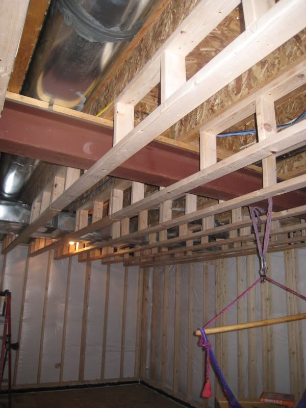

This is the start of my New Years long weekend. this is my longest soffet with a small wall to hide a column. This shot was taken at the foot of the stairs looking towards the theater entrance. I have widened the stair wall to allow for a nice thick area for rail stiles. Beyond the column will be a built in shelf for some hockey memorabilia. Then the wall will continue to the theater.
This shot is from the theater door looking into the bar area. Wow, with the bar layout I can start to picture it a lot better. This will be the top part of the bar, and on the other side will be cabinets and a lower counter over those. I still need to make my last soffet above the bar, and it will follow the angle of the bar and as a result will be the most complex of the soffets. Good thing it will be my last one (until the theater has been drywalled at least). You can see the base of the column where I started framing it, but I really can't go further until the soffet is complete so I know where to tie into it. The column will be a support for the upper counter, and appear to go right up through the edge of the counter (at least that is the current plan).
Here is a shot from the inside of the bar area looking towards the theater.

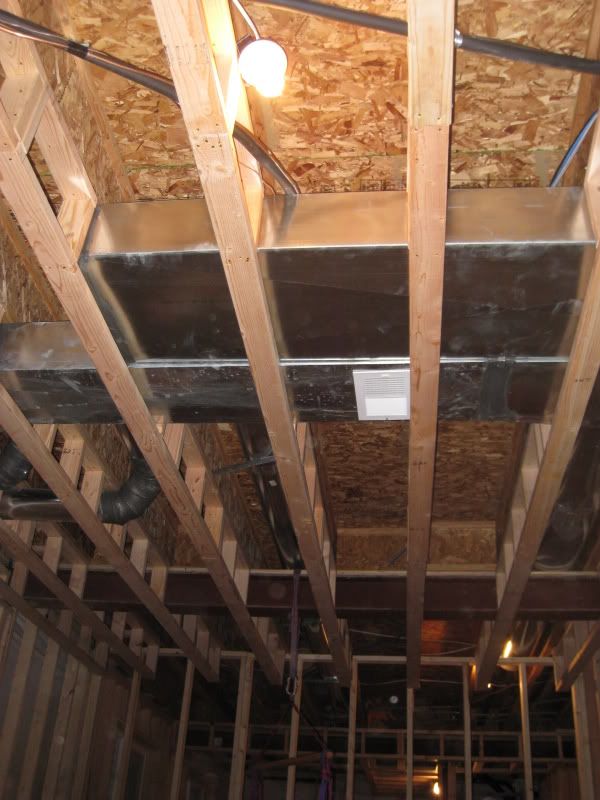

I finished the project of lowering the ceiling. Working above your head with a nail gun is painful. The arms get real tired.

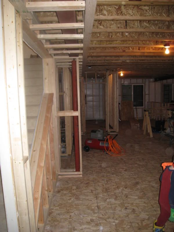

This is a shot from the entrance looking towards the screen:
Here is a shot from the fron floor looking towards the back:

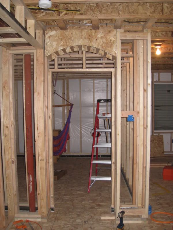

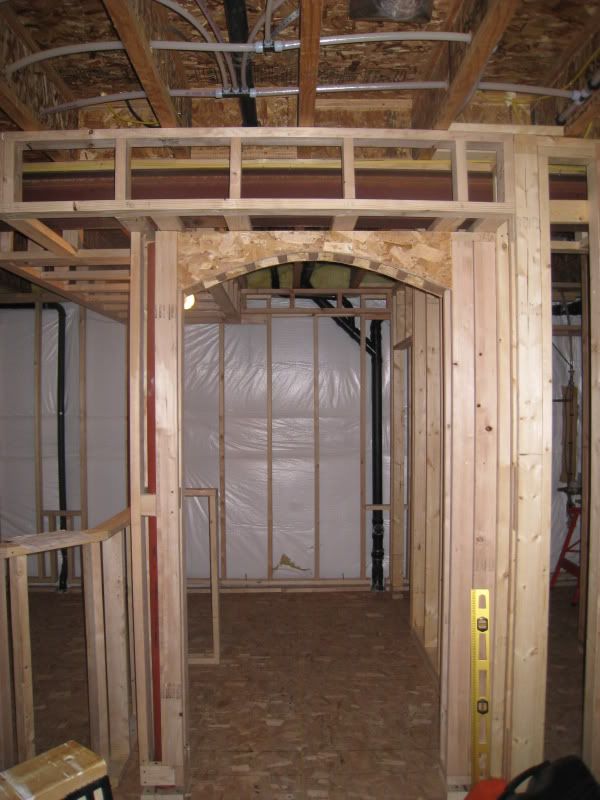

And now, I can work on something new and different. I started my arches. This is the longest arch at the foot of the stairs:
I have 2 arches left, and a few spots to make sure the edges of the drywall will have something to attach to, then I can start something other than cutting and nailing 2x4's.

Well, framing is now done. I finished the last of the arches this weekend.
Here is the arch over the kitchen entrance:
Here is the arch over the theater entrance:
This one was tough, because it can't attach to the ceiling or the column on the left because those are coupled to the rest of the house. I used the last of my RSIC clips for those connections. The back and right side are attached directly to the walls, because those walls are the decoupled ones.
And we now have injury number 2. When finishing the last arch, I stepped off the ladder and rolled my ankle. That was Saturday, and today, it is still sore. It stiffens up whenever it sits still for a while, and by the end of the day it is throbbing. No pretty colors on this injury, but there was swelling the first day. Going to church Sunday was funny. I was hobbling from my ankle, and my wife pulled her back that morning, so we were like a little old couple shuffling in.

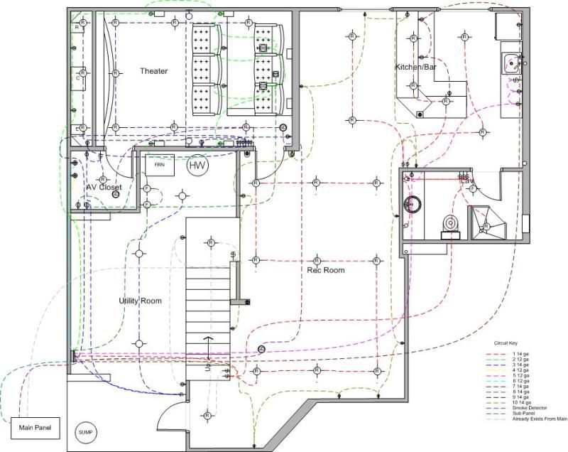

New pic and electrical plan, deleted old ones.
Up next:
Electrical. Here are my current plans:
And attached is the excell spreadsheet of my load calculations.
Reason for change from last pics. Too many pendants on the plan, combined 2 circuits, found 3 outlets on two separate circuits in the excell file.
Changed theater door per Jamis suggestion in 2 posts.

Well, yesterday, I bought some recessed can lights in preperation for the snow storm comming this weekend, and when playing with them, I got half of them installed, so I need to go buy some more now so I have something to do during the storm.
Anyone know if there is a special kind of light for a shower stall, or is it just a plain can light? I would think with the water spray, you would need some kind of sealed light. Also, you don't want the vapor getting past you green board, so I would think there is something for it to seal around.
On a side note, I was getting bored with framing, so this change is kind of invigorating.

One quick thing I noticed...
I would consider flipping the door into the theater so it opens the other way. Not into the theater, but to the left against wall adjacent to the utility room. As it is shown in the plan, it will stick out into the rec room and bar area when open which could be annoying (especially during parties or movie night).
