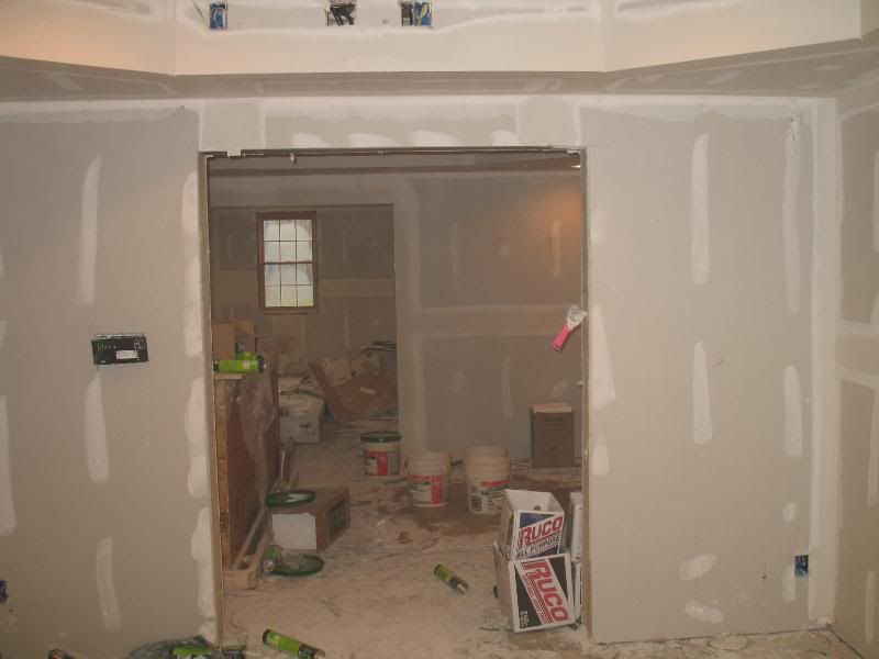

Disclaimer: I'm not an expert, and am in the midst of my first HT. Also, every room is different.
My room configuration: 12x15 with 8 foot soffits, ceiling is 9 feet. Back wall is open, but will have double-doors. Visit signature for pics.
Wanted to share my plan, which I think is "sound" :-)
Steps/Approach:
1) Install furring strips for fabric on all four walls

Only concerns I have are:
1) For a 12x15 room is this overkill - NOTE: I did do double drywall and GG only, no risc clips. Am also caulking all possible leak points for sound.
2) How in the hell do I build the furring strips to hold the bass traps (need to research bit more).
Figured maybe my approach may be a guide or possible suggestion. Treat it with skepticism.

Rear corners? Back wall? Those are both critical areas; some of your highest peaks and deepest nulls will come off the back wall...low end will build up in the back corners like it will in the front.
Frank

Frank,
Yup, this is something I fear. However, based on the build of the theater, there's only one of the back corners that could support a trap. The other back corner has a small panel that accesses the equipment.
Not ideal, but best that I can do based on room layout. Here's picture of the back wall, and you can see my dilemma.

Hmmmm...yes, I see the problem.
