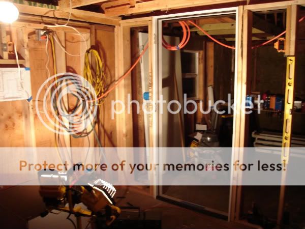

My father came over and we got the garage door disassembled. Now to frame it out…
After applying tyvek… we were lucky to find some spare siding up in the loft… just enough to finish off the wall. Done in four hours. Sorry, Dad, no more parking the Mini in here.
Beginning the ceiling leveling… attaching 2x4s to the joists gives us the level ceiling we need. It’s a lot of work, though, and will only give us a finished ceiling height of 6’9”. Good thing we are not NBA players. Is that a server rack on the left? Uh, oh. Premature purchase! -5 WAF points.
Now getting the wall between the HT and studio framed. Went 2x6. My father did a great job on the design, but had I done my research and visited AVSforums before having this wall framed, I would have insisted on a staggered 2x4 wall. Let that be a lesson, kids..
There is a spiffy workbench in the studio area that needs to come out eventually, but right now it’s really handy for cutting all that wood. Note the ceiling leveling. Still need to finish that up.

Framing for the door to the studio area is in. We've taken out all the original florescent lighting, so we broke out some halogen worklights ($30 each at Home Depot, the visa card is burning now).

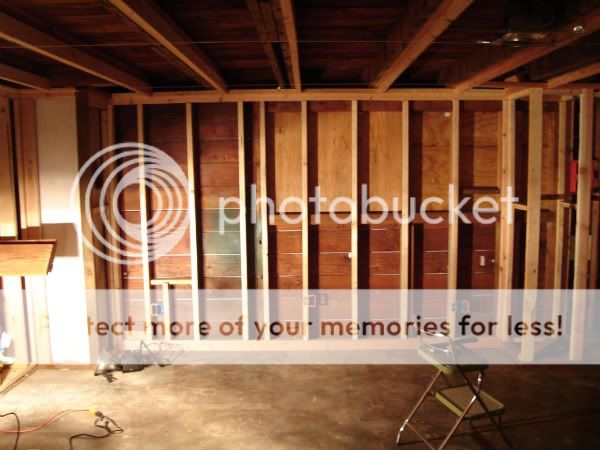

A view of the screen wall. All original electrical is now out.

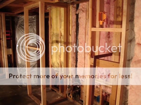

Into the studio area... reframing of the soffits. I'd take them out completely, but there is this whole "it's holding up the roof" thing that concerns me.
Up above the HT, we;ve decided to frame in a wall for the storage area, reducing the amount of drywall we are gonna install. Notice the furring strips on the roof joists; we are putting insulation up there, too.

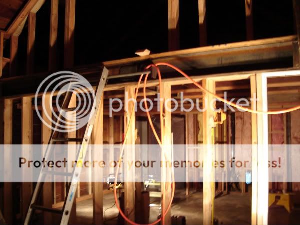

Ok, back into the HT... Dad furred out the wall with the breaker box, so it is now flush with the ex-garage door wall. Hooray! Except now we see how crooked the wall is compared to that door... Hmmmmm... everything looks so good in the computer, though!

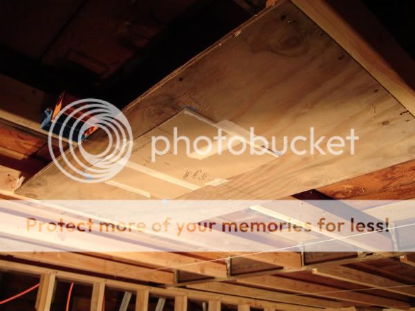

My Adidas shoebox projector mockup now hangs from a piece of plywood to give extra support for the projector ceiling mount. Don't wanna have a $3K projector fall on my head.

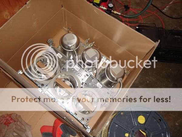

Speaking of falling on my head, I've started to put up the 5" Halo cans.
This one decided to take me out. A rail came loose and it was bonky on my konky. But I think the can, and my head, will be ok. Btw, whose job is it to put those little foamies on top of the cans, horrible placement of foamies, people!!!
ya know, i do have a bone to pick with you guys who say these cans are so easy to install... yeah, like you, judsonp! these are taking forever! I'm tempted to fly you out from Ohio to Oregon just to put up my cans and see if it really is a 15-minute job.

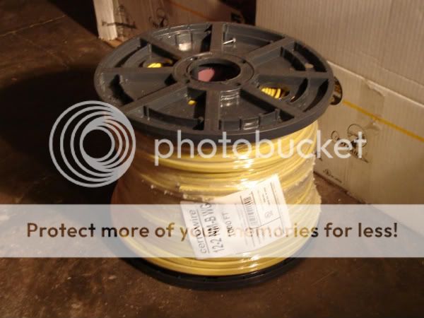

and what is better than a 1000 ft spool of 12/2 romex?
Well, I can think of a lot of things. That's it for now. Watch 'em if you got 'em.
Update: I returned the 1000ft spool. What was I thinking?
