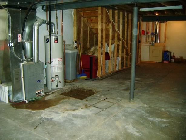

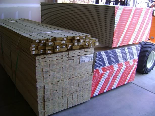

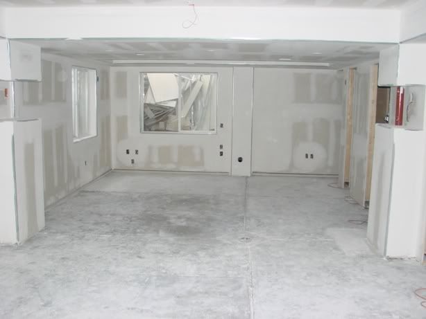

Drywall/Lumber Arrives on May 30th 2008:

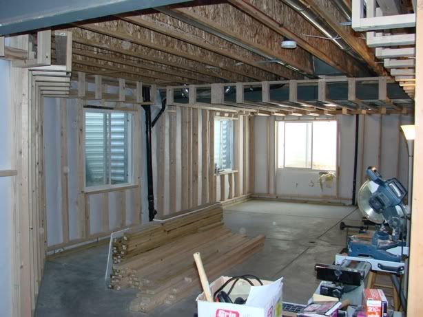

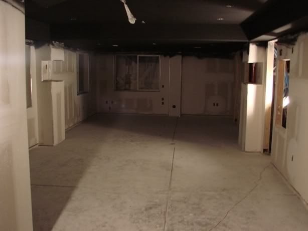

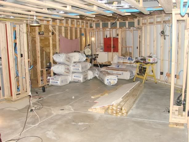

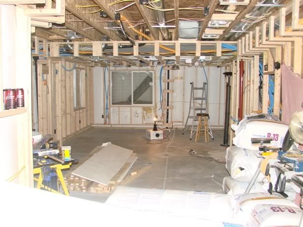

Basement Prior to Framing & Post Shift:

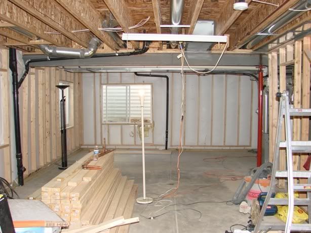

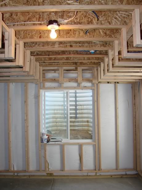

Framing:

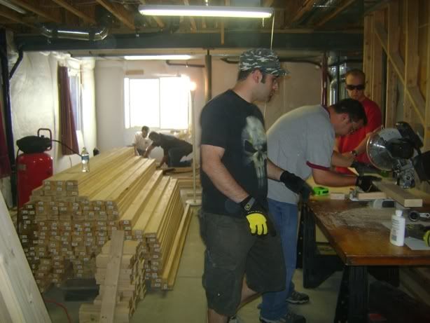

My buddies helped me kickstart the construction in the first couple of days of framing, which set me on the right track to finish the rest of the framing
Notice original structure post removed and replaced by new post (5 ft to the right)
Construction Gangsta!

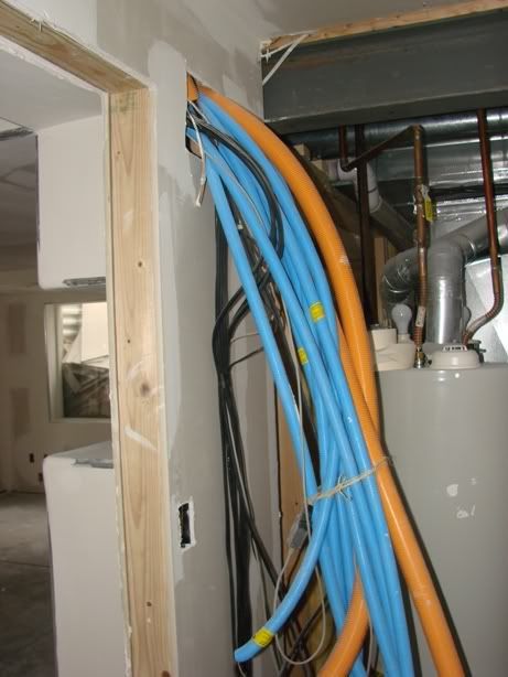

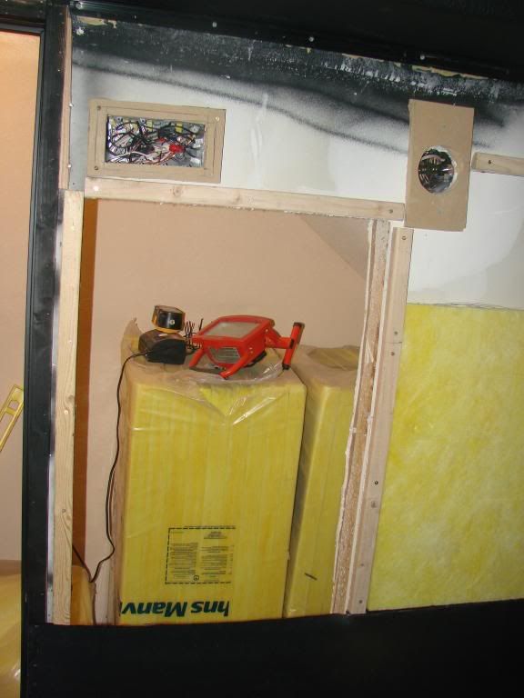

Electrical & AV Wiring:

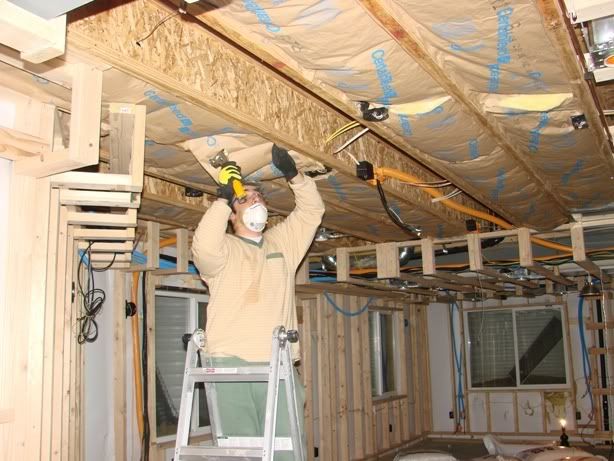

Insulation

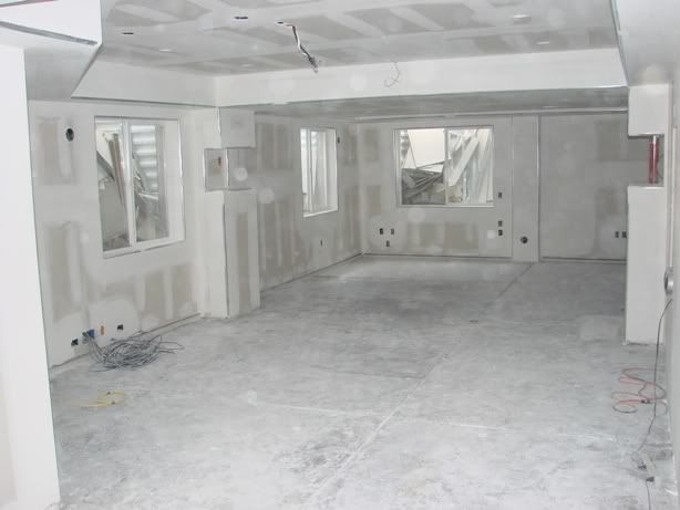

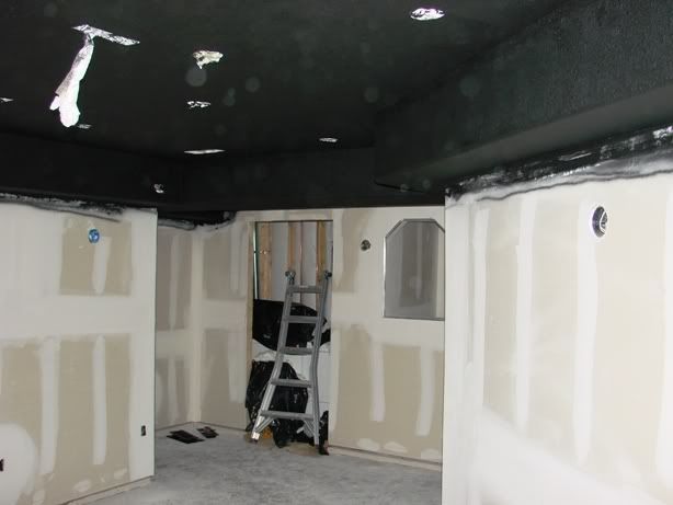

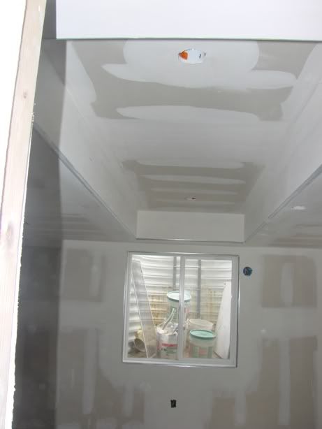

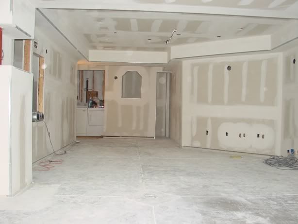

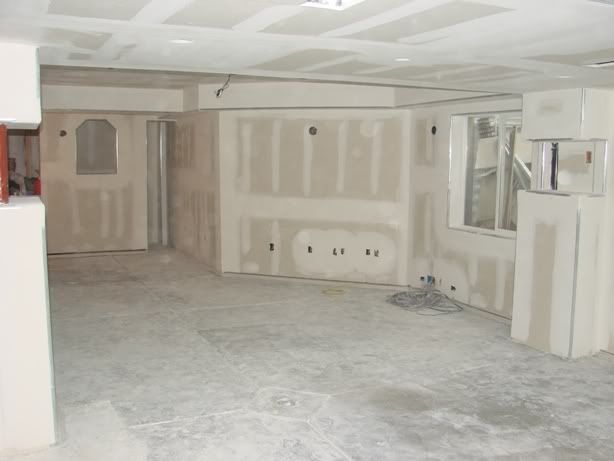

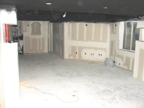

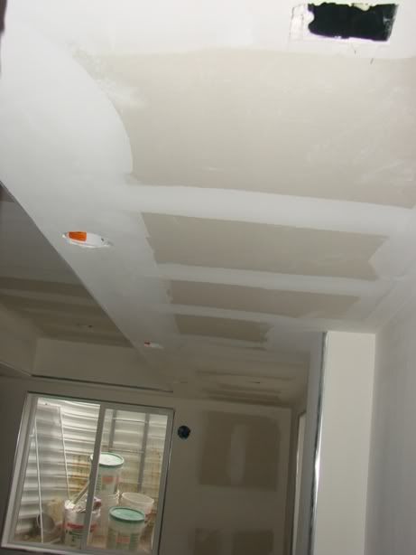

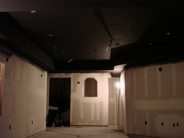

Drywall:
Jose's Drywall Crew (VERY affordable and worth every penny!)
Looking at Front Main Wall (where false screen wall/stage will go)
Looking at Back Wall / Bar area
Right Column
Left Column
Under Screen Wall Soffit
Soffit Near Screen Wall /Stage Area

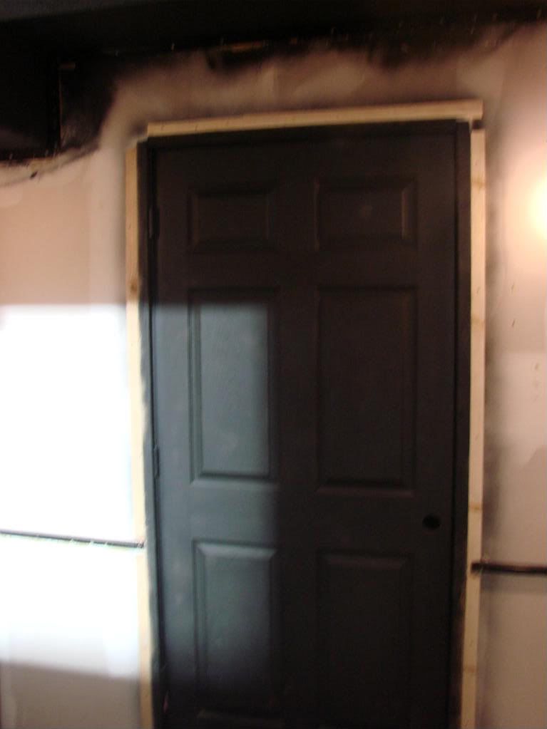

Door/Entry to area behind screen wall
Mechanical Room

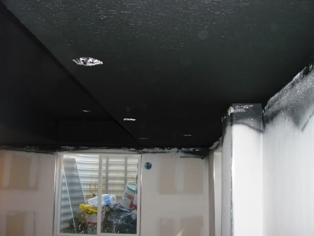

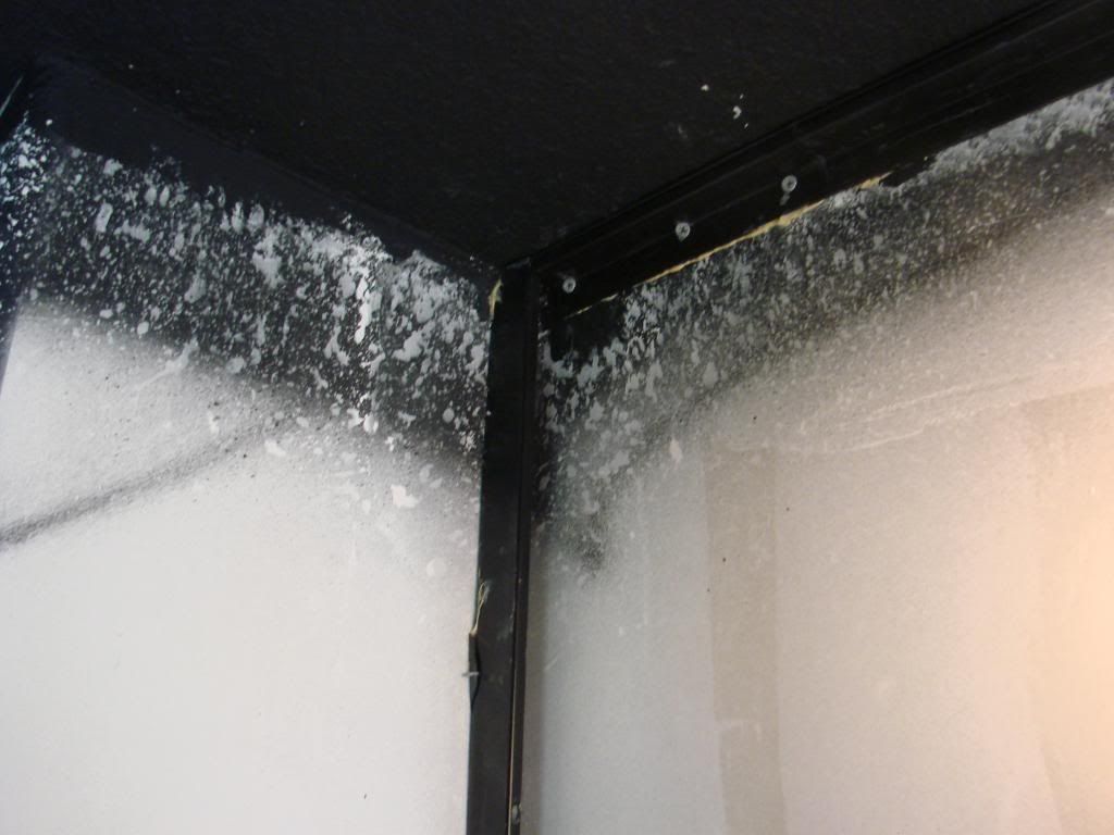

Texture/Paint Ceiling and Soffits (Flat Black over Knockdown texture) :

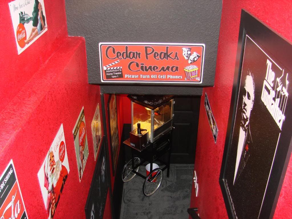

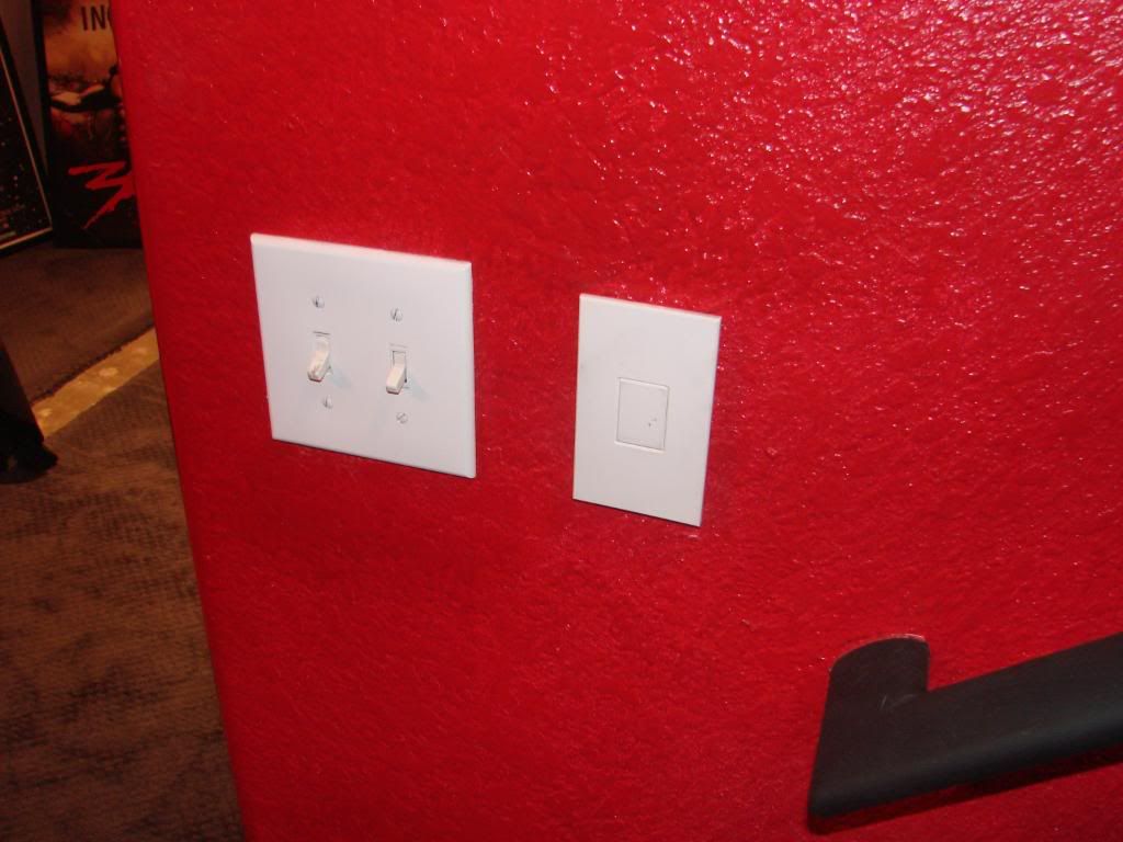

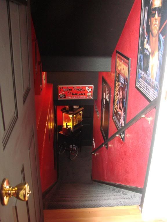

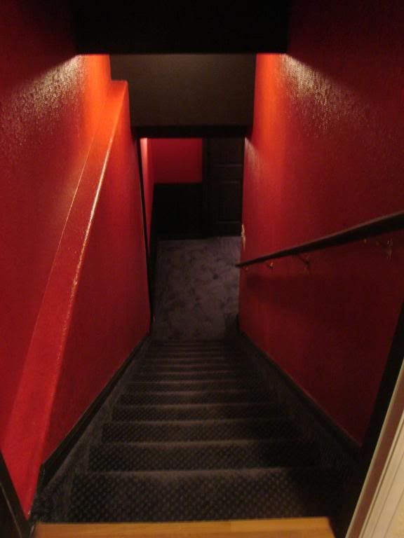

Entrance/stairs down to basement (Only area with Painted Walls – No Fabric)

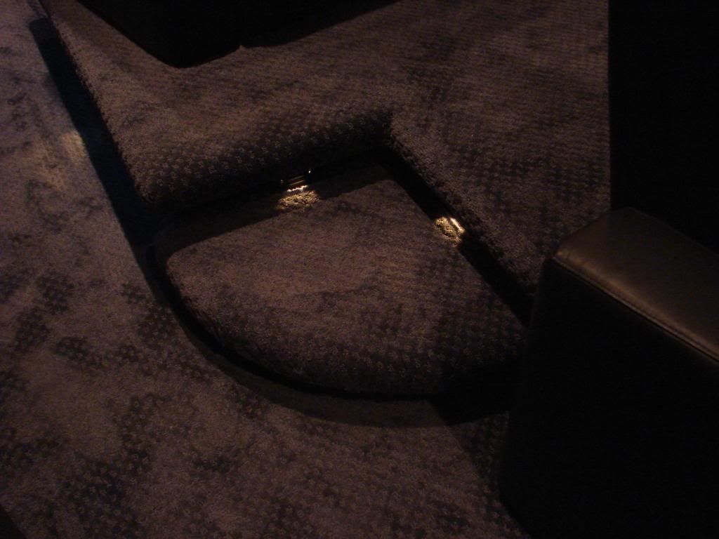

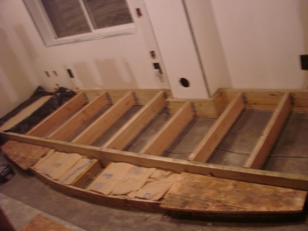

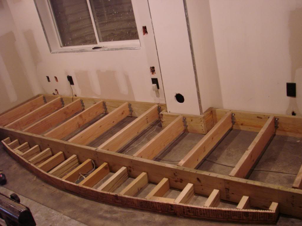

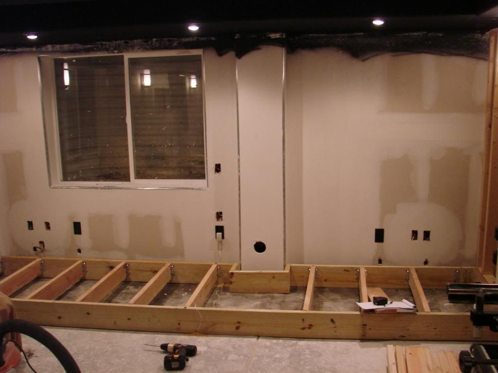

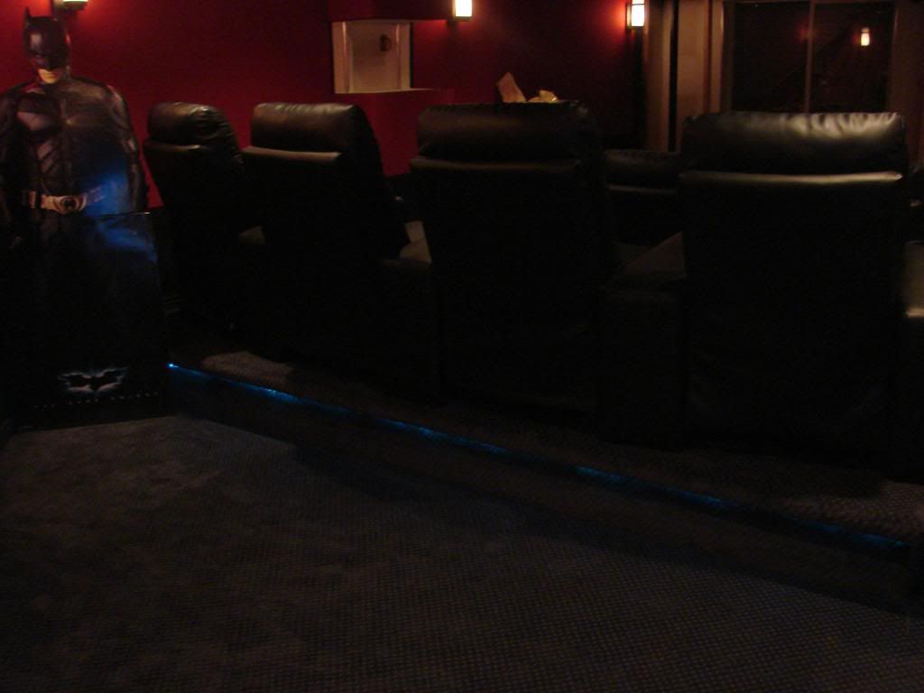

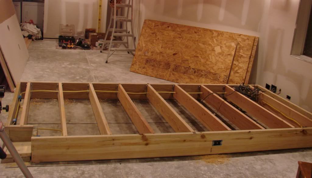

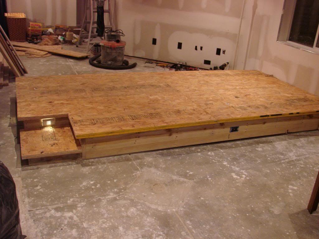

Original Riser Step and Step Lighting Set up + Changes made to step shape and step lighting (Used 2x10's with Joist hangers, secured with nail gun and screws). I call this the The Evolution of the Riser Step ( I started with a very small square step, into a much larger square step, into a nice curved step)
First Pass - Small Square Step (With one Step light and two side riser lights):
Second Pass - BIGGER SQUARE STEP (Now with two step lights instead of one, and one center side riser light instead of two)

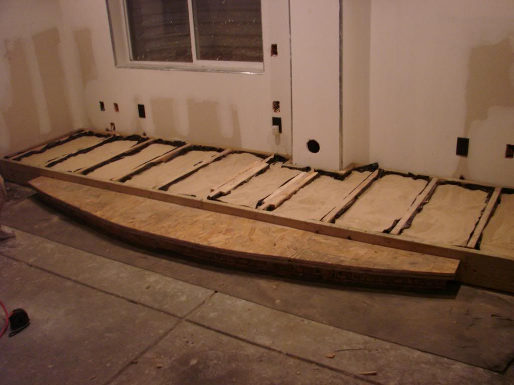

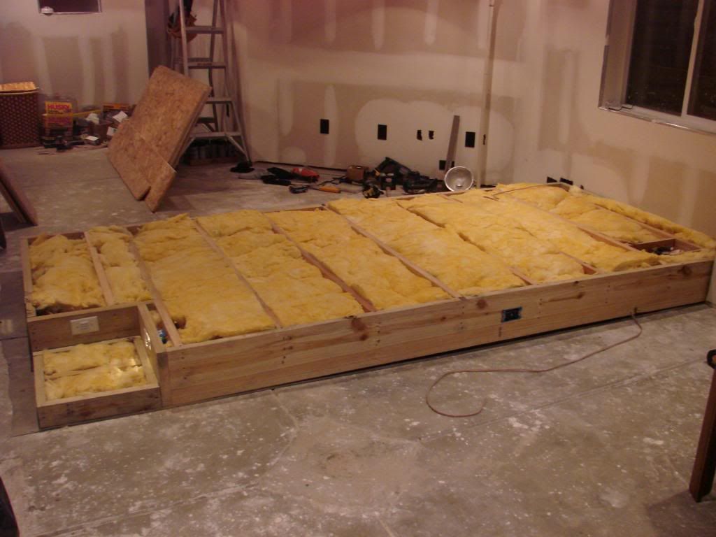

Insulation now stuffed inside riser joists, then 2 sheets of 3/4" Plywood installed as surface with Roofing felt in between:

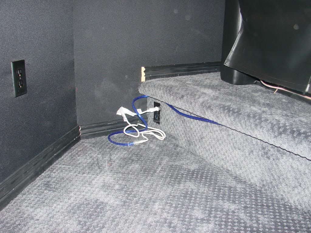

Built an AV/USB box inside the riser (Front left corner of riser surface):
Finished (uncarpeted) AV/USB box):

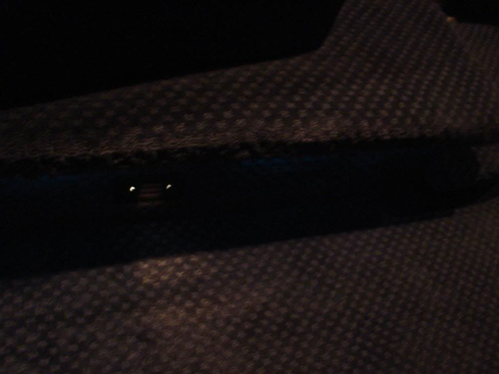

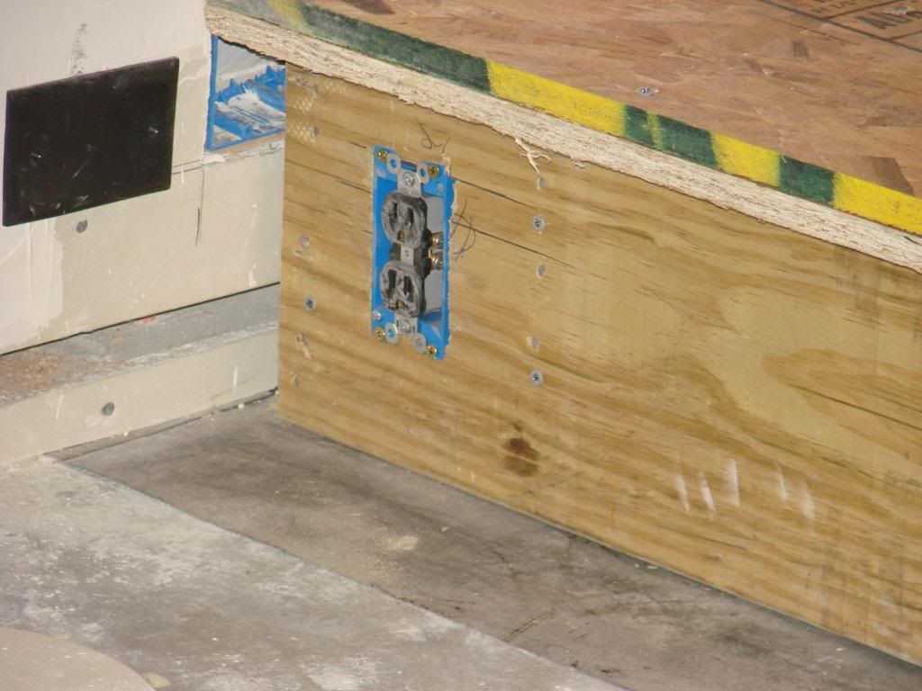

Bass Shaker Wiring for Riser:
GrafikEye wired outlet for LED rope lighting under Riser's 2" lip:

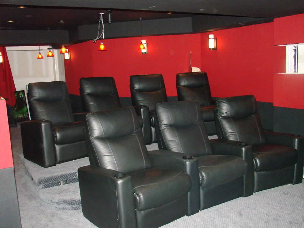

Final Change to Riser Step (my dad, who is an architect engineer of 35 years, convinced me to and helped me redo the riser step to make it round - creating more access/walk room between right column/wall and riser)

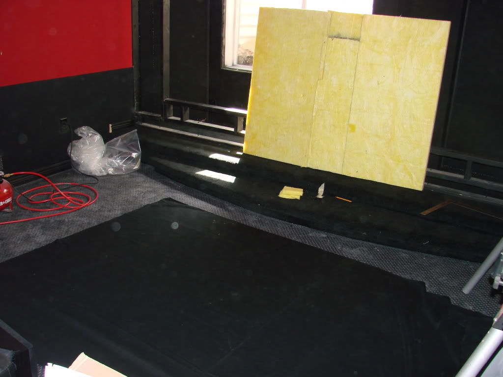

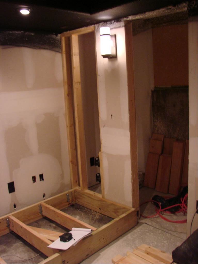

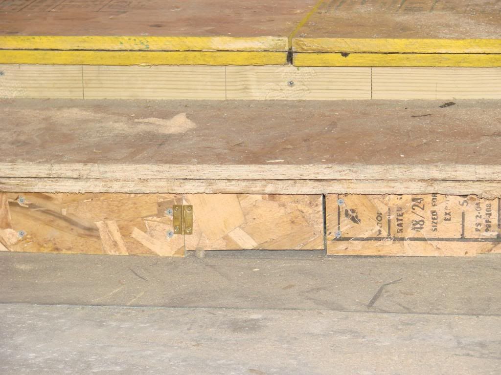

Moving on to Stage Construction (Build stage with 10 foot wide curved step, fill with 1800 pounds of sand and insulation, cover with 2 sheets of 3/4" plywood + 2" lip - also roofing felt sandwiched between two layers of plywood - just like riser):
As recommended by Bryan Pape's room acoustic analysis - I closed the stage's right side open area (framed and drywall-ed to provide better corner bass trap sound treatment)

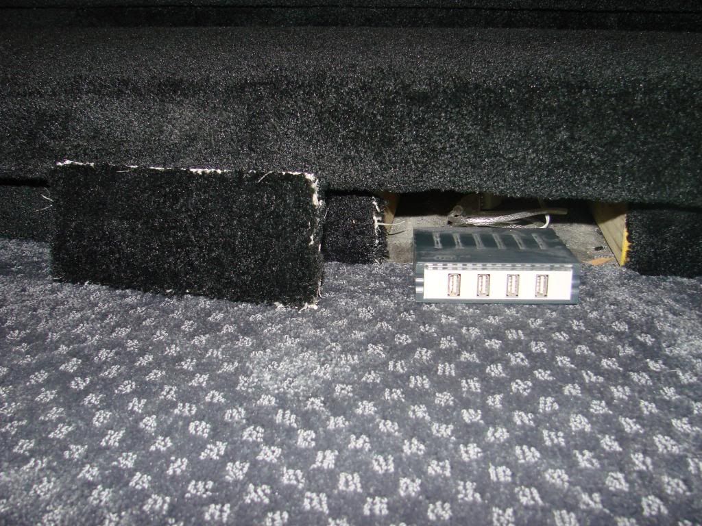

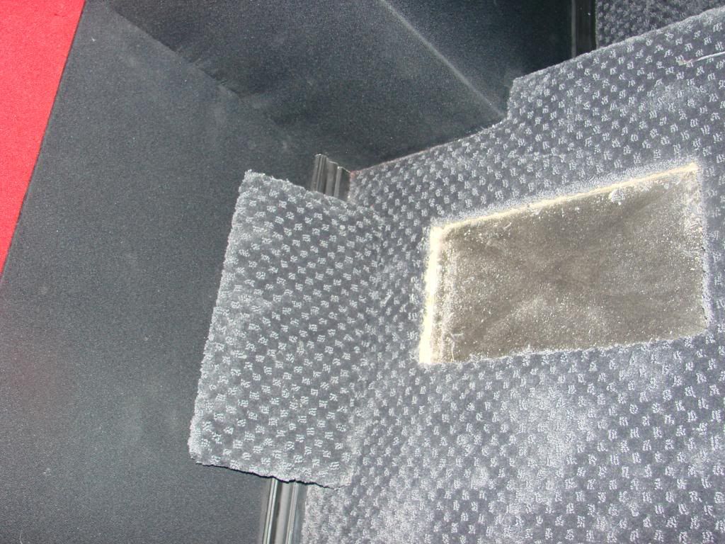

Added a hidden powered USB compartment under stage's curved step:

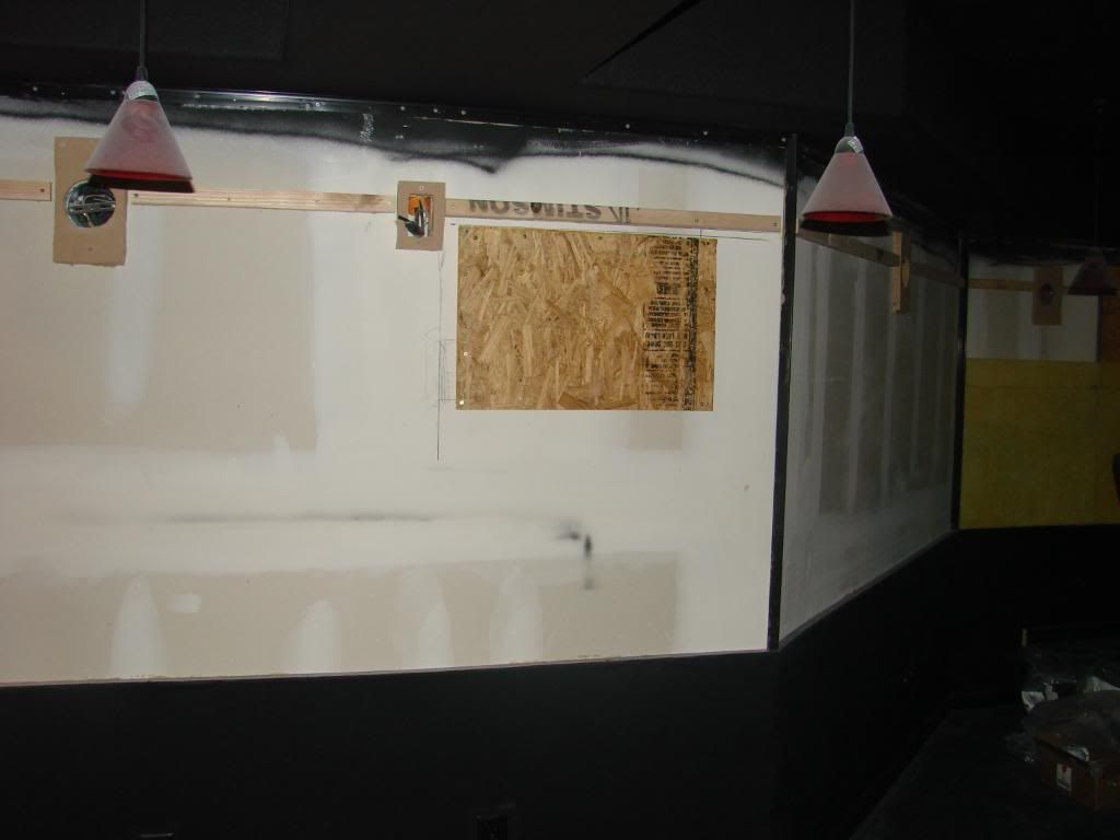

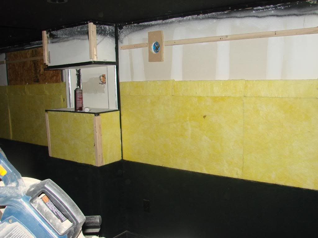

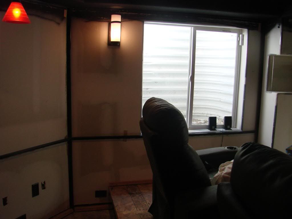

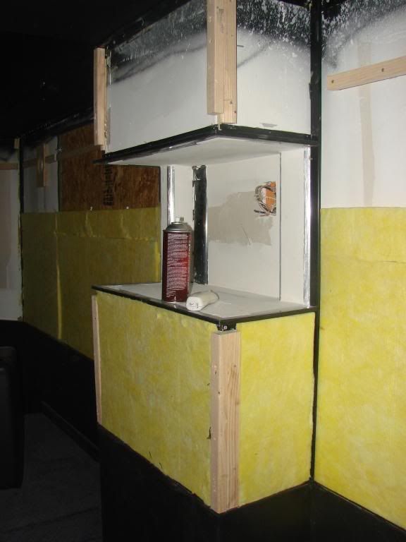

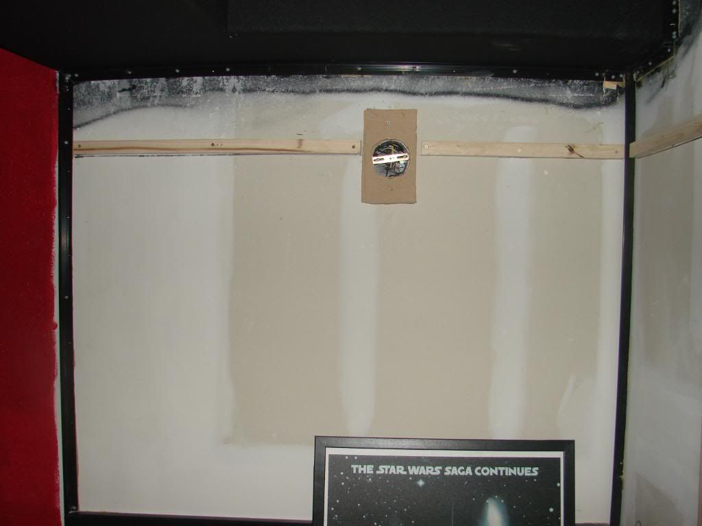

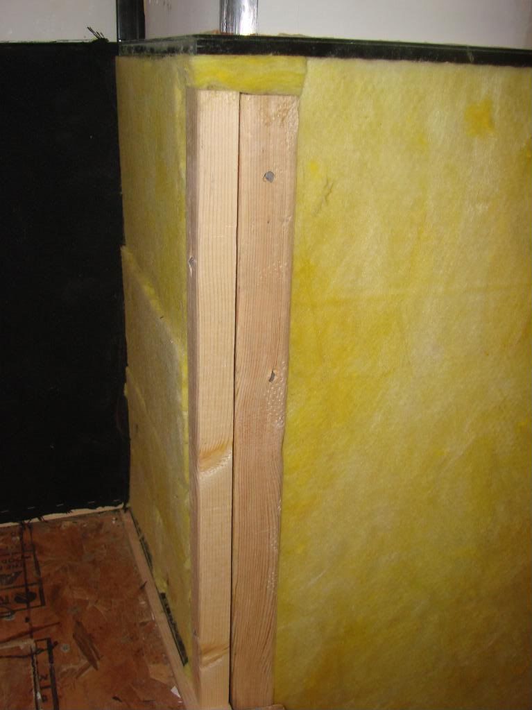

Now moving on to 1" Furring, 1" Fabric Mate Track, JM814 Insulation/Sound treatment, and Guilford "GOM" Fabric installation (used 1" FabricMate Track, 1" and 2" ripped lumber, liquid nails, screws, nailgun, Finishing Nailer, Pnuemtic Stapler...etc):
Special Note: I did not know the first thing about using FabricMate track and ripping 1" and 2" studs for furring purposes. I really started with zero knowledge and worked my way through the great AVS forum and builder community to get to the expert level I am at today, so if I can do it, so can any construction newb!!! You just need to think outside the box and try to be be a little more inventive to come up with better ways to work around columns, door frames, furring..etc. Big Big thanks to China Bud, BPape, RMcVeigh and Oman321 for their GREAT FEEDBACK and advice! And especially for my fellow Coloradoan RMcVeigh for letting me borrow some of his tools and always picking up the phone when I called with questions!
Running track around inside/outside corners, columns and soffits
Contrary to many have said before - You Only Need One Piece of track, not two side by side, in almost any corner or column application/orientation or inner/outer corners - Check out the photos to see the proof):
Track and 1" Furring right of screenwall:
Oh yeah, I had already built the floating Screen Wall prior to carpeting:

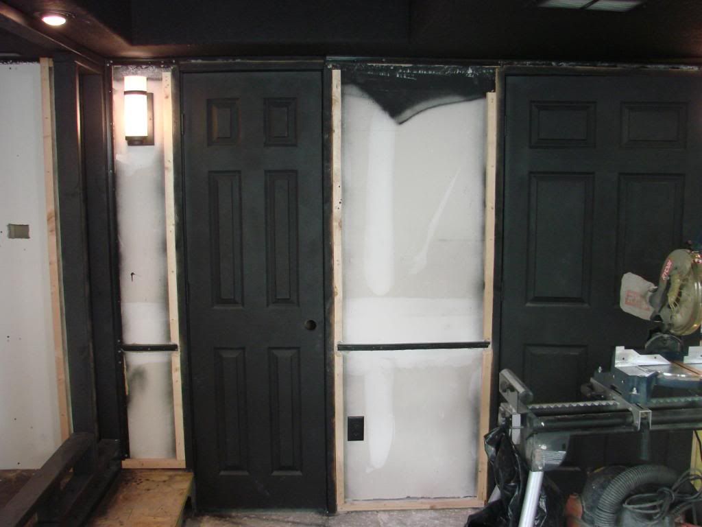

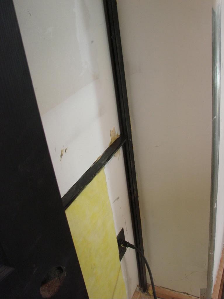

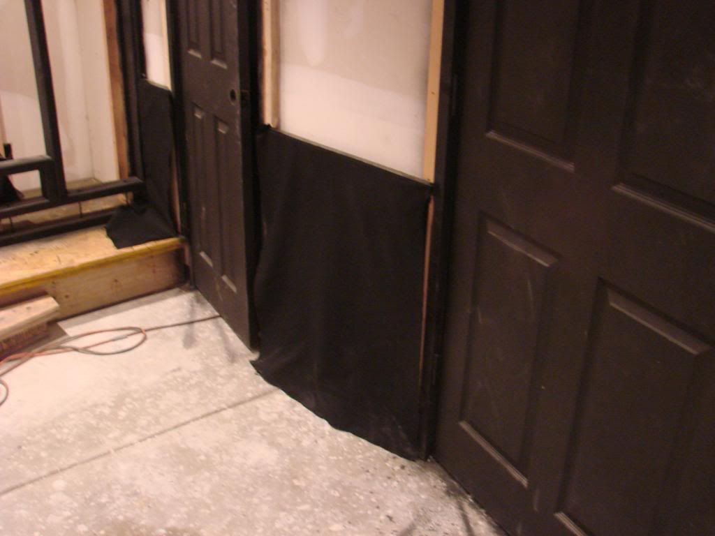

Track and Furring between side-by-side door/door frames:

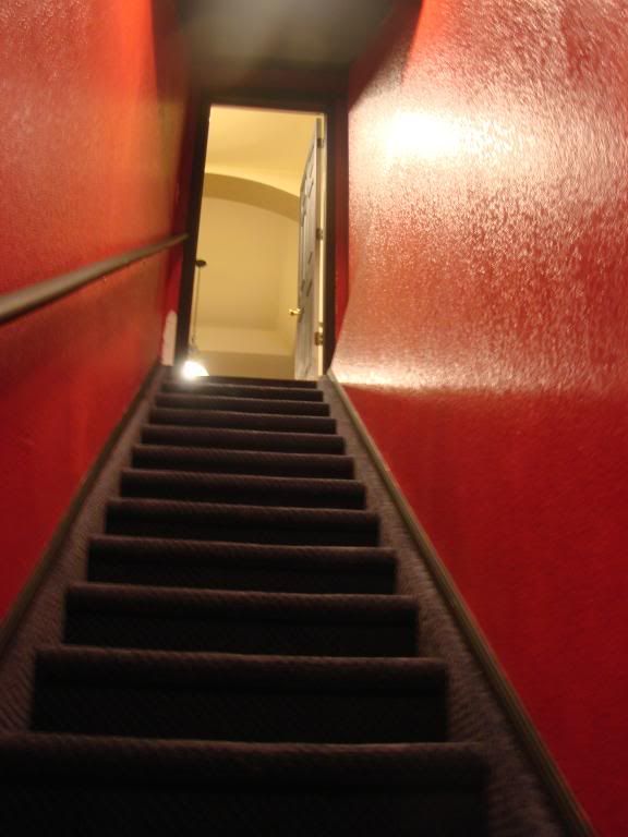

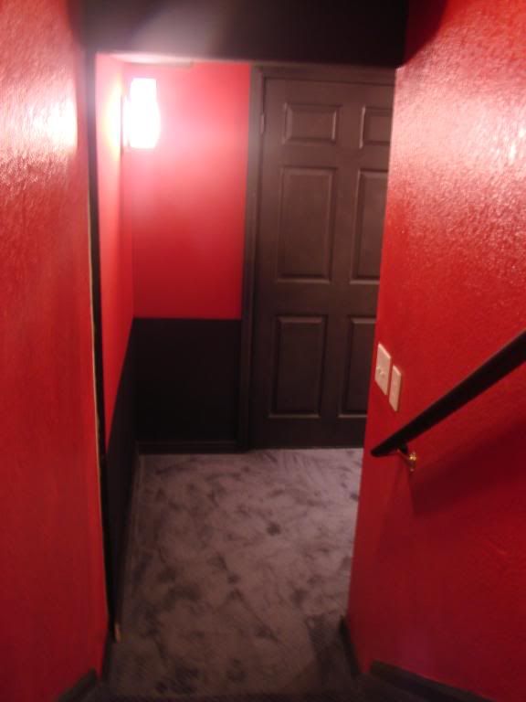

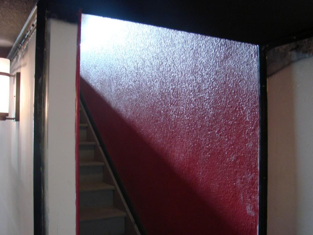

Textured/Painted Stairway meets Fabric at entrance of theater:

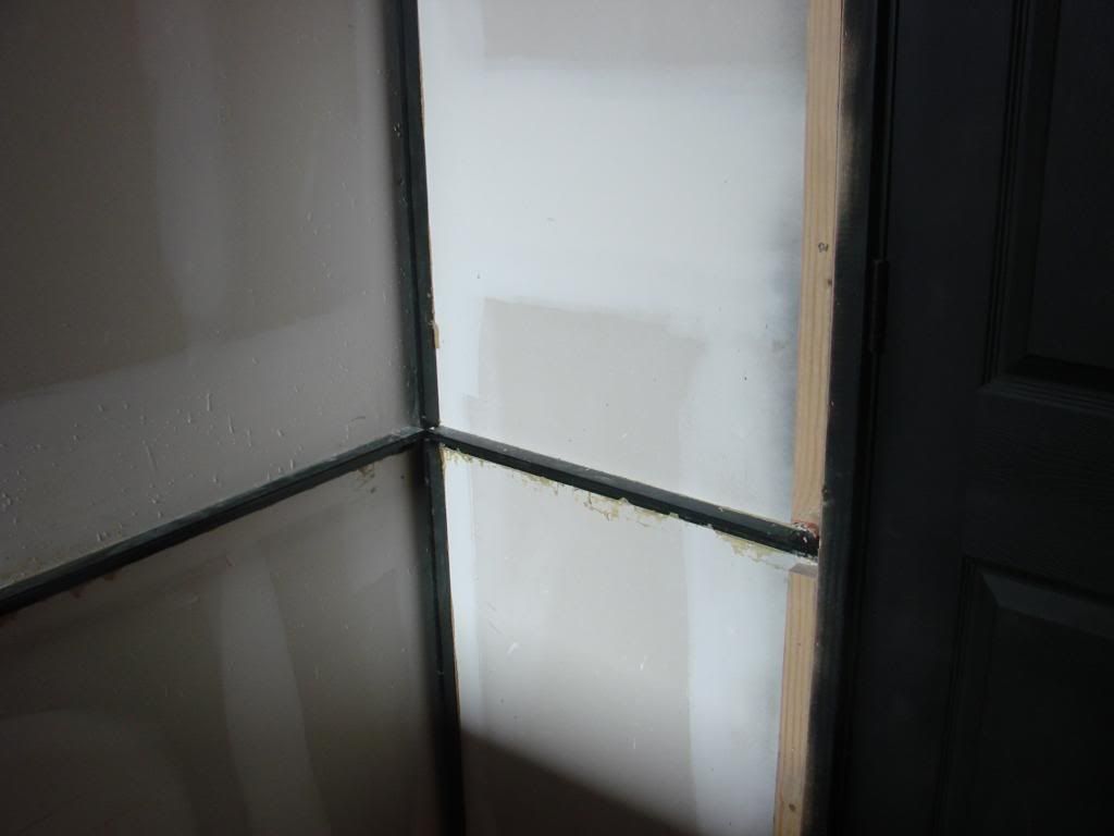

This is how I used one vertical piece of track to join the horizontal chair rail track (just drill/cut small side area on vertical track to meet with horizontal track fabric seam)
Close up of column/corner track orientation:
This may look ugly at first, but once you have insulation and fabric, you don't see anything but perfection!!!

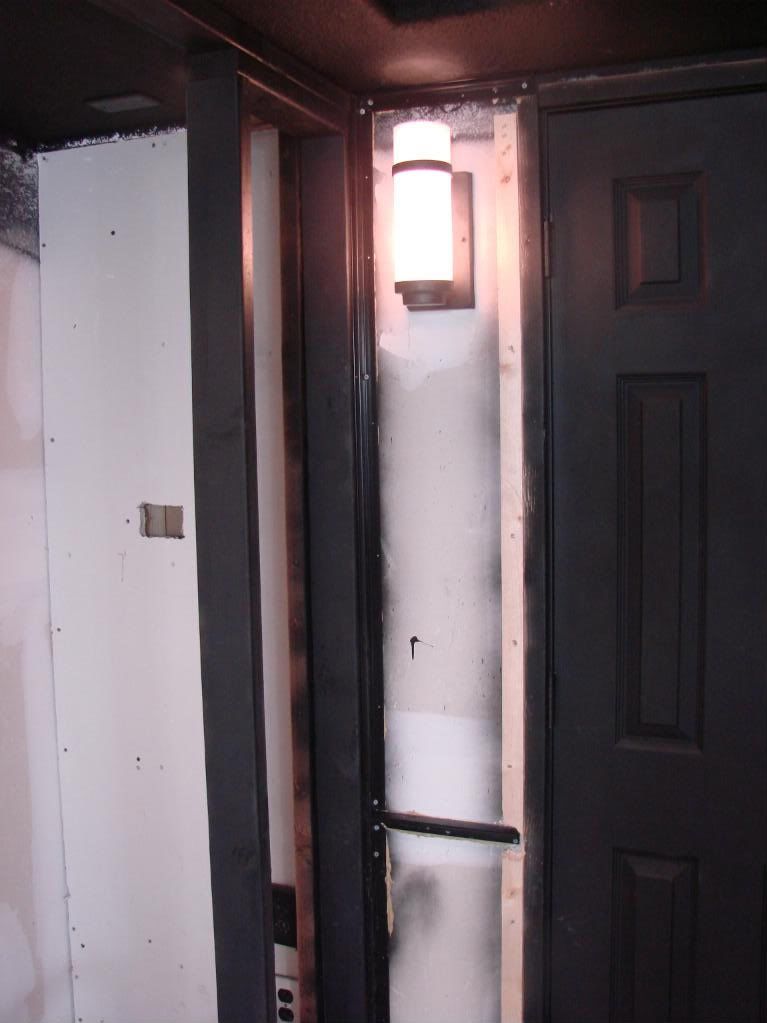

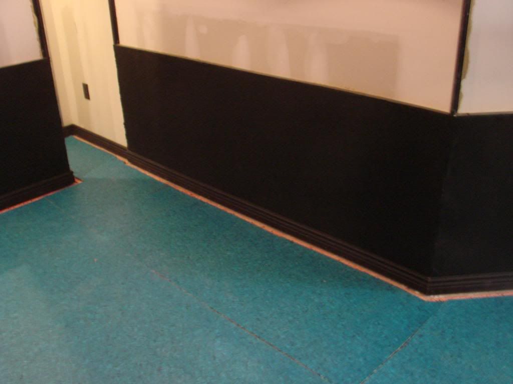

Used 1"x 1" Furring around door frames and for baseboard furring (saved me $100's in track costs)
How to achieve a nice streamlined corner square look on columns using Furring, track and insulation:
Notice how nice and treamlined the column corners look (by using 1" corner furring, track, and insulation, I got a nice square column)

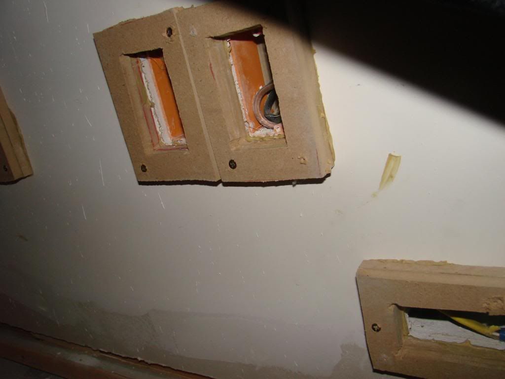

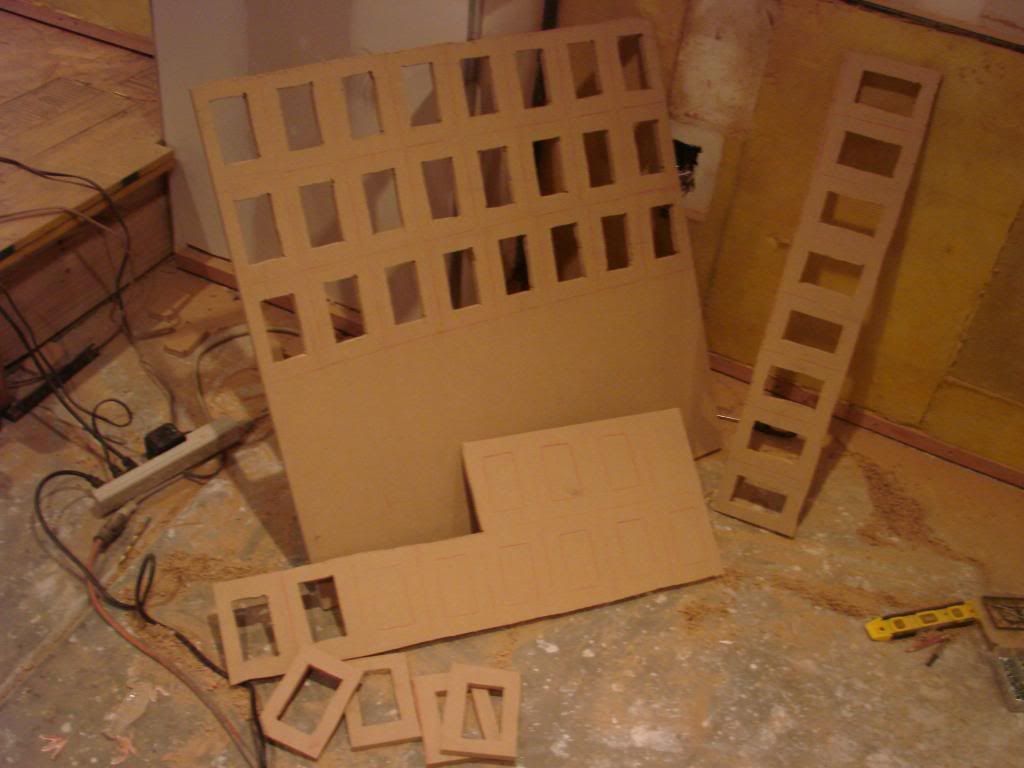

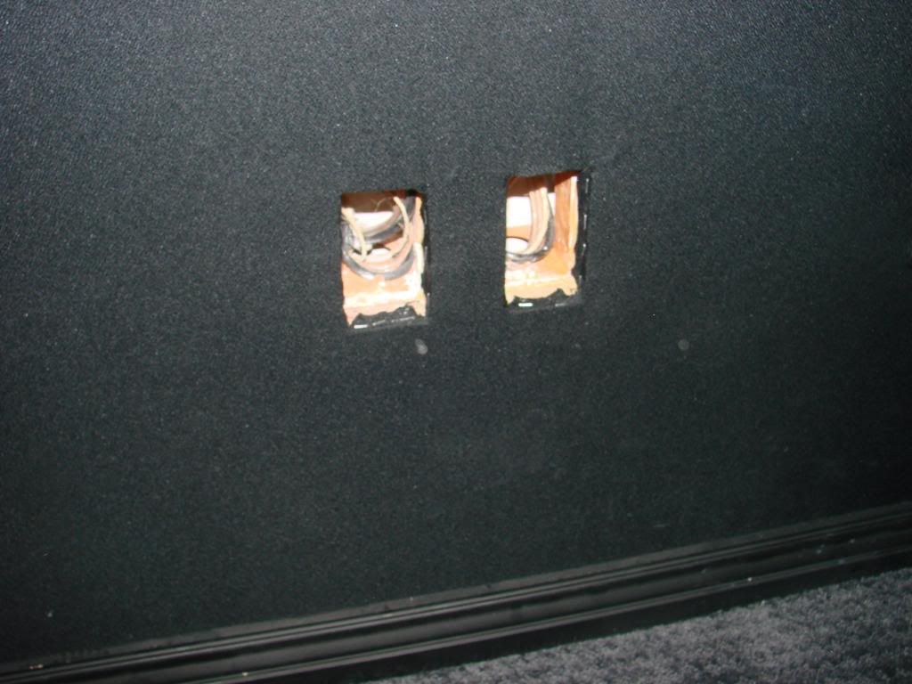

LET THE ELECTRICAL OUTLET 1" FURRING BEGIN! (Used 1/2" MDF with Jigsaw for square Furring, also used liquid nails, 2" Electricl Box/Sconce screws..etc - thanks to RMCVEIGH's recommendation)
Also notice the 1" baseboard trim prep furring

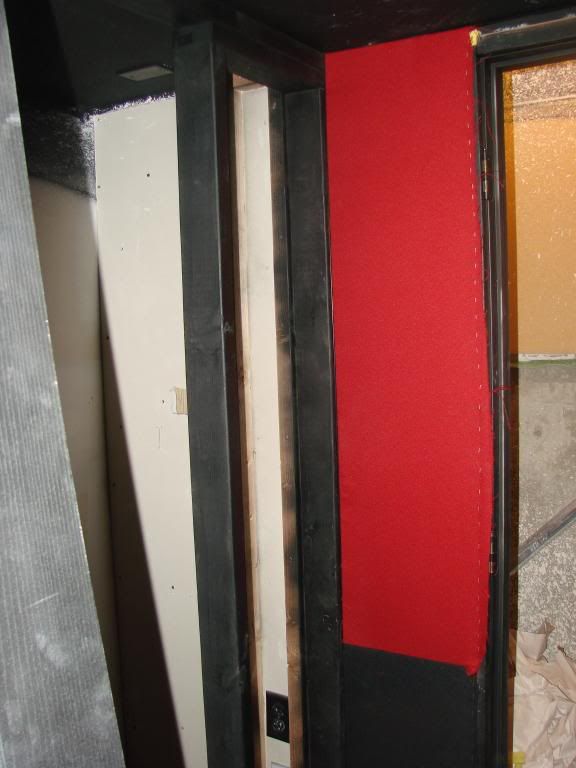

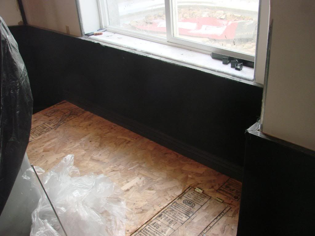

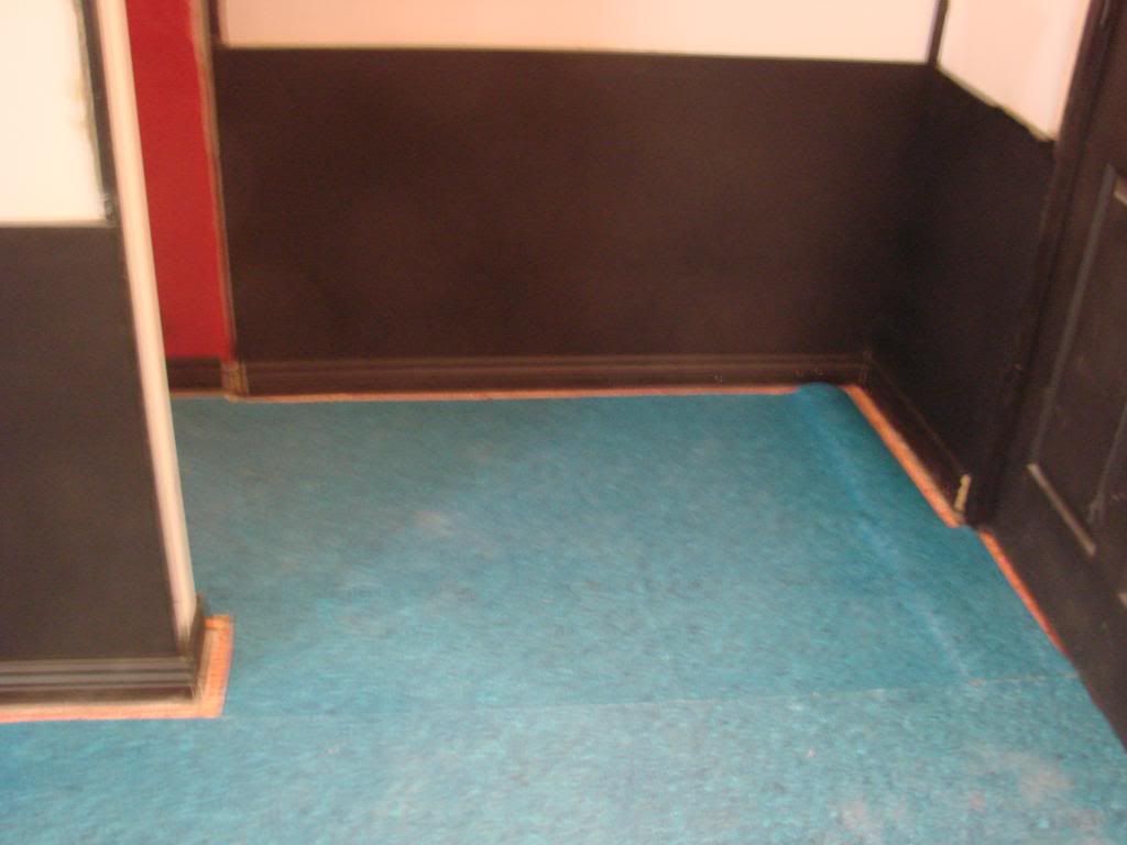

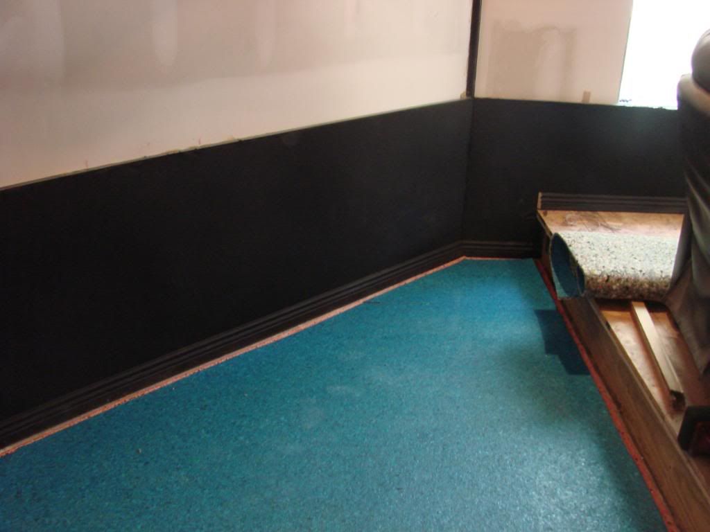

Now moving on to installing the GOM Anchorage black Onyx Fabric for chair rail (Floor to 32" chair rail height - Note that the 1" JM814/OC703 insulation/sound treatment has already been done using 3M Adhesive Spray):
No matter how dusty and dirty the GOM fabric got at first, it was as easy to clean as wiping it with a lightly damp cloth (I LOVE GOM FABRIC - SO EASY TO WORK WITH!!! Same with Track)

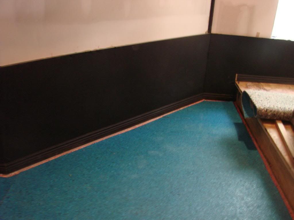

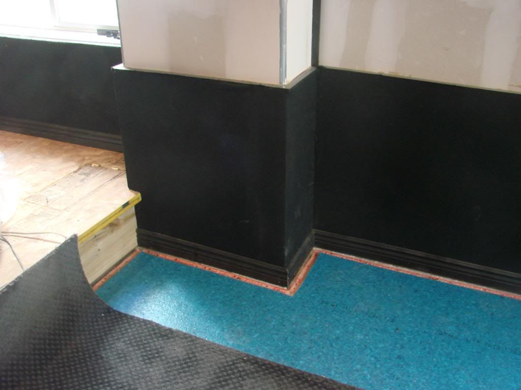

Next pictures will show the fabric after it was already trimmed at the bottom - you need to trim about 1" from the floor so the fabric doesnt touch the floor, then you will hide all the staples and any imperfections with the baseboard trim moulding.
Also by the time I took the next few pictures, the carpet crew showed up and started installing the carpet pad.

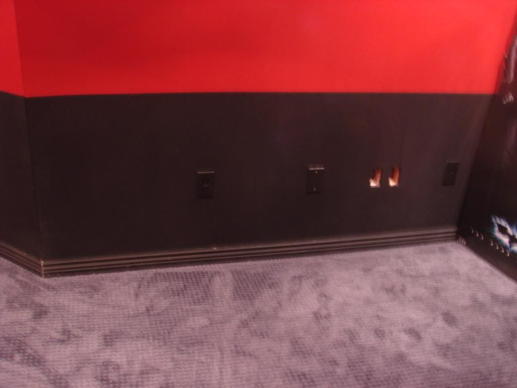

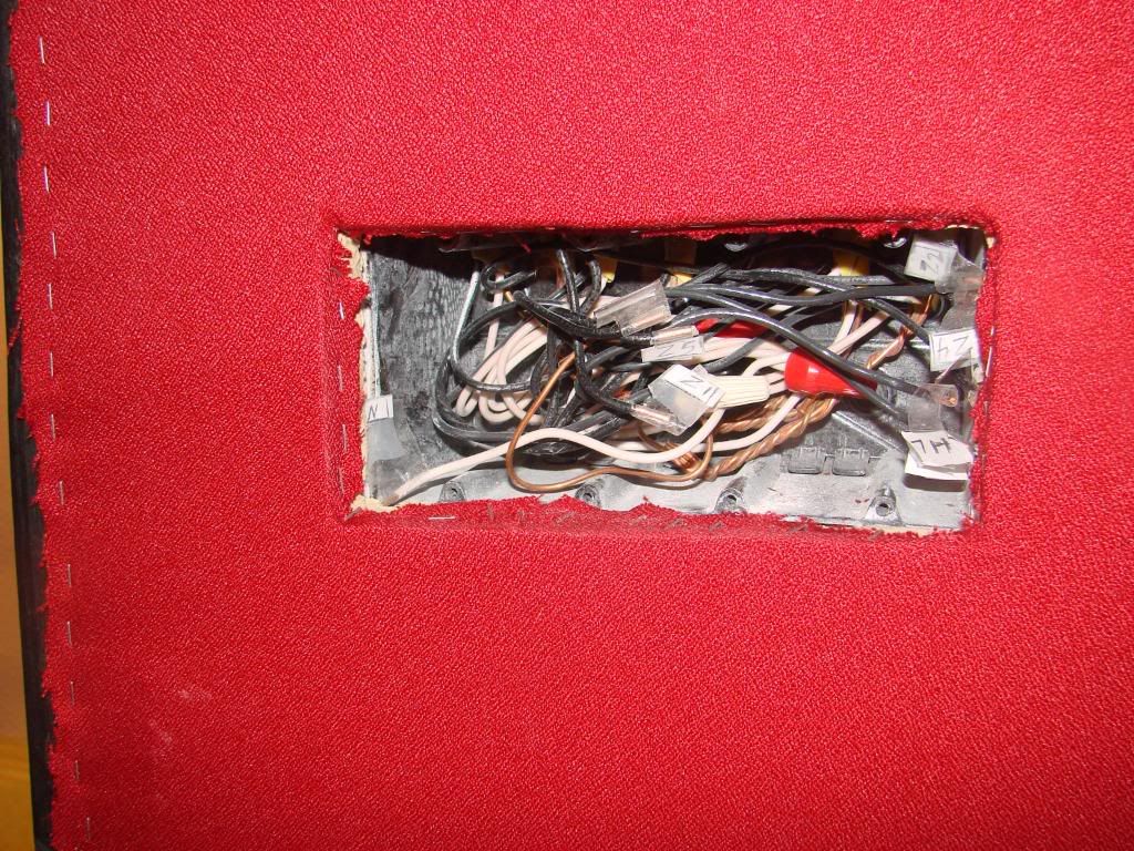

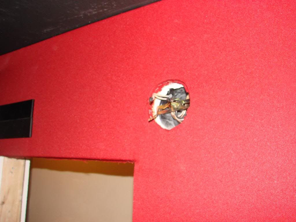

Next, I started cutting small X's through fabric where the wall outlets are, then stapled fabric to the inside using RMcVeigh's awesome Pneumatic stapler:

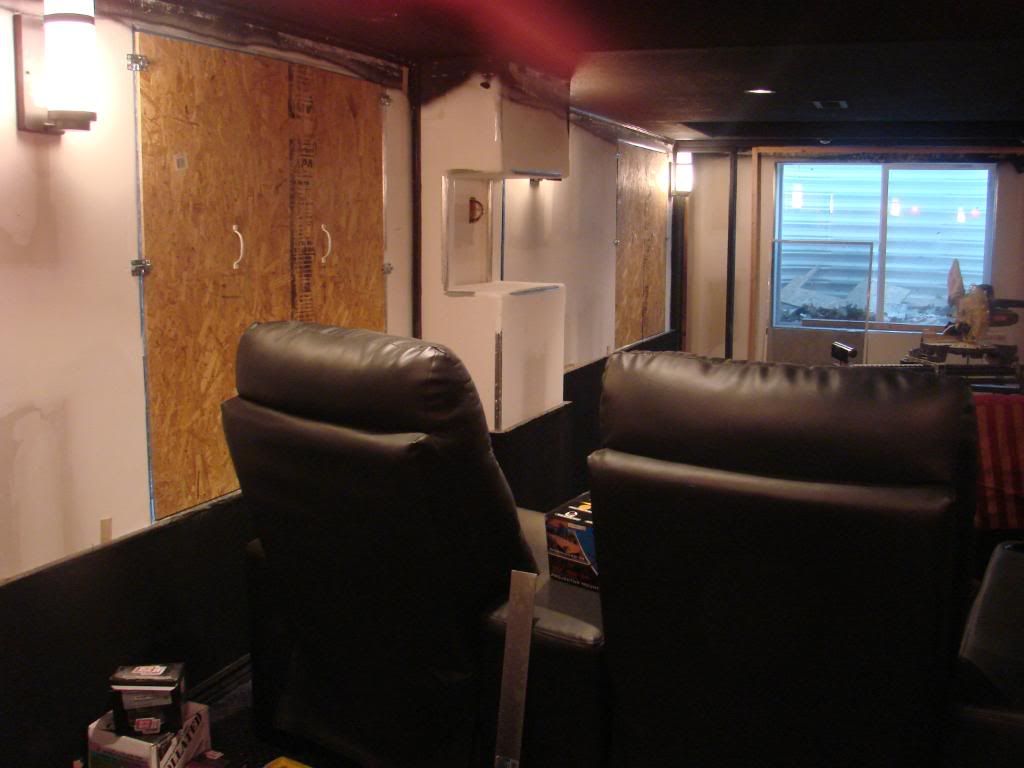

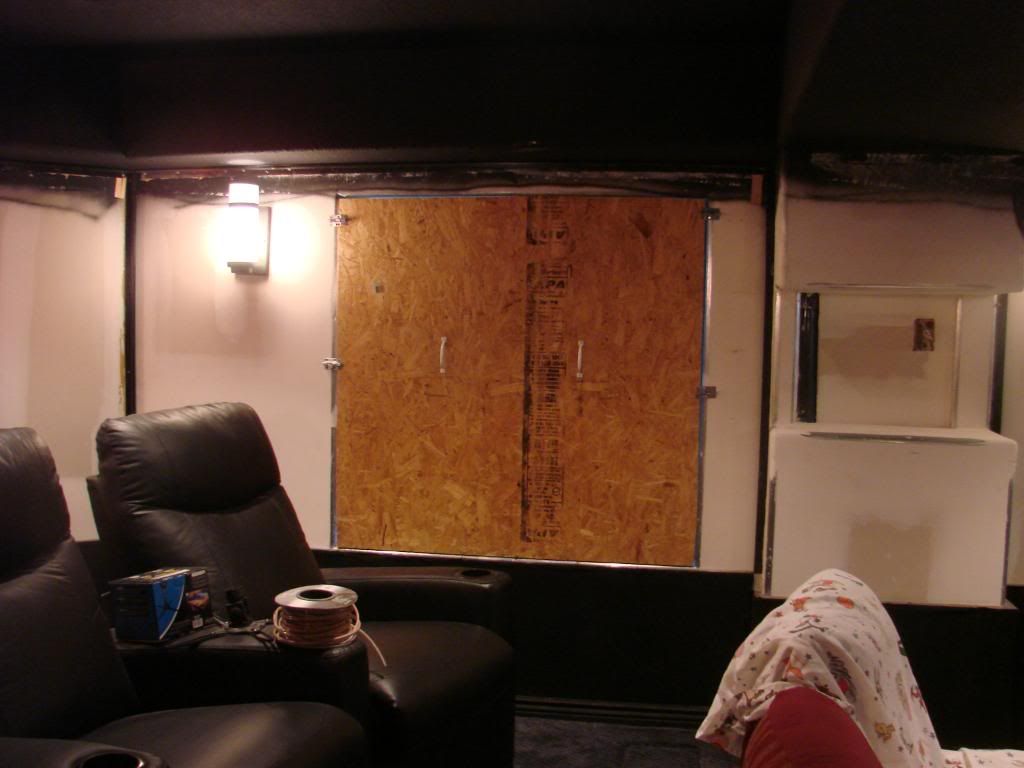

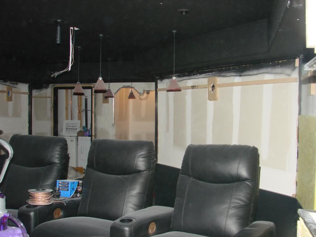

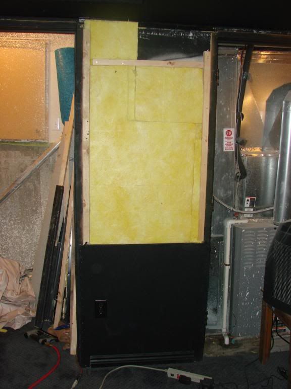

Now I had to become a little more inventive to think of a way of blocking my side non-egress windows. I did not want to close/board the windows permanently, so I used lighter sheets of 3/8" Plywood with low profile handles and the old fashioned door locks (with the swinging bar thingie)
Notice the First left window is now covered, but can still be easily removed using handles and 4 locks (nothing is blocked permanently)
Also I used a grey 1/2" lightly adhesive foam tape to seal any light coming through from the outside through the window/window plug border - Must have Cave Bat setting for my RS20 projector)

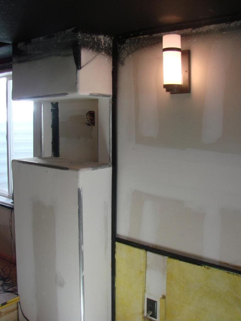

Now I had to disconnect all eleven wall sconces to do the 1" MDF round furring (as recommended by RMcveigh)
Then once all the round cuts where done and duplicated, I cut each furring panel individually - all I needed was a good jigsaw that supports curved/circular motion (cost was $35)

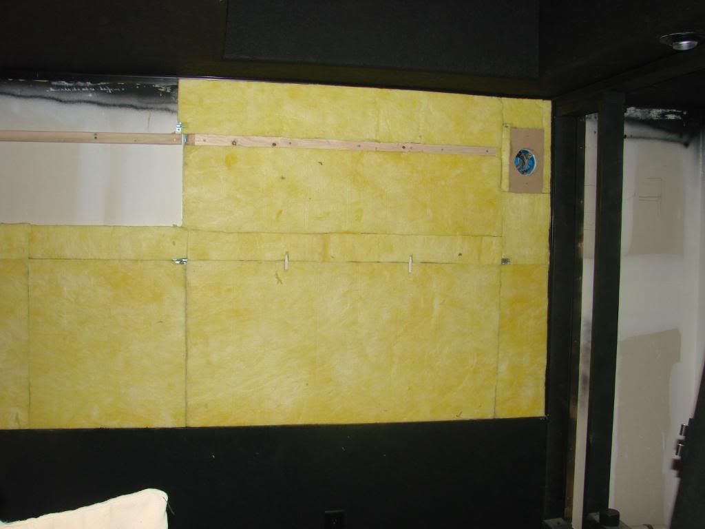

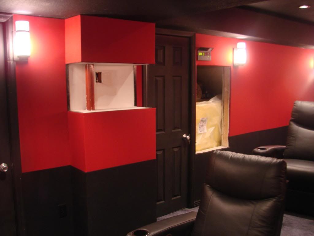

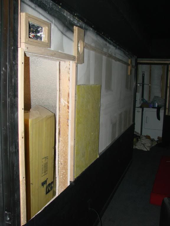

Continuing to upper wall furring and JM814 Sound treatment insulation above chair rail (NOTICE that I ran a 1" x 7/8" ripped studs horizontally across all walls at about a 72" height to support the mounting of heavy signage/posters, this way I never have to guess where the vertical studs are located once fabric is covering all walls.
I also installed a 24" x 20" panel of 7/8" on the wall incase I ever needed to mount a small LCD TV in the bar area)

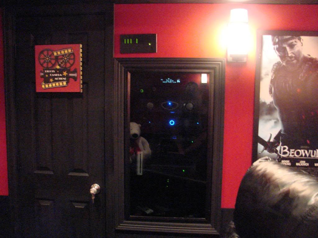

Furring around GrafikEye and AV Rack wall openning:

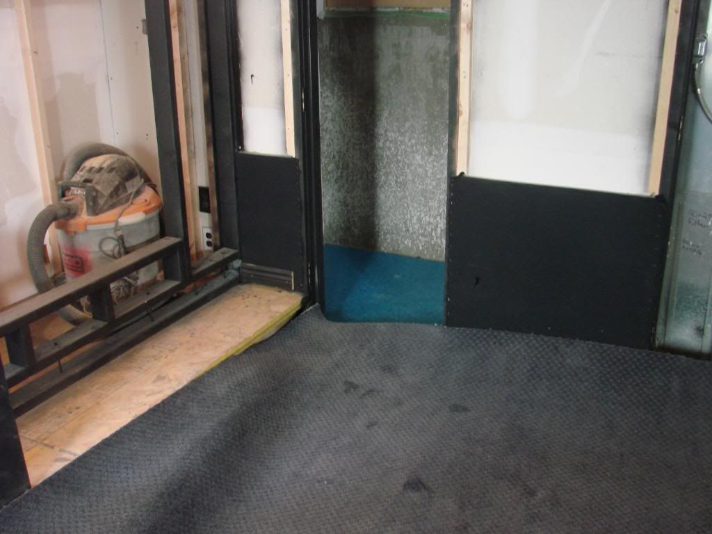

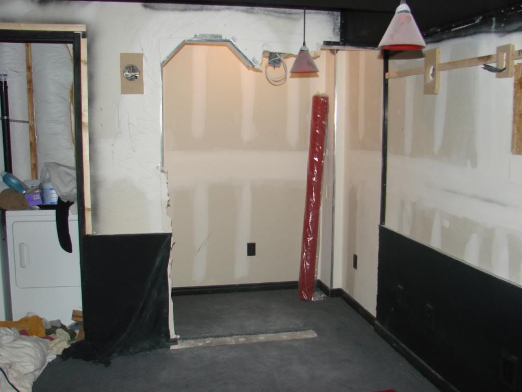

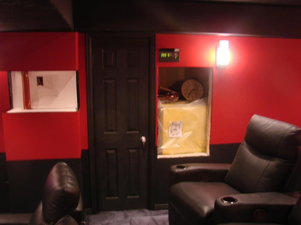

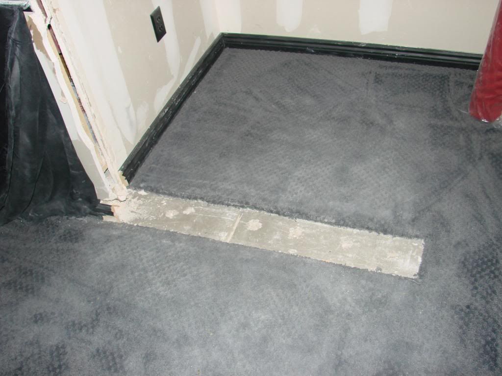

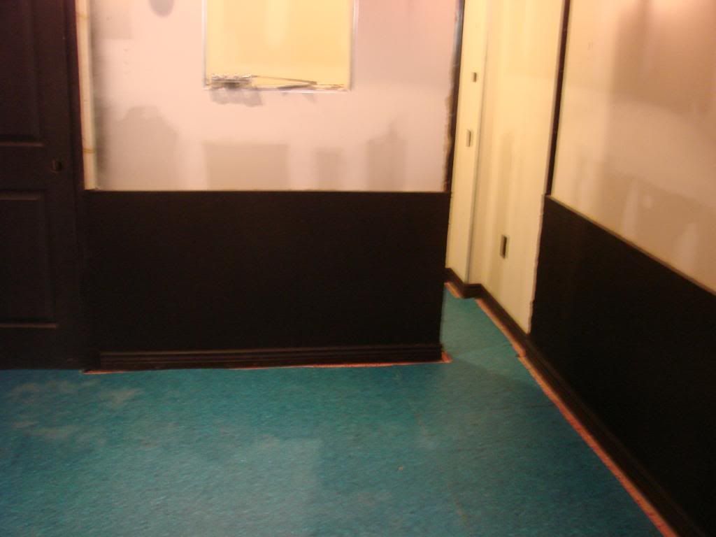

Now I had to make a difficult decision, which is to demolish a half wall and eliminate my very lame pseudo box office interior window idea, the reason why is because I was able to score a full size Arcade cabinet for $150 through a friend of mine, he had built it from scratch on his own, and after his divorce, he decided to sell it. And in order to incorporate my Arcade Zone idea, I had to make some room, so I demolished this non-structural interior half wall/window and opened up a nice 7 feet x 5 feet room which I will now use for ther Arcade cabinet, an electronic DART board, and possibly a small side food/concession area).
These are the Before Demolition Pictures:
Destruction in Process (I cannot deny that this was the most fun part of the theater construction):

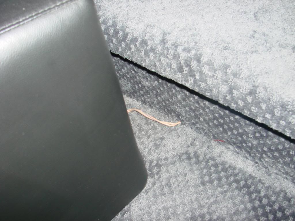

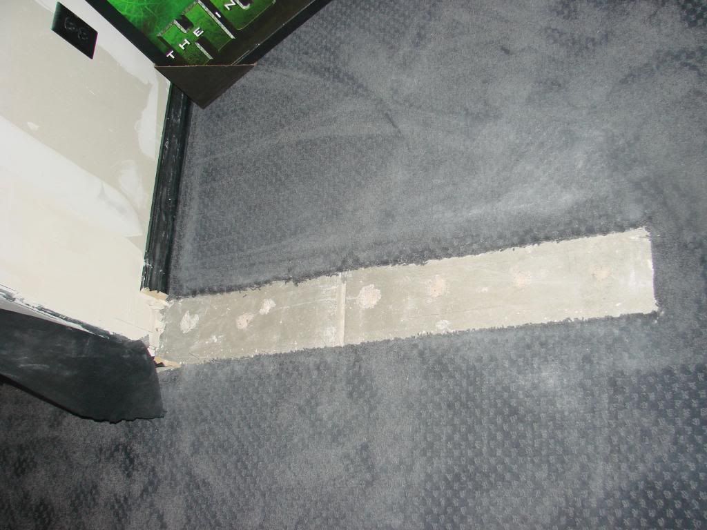

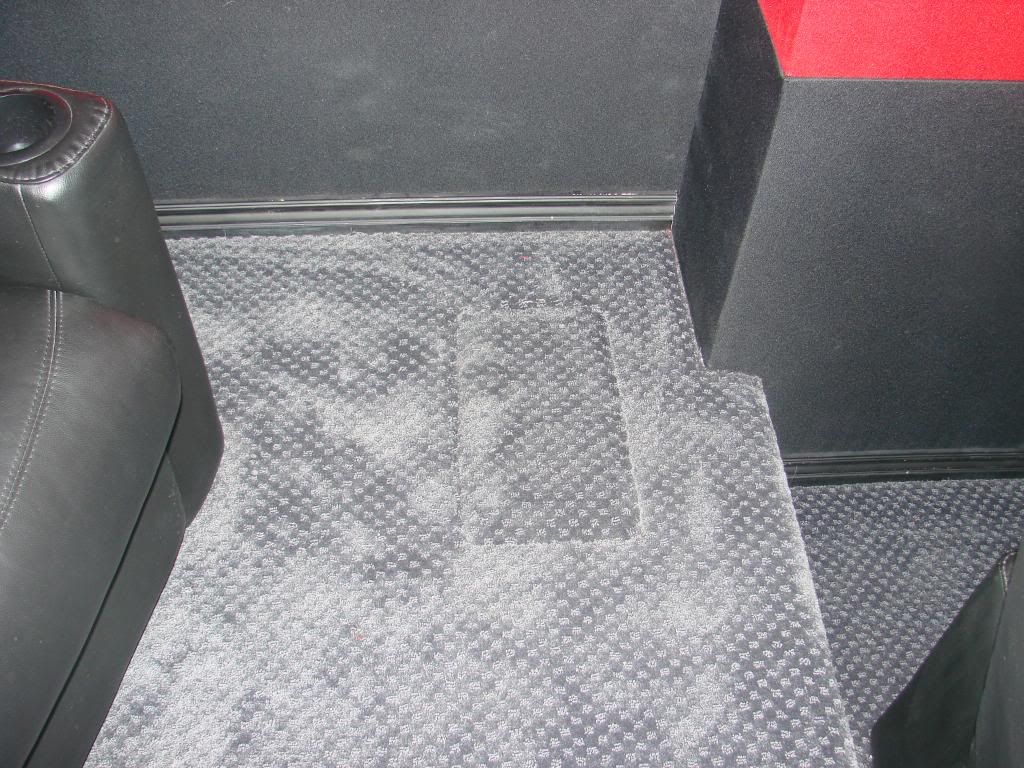

Now the debris is cleaned up (Notice Carpet gap which I will need to address/fix/patch) Also , my Drywall helper Jose, came out last weekend to smooth out /mud/tape the mess I created (Drywall repair not shown here)

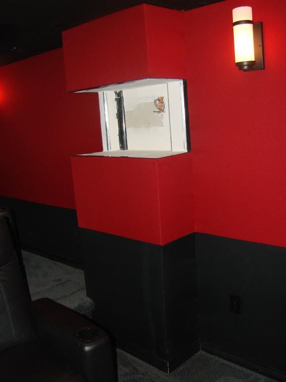

Fabric around GrafikEye & Sconce Opennings (Remember I had to use 2" Special Electrician screws on all electrical outlet boxes, sconces, grafikeye because of the 1" furring and 5/8" drywall)

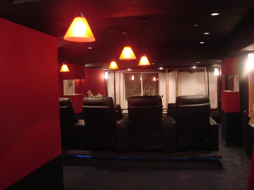

Now we're getting close to the semi-final product with the GOM Anchorage Red Delicious Fabric Installation on upper walls - Ofcourse like the rest of the lower wall area, I used both staples on furring strips around door frames, wall sconce and GrafikEye furring, and tucked fabric elsewhere inside track seams using a hammer and a nice firm puddy knife.
Now I will quickly roll through the most recent pictures showing the my current progress (This includes Fabric on all walls except Main Wall, Screen Wall, and the newly opened Corner area where the Arcade Cabinet will be placed, I still need to add track, furring and fabric in the next couple of weeks for that area. I also need to clean/dust off ceiling and touch up paint on ceiling, baseboard trim, and door trim and possibly repaint all 4 doors.

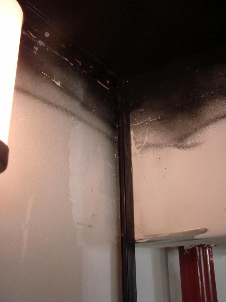

So for now, you may still notice/see some dusty/dirty areas in the ceiling, and on black fabric, and other areas in the ceiling and on baseboard and door trim which will need to be painted and touched up. I will do the final touch up once the theater is about 99% Complete.
Ok enough talking, Here we go!!!

AV/USB Box inside Riser (Carpeted)
Bass Shaker Wiring for Front Row (through riser)

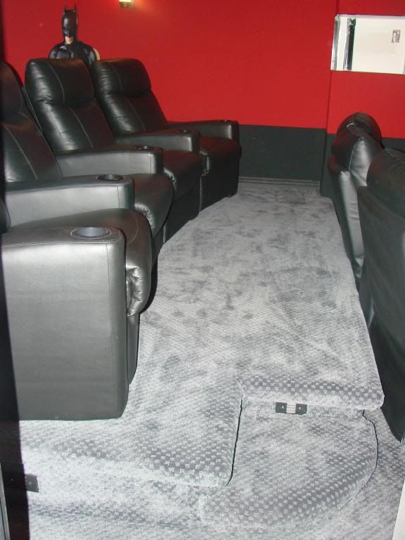

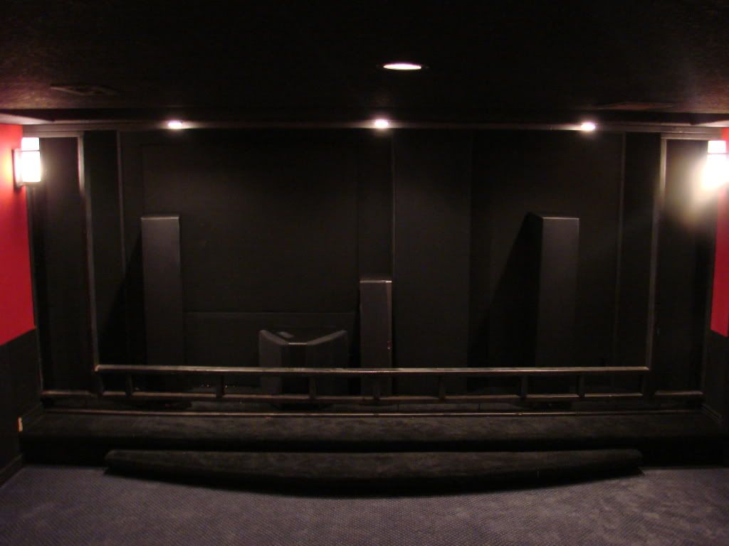

Stage Full Carpeted (Also check out the hidden powered USB compartment underneath the stage curved step - now carpeted)
Riser/Column Area:

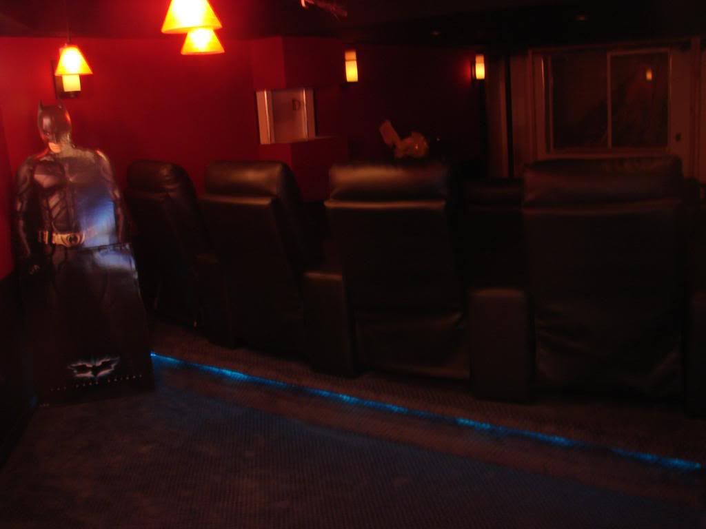

More riser pictures (Blue LED rope looselt hanging - not fully secure - Connected to Grafik Eye Zone 4):

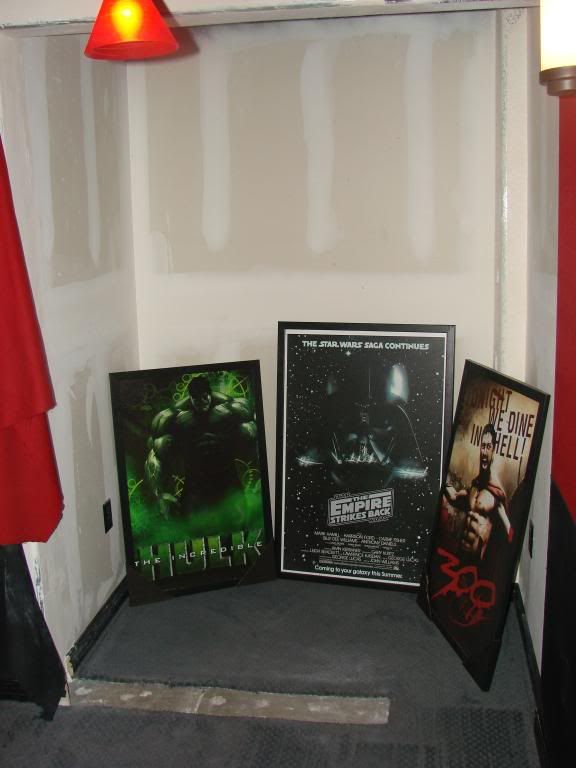

Still need to add fabric/track/furring and patch carpet in the Arcade Zone area (Drywall repair is done):

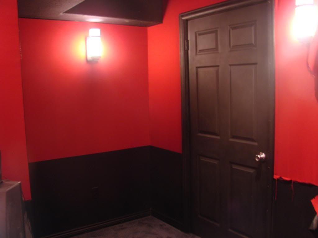

Custom Theater Sign:
Now to building the screen wall, finishing main wall behind screen wall, and finishing Arcade zone corner/area, not to mention connecting and setting up all the AV equipment (Last Updated 03/02/09)
NEW UPDATES (THEATER COMPLETELY FINSIHED On 05/01/09 - Exactly 11 months From start to finish)

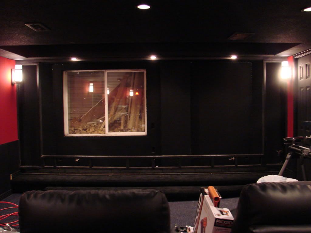

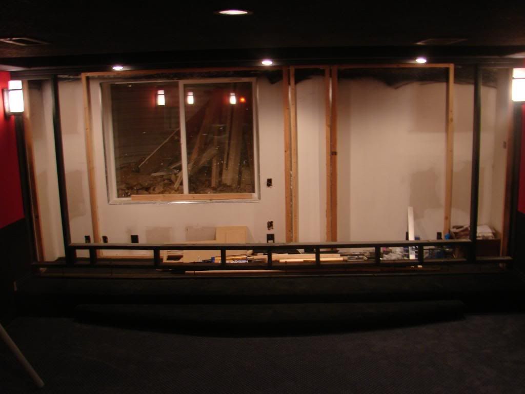

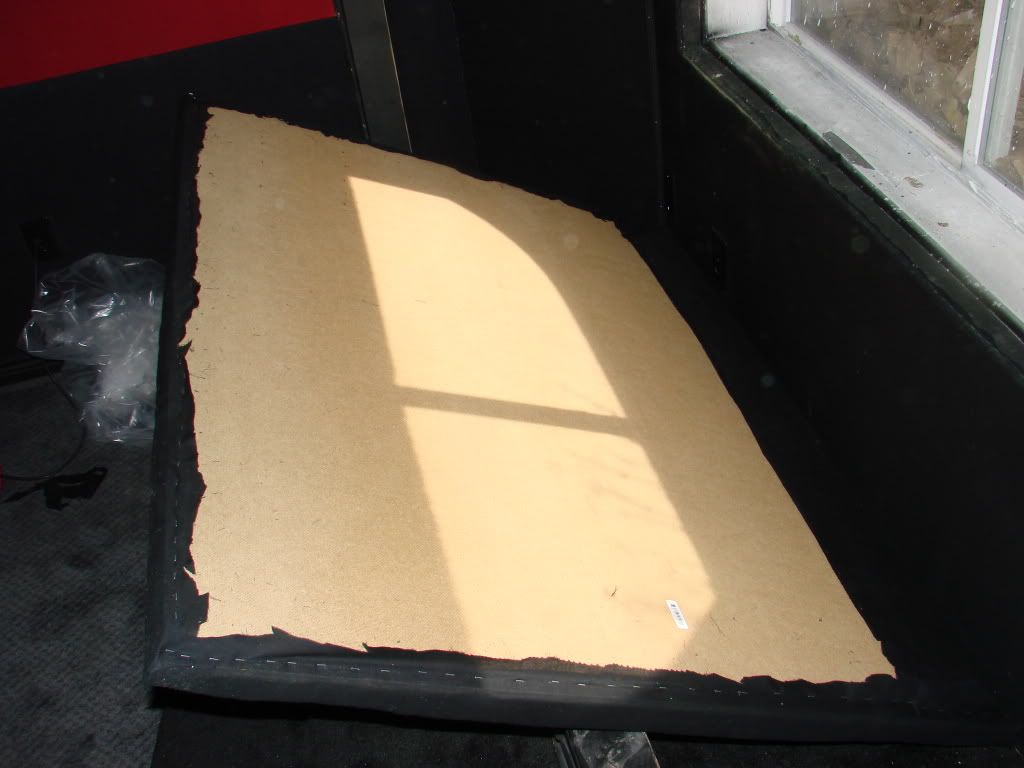

Picture of main wall through the open screen wall, as you can see the window is still open

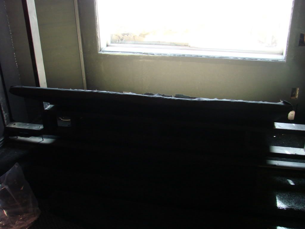

Building removable Window Plug using the thin paticle board which is used to cover the back of cabinet. I also used the 3M adhesive spray to attach the insulation to it, then wrapped it with the same broad cloth fabric and stapled the back side facing outside.

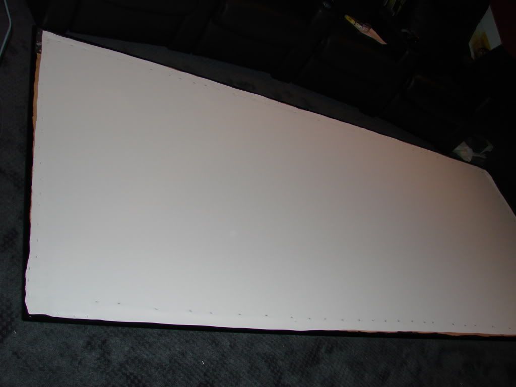

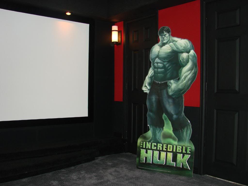

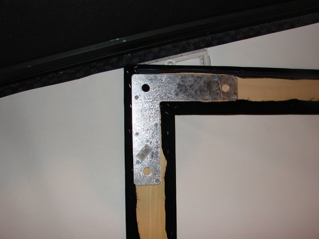

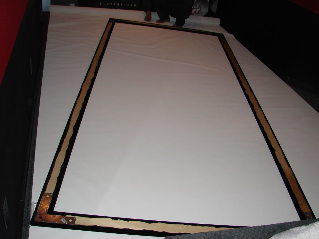

NOW TO THE SCREEN FRAMING STAGE.
I framed a 2.37:1 screen using a 96" roll of acoustic transparent fabric similarly sold by SeymourAV and SMX. I used a 15 degree tilted cut and framed the screen at 132"x 55.6". I used 4x1 Poplar wood which is more like 3.5"x.75". I cut the corners and framed them the same way you build picture frames and cut door trim. Just simple 45 degree cuts in corners. Then I covered the 4 frame pieces with black velvet and then attached them using heavy duty L-shaped brackets. The screen is currently mounted onto the top 2x4 of the screenwall using 4 heavy duty swinging picture hooks, allowing me to swing the screen upwards if I ever need to get behind the screen wall. That being said, I think I rushed with building the screen, and there are a few minor issues that I plan to go back and address. One of them is regarding center support. I chose not to include 2 studs to support the screen, and I think this is why the screen's height is off by a little less than 1/4" in the center. The other thing I noticed after I built and install the GOM Fabric panels around the screen is that the screen fabric may need to be stretch out a bit and there are some wrinkles around the bottom. So bottom line I will probably need to take the screen down and make some adjustment to the screen's frame, fabric, and possible adjust one of the 4 GOM fabric panells. But the problems are so minor at this point, that I may never get to revisit the screen issues anytime in the near future. Its one of those imperfections that no one else other than you will notice.
What you see below is the complete frame prior to the screen fabric installation.
The only other "in-between" pictures that I did not take were the pictures showing the Fabric Frame builds for the screenwall. I failed to take any pictures because I was in a rush to get the screenwall finished before my uncle flew in to visit us. So I quickly build the frames out of 1x1 rips and wrapped them with GOM FR-71 black fabric and they turned out pretty good. I may need to go back and restretch the black fabric on a couple of the 4 panels, but it looks pretty darn good already as of now. I built two tall side panels to go on the right and left sides of the screen, and I also built two smaller frames for the bottom of the 11 foot wide screen.

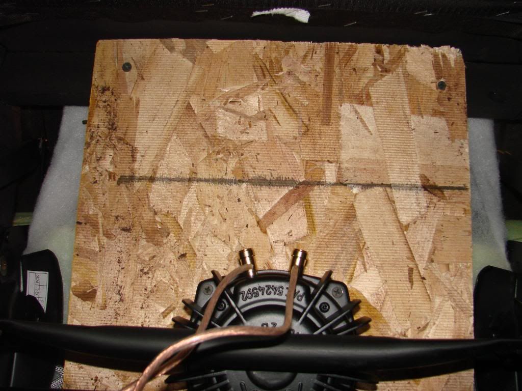

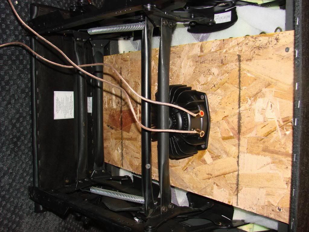

BASS SHAKERS:
Last, I just want to share with you how I installed bass shakers under each of the 8 Coaster Showtime Seats. I used 3/4" OSB boards and cut it to size (I think 15" x 30") and I mounted the OSB board underneath each chair and put in 4 screws in each corner of the board into the chair's wood frame at the bottom. Then I installed the bass shakers onto the board using 4 small screws for each shaker. Let me tell you, I don't want to even know how a movie or a game would feel without those suckers underneath each chair. The bass shakers are truly the main attraction in my theater. Anyhow, what you are seeing in the pictures below, is the chair flipped over.

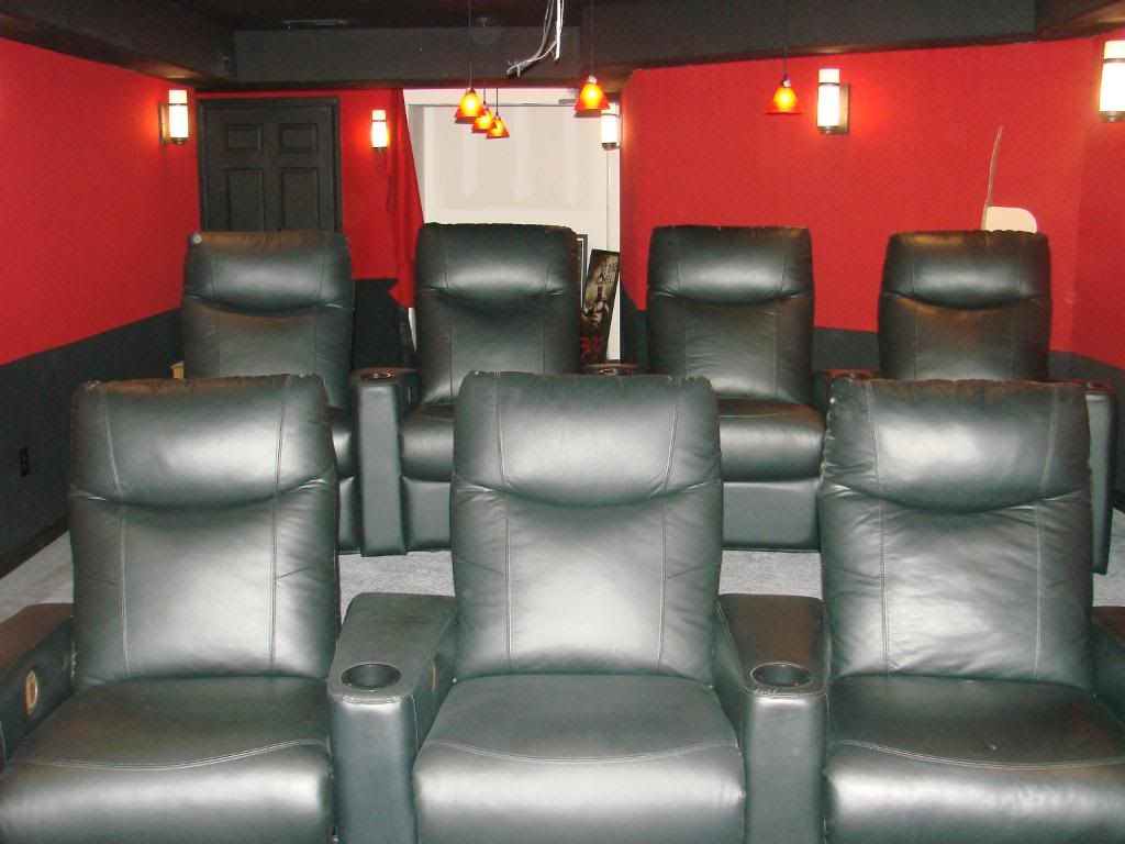

PLEASE ENJOY THE FINAL PHOTOS OF THE CEDAR PEAKS CINEMA! (Project duration 6/1/08 - 05/01/09)
That's All Folks!

- Ceiling Height = 8 ft at it’s highest and 7 ft at its lowest in soffit-ed areas around the perimeter of the basement and in center of the room due to HVAC runs.
AV Wiring:
- All AV and Misc low-voltage wiring was done through ¾” smurf and 1.5” resigard flex tubing with strings and cat-6 cabling running with all AV conduits.
- Wired for 7.2 surround sound w/up to two subwoofers in front and back)
- Wired for a multi-media port in riser which will include almost every AV connection you can think off (HDMI, Component, Headphones, USB, RCA composite, VGA w/ audio…etc). The multi-connection port will be housed within riser underneath a latched-cover (similar to what you see in conference rooms)
- Also pre-ran HDMI for a future small LCD in the adjacent bar area.
- Also pre-ran USB in ceiling for future StarPanel
Electrical Wiring:
- I paid for a master electrician to wire my basement and add a 100amp subpanel, he was by far the cheapest, and ended up being probably the best master electrician I could have worked with.
- There are multiple standard 20amp dual outlets throughout the room
- Also some special outlets connected to GrafikEye for future use of rope lighting, star panel, motorized curtain or masking, back-lit movie marquee posters…etc.
Lighting:
- The Theater/Bar areas will be well-lit, all line voltage lighting, however it will be 100% controlled via a 6-Zone GrafikEye 3106 unit, combined with a one-zone switch by main entrance for the bar/lobby area.
- 11 sconces throughout basement (6 in main theater area, and 5 in bar area)
- 11 x recessed 4” cans throughout ceiling
- 3 x recessed eyeball 4” cans above stage/screen wall area
- 3 x mini-spot back accent lights to point upwards to speakers stage behind screen wall.
- Blue Rope lights around two soffit-ed ceiling areas, and one rope light behind screen wall (will work on adding some crown molding at the very last).
- Riser lighting: I may add some kind of a step light or rope lighting for riser.
Walls & Ceilings:
- Back/Entrance part of basement will serve as a bar/lobby/concession area, which is small area adjacent and open to the main 22ftx14ft theater room.
- Pre-Construction: Concrete Walls and Floor and floor joist ceiling (16” OC)
- Used 2x4 studs throughout all walls (16”OC) over existing blanketed R-11 insulation
- Used R-19 Insulation between ceiling joists and inside soffits. And used R-13 insulation on newly framed interior stud walls.
- Used single layer of 5/8” sheetrock to drywall walls and ceiling (Due to room construction and proximity of stairs to walls, I was advised by many includingTed White w/ SoundProofing company against investing in green glue, RSIC clips, and Double Drywall, which would have done very little sound proofing the room in the way it was constructed (Luckily, it’s just my wife and I in a two-story house, so not being able to soundproof the ceiling was not a deal breaker to me)
- Bullnose was used throughout the walls and soffits to round edges and corners
- All walls are floating (code in Denver for concrete basements)
- Maximum Ceiling Height is 8 ft, however there are some major HVAC runs through the center of the theater area forcing me to soffit in center of room at 7 ft height (see pictures)
- Ceiling was originally painted flat black without any texture, and with the ceiling being low at 7 feet and 8 feet, it was very easy to spot the imperfections in the drywall and paint patterns. So in order to hide ceiling imperfections, I decided to have ceiling and all soffits textured over existing black paint with knockdown technique, and had it repainted again in flat black
Windows:
- Two standard 48x48 framed windows on left wall, one 60x48 window on main front wall.
- I plan on somehow concealing all windows with some kind of semi-permanent but removable square framed panels to be inserted tightly within window framing (using 2”x4” frame with a rigid insulation or drywall top panel covered in fabric). I am not sure how and if I can do it, because I will need to treat all walls and lay fabric, and I was hoping to make the Window treatment appear seamless where you cannot spot the windows, so I am looking for suggestions.
Doors :
- All doors are on right side wall - no doors have yet been installed.
One 36x80 door in back of room to conceal laundry area
- One 36x80 door on right wall to conceal mechanical and HVAC area
- One 24x80 door to access AV area underneath stairs
- One 24x80 door to access an unfinished 8x 4 area where you can also access area behind AT screen wall.
- Existing 30x80 door to basement.
- I am not sure how I would treat the doors or if I should treat them as the walls with JM814 and GOM fabric. I have seen it done, so I am open to suggestions.

DIY AT Screen:
AT screen purchased from Interior Mall website similar to the same fabric used by SeymourAV and SMX. Width will more than likely fall between a minimum of 10 ft and a maximum of 12 feet at with an approximate CIH of 50-60 inches. (more than likely I will end up with a 10’-11’ wide 2.37 screen)

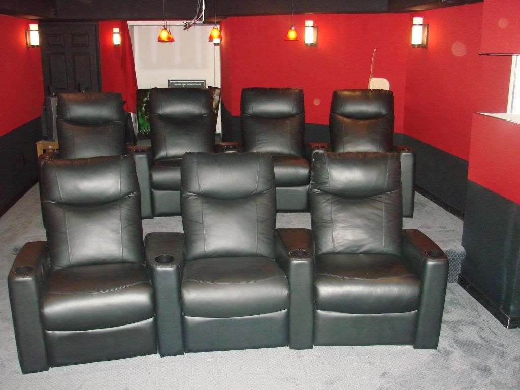

Seating:
- Black Coaster Showtime Home Theater Seats (www.hometheatersupplies.net)
- 4 in front row wide w/ center love seat configuration, 4 in back row on riser at full 134” width
Color Scheme, Wall Treatment, Wall Fabric, Paint, Carpet, Signage, Theme:
- Working with Bryan Pape to properly treat my walls with 1” and 2” JM814 2’x4’ panels.
- Plan to use black GOM for lower 32” Chair Rail level (Anchorage-Onyx) and Red GOM for upper 52” area (Anchorage-RedDelicious)
- I will use FR701 black on main front wall and screen wall.
- Carpet will be a red color (medium-dark red) from Lowes.
- Ceiling and all soffits with knockdown texture have been painted flat black using Behr Disney Mouse Ears.
- We are going for a classic Coca Cola Black/Red theme (Black Seats, Red carpet, Black/Red walls, and black ceiling/soffits).
- There will be plenty of classic Coca-Cola signage along with movie posters and general theater signage.
Other equipment (non-AV)

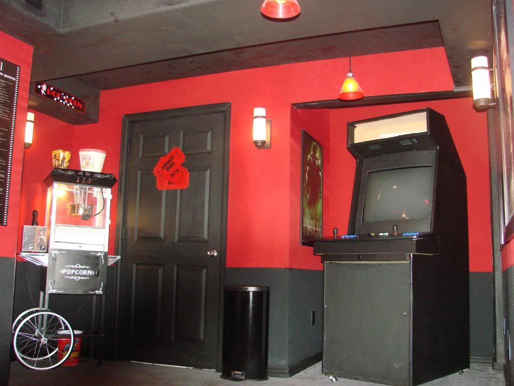

1. Maxi-Matic EPM-400 8oz Popcorn Maker (black)
2. Plan on building an L-shaped bar soon
3. AV Rack (standard 1U/2U 30-space rack I bough on CraigsList)

Question about building the riser/stage:
I have seen some people build their risers and stage using pressure treated green wood, and I have seen others use roofing felt at the bottom, and instead use your regular lumber (2x8, 2x10, 2x12..etc).
I really want to avoid the extra expense of buying greenwood. I have a concrete basement, can I simply go with the the regular non-treated 2x10 lumber, use roofing felt at the bottom, and two layers of 1/2" inch or 1" plywood on top?
damnsam77 is offline
post #26 of 275 Old 09-17-2008, 11:30 AM
JOHNnDENVER's Avatar
Posts: 13,434
You can.. Especially in this semi-arrid climate here....
Very little chance of flooding anyways.
I have helped a few people and never used green / preasure treated lumber. Most people around here don't do dricor(sp?) floors.
Of course it never becomes a problem until it becomes a problem though.
I elected not to do a stage and my riser sits on cinder blocks. I used contrsuction pine everywhere. I had intended to paint it all / cover it, but it adds to the feel of the downscale theater feel, so my wife elected for us to leave it all unfinnished even.
JOHNnDENVER is offline
post #27 of 275 Old 09-17-2008, 01:37 PM
Chiahead's Avatar
Location: Parker Colorado
Posts: 1,637
Good to see the thread up and progressing. It's fun to see the threads that have alot done when they originally post, it seems to go so fast that way. My thread starts at the begining, so it seems real slow, just have the floors done and starting the walls.
you don't need to block the windows, just leave the trash in there, and they will eventually block out the light...
As for the green wood, you only need PT if you are touching concrete, so if you put roofing felt under you should be fine without. besides that green stuff has some really nasty chemicals in it, and it will eat through most hardware, including some of the galvanized stuff. You would need the double galvanized stuff to last. So cheaper wood, and hardware, and less chemicals is always good.
Michael
PSN: Chiahead
Chiahead's Man Cave - Indexed
Loganed on 8/29/2008
Chiahead is offline
post #28 of 275 Old 09-17-2008, 01:44 PM - Thread Starter
damnsam77's Avatar
Location: Beautiful Colorado
Posts: 2,317
Thanks Michael, I think this is probably the way I will go, just traditional pine lumber for both stage and riser.
Very funny about the trash in the windows...lol, I know one day I am gonna have to dispose of all of this construction debris, definitely before the final inspection, as they won't pass it if the egress window is blocked.
Since you brought up the window issue, I am open to suggestions on how to properly block the windows, as I am plannting to cover the entire wall and blocked windows with GOM fabric

post #30 of 275 Old 09-17-2008, 02:18 PM
javadoc's Avatar
Location: Parker, CO
Posts: 419
I was toying with this yesterday too, because I need to put a sconce in the window opening, for symetry. Solution: framed over the window! You don't need it for egress anyway, right?
Scott - I am one of many. You shall be assimilated
