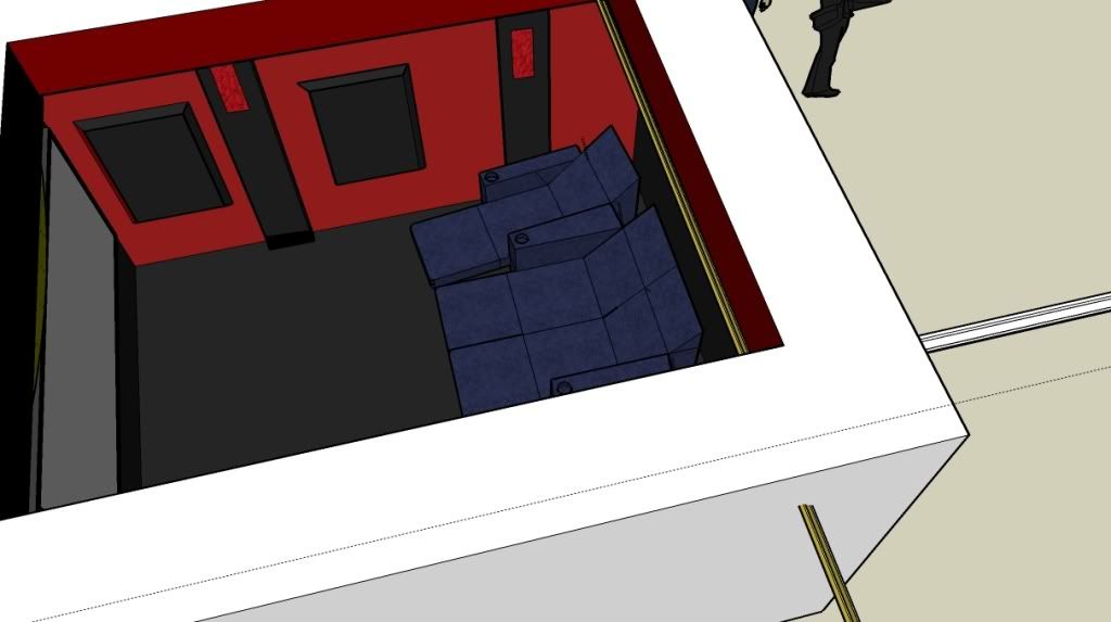

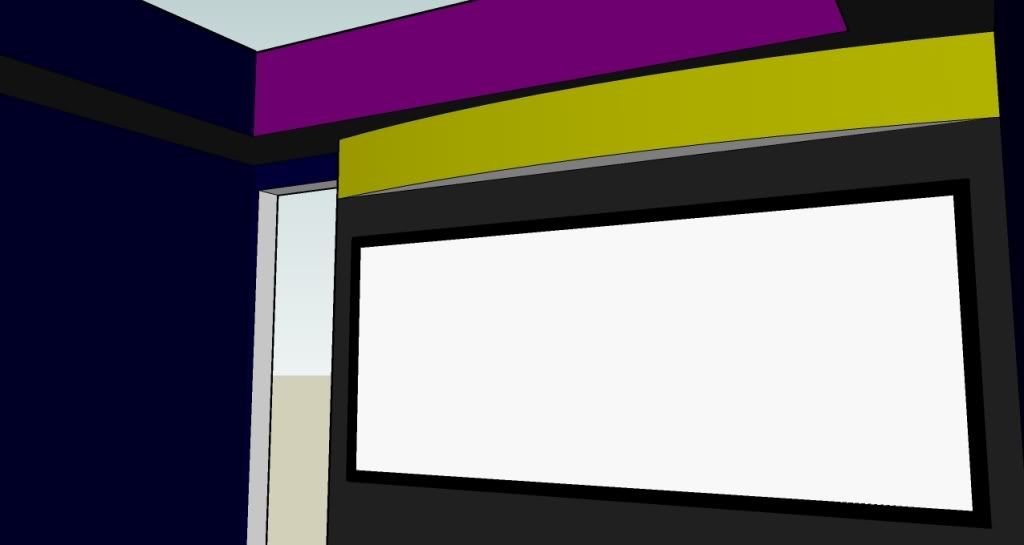

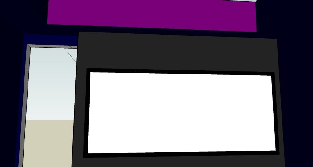

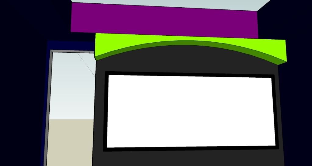

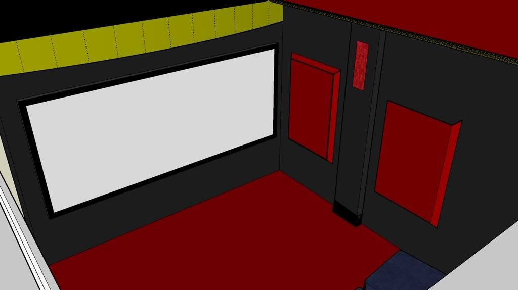

First design issue:
The screen will be offset by the door - do I go for a marquee that is centered to the room, or centered to the screen. The soffit will inset to the screen area on the right side of the front wall, it won't come out all the way on the left side (will end over the door.
Sketchup is a great tool. I think the solution is to come down under the soffit. The screen is 2.35, so height isn't a big issue, and the room is tall. So what do people like better, an arch
or a curve?
The colors are just to make it pop, so ignore those. I had the curve in the last one, and liked it. Would be willing to mix it up. Or entertain different ideas. I guess I'd go with a square stage with the arch, and mirror the curve in the stage in that option.
dc_pilgrim is offline

My HT is almost the same size. I went with Quietrock in order to save precious inches on the sides, and am glad I did because it is tight with 4 Berks. I don't often have squeez back behind the seats, but when I do every inch counts, and they are not particularly stable so crawling over them could be interesting.
You may be more upscale than me on the audio, but I went with a 7.1 system (actually wired for 7.2, but that seems overkill). For the front 3 I used the Axiom M22s (bookshelf speakers). I had planned on using towers but the Axiom guy talked me out of it. The sound is great and that may be an alternative to low profile speakers. The axiom guy also tried to talk me into just a 5.1 system given the size of the room, but I did not listen.
I also went with a square stage with an arc extending out on the bottom level of the stage. I think it makes the small space look more flashy, in a good way. I had planned on a matching arc on the ceiling, but ended up scrapping that idea because I was worried about making the ceiling look too low visually. I ended up with a tray ceiling in the middle of the room due to some miscommunication with the contractor who was renovating my basement, but I like the tray ceiling and in retrospect would have liked the ceiling arch -- I have three spots along there now, so I won't be doing any retrofitting.
My screen is a 50" high 2.37 CIH. I had an anamorphic lens but because of the screen size and short throw, the throw ratio was too low to use the lens, so I sold it and now zoom. My miscalc was due to using 1.78 numbers when determining the ratio, and you are too smart to do that, but still beware the small ratio.
If the door placement requires a smaller screen than you want, perhaps you could put the screen on a slide rail so that you can move it to the side when you need to enter/exit the room. Then your stage and screen would be centered across the room during viewing.
If your target date is 2009, then you still should finish ahead of Logan. I sub'd too much out to qualify as a DIY, so I just don't feel right about calling him my beeyatch, but I am happy to watch you do it.

Interesting about stability on your berks. How do they come apart? I know they are modular, can you just slide one out? The chairs will be in the way of the electrical panel, and I was thinking I'd just pull one out when needed.
I *could* move the door. And probably would, but it has poor WAF. I would probably fight the moving the door fight before I would design a screen that has to be moved to enter and leave the HT. But I did think about that, or a drop screen. Not worth it. Move seats closer if I want it to be more immersive.
That's a pretty big screen you got for a small room. Nice one!
I might start in 2009 - Finishing is another story. No need to poke the Logan bear (yet).

Dave I like the curve, but like you were with mine I'm impartial
The foreign made berks numbers begin with 13's dont lock together, they simply are placed next to each other. The us made 45's lock in together. I know av noob means about stability, if the chair is reclined and the person sitting in them leans foward and puts all their weight onto the foot rest, the chair is going to lean foward with them. My daughter was waking up from a movie and did this, luckily Dad was there to save the day
Now, I've been thinking Dave and I'm sure you have tossed this around in your head more than a couple of times but, if I had the same space to work with and I were putting 1 row of seating, I think I would put the seating at the wall which is right of the door when you come in. I would either have the door swing out or move down the door that wall a couple of feet, shouldn't be more than a couple of hours work to reframe that door opening. 13' is plenty of space for 4 berks 13175 or something along that line, still leaves over 1' at each side even more if you do a love seat in the center. Then you could do a bigger screen, at least 120"-130" diag. at 15' or there abouts you'll be golden. Just my 2 cents... Something else to think about, sorry

Oman - Yeah, that was my original plan, but throw and the seating had me re-thinking it. I was using Berks 090 as baseline chair, but I have seen your posts about your seats, and they are quite a bit more narrow. Wouldn't fix short throw, but worth considering. As for screen size . . . Bigger is better, but I'd be satisfied. Mostly I'd want to build a theater I am proud of, so aesthetics and performance are factors.
Since sconces are going to be a wall element to replace columns, I went and looked at Hubbardton Forge, since they always have the coolest stuff. Not really remembering its cool stuff that I can't afford. Feel like clawing my eyes out after seeing these ($250 a pop and I'd want at least 6):

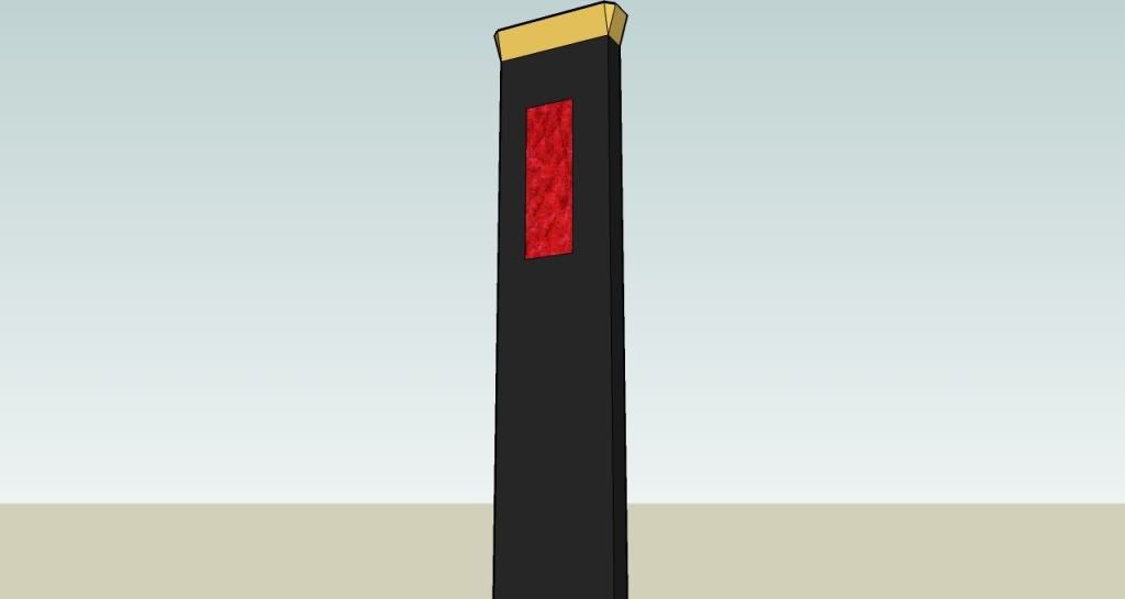

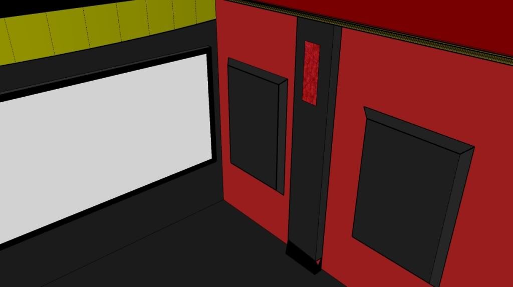

EDIT - Decided to go a different direction than the onyx columns. Still planning low profile columns though
Contemplating marrying low profile columns like these:
http://www.avsforum.com/avs-vb/showt...=#post15484799
With the translucent onyx similar to these sconces:
http://www.avsforum.com/avs-vb/showt...8#post15321708
I would probably go with it as an inlay in the column, maybe something like this:
Would switch to a red, black and gold color scheme, since the marble onyx tiles (based on google) seem to more prevalent in honeys, greens and reds than blue. This design would take an 18"x12" tile and cut it to 18" by 6", then the column is 14" wide, 3" deep, enough to add a light source, and probably include a power outlet as well. Then run red rope light in the crown that would flank the soffit.
I would need to add cans or puck lights under the soffit, since most of the lighting I like is accent oriented (accent sconces, rope, star ceiling).

Posts: 4,825
EDIT - This design was decided against but might be interesting to some readers
God, I am terrible at sketchup.
Quickie of the new columns & color scheme.
Up high
I kicked around flipping the other way to avoid the door on the screenwall, but it just creates planning issues around the electrical panel access, and limits seating choices. Been there done that. There is only one row option, its a small room. I need four across.
EDIT - flipping the color scheme -

darkpixie08's Avatar
Posts: 67
It looks like you have a great start. Although I will never forgive you for posting those sconces up. Man, those are sweet. I may now have to make my own sconces, and it will be all your fault.
Thanks, and err, sorry post pics if you DIY them.
