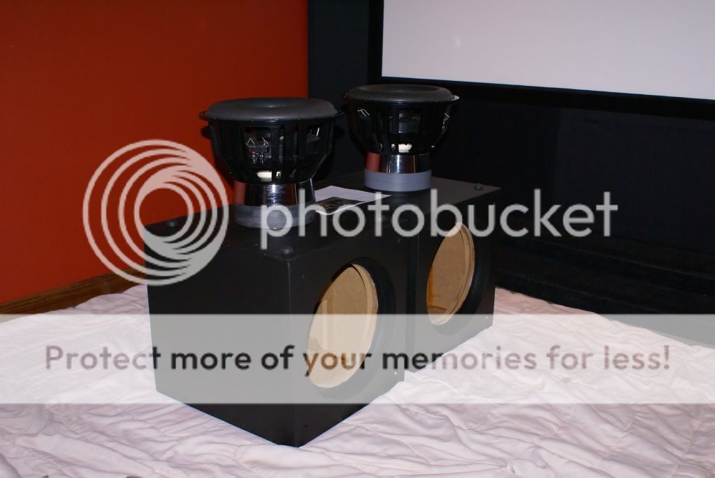

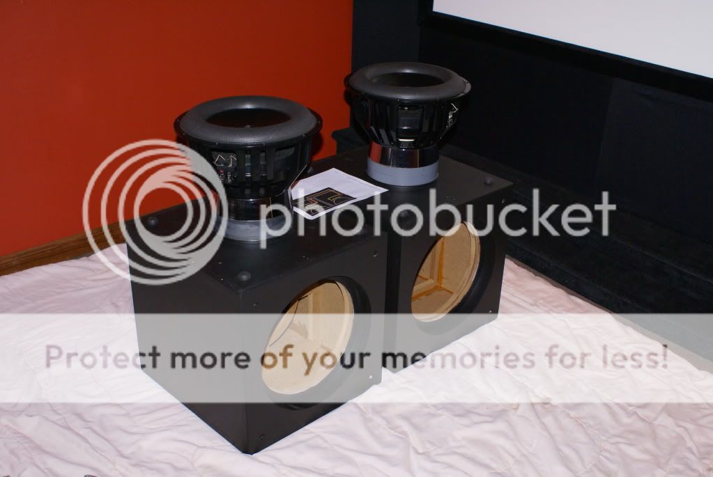

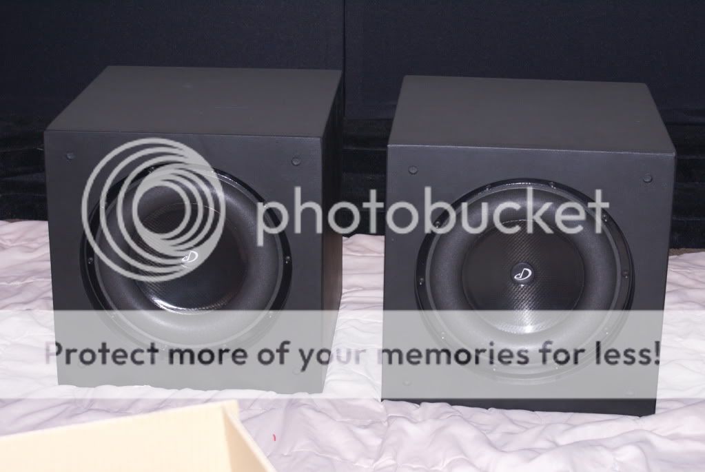

I can finally cross one of my ongoing tweaks off of my list. I finished my DIY subs and snapped a few pics along the way. Recall, I lost my pre paint build pics in early January.
The sub is the DIY P7S-650 sealed sub from Elemental Designs (eD). The P7S-650 is the eD A7S-650 dual sub split apart to house each driver in its own cabinet, with one cabinet holding the LT/1300 amp that powers both units. Each box measures approximately 18.5x18.5x23.5 (HxWxD). I choose this style to get the spec'd performance of the A7S-650 in a package more fitting of my space. The P7S is still a beast, but splitting up its weight made it a bit easier to maneuver into position without destroying my stage, false wall, screen and more importantly, my body.
On to the pics
Here are the boxes as they dried after two coats of Mickey Mouse Ears black in satin. My wife added a third coat later.
Here is the driver - the eD 13Av.2. A very impressive piece of equipment
Here is the amp - the eD LT/1300. I had to wait quite a while for this so it didn't stay in the box very long once I got it.

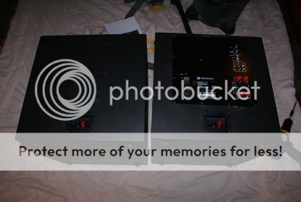

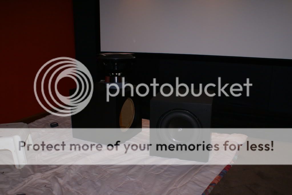

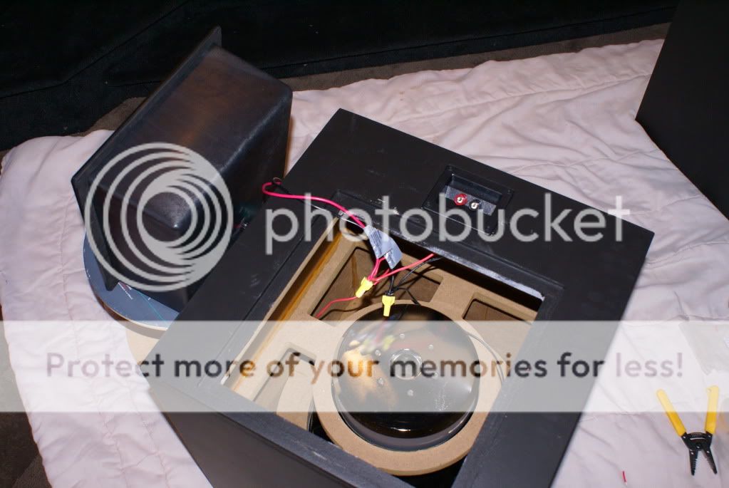

Here is my miniature eD production room. In full appreciation of the weight of the individual pieces, I decided to build as close to the final position as possible.
Since there is no large opening on the back of the box without the amp, I connected the sub wiring and passed it through the terminal opening before attaching the driver. Dropping in a 60lb sub is not for the faint-of-heart. After lining up the eD logo on the driver with the bottom of the box and centering the driver in the box opening as close to the edge as possible, I let er rip anddropped the driver into place. With a mighty THUNK!, it landed in position. A few pilot holes and a handful of screws later, I had this:

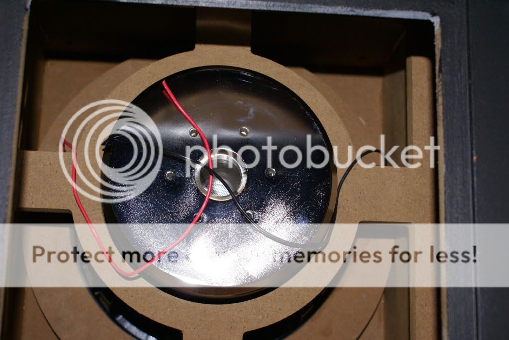

One down and one to go:
After dropping in the other driver, wiring the amp was relatively easy
Lots of room to work in here

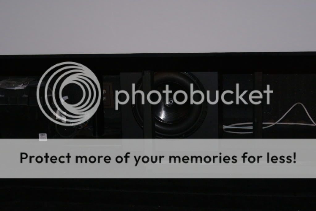

Another round of pilot holes and another handful of screws on the back side yield this:
From the front

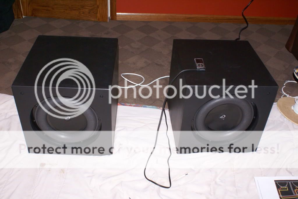

On to the QC and testing area. A length of speaker wire to connect the units, the power cord for the amp and an Ipod for some bassBOOM, BOOM, THUMPBOOM, BOOMTHUMPBOOM, BOOM, THUMPBOOM, BOOMTHUMP!
Welp? Out with the old, in with the new
Here are the subs behind my false wall

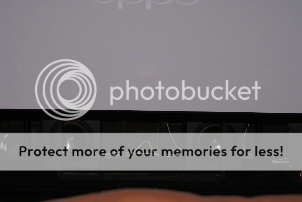

Here is a slightly better pic showing the front sound stage through the screen
Not the best pics - I know. But, at least I didn't delete them from the memory card this time!
The P7S-650 sounds good to me so far, but I just picked up a Radio Shack SPL meter to try to get the best sound I can.
