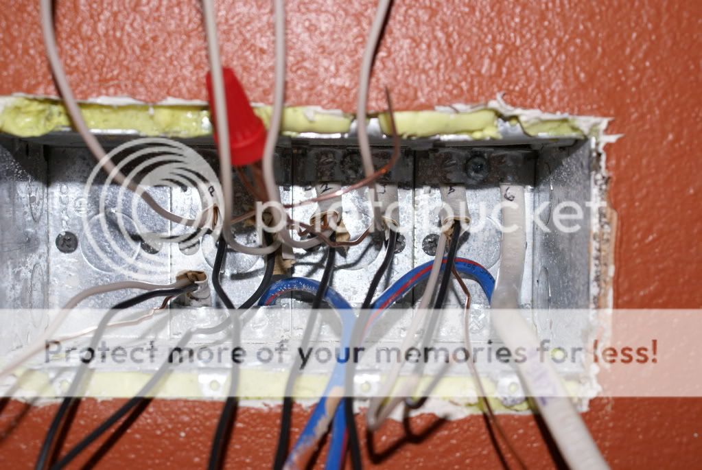

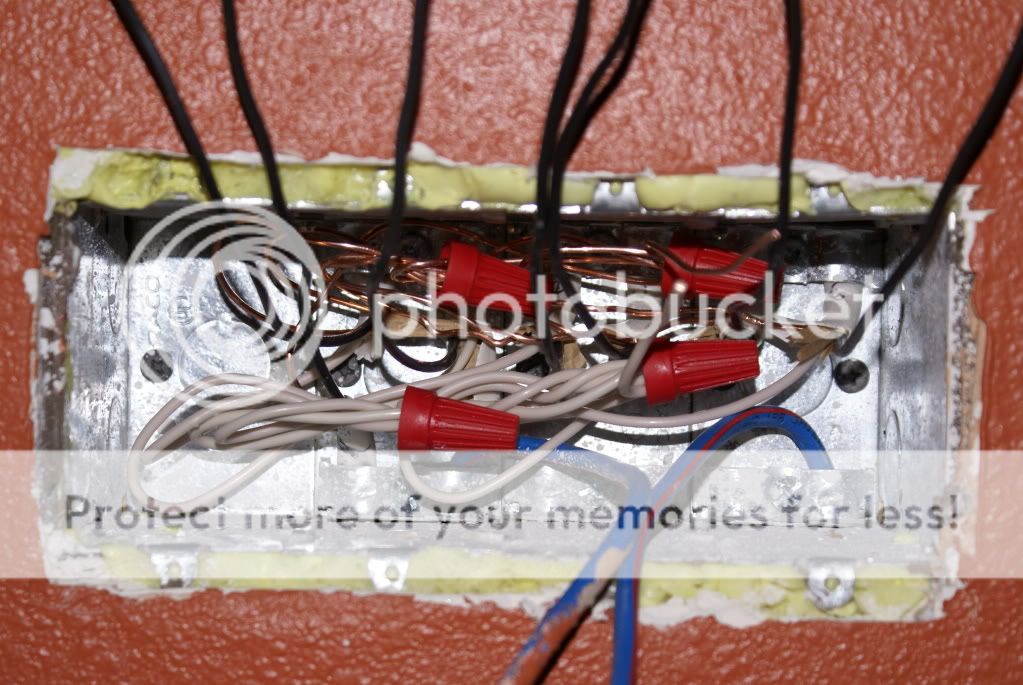

I built the sound boxes exactly as you described them. In addition, I used liquid nails to glue the edges of the box to the 1st layer. Then, I added a couple of screws through the 1st layer into the wooden part of the box.

I wish I would have done this on my sconce boxes. I thought I would be able to fine 1inch deep pancake boxes with enough volume...not! I need to carve a bit out of my second layer of drywall. Not sure how this will go but think I can manage with my rotozip and chisel

Perfect, I had been thinking about how to handle this, and using the old work boxes are the missing ingredient. I kept getting stuck on how to attach the new work electrical boxes to the sound box.

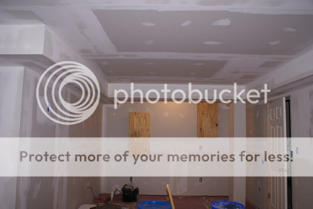

After tetering on the edge to doing it myself as well as interviewing and researching 6 different finishers to mud, tape and texture, I settled on hiring this step out. Since the beginning of my HT planning and research I intented to hire out this stage - see post #2. Oman got me fired up and seriously considering doing it myself. But we found a great guy with solid references, BB certification and a great quote. He's getting started...
HT front
HT back

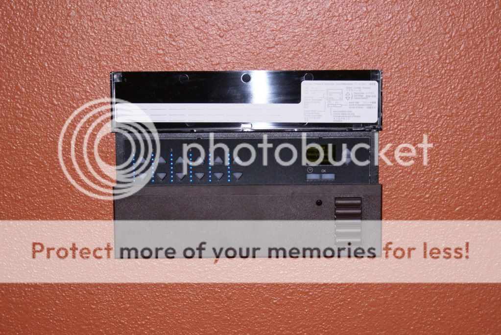

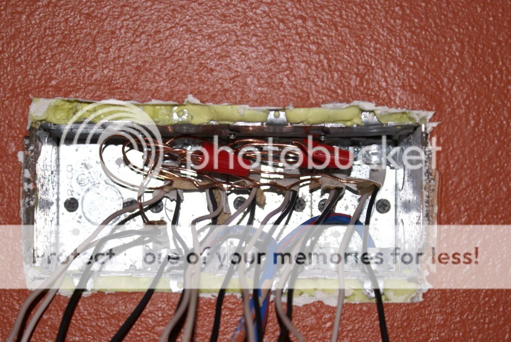

Over the next week, I plan to prime, paint, install the sconces and dricore and tinker with these...
You guys have mentioned tips and tricks for installing the GE. Any suggestions here?

Ah my Grafikeye hasn't come in yet Looks good man! IMO drywall is best left for the pros it will look good and most importantly be done soon!

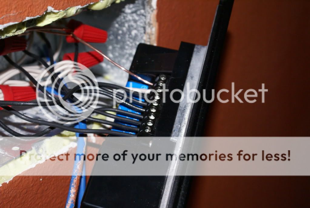

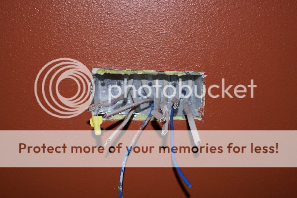

Make sure to remove all of the plastic jacket off the romex in the box when installing the grafikeye. Once I did that it went in pretty easily. Also make a plan for how you are going to connect all of the white wires together before you start any of it. If you need a hand or run into problems feel free to email/call me.
Thanks for the tips Guam. Hopefully, I can give the install a shot later this week.

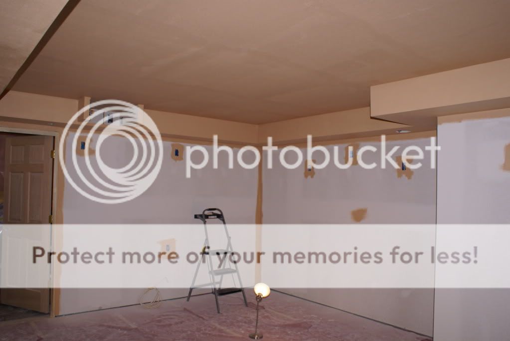

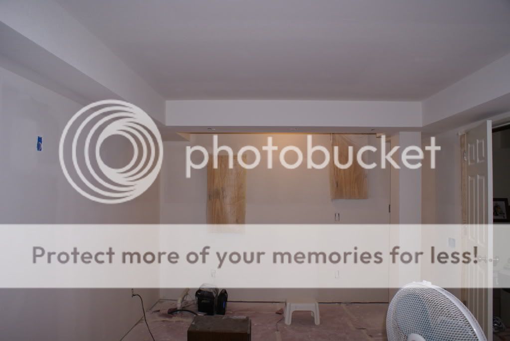

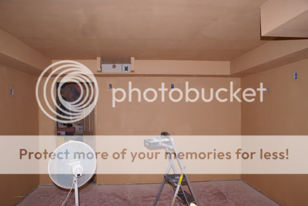

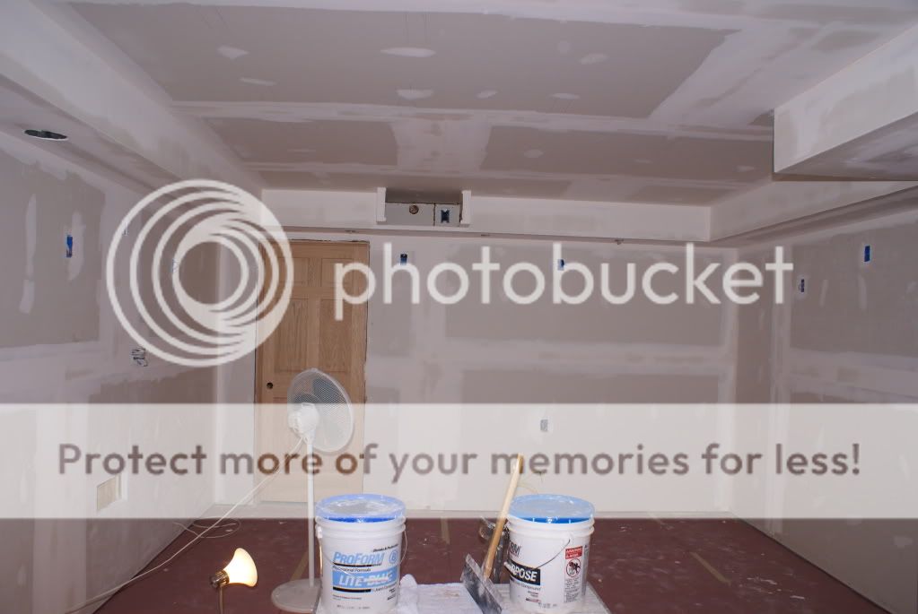

The drywall finishing is complete. I'm glad we decided to hire out this step. It took 4 days...

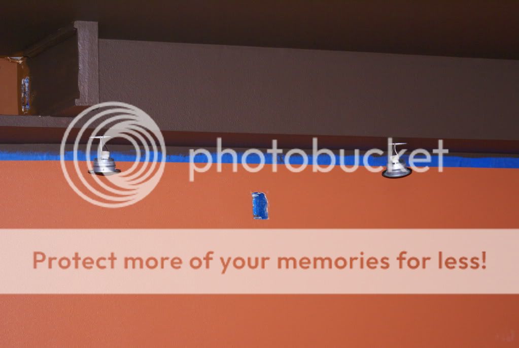

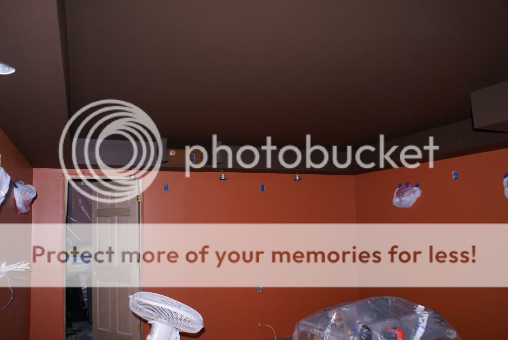

Paint time. My wife and I were excited to get started.
Walls are Faded Clay.
Ceiling and soffit bottom are Rootbeer.
Primer going on...
Ceiling and soffit trim
Walls and soffit face
Another coat of each should do it.

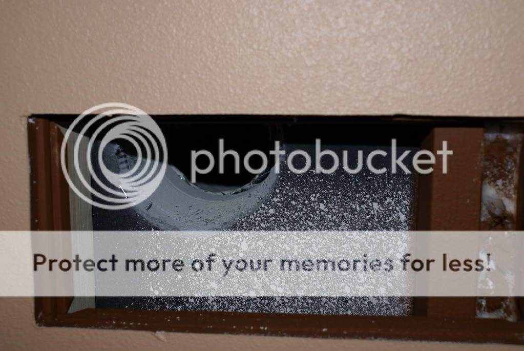

I noticed that my linacoustic got splattered with the drywall texture. Doesn't seem like a big deal. Is this something to be worried about? I have a little linacoustic left that I can replace it with but I need to find it.

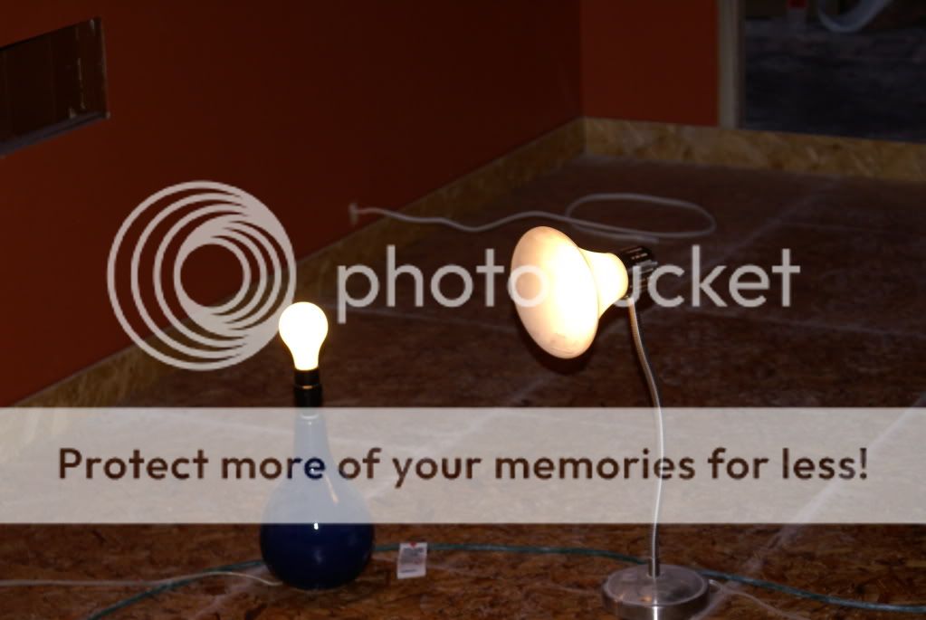

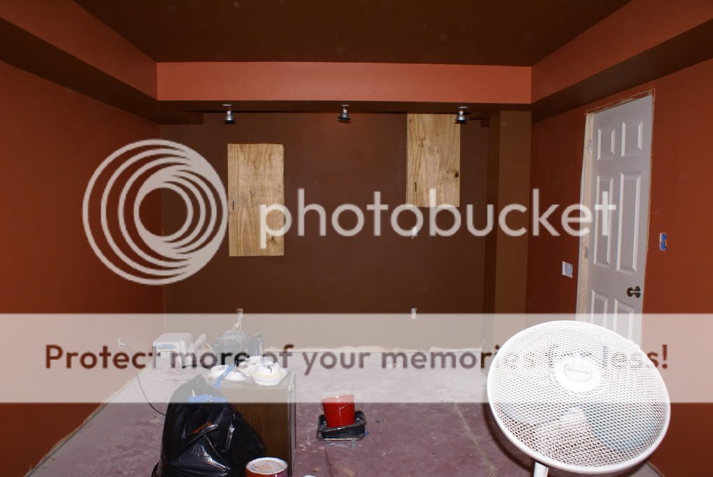

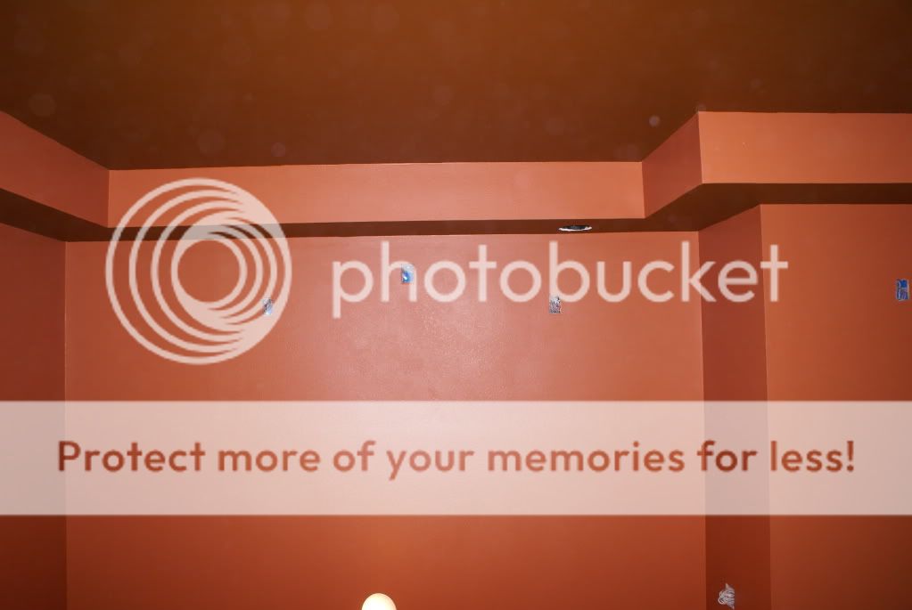

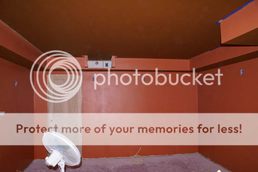

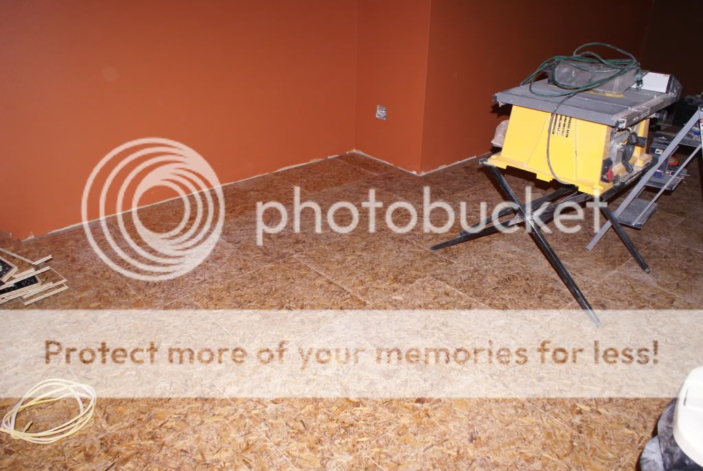

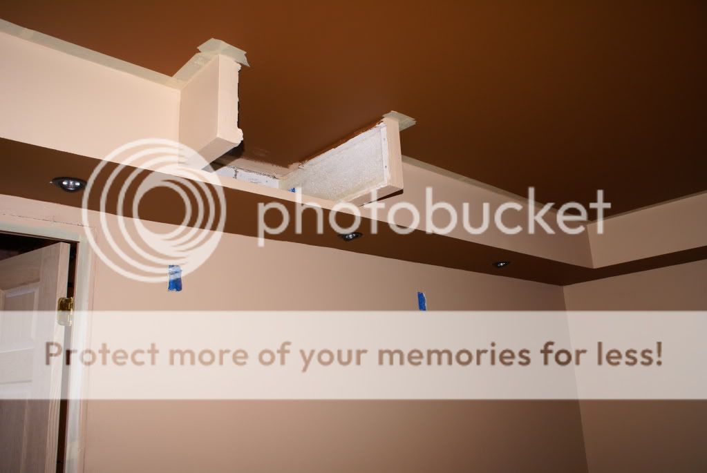

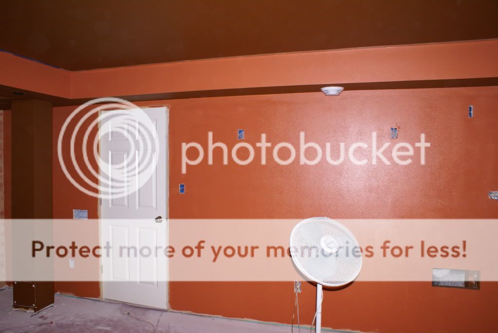

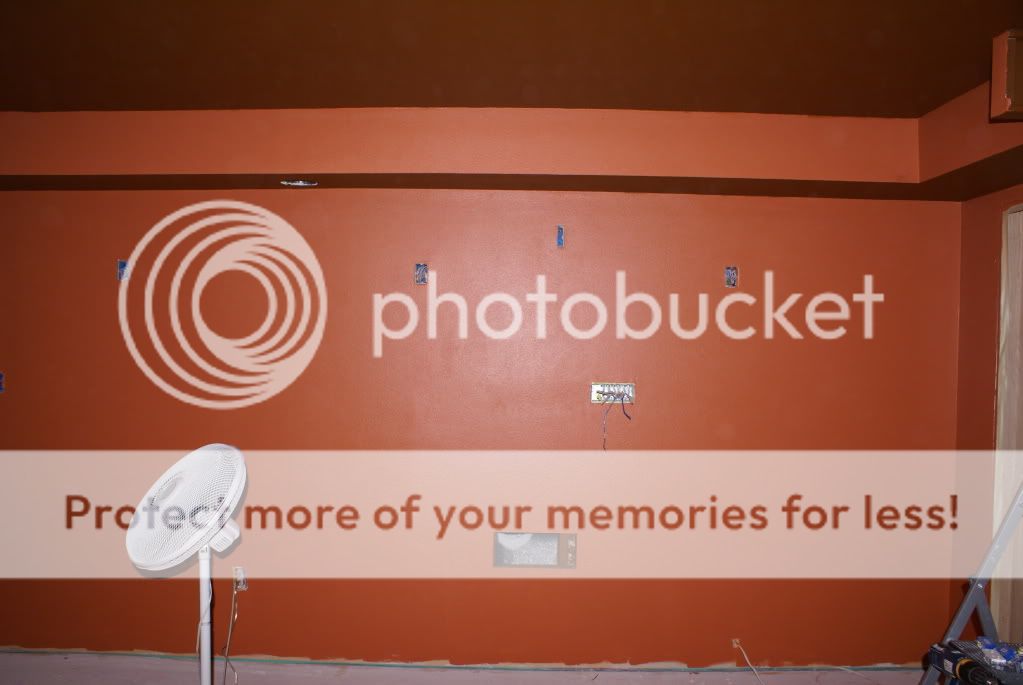

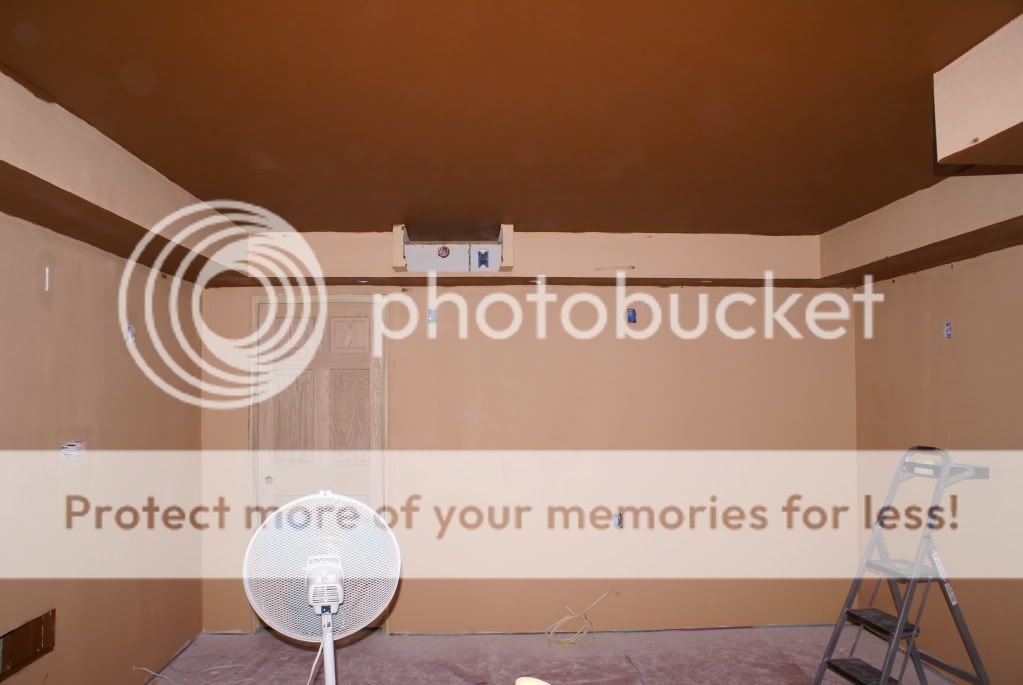

Got another coat of paint up tonight instead of starting the Dricore. That's 3 total coats - might be enough. Tried to get a few pics to show the shine or lack there of with the eggshell finish on the walls. I'm not the best with the camera so...
HT front viewed from riser area
HT rightside
HT rear viewed from screen wall
HT leftside

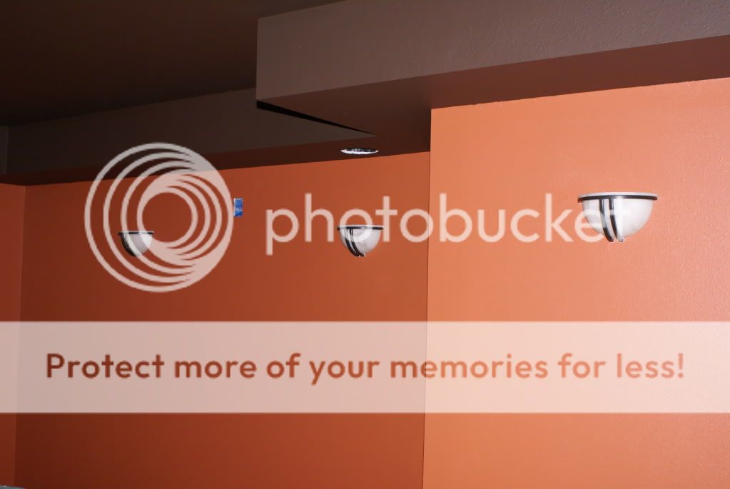

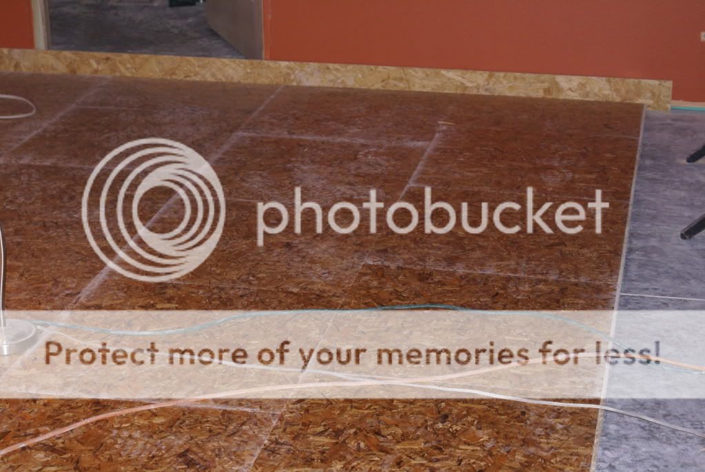

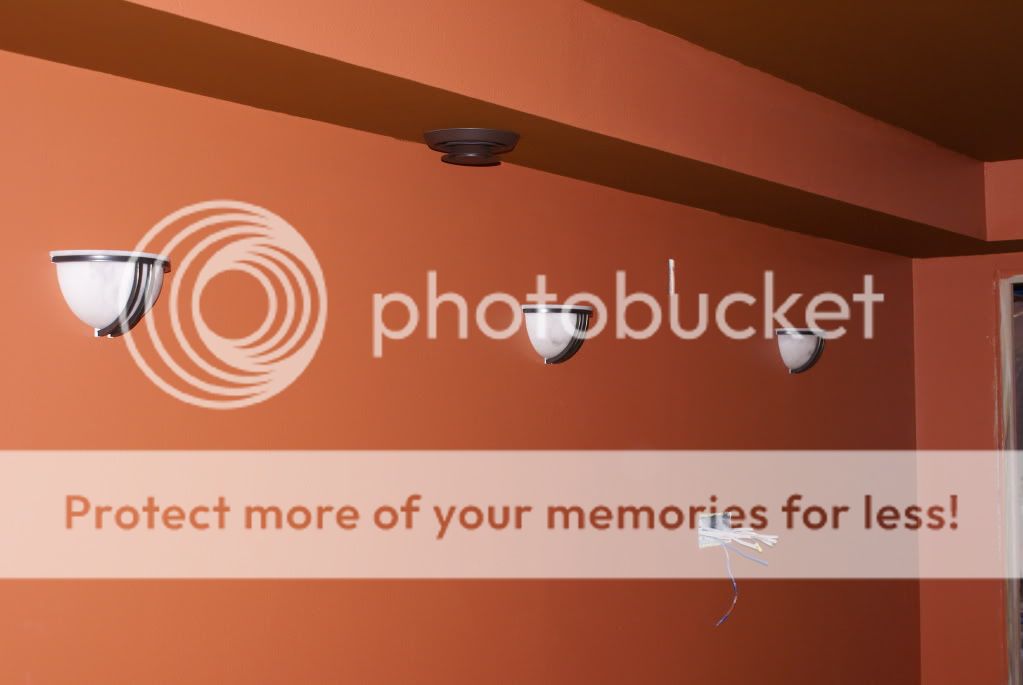

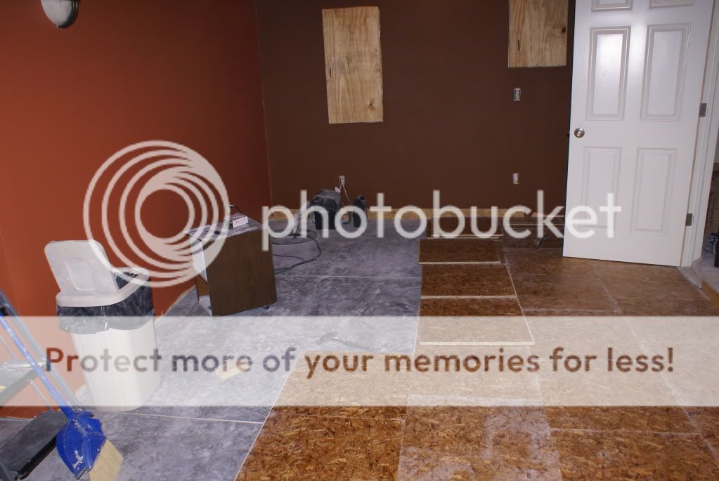

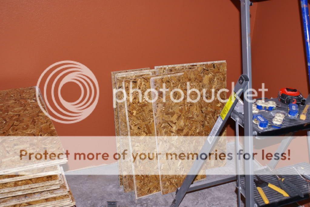

Sconces are up and subfloor is going down.

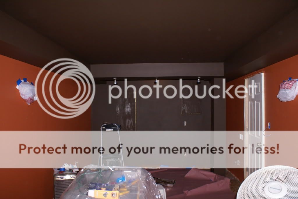

After living with the paint for a few days, I must say it hasn't grown on me like I'd hoped it would. My wife really likes the colors but I'm convinced we should go darker. When see shes the sconces up, I'm sure she'll agree. Its only paint, but it will be a slight pain to do it again.

I'd have to agree about the paint. it reminds me of a terra cotta flower pot. I would go a shade or two darker. Do it now..or you'll regret it.
Yeah, she saw the sconces and agreed. We picked up some darker paint today. I'd planned to fiddle with the GE QS tomorrow, but we'll paint instead.

I got the Dricore installed today as well. Now its on to the riser and stage and then carpet. Well, first a bit of backtracking for the re-painting then on to those steps. Here are a few pics of the Dricore install.
I'm about halfway finished here
Notice the drywall dust on the edges of the panels. Despite several cleanings, remnants of drywalling remain
Not your everyday worklights, but they get the job done
Measure twice, cut once or you'll get these. Two wasted panels.
Dricore installation complete
Audio: Marantz AV7702mkII / Marantz MM8077 / Emotiva UPA-7 for 7.2.4 Atmos/DTS:X - Video: Sony VPL-VW600ES & SI Black Diamond 133" 2.35:1 CIH for 4K UHD - Sources: Oppo BDP-103D, Mede8er 600d with Synology ds716 NAS (28tb), PS4, DirecTV - 7. Paradigm Studio 20 v5 (L, R, FW), Studio CC-590 v5 (C), Sonance VP63 (SS); 2. DIYSG Dayton HO 18" (4); PSA S3000i (3); 4! Infinity Entra One (FH), Sonance VP65R (TR)

Nice work on the dri-core kj. Curious why you did those small panels on the sides of the walls? Haven't see that method before.
queendvd2 is offline
post #118 of 419 Old 04-12-2009, 08:06 PM - Thread Starter
kjlewie's Avatar
Join Date: May 2008
Location: Marion, Iowa
Posts: 1,142
Quoted: 65 Post(s)
Liked: 85
Thanks Queen,
That side of the wall was my last row. It measured 20" so I just cut 3.5" off the panels for a nice snug fit. The smallest piece in the corner at the top was the last piece to go in.

We started our repaint earlier today. We decided to paint the ceiling and all of the soffit the same color. The new color is a darker brown called Labrador. Haven't decided what to do with the walls yet, but we really like the ceiling now.

After dinner I settled in with the GE. Despite planning all of my steps in advance, I was still a bit nervous about the install. Kept hearing the Mission Impossible theme song as I began stripping wire. Turns out that it wasn't that bad. I took my time and plodded along step by step for 3 hours.
Here's the first pigtail
All of the grounds pigtailed and test fitted, so far so good
All of the neutrals pigtailed and test fitted, still looking good
Ground, neutral, hot, and loads all installed
And...it works - THANK GOD!
