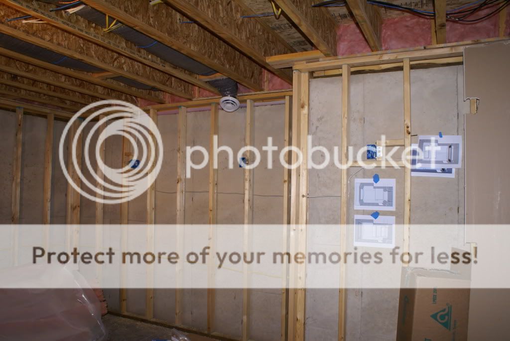

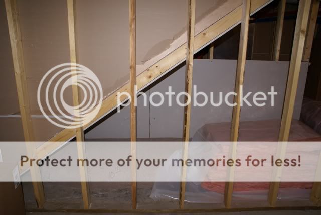

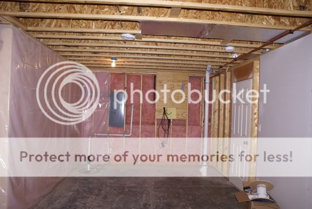

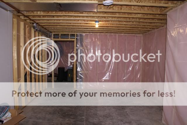

Here are some images of the unfinished space.
Front of HT
Back of HT - Doorway leads to utility room

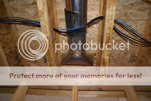

Beginning to remove rigid duct work

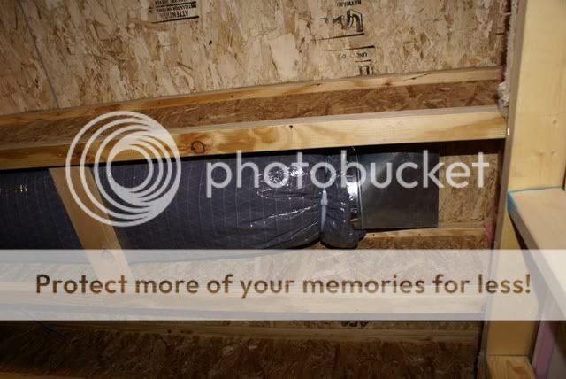

Replaced with acoustic flex duct
Equipment will go here under stairs
Cold air return added

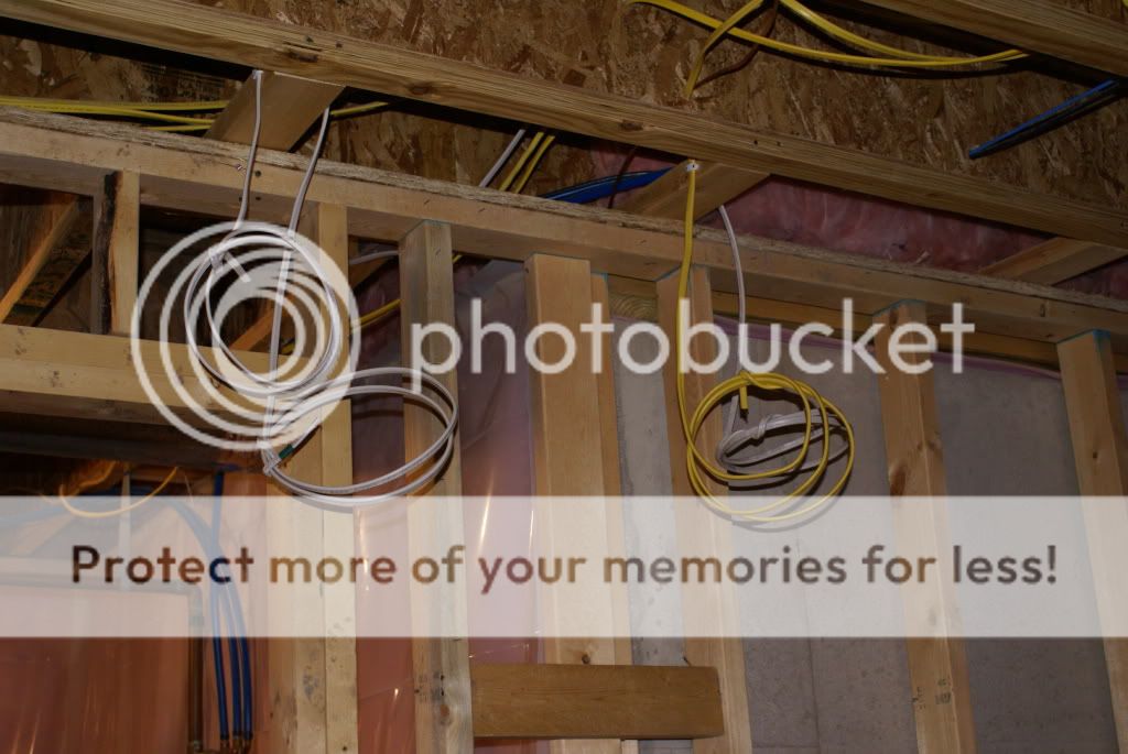

Electrical rough in
More electrical wiring
Drops - considering I didn't know how to wire a couple of months ago, I'm reasonably pleased with the rough in

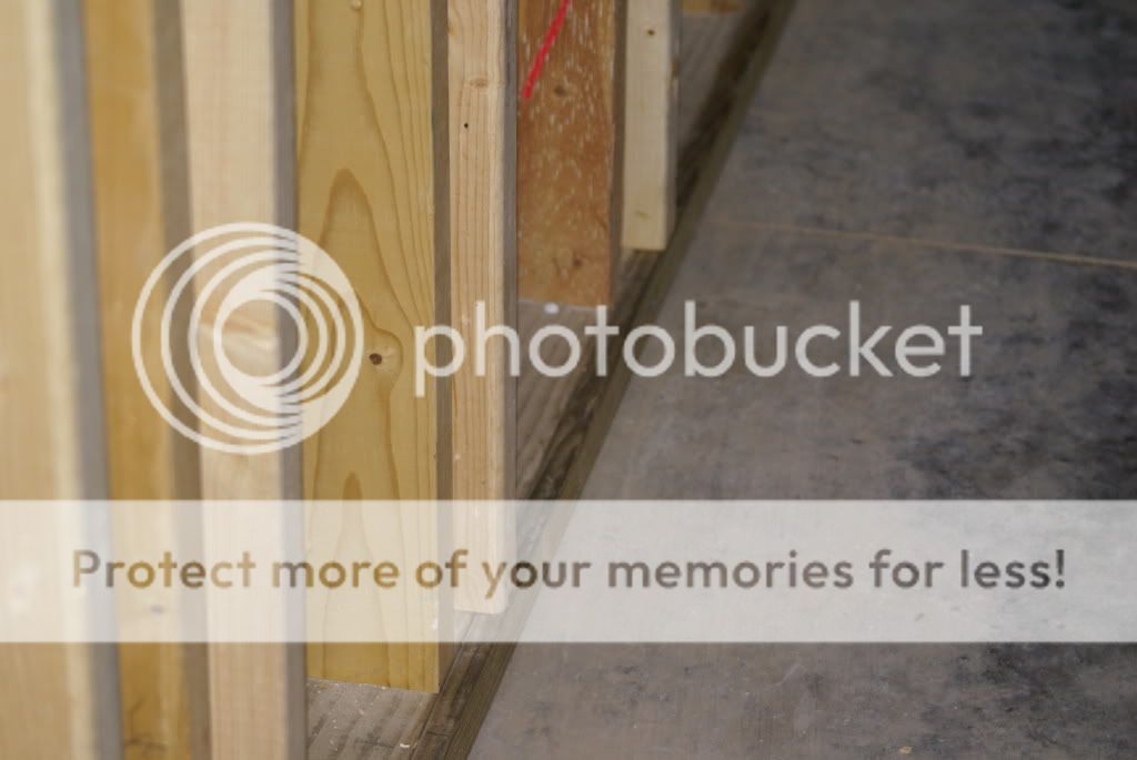

Got the idea for the staggered stud wall from guamguam. Used 1x's and 2x4s to add an inch of space to decouple the HT stud wall:
At this point, I’m really excited about everything except the mud and tape. After learning to wire and completing the rough-in, I literally feel like I can do anything. That is as long as there is no time clock. Looking ahead, my next big puzzle is how to design/build the screen wall to provide easy access to the breaker panel and sump pump or if I should build a second door to access the area.

curious why you didn't go for flex duct on the return. That's a pretty big conduit to the rest of the house.
Rookie/Novice mistake. I noticed it when I stepped back to congradulate myself on a job well done. I have some flex duct left that I can replace a portion of it with. But, is there anything I can do deaden the vent without tearing it out? Or, is tearing it out and using the flex the best option?

Rookie/ I have some flex duct left that I can replace a portion of it with. But, is there anything I can do deaden the vent without tearing it out? Or, is tearing it out and using the flex the best option?
Replacing the round duct with the flex will help. Replacing with true acoustical duct better. You could also get some JM Linacoustic RC and line the inside of the duct work.
Lastly it looks like you are planning on using the wall cavity as part of your vent system. If you would make it deeper you could line the box with Linacoustic as well turning it into a duct muffler. To do this you would need to build the box deeper, but you have the room. You could attach 2 inch thick furring to the studs and just move your construction back a bit.

When I say "True" consider that all flex duct is not created equal with respect to acoustical properties. Only product 6B/6M in this example has broad band absorption characteristics from this assortment of Flex duct.
Big,
Thanks for the tip. I'll get some furring strips and deepen the box. I'll also get some Linacoustic for the box. I'll use the flex duct since I have it. I hope there is not a big difference between the flex and acoustic flex, but if its still a problem, I'll have access to it.
