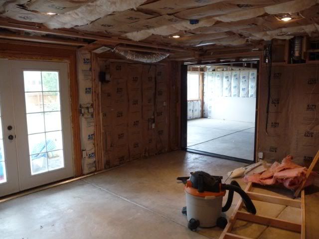

Here's what I started with.

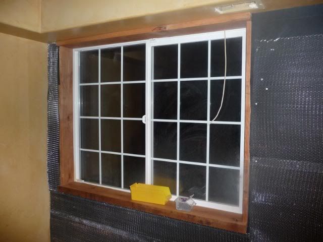

Replace the window with french doors (lead to main patio) and removed the slider all together.

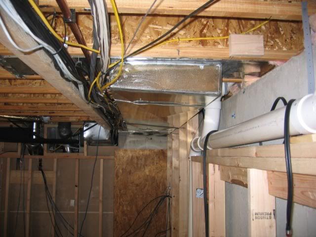

Did some vent relocating.
Still didn't like how the soffits for the venting would have turned out so I had a custom vent made to the same volume but wider and angled. I had to frame down a little for the gas pipe so designed the vent to maintain as much ceiling height as possible.

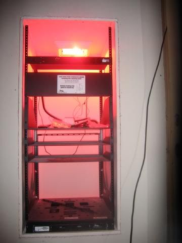

I put the equipment rack right out side the theater doors. Had to move the hot water heater to the other side of the furnace.
It sat like this for lets say awhile.
Picked up some solid Mahogany exterior doors. Thought these would be decent for sound isolation. Haven't been impressed after doing one little test after drywall went up.
Here's right before drywall went up.

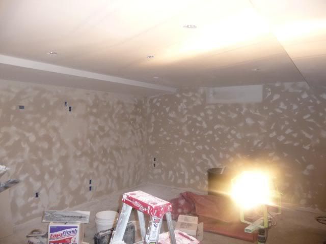

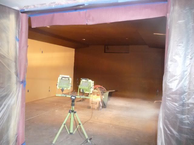

DD 5/8 and GG, caulked around everything, used 4-4" airtight can lights and two sconces for lights.
Well that's where I'm at now. I need texture so I can start to paint.

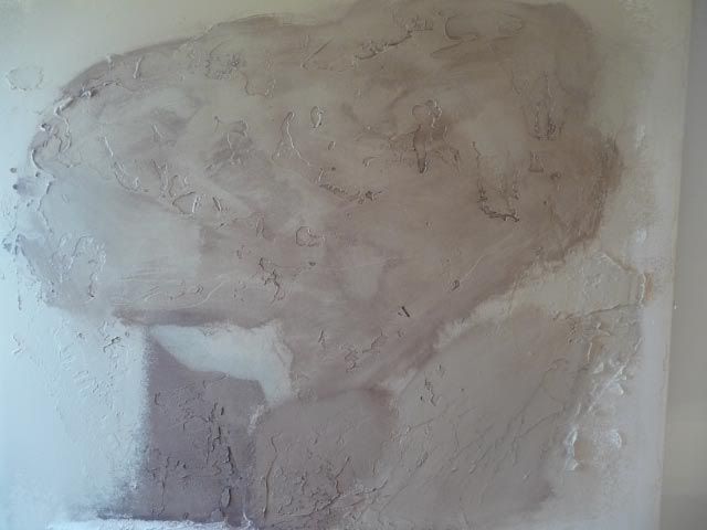

I have decided on hand trowel for texture and did a little experimenting with faux painting a sample of the texture.

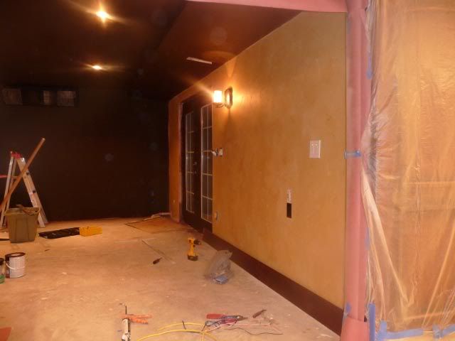

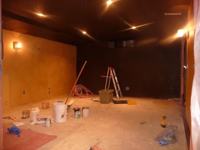

Here's the texture being applied.
Paint.
Glaze applied.

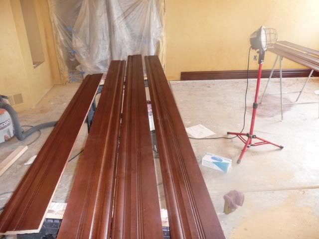

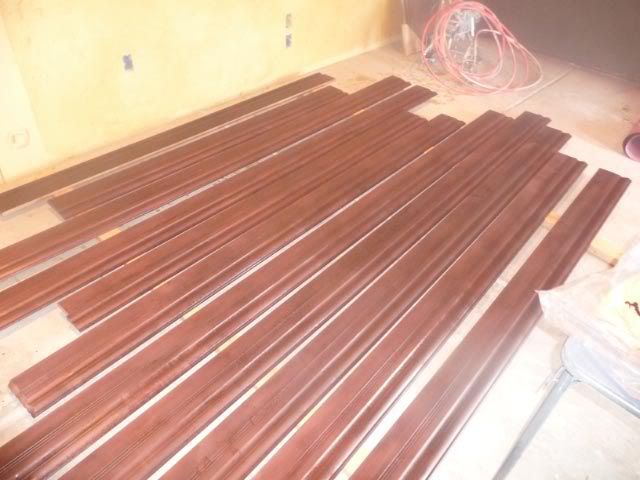

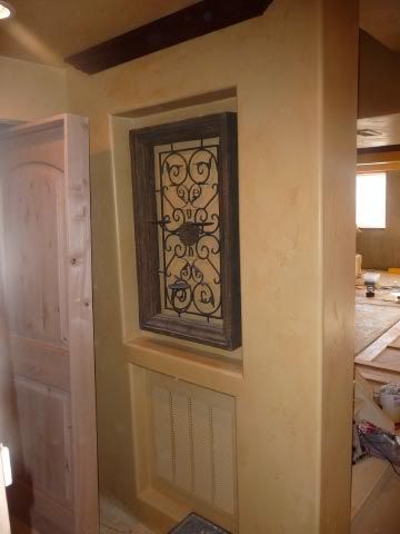

I did get some trim stained today. Horrible picture. I played around with stains and applications until I got close to what I wanted. Ended up with 2parts Expresso to one part Mahogany stain. I liked how the air brush put it on so thats how I applied it.

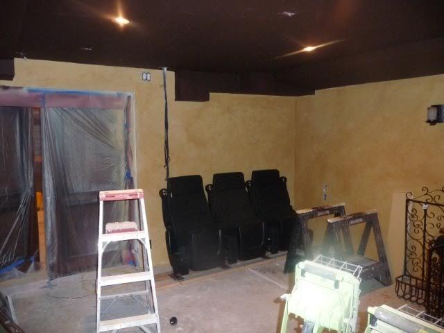

I picked up 3 theater seats that I thought might work for a second row of seating up against the back wall. I'm afraid its going to look a little congested when I get the main couch in there though.

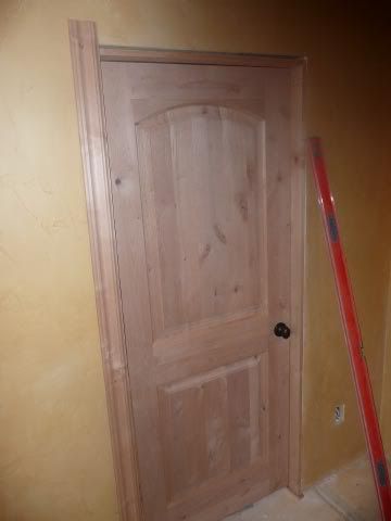

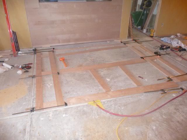

Built my first door jam. It wasn't to bad. Just a lot of steps in the process.

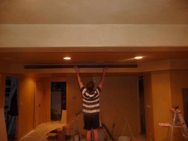

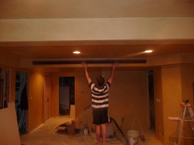

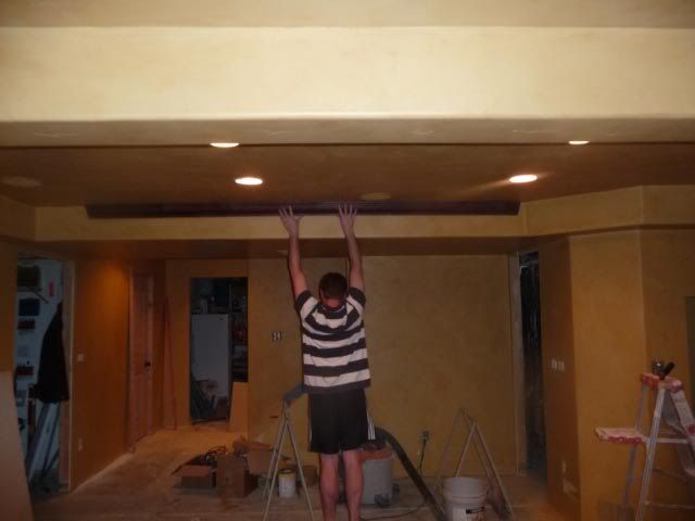

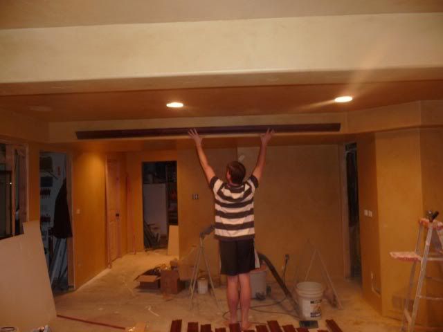

I need some help deciding where to put the crown molding. We planned on putting rope lighting behind the crown but it seems to look better flush to the ceiling. The short ceiling height seems to be helped by the higher mounting postition also.
Give me your opinion on where you think it should be mounted.
flush to ceiling
an inch or so down
in the middle
down low
68sting is offline

Very nice job you are doing... I love the Logans and also have a full Martin Logan System with SL3's up front, Theater i center and Scenarios as surrounds. Velodyne 18" as sub as well!
I am not sure about your center channel placement that high up... I think it would be better close to the floor and angled upwards toward listening position, but you may not have had a choice... anyway, keep posting pics of your progress! Can't wait to see finished product!

Yep, 1" looks good.
CJ
carboranadum is offline
post #20 of 91 Old 12-24-2008, 08:15 AM
phisch's Avatar
Join Date: Nov 2004
Location: Colorado
Posts: 1,858
Quoted: 57 Post(s)
Liked: 40
Another vote for 1" down.

I concur with there decisions also!
Theater is coming along really nice, looking forward to seeing the next set of pictures of your progress.

Looks like 1" or so down wins. Thanks for the input.
Thanks for chiming in. I went high with the center in case I want a second row of seating. Also I can open the theater doors to the other room and people can still hear the action. Have you acoustically treated your room? If so what did you end up liking.

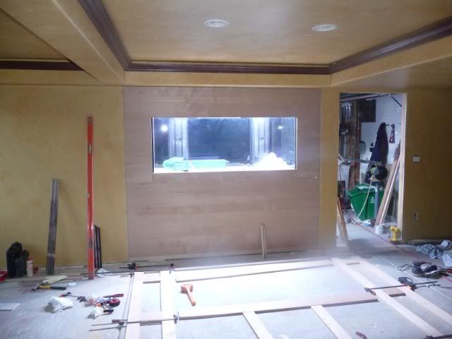

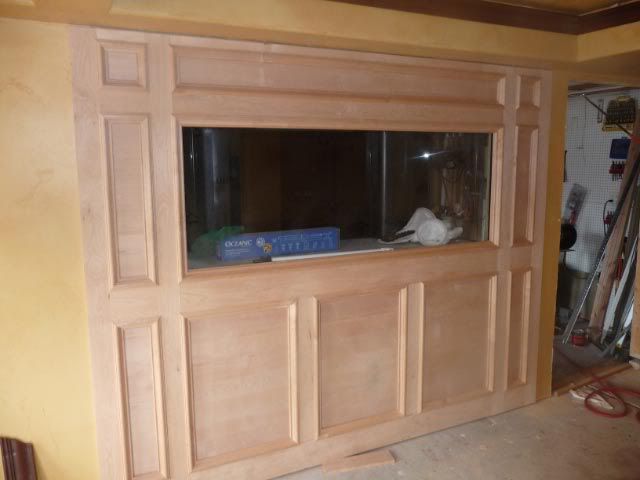

I'm doing a 215 starphire reef tank in the main area. I got the alder ply up and started on the frame. It will be 1x4's and 1x6's with cap molding for a paneled look. I have never used a biscuit jointer and it didn't go as planned for some reason. I thought the pieces would be virtually flush with minimal sanding but there off a little more than expected. Nothing a little sanding won't take care of though. Glued up the sides today and plan on gluing up the unit as a whole tomorrow.

I got most of the tank wall done now. Still need some trim across the top and stain. I haven't been able to find any frosted rope light. If anyone has source for this let me know.
That looks awesome ! ... what colour are you staining it ?
what are you doing for lighting/circulation/skimmer ?

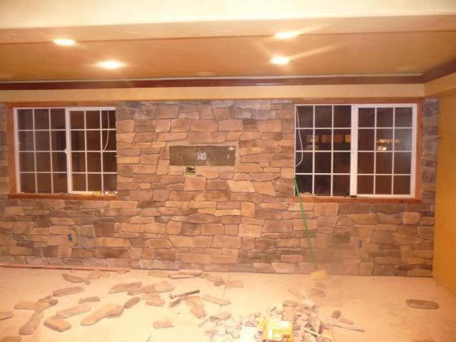

Here's the rock up. It still needs to be over grouted. My drywall guy threw it in his bid to sweeten the deal. I was out of town for a few days and came home and it was up. That was sweet. Probably the best basement experience yet. lol

phisch's Avatar
Join Date: Nov 2004
Location: Colorado
Posts: 1,858
Quoted: 57 Post(s)
Liked: 40
That stone work looks great. It's all coming together nicely.
phisch is offline
