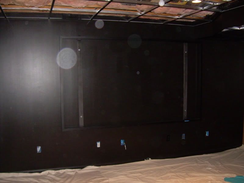

Here's the screen wall:
Sorry, I didn't take too many construction photos. I always meant to but time just got away from me in the evenings.
The screen wall obviously much farther along in the process.

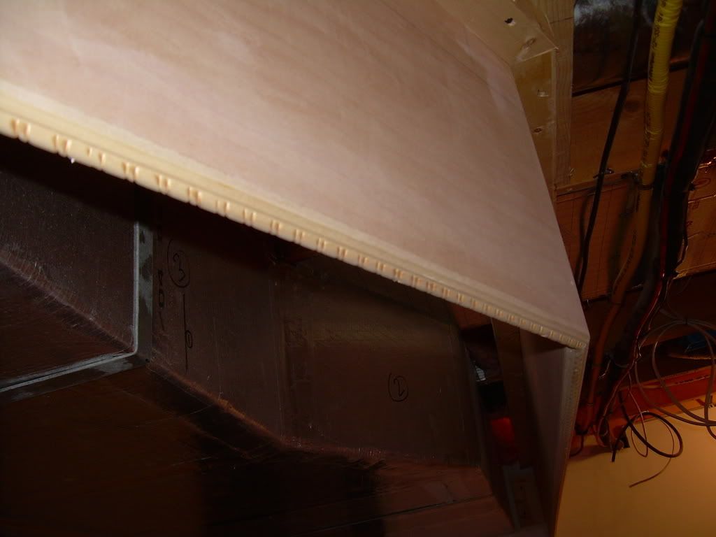

Carl built a soffit to cover the duct. It was the only option. Because of another I-beam, there was no way to move it out of the theater room. Here is a detail shot of the molding he trimmed it out with.

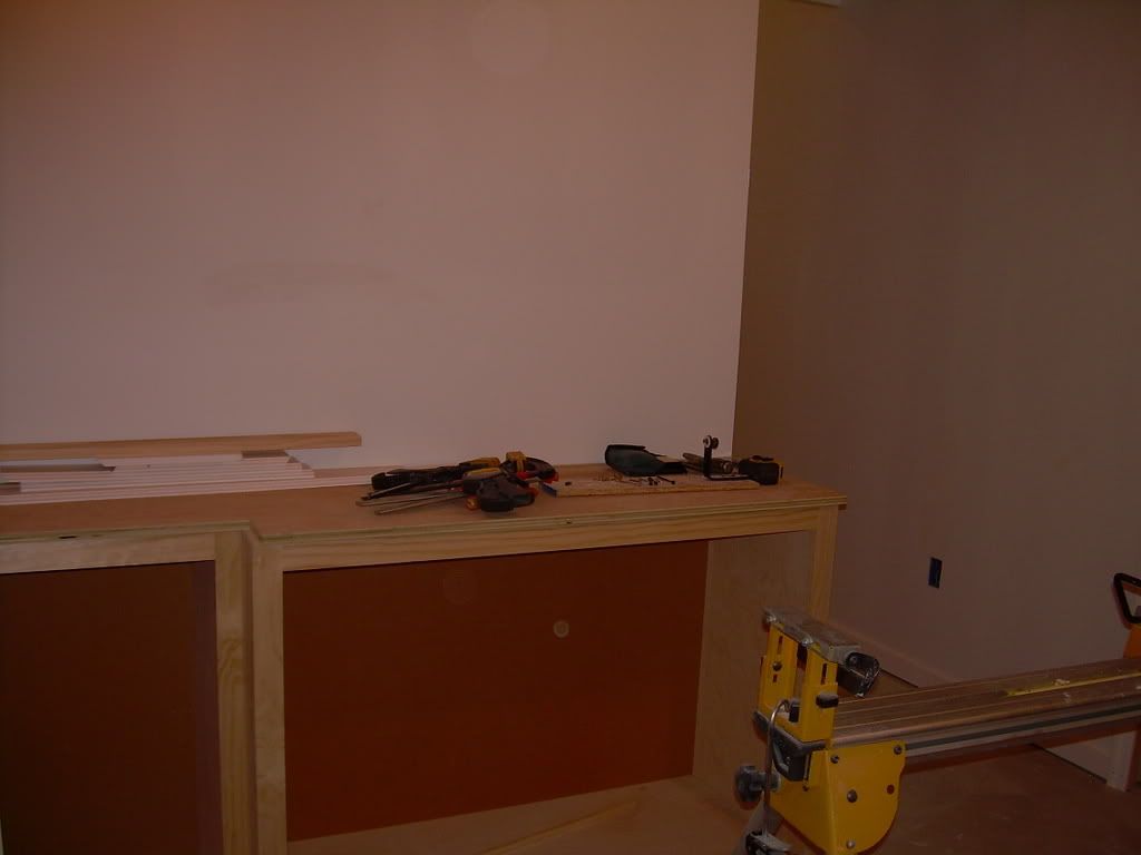

The cabinetry out in the kids' playroom.
And another view of the cabinetry. The door in the background leads to the unfinished storage area.

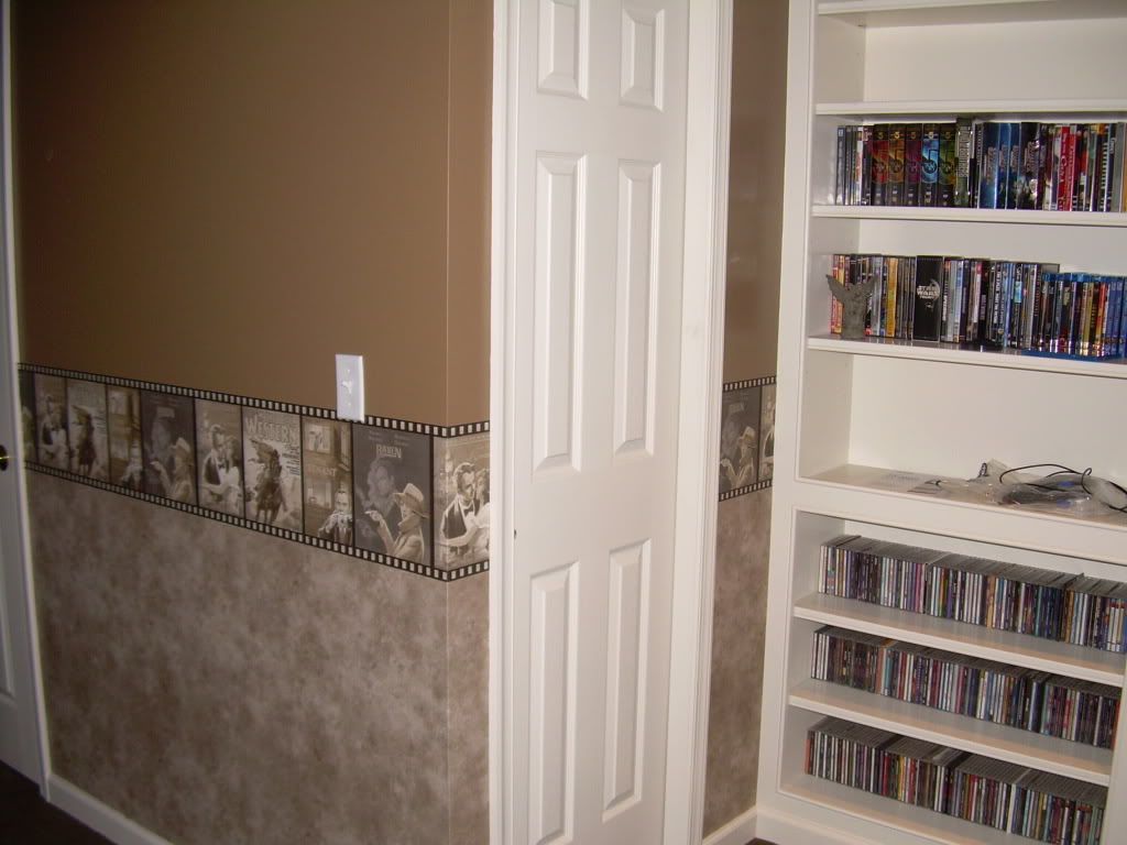

The shelving unit in the back of the room, with the pocket door opening to the equipment rack somewhat visible on the left.

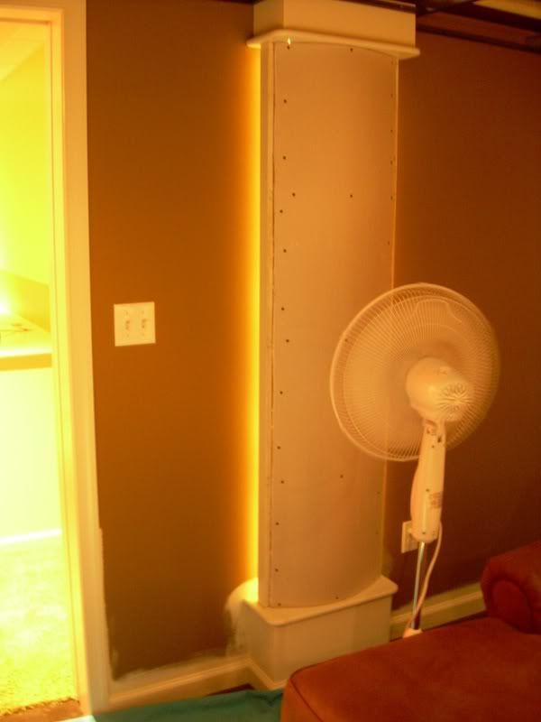

There was one support column we couldn't quite bury in the wall. I told Carl to just box it in a column and make one to match on the other side. That was far too simple for Carl to bother with! He ended up making curved columns with trim detail that matched the duct soffit. I forget who suggested the lighting, but I ended up ordering rope light that he worked in behind the column.
Here's the column with the face removed. The face just slides on over top and is held in place with four drywall screws (it's a tight fit to begin with).
Another view of the column.

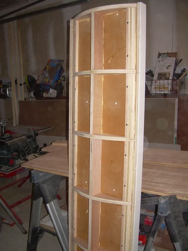

This is how he framed out the column. He then wet drywall and bent it over the framing. It took quite a bit of drywall mud to even everything out!
Another look at the column frame.

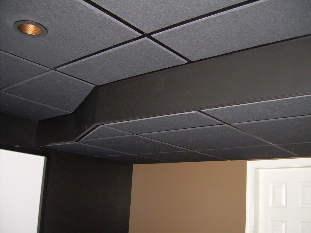

Completed soffit. I was close and used a flash, which is why the tiles look gray. Carl did a fabulous job of making the angles in the soffit fit perfect with the ceiling grid.

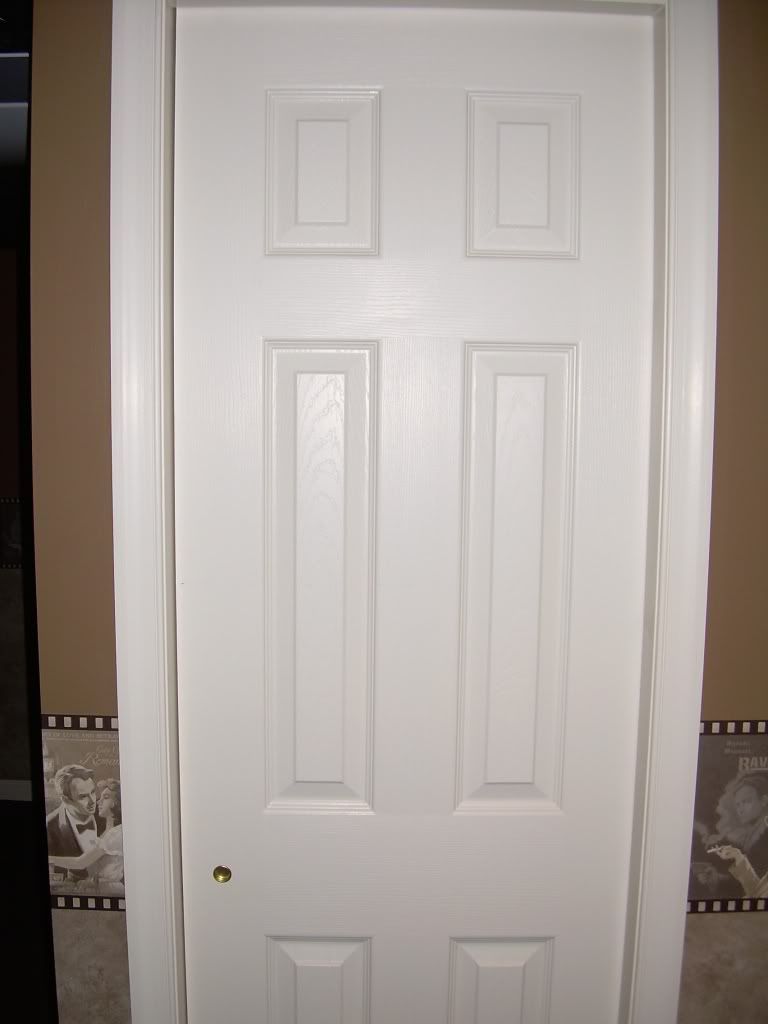

Solid core pocket doors leading into the theater, with one of the columns visible on the right.

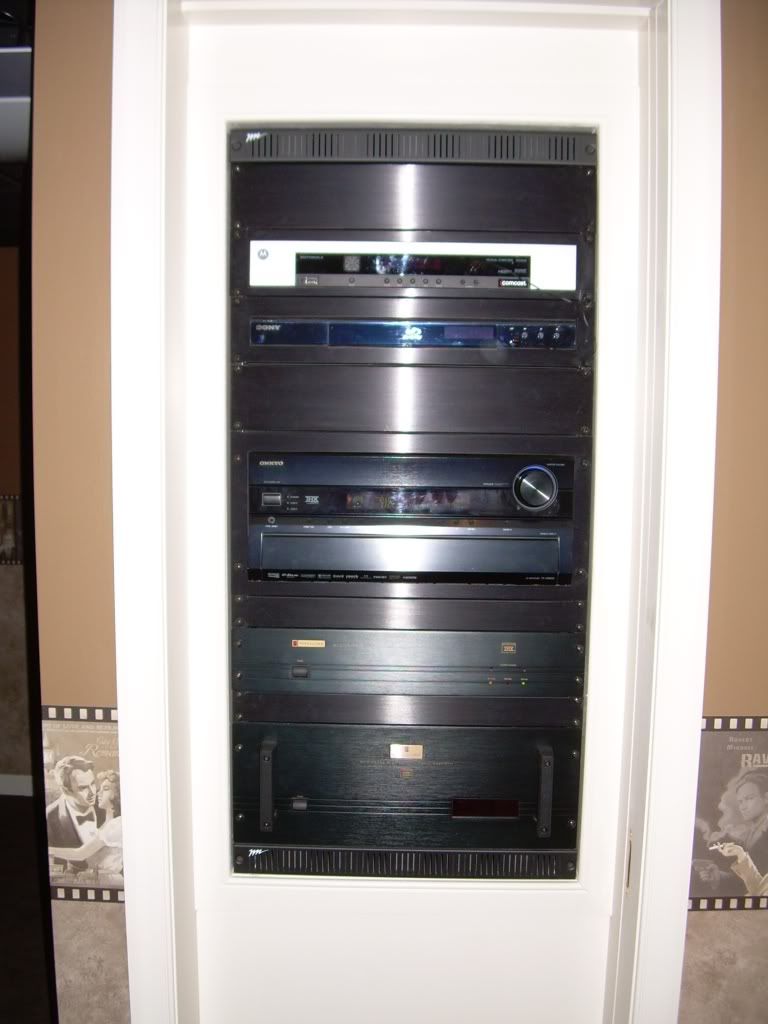

The equipment rack behind a solid core pocket door.
The equipment rack door open. Not a lot of stuff, but it works for me. A three channel Parasound amp on the bottom, a two channel Parasound amp above that, then an Onkyo 805 receiver I'm using as a processor, a Sony BDP-S350 Blu-ray player, and the latest Comcast HD DVR. The rack is a Middle Atlantic Slim 5.
My speakers for those who are interested are Vanstersteen 2CEs, a Vandersteen VCC-1 center channel and VSM surrounds, and a Paradigm subwoofer.

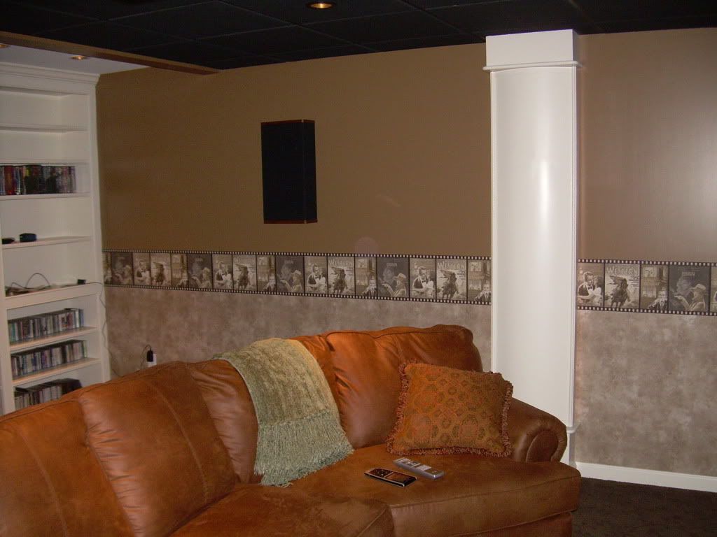

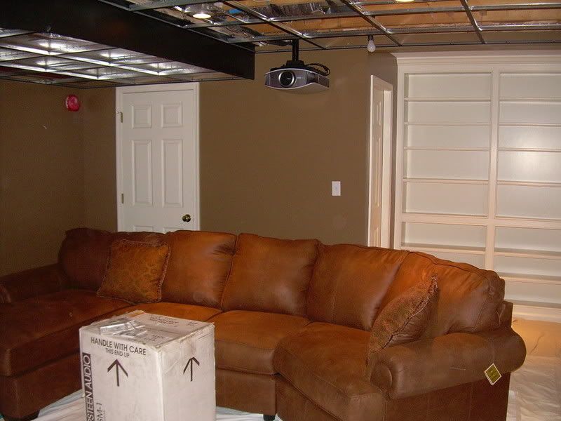

A different view toward the rear of the room showing the shelving unit and the other column.
Rear of the room with the Sony VPL-VW40 visible.

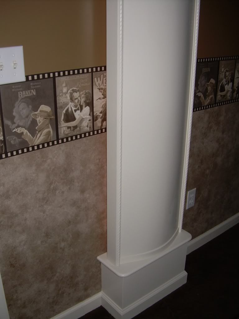

Detail of one of the columns and wallpaper.

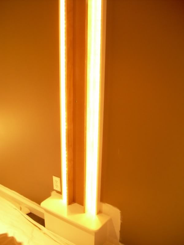

A view of one of the columns lit up. All lighting is controlled by my Pronto TSU-9400.
