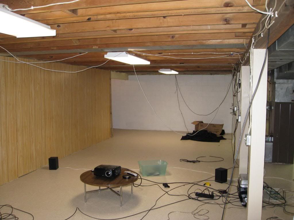

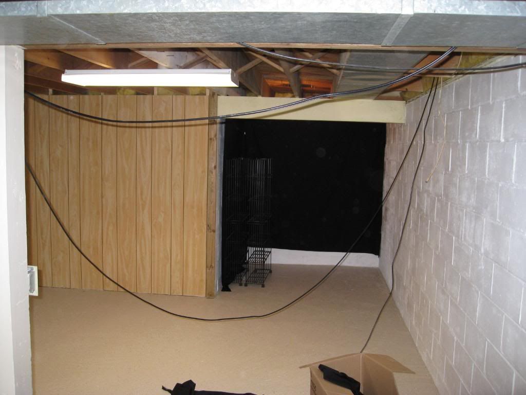

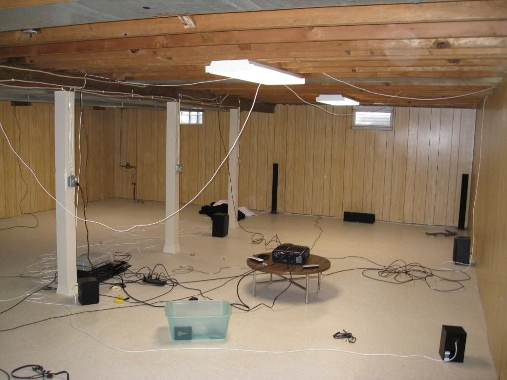

ok heres some pix like i promised, heres the deal we have plenty of windows in our basement but she wants me to put the screen on the concrete wall because she thinks theres a leak by the other end of basement where one of the windows is...i dont believe that myself but i plan on sealing up that window and everything around it after i tear down all that paneling.... so any suggestions?
oh and yes, theres a slight slant as it goes down towards the window... and the space is about 13.6 inches across and oh say 25 feet long....or i can shorten it dont matter....just some ideas...

post #4 of 181 Old 12-28-2008, 01:32 PM
mbgonzomd's Avatar
Location: North Carolina
Posts: 3,846
Where are the stairs? I guess the 13.5' is the distance from those white columns to the side walls?

post #6 of 181 Old 12-28-2008, 05:12 PM - Thread Starter
arc trooper's Avatar
Location: Eau Claire,WI
Posts: 229
the stairs are in the way back behind the furnace in the one pic... bout 10-15 feet to be exact and yes the 13 is between the pillars and the wall, and the stupid paneling is held up with furing or whatever theyre called strips, with ugh....styrofoam behind them. the wife wants me to leave them up saying theres nothing wrong with paneling...i told her helll no!!!

Update... decided to move a couple of the posts out and down and re-enforce the beam making this baby 26ft long and 16ft wide... got my money today for it and will be starting construction soon!!!!! hopefully by the end of the week if not sooner

a 16 foot piece of iron bolted to the exsisting beam and another board over that and straps along with the columns on the sides. or something like that

Don't want to burst your bubble but if you are moving posts you probably need to dig out the concrete floor and pour a code legal footer.
Slapping a pole just anywhere on a concrete floor can lead to that sinking feeling in the years to come.
It's not a big deal, you need to cut out a 2x2 (please verify dimension) section of the floor, dig the required depth, then fill it up with some new concrete.

As a structural engineer myself, I would suggest you get a structural engineer in to make sure this idea of yours will work. Nothing ruins the experience of watching a movie more than having a house collapse on you.

Is that Beam three 2x10 nailed together ?

i would think they are nailed together and if worse comes to worse we can always just leave the columns there and not do that the guy ive got doin this has built stuff like this in the past and is pretty knowledgeable bout this kinda stuff i trust him. plus were putting another board on the otherside and such but it will work just fine. in 2 months if it all comes down you can all say i told you so and ill post pix!

I think you mean he's bolting a steel flitch plate to the side of it?
This really isn't something you can do by eye. I would get a design professional to look at it. I think it can be pretty easily done, but you need to run the math. What thickness plate is he using? .125? .5?
A triple 2x10 should really do no more than 8 or 9 feet in the best of conditions. Of course, it depends on the design of the house and what your snow load is. Logically, you should be able to get more out of it with a steel plate, but who knows.
Deflection is as much a concern as failure.

the steel is 3/8 inch thick so im pretty sure its going to work and like i said hes done stuff like this in the past and its worked well to date the load on the house is pretty evenly spaced and the bedrooms are right above the theater so theres hardly anything there to begin with.

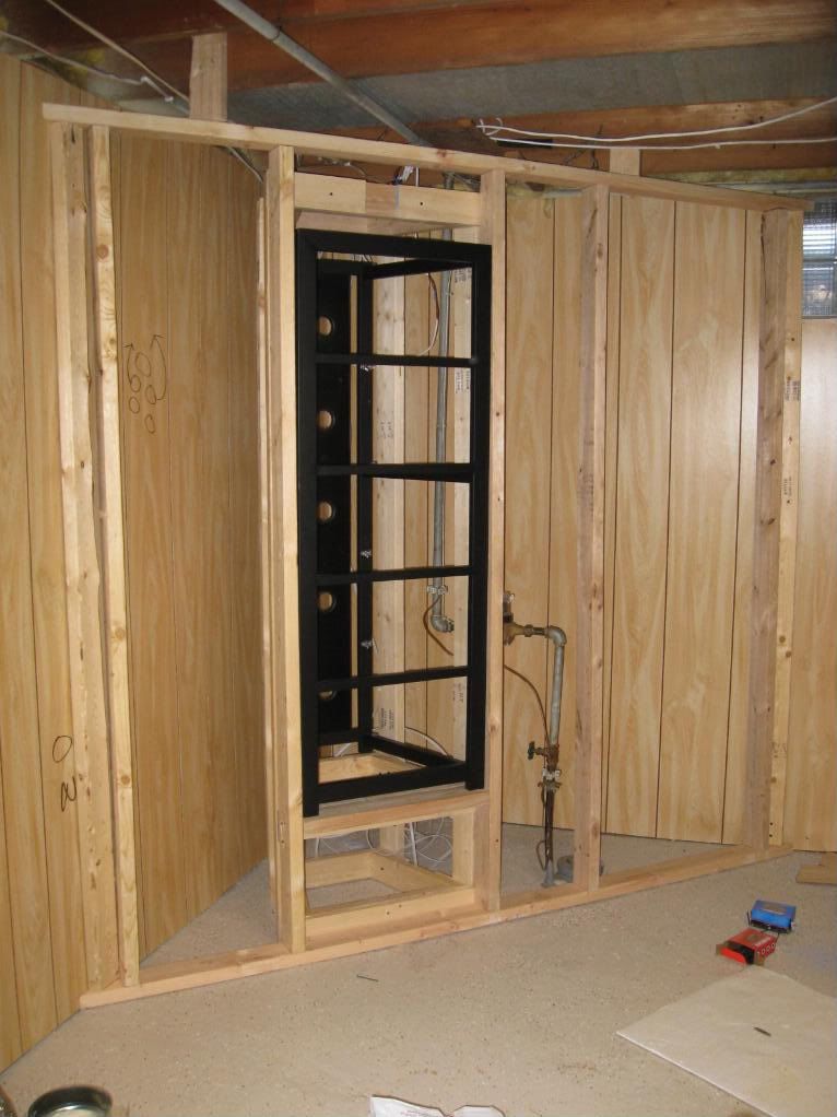

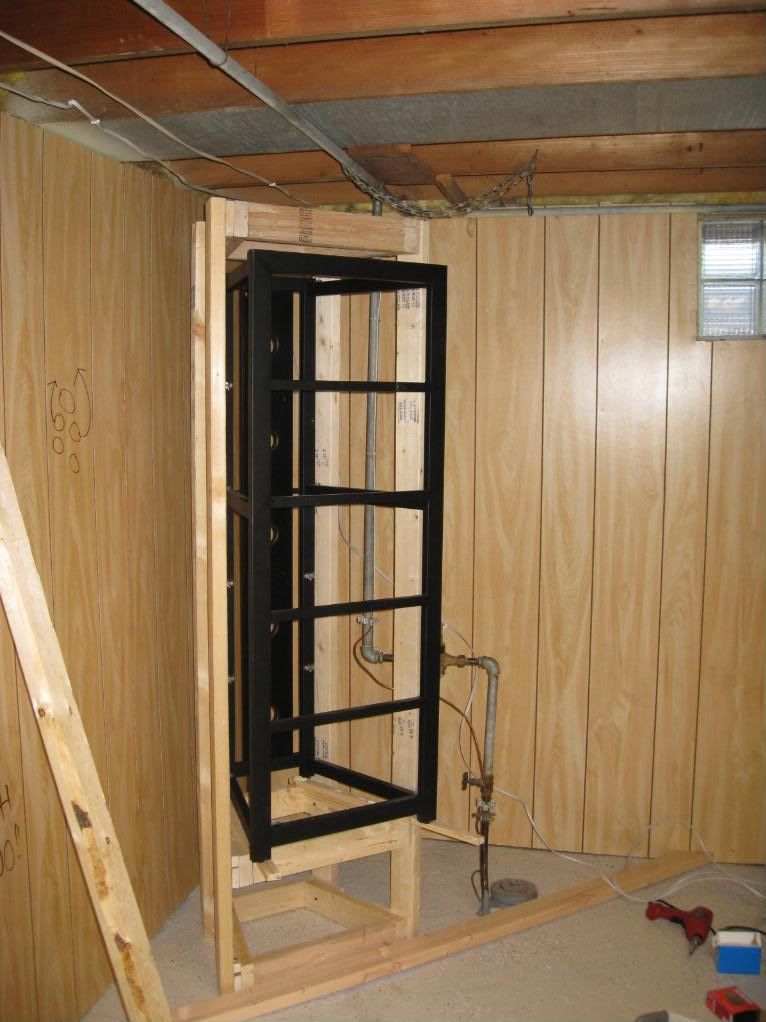

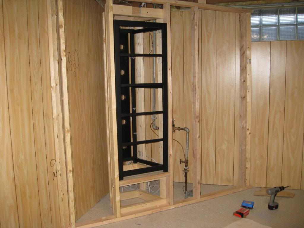

post #24 of 181 Old 01-15-2009, 07:35 PM - Thread Starter
Posts: 229
heres the rack in its varying stages....

post #25 of 181 Old 01-16-2009, 04:50 AM
Mr.Tim's Avatar
Location: SC
Posts: 2,839
Quoted: 277 Post(s)
Liked: 180
Looking good.
You may want to think about changing your water line over to copper or plastic. The galvanized pipe is just a problem waiting to happen.
If you used pex, you could drill the floor joists and have the line concealed in the ceiling.

post #26 of 181 Old 01-16-2009, 07:05 AM
oman321's Avatar
Location: MASS
Posts: 4,981
Quoted: 127 Post(s)
Liked: 117
So your keeping the paneling up in that space behind the rack?
You mentioned you were tearing it down, I know your probably procastinating on it cause once you start there's no going back.
What's the plan to maintan access behind the rack and water line? Are you planning to cover the frame (including the frame to the side of the rack) with fabric panels or something that's removeable?

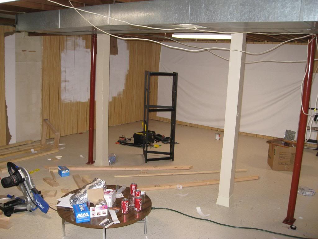

post #30 of 181 Old 01-20-2009, 08:48 PM - Thread Starter
Posts: 229
well tomorrow we start the steel beam part... brought in a specialist and he did the math and it will work cost me an extra 200.00 but it was worth it to calm the wife! heres some more pix
the last pic is me and the guy in the way of the wife takin pix, said she didnt wanna wait for us to move!
