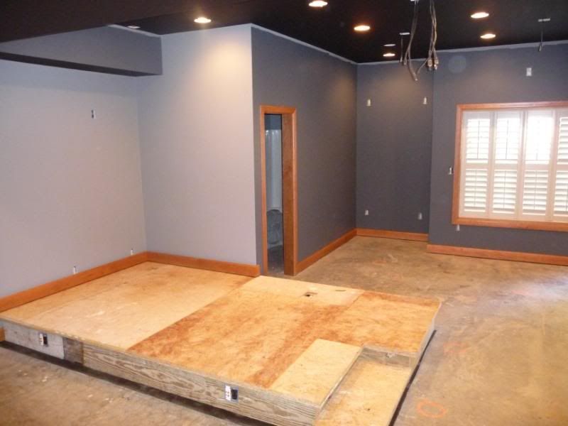

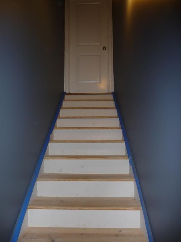

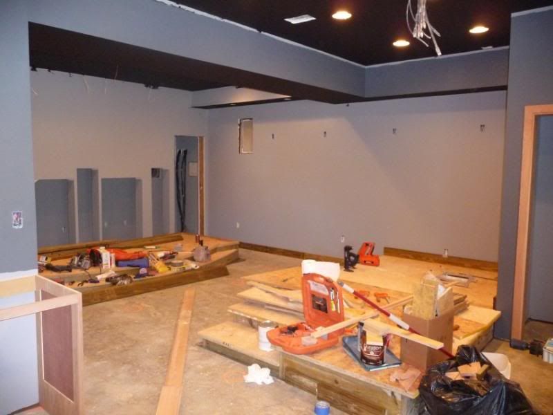

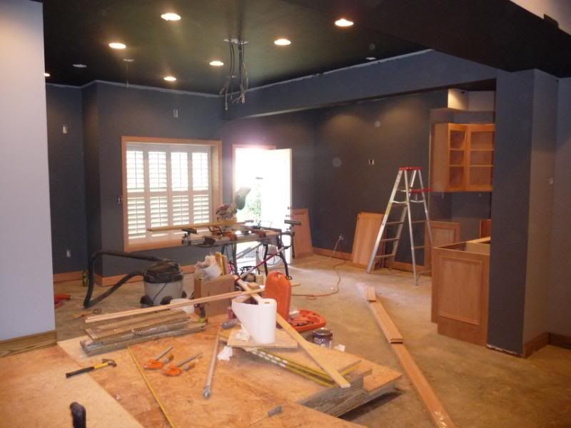

Progress Update! Last 1/2 of October (no specific days...a touch here and there...)
Painting
I went with Sherwin Williams color "Wall Street" in Duration Matte finish for walls that won't be 703/GOM.
2 coats over the 2 coats of primer and it looks great. Also VERY smudge resistant and cleans up like a breeze.
Painted Hallway:
Good comparison shot of the old primer color (which wasn't bad at all) and the new, darker color (taken on landing at foot of stairs):
Shot upstairs for perspective:
Other pics showing new color will be following!
John

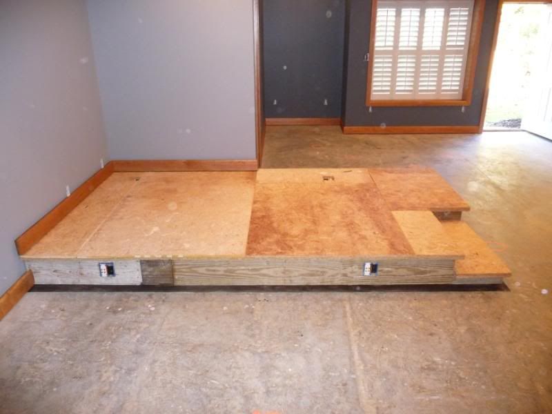

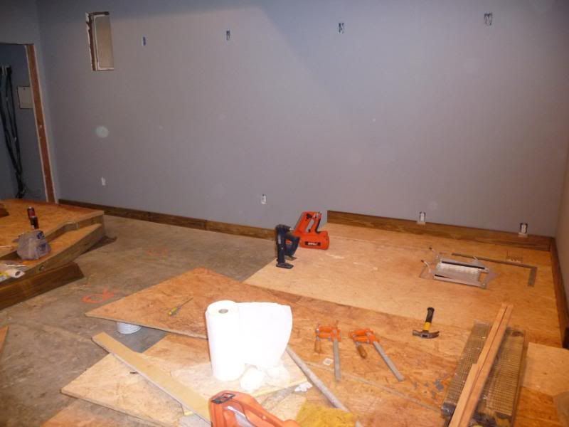

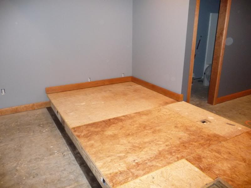

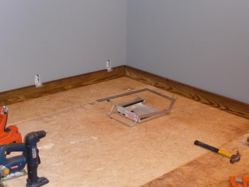

10/28 Progress Update:
For the 703/GOM covered walls, I needed to add 1 inch thick firring strips...the baseboard will attach to these, so in the end, the baseboard will be 1 inch from the walls and look flush with the 1 inch linacoustic/GOM.
Basic Idea:
Pic showing firring strip and baseboard:
I used 5/4 lumber which 1 inch thick and used for decking. It was 5 1/2 inches wide so I ripped it down by an 1 inch so it would be shorter than my baseboards.
When used with the fabric track, the baseboards will cover the small part of the track that otherwise would have been exposed. Thanks to Cathan for this neat idea!
Some Example Pics:
5/4 firring strips in place (I had to notch out for the 2 outlets):
More pics of the firring on the riser/floor:
John

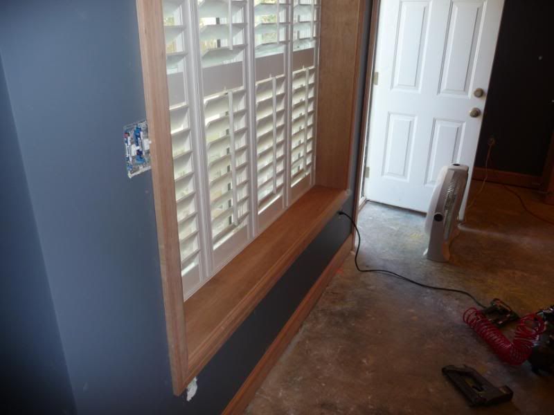

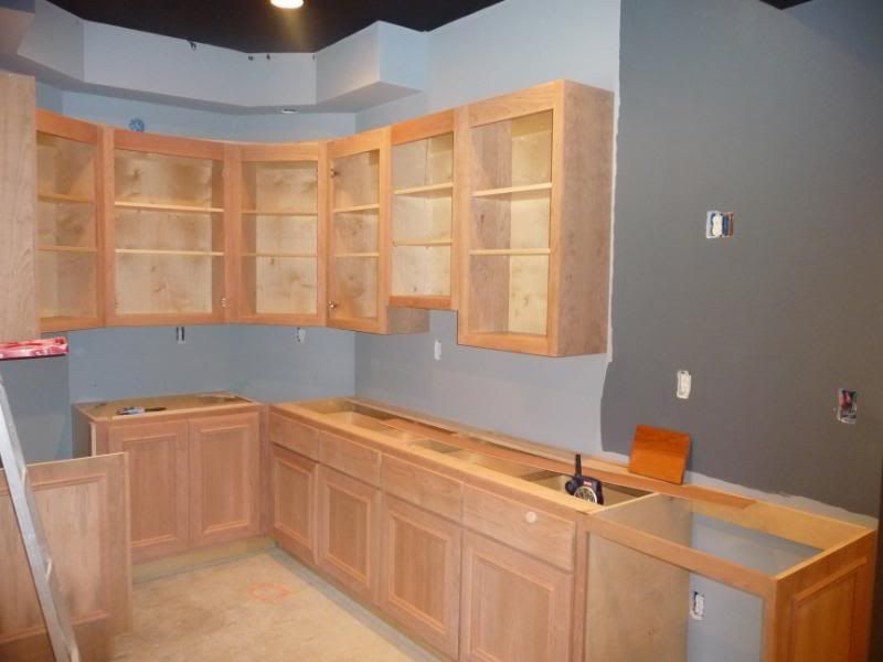

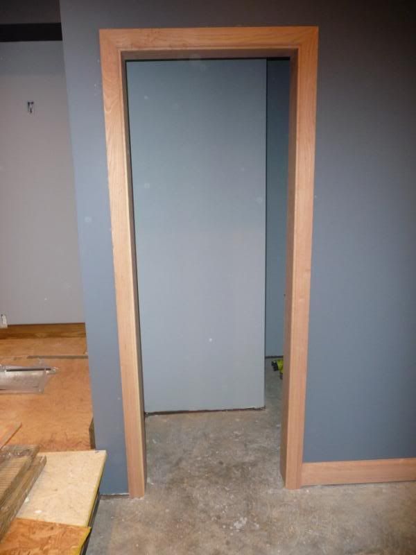

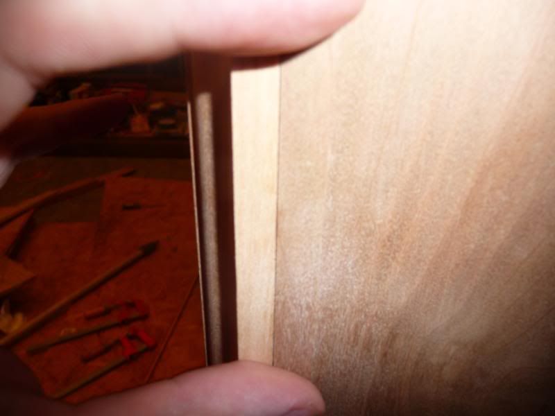

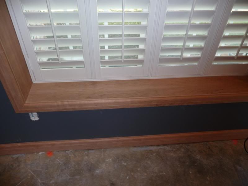

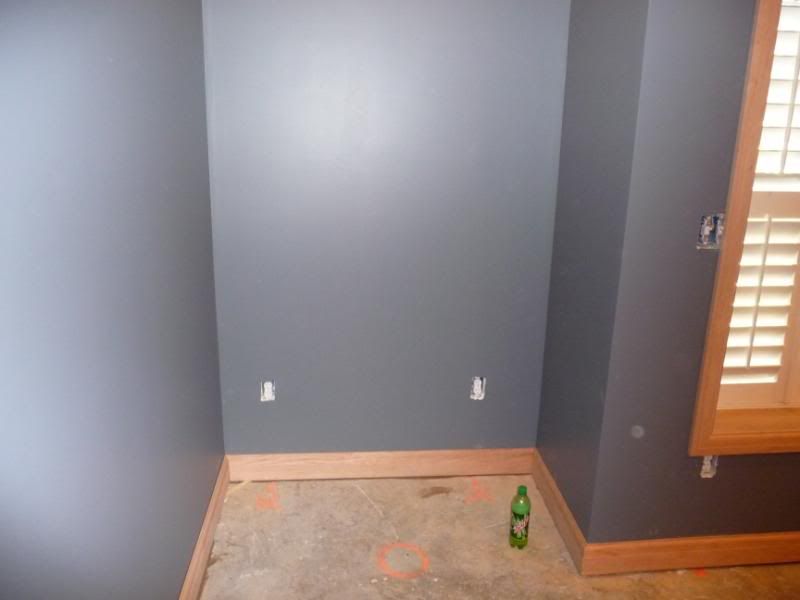

10/29 - 11/1 Progress!
My cherry baseboard/casings came in a couple of weeks ago but I hadn't touched them. I finally started getting everything put up.
Special thanks to Harrison Millwork that gave me a great price!
I didn't take any specific pics of cutting/installing them...but here's some pics...
Door casing around bathroom:
Closeup showing part of custom jamb and casing (nice tight fit):
Media niche:
The double window was particularly time-consuming. I spent the better part of a day just doing this....double drywall really adds extra depth!
Stack of doors off the cabinets for clear coating:
Cabinets ready for clear coat:
Some general pics of the chaos:
John

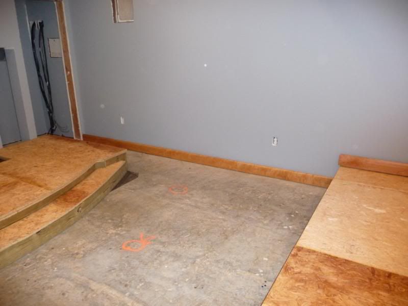

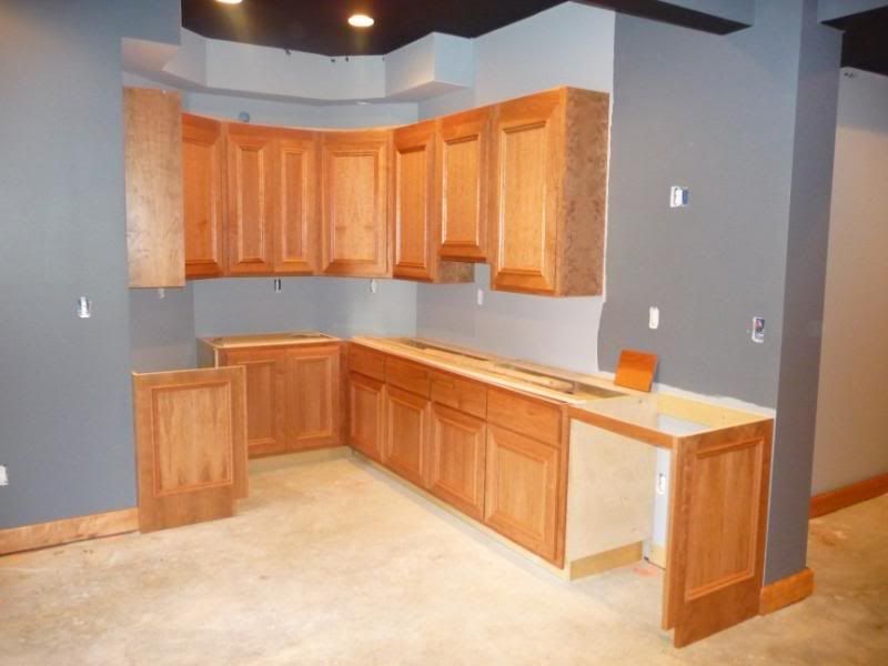

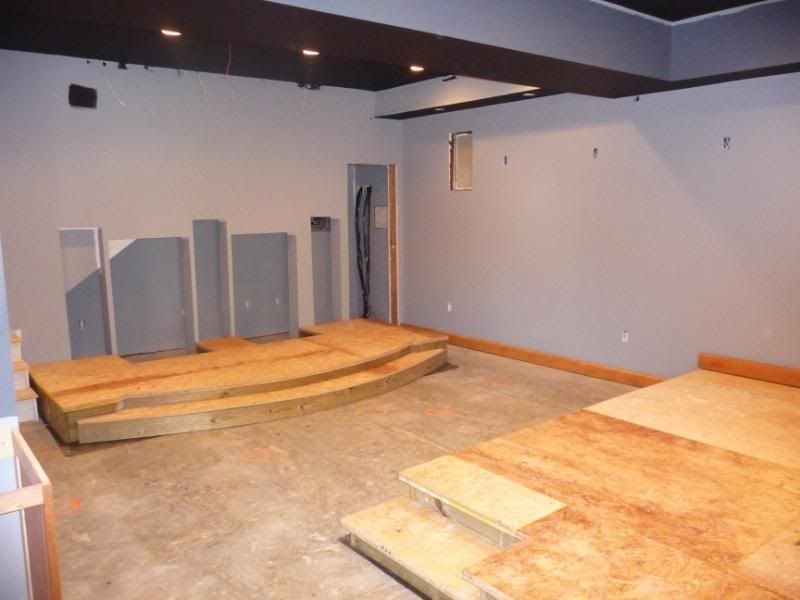

Progress Update: 11/2 - 11/3
More pics of installed baseboards. 1st coat is on the cabinets and trim. I didn't want to stain the cherry as it is beautiful (at least, in my opinion!).
John
Johnsteph10 is offline

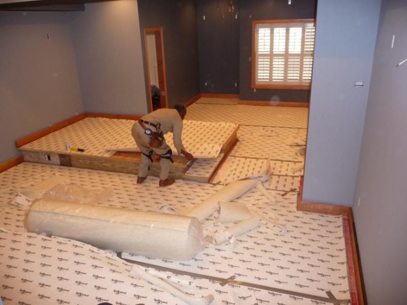

Progress Update: 11/4
Everything is clean and ready for................carpet!
John

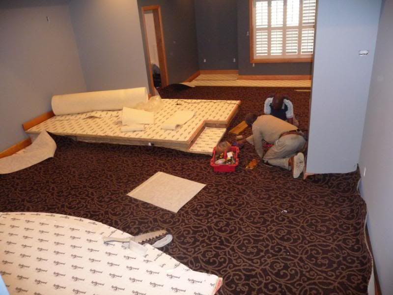

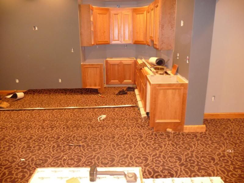

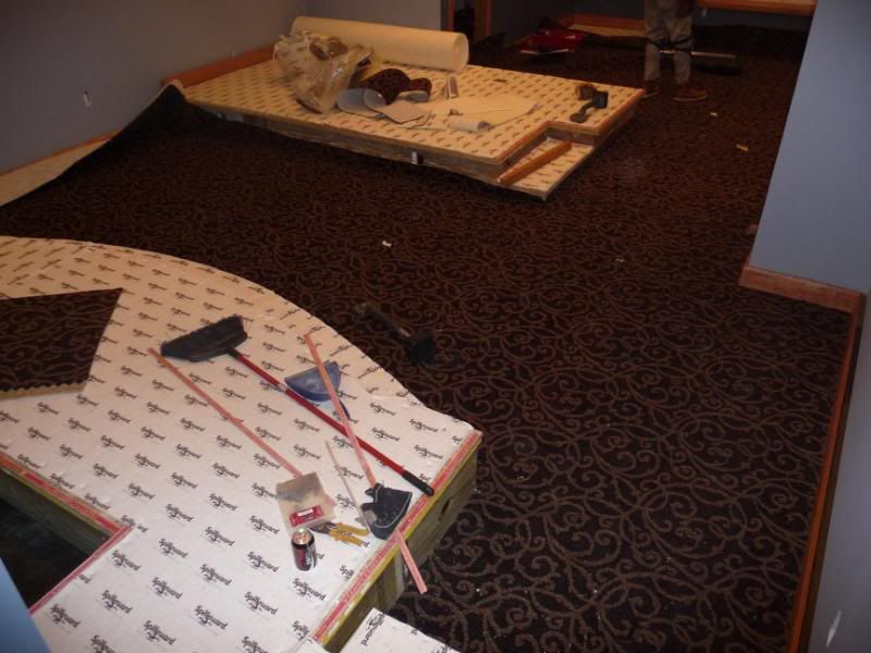

11/4:
Carpet!
Teaser Pic:
John

I went with the one that most people liked from the choice earlier...It is Masland "Athens"
Here are some pics from installation today:
Stairs down to HT with padding in place:
Putting padding down:
I went with moisture proof padding...It was a good deal more but it is also quite high quality. It makes all of the other carpet pads I've felt...inadequate.
Carpet beginning to go in:
They're going to finish the big sections today and come back tomorrow to wrap the stage and riser and do the stairs and equipment room. They say it'll be 2 full days for everything.
They were excited to do something like this as it isn't a typical installation...they said it is "challenging."
John
