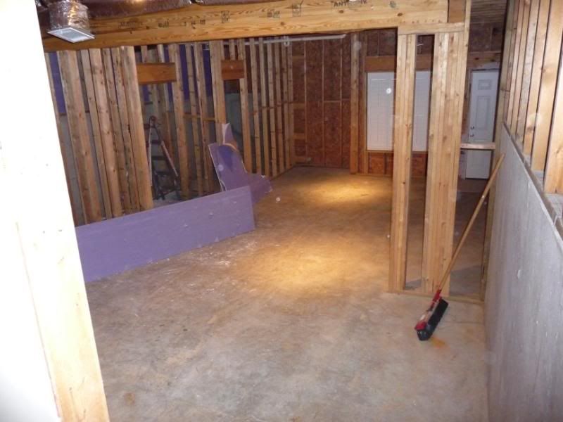

Basement Stairs Leading Down:
At the foot of the Stairs Looking into the Room:
1. Looking Straight ahead:
2. Looking Left (bathroom in left corner):
3. Looking Right (at what will be the wet bar/concession area):
Walking into the Room Looking to the Right where the Wet Bar will Go:
Looking Back at the Stairs:
Looking at all of the Stuff that has to be moved in the Joists:
Closeup of the Future Equipment Closet/Behind Screen Wall:
A Look at Part of the Framing that Will be Moved:
Partially Framed Bathroom:
Will have shower/tub, vanity
John
Johnsteph10 is offline
post #3 of 890 Old 12-28-2008, 03:43 PM - Thread Starter
Johnsteph10's Avatar
Join Date: Aug 2004
Posts: 4,216
Quoted: 31 Post(s)
Liked: 24
As you can see,
I first had to tear down some of the shoddy dry wall work the builders had done 3 years ago when the house was built. It was terrible! It equalled around 15 contractor's bags of drywall broken into small sections to fit. That was a pain in the butt.
The other thing I had to do before getting started consisted of throwing out all of the crap that the previous owners left down there. That in itself was over a full days worth of work!
I think those were all of the initial round of pics I took.

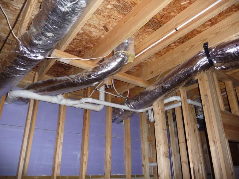

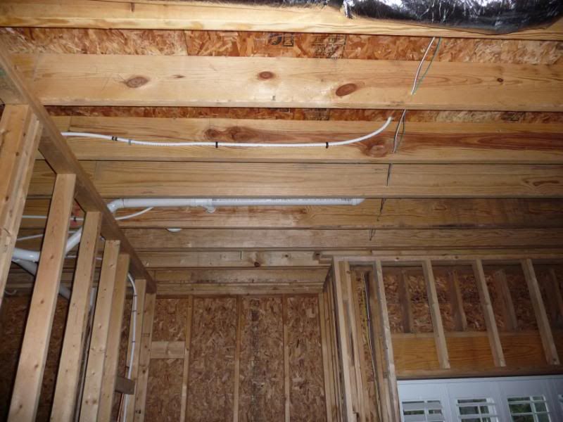

HVAC update:
HVAC flexible ducts are now re-routed to be either enclosed in soffits or raised to run in the rafters.
When I pulled down some of them, it looks like the builders basically used them for garbage cans....cigarette butts, pieces of grout, a newspaper, gloves, scraps, etc. I couldn't believe it!
Rerouted Flex Duct to run along walls:
Another view of the same:
Now entering through the wall along the main support beam:
Moved air intake up the wall:
Newly empty space in joists:
New low-profile 90 degree boots to keep them in the joists:
More duct-work on other side of main support beam (lam joist):
Vent running over bar (will be enclosed in soffit):
We'll have to see if I get enough air exchange (especially in the hot GA summer)...

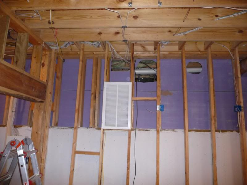

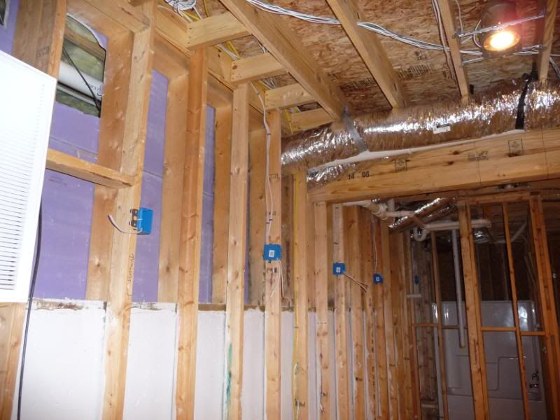

Wall on left as you walk down into the basement:
Note that the Lutron Graphic Eye is located at the bottom of the stairs.
I also mounted 2 outlet boxes for either sconces and/or lit poster frames (to be decided later).
The duct will be enclosed in a 12 inch deep soffit and (hopefully) lined with insulation/duct liner for dampening..and maybe to act as somewhat of a bass trap if I can put enough insulation in there..
Left side of theater with outlet boxes/sconces in place:
This wall will also have a 12 inch soffit stuffed with insulation..
John
