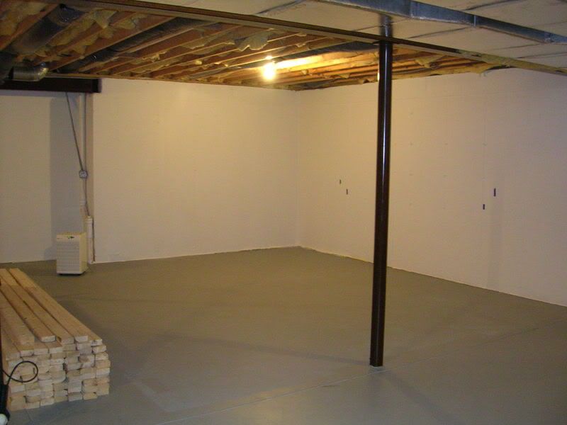

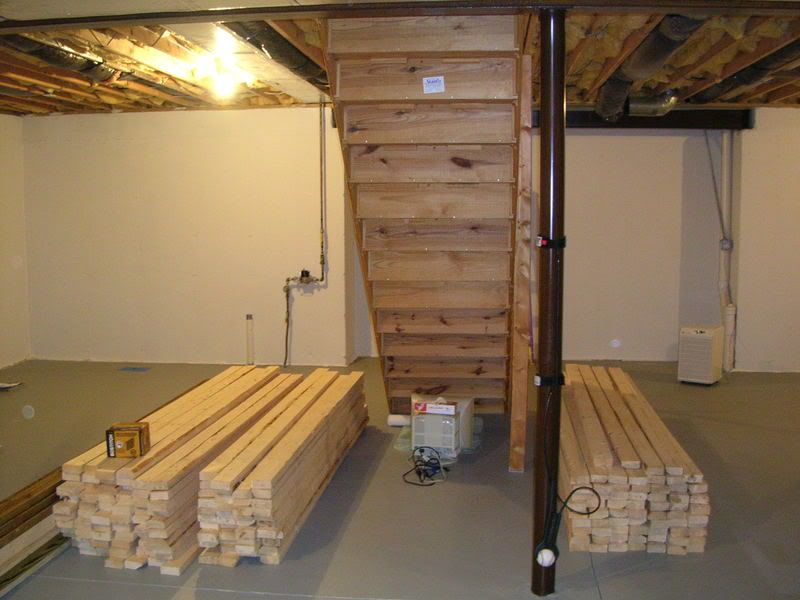

So, what did all this look like when I started? Well, pretty empty. I cleaned out the whole basement. Pushed everything into the back area that wasn't getting finished and got it ready to be framed out.
Ok, time for a confession. So this was a DIY project right? Well, I didn't do everything. It took me two years as it was, I needed some help
I had a contractor (thanks Johnny) frame out the entire basement. Then I had a electrician do *most* of the rough electrical. The contractor handled getting a plumber for the full bathroom and wet bar. The contractor also got someone to do the drywall. The drywall guys never heard of Green Glue, never mind actually doing it. I only DD/GG the HT room. All the walls and the ceiling. The ceiling was also done with furring strips over the joists to give me a little more sound isolation.
I ended up doing all the low voltage wiring and rough electrical in HT.

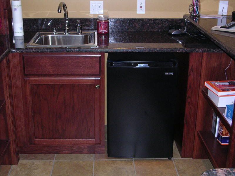

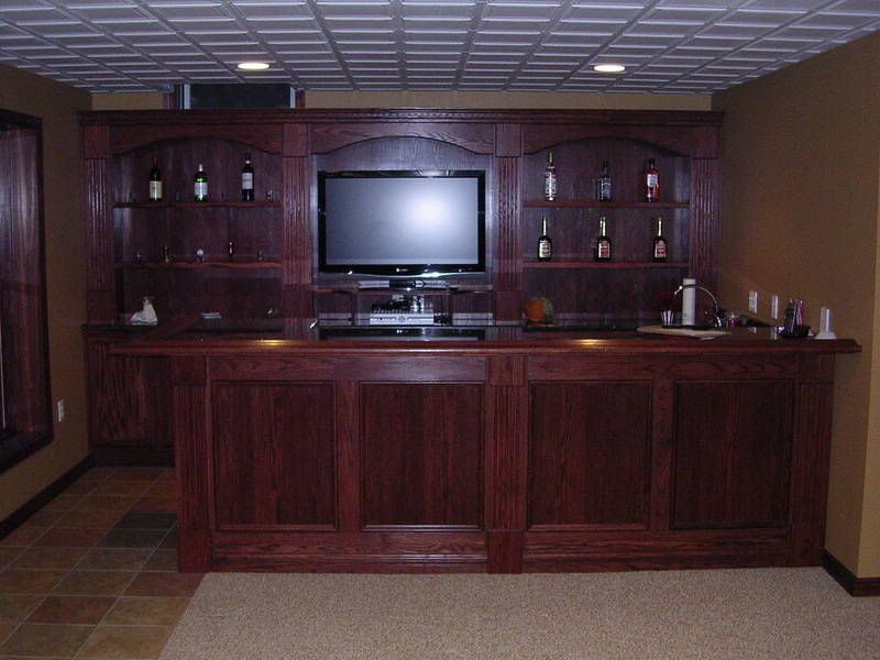

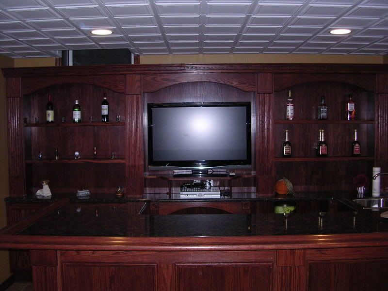

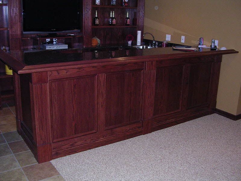

So, what the heck took me so long? Well, I had to finish the rest of the basement before moving to the HT. That was the deal with the boss, so that's what I did. The rest of the basement is basically one big room made up of a bar and sitting area. The sitting area is a couch with a 50" Samsung DLP for my son to play XBox360 on.
The bar is red oak with a granite top. I can't take credit for the construction of it, but I can for the design and finish. My wife and I did all the staining and polying. I used Sketchup to design the bar and give the constractor a vivid description of what I wanted. I'm real happy with how it came out.
One thing missing is a brass rail. I was supposed to buy that about 18 months ago, but got side tracked with something else. Hmm...
Main shot.
Bottom close up.
Fridge and sink in the back.
Back wall.
Shot from hallway approaching the main room.
ejhuzy is offline

Is that a window behind your bar? Everything looks good - can't wait to see more build pics.
WingZero94 is offline
post #14 of 205 Old 01-06-2009, 06:56 PM - Thread Starter
ejhuzy's Avatar
Location: NEPA
Posts: 1,190
Quoted: 17 Post(s)
Yeap, there's a window up top and a large window to the left.

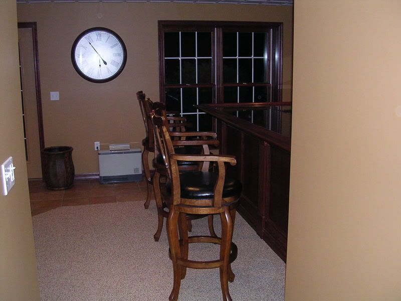

Originally Posted by Screen Shot View Post
Could you post a pic of the sitting area with the couch and Samsung DLP?

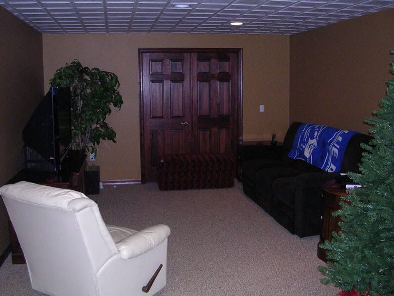

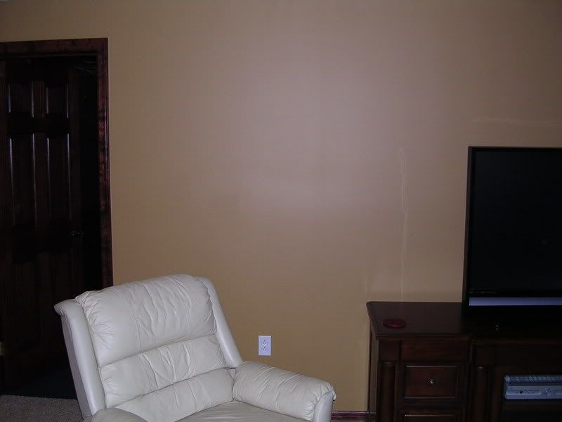

Screen Shot, here's the rest of the bar area. Pictures aren't that great, but you should get the idea. Taking these pictures reminded me we really need to move on to the decorating phase. Pictures especially.
This picture shows the spot on the wall where I hope to hand a ticket window ala chinadog. I think it's a perfect spot for one. That door is the entrance to the HT.

Love the room - it has provided me with some ideas to update my basement theater / game room.
I actually showed my carpenter a pic of your bar to quote me a price.

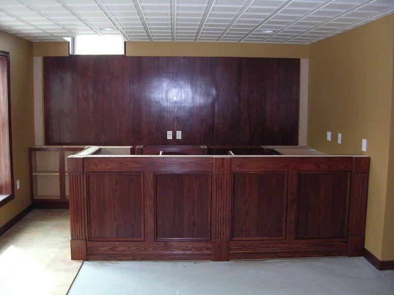

Screen Shot,
Glad I could help. I may actually have a few pictures of the bar during its construction. Also, if you or the carpenter have any questions on "what's that part made up of", just let me know.
ejhuzy is offline

Originally Posted by ejhuzy View Post
Screen Shot,
I would love to see any bar construction photos you have. Thanks.

I thought I had more, but this is all I got
Let me see if I can give some info to help you. I remember when my wife and I were staining all the wood (we did the pieces before they were assembled), she just couldn't imagine how all this "flat" wood would make a nice bar.
The bar itself is a 2x4 wall secured to the concrete floor. I had the installer cover it with 1/2" MDF. This gave the inside under the top a nice smooth finish. The outside of the bar is then covered with 1/4" oak plywood. Same is true for the entire back wall you see in that picture.
Once the bar was covered in the plywood, the boxes are built by applying 1x6 oak stock horizontally on the top and bottom. Then 1x4 oak stock is applied vertically between the 1x6's. This gives you your "boxes". Then I used 1 1/4" "shelf edge" trim from home depot to frame out the boxes.
I use fluted wood and plinth blocks to give it some dimension. These are on the ends and in the middle. For the middle, I used two 1x4's with some space between them to give me the width to apply the fluted piece over. (I can give you close up pictures if that helps).
To save money and keep the wood finish color the same, I used unfinished cabinets from Lowes for the back wall. You can see some to the bottom left in the picture. I used a double door there and then another to hold the sink on the right side of the bar.
Most of the oak for the bar came from HD. The fluted pieces were custom made (although I now know where to get them on-line). The "valances" on the back wall were made out of regular stock. Jigsawed then routered to give a fancy edge.
Hope this helps. Keep the questions coming!
