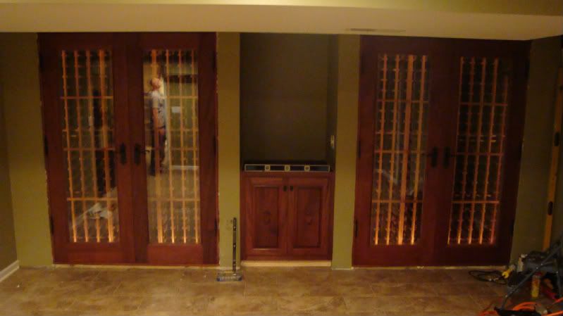

Here is the front of the room where the TV, L/C/R/SW will be
Second Picture is where the custom wine cellar is going. There will be 2 sets of french door openings with a dry bar in the middle, should hold about 525-560 bottles.

Here are some more pics now that the wine room and system is almost completely done:
