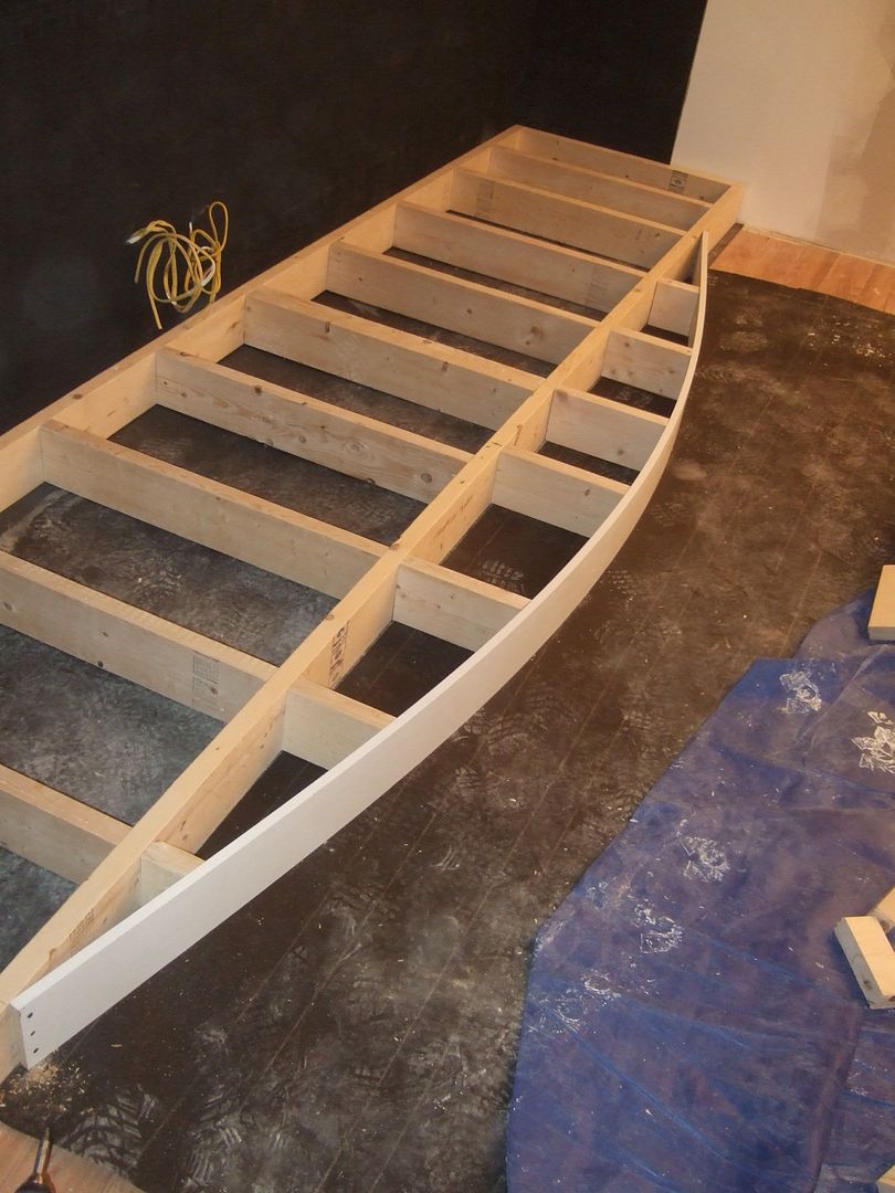

I built this one for Jesto it looks to have the same shape as your sketch. The back part is two easy to assemble parts moved into position.
The front is based on simply bending a composite wood board.
Then fitting in rest by laying the boards on top and marking where to cut and what angle. Mark one then make a duplicate for the other side. Just slide in until it fits and LOOKS about right.

Originally Posted by berg0 View Post
Also, was the curved board in front anything special? I was planning on using plywood for the curve, but I'm not sure how well it will work.
Plywood works but you would probably need to use two pieces to get the length, we used 3/8 plywood for Damelon's stage. I like to use a single piece of wood if you can find one long enough. It takes the shape of a curve a little better with a single midspan spacer as shown in the picture. I can't remember the particular brand of board we used but it was one of those rot proof man-made pieces of lumber that acts more like plastic than wood. We can get a brand of board locally at HD called Tuff Board and I think that is what we used.

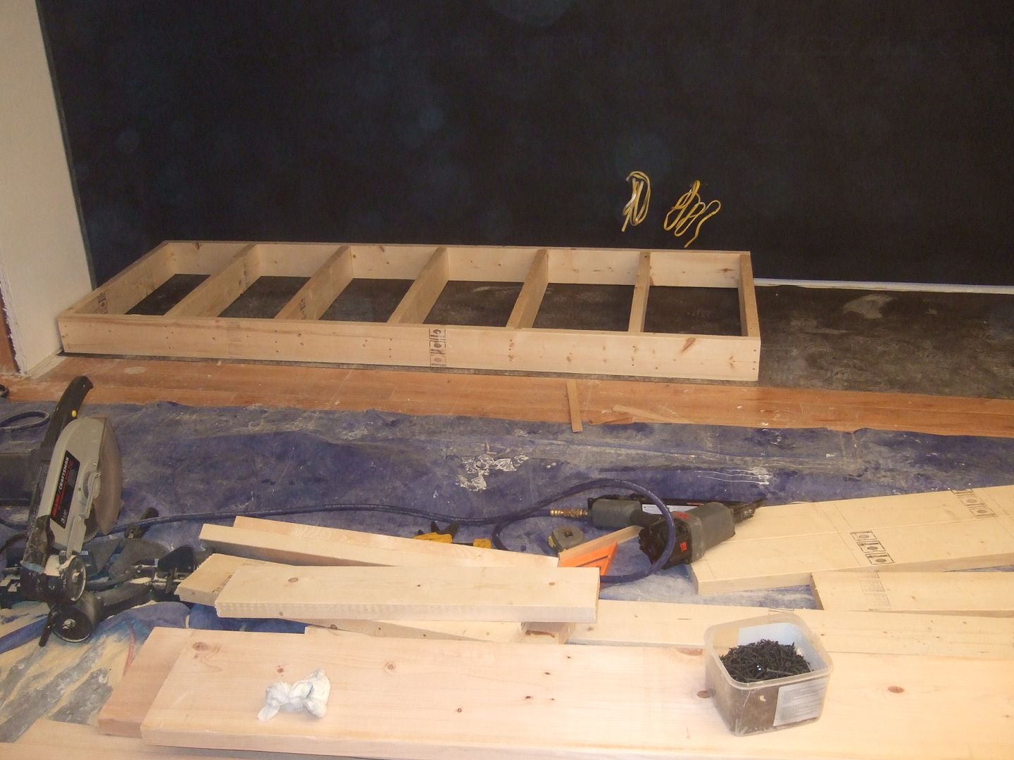

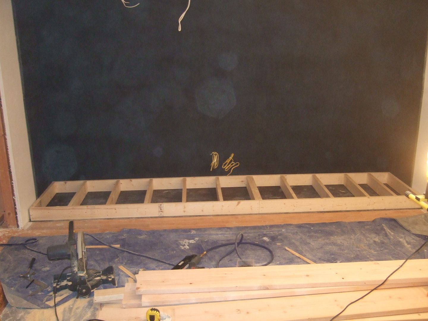

post #40 of 51 Old 01-21-2012, 09:05 PM - Thread Starter
berg0's Avatar
Join Date: Jul 2009
Posts: 44
Got a start on my stage this evening, hope to finish up tomorrow, and get the screen wall put up next week after my ceiling gets retextured.

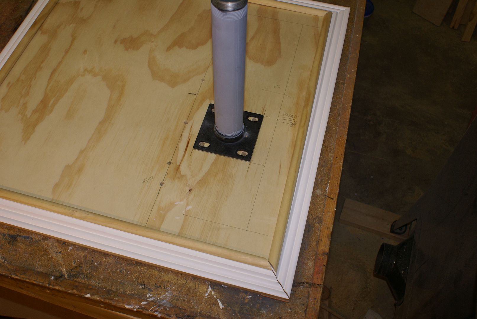

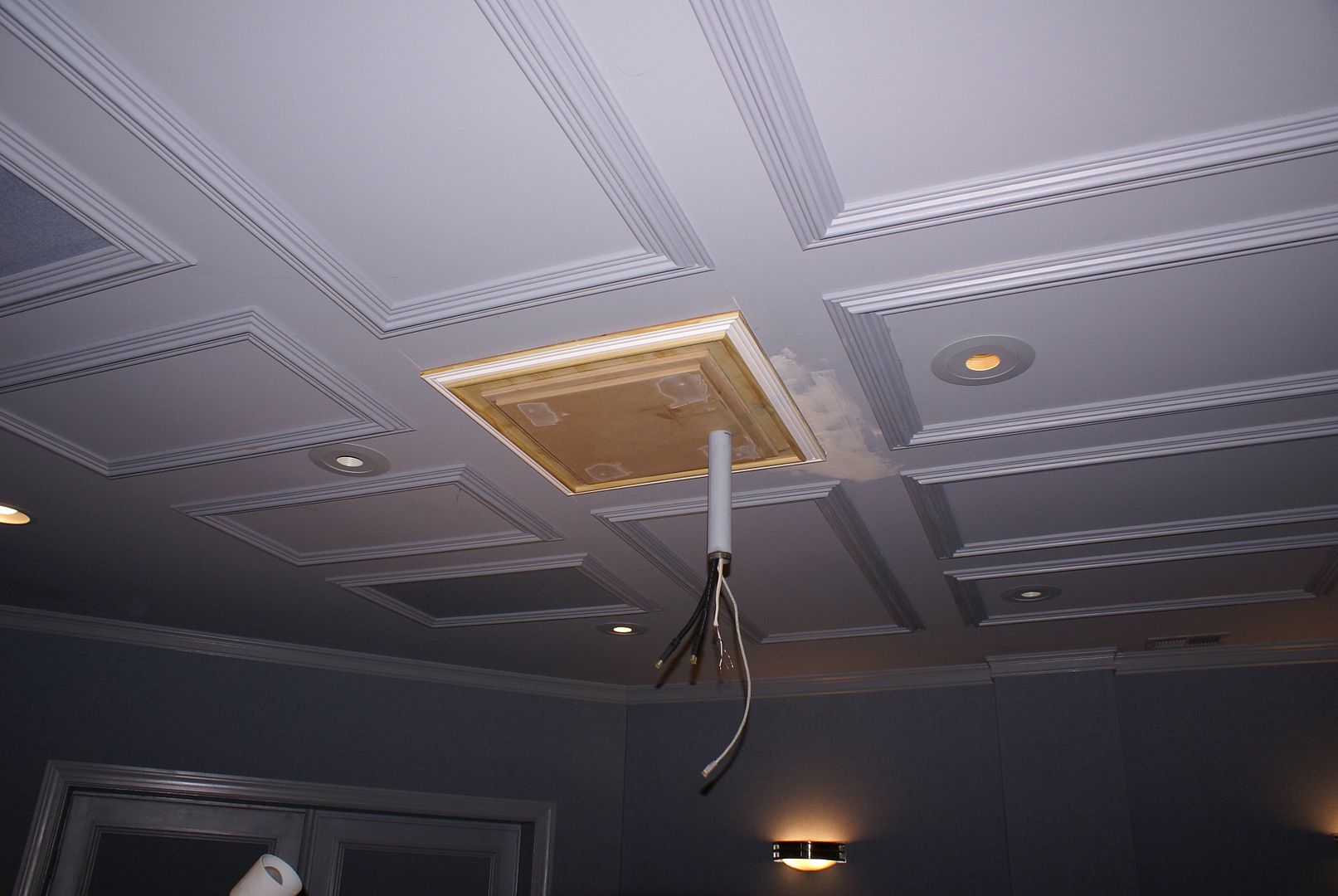

Any advice on how to mount a projector, without it looking really poor? My ceiling is already finished in drywall, initial idea was to use some 50lb holding drywall anchors into the drywall, screw in type, but now realize that is not recomended. My new plan is to use a 2'x2' sheet of 3/4" MDF with a routered edge as a mounting plate, lag bolt it into the joists above, and hang the PJ off of that, but I"m a bit worried it will be large and unsightly, any advice?
berg0 is offline
post #43 of 51 Old 01-23-2012, 08:20 AM
Posts: 26,354
Mentioned: 126 Post(s)
Tagged: 3 Thread(s)
Quoted: 2617 Post(s)
Liked: 2204
Dress it up and paint to match the ceiling.
post #44 of 51 Old 01-23-2012, 08:33 AM
cuzed2's Avatar
Location: Chicago Area
Posts: 4,814
Mentioned: 16 Post(s)
Quoted: 133 Post(s)
Liked: 189
PJ mount - turned out great.
Adding the tiered layers of MDF really did the trick!

Any thoughts on mounting my projector like this:
I just happen to have a conveniently placed joist above my projector mount, I could lag bolt the MDF to the joist, then mount the projector mount to that, or can I just lag bolt my mount to the joist, and use 50LB screw in metal drywall inserts for the front of the mount? I have no will work on my ceiling, and feel the MDF might look out of place.
