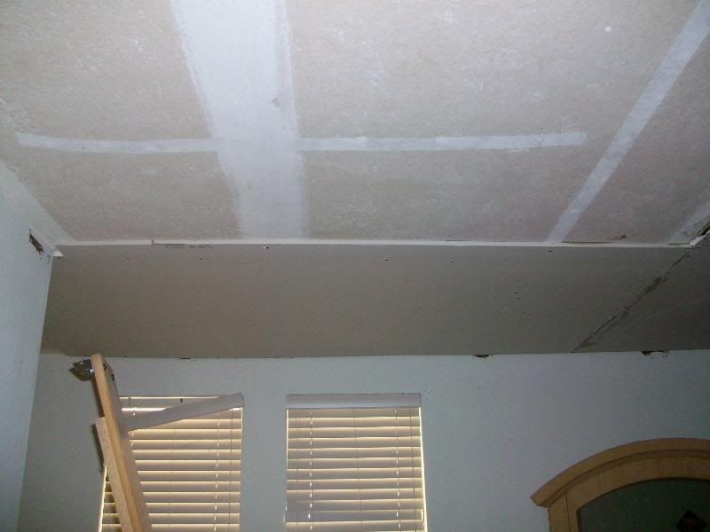

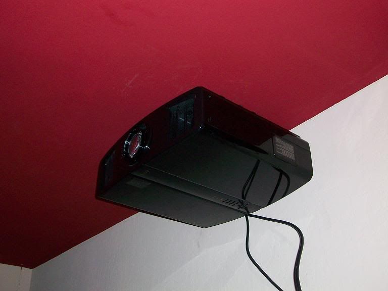

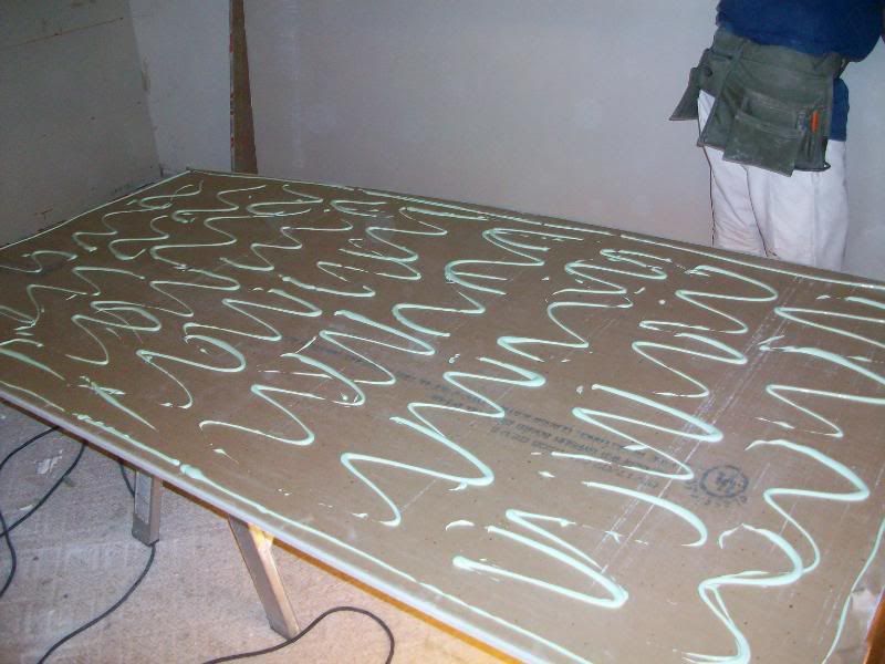

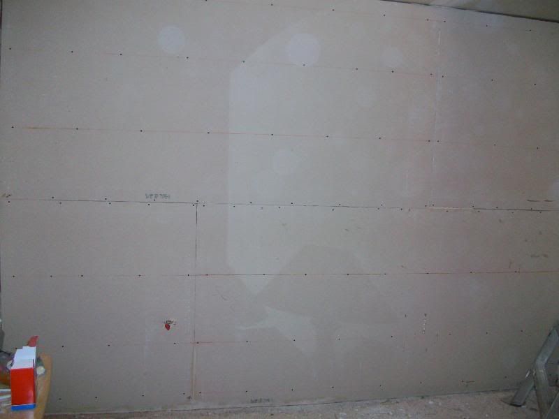

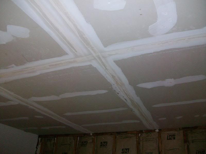

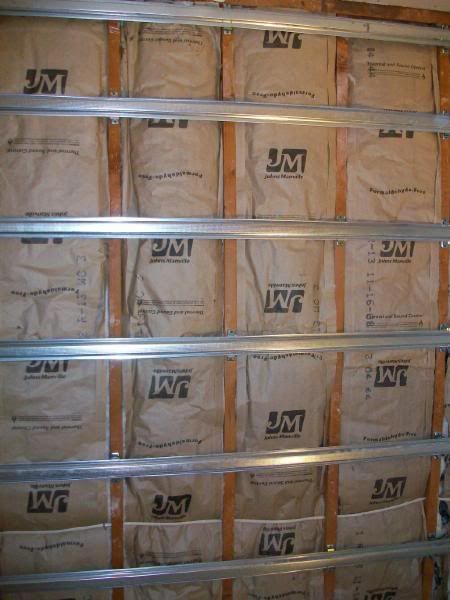

Since I live in a condo and I don't my neighbor (Complex Manager) complaining while Im watching a movies I deciding to do a little soundproofing to the wall that we share and the ceiling. Ted White and John Hile were extremely helpful with this. I used R-13 insulation,Green Glue,Whisper Clips,Hat Channels,3 Pieces of 5/8 plywood, 6 pieces of 5/8 Drywall for the wall. John Hile recommended I use 5/8 plywood so it would be stronger then drywall to hang a large projection screen. Great idea! I used whisper clips and hat channels to decouple the wall and 3 layers of mess. 1 layer plywood 2 layers drywall with green glue. The ceiling is 1 layer of drywall with green glue. I haven't gotten a complaint yet so it must be working!
Thanks again Ted and John!
Testing Out The Projector On Unfinished Drywall

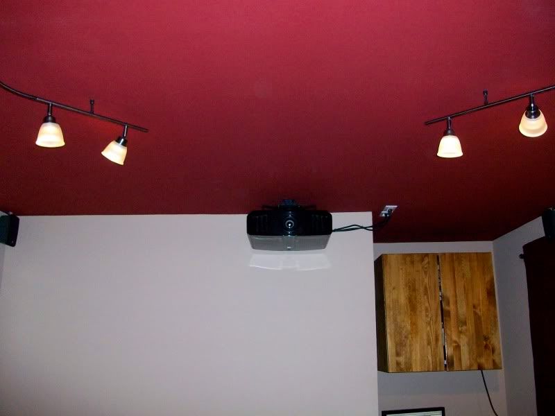

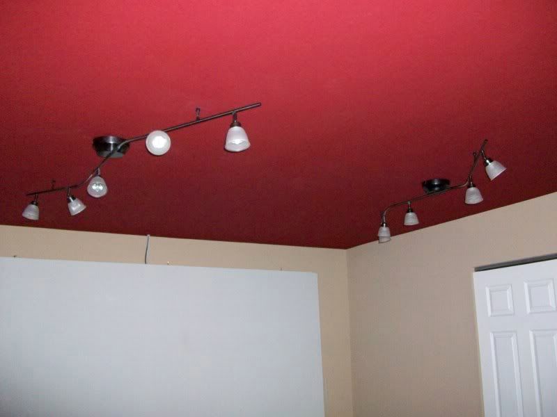

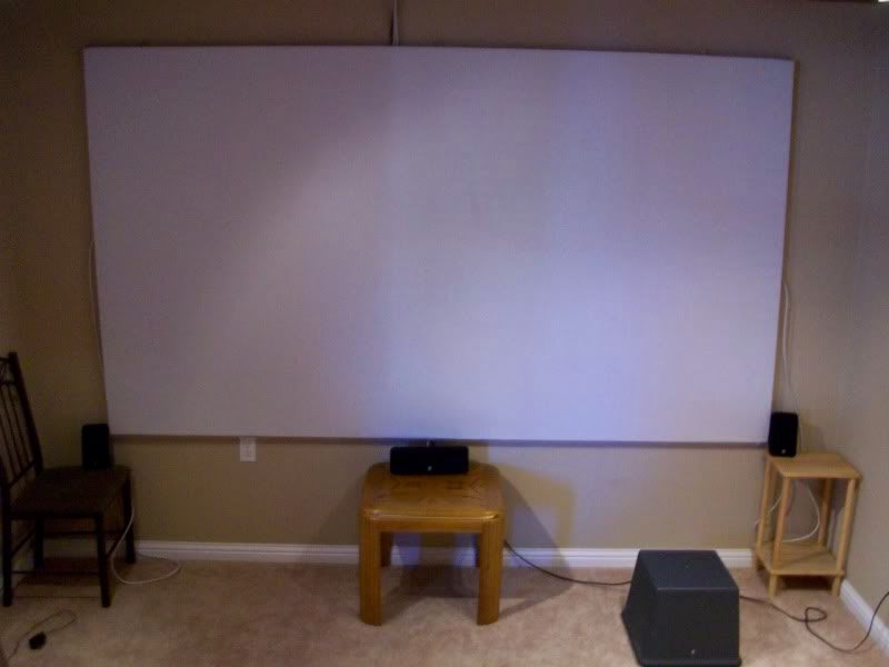

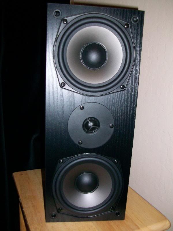

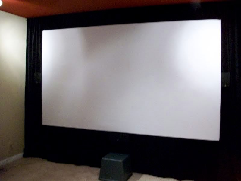

Here's some pics of the completed theater. Built the screen with Blackout cloth and some 2x2's..Came out pretty good! Thinking of using it for awhile. I would like to find some material better then Blackout cloth and that has a gain of 1.0-1.3. My grandmother use to work for a drapery company so she made me some black velvet drapes to go around my screen. Got the velvet material from Joanns Fabrics. Ran all cables and wires in the walls and ceilings then into the A/V Cabinet.
The paint colors are actually way darker then they look in the pics. The flash made the walls look like white. The red is really a dark red and the walls are a tan color. All paint is Flat paint.
Testing everything out with the surround sound
126" Screen
Officially Done

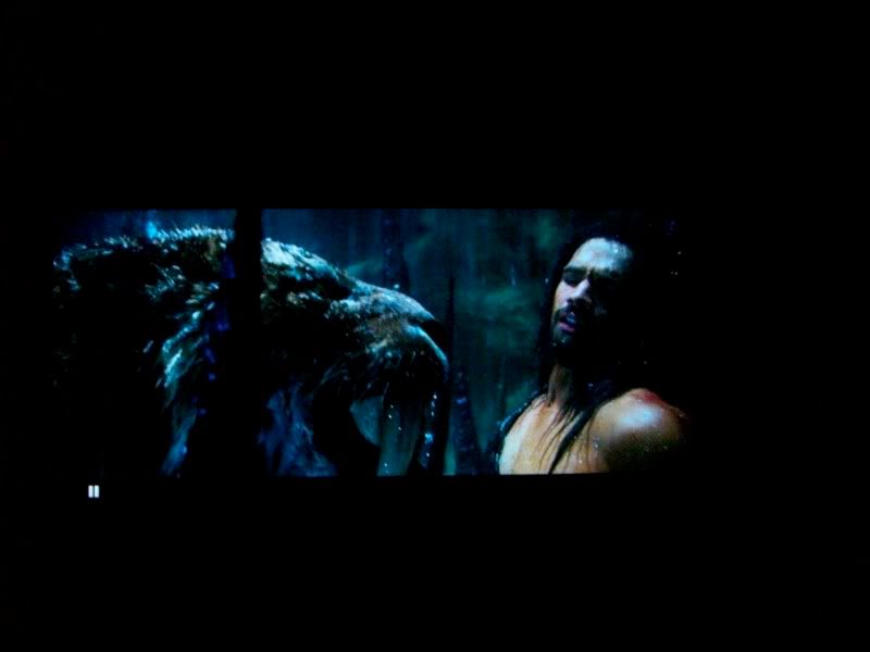

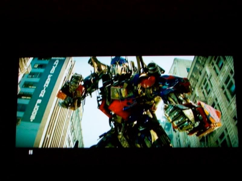

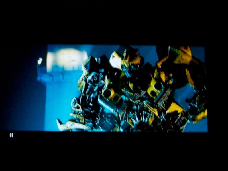

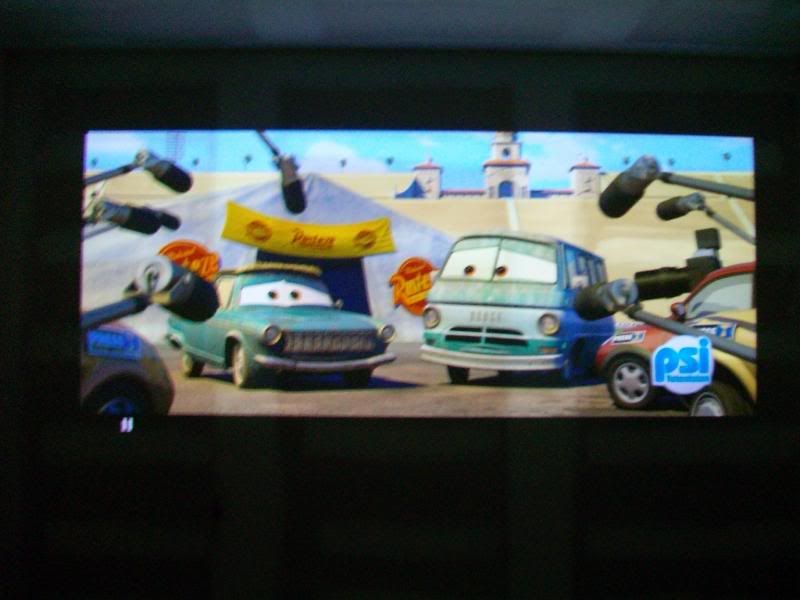

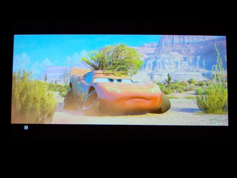

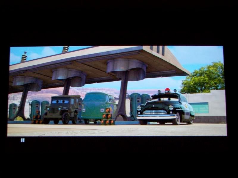

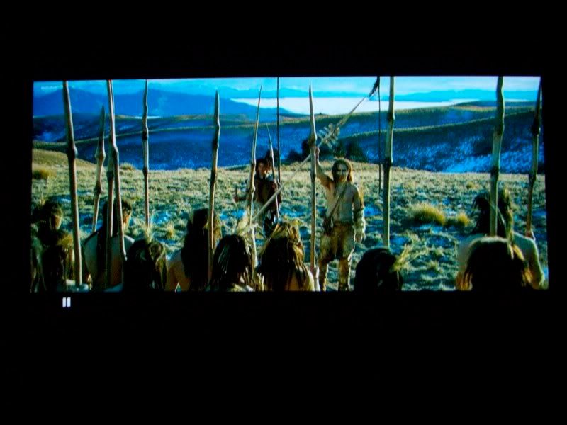

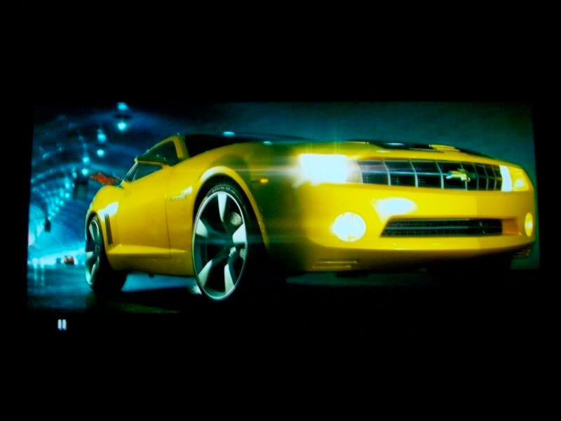

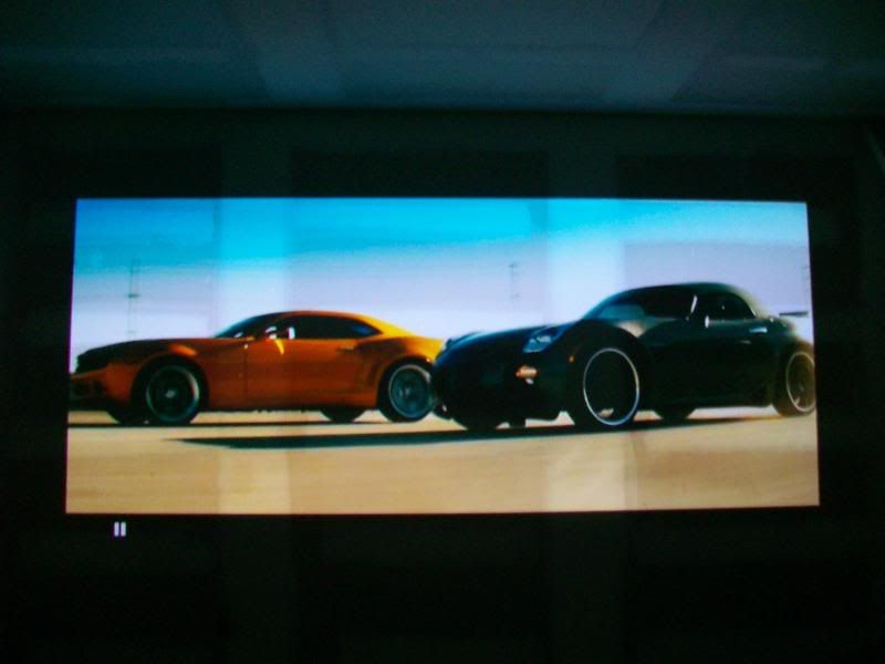

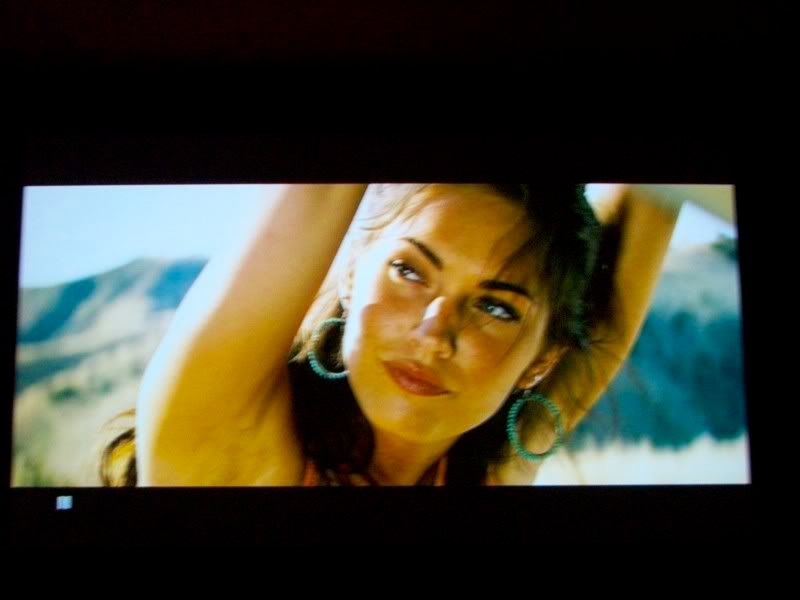

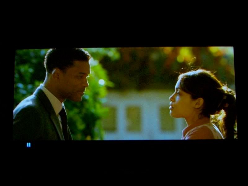

Here's some screenshots I took.. My camera isn't the best. All movies are Blu-ray. Standard DVD's look great on this PJ also!!
"Seven Pounds"
"Transformers"
"Cars"
"10,000 B.C."

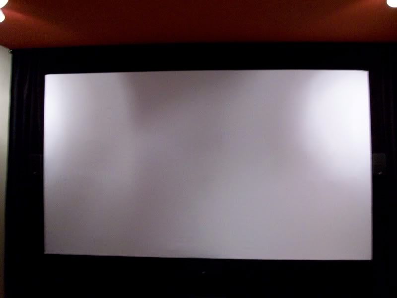

So been having my PJ room up and running for a lil bit now. Almost got 100hrs on the bulb. Picture looks good! Still using black out cloth. Hoping to get a screen with some gain soon. Would like a little brighter picture.
Does anyone have any tips for improving contrast in my setup? I know a black room would be best but I can't do that. So any other ideas anyone might have please share.

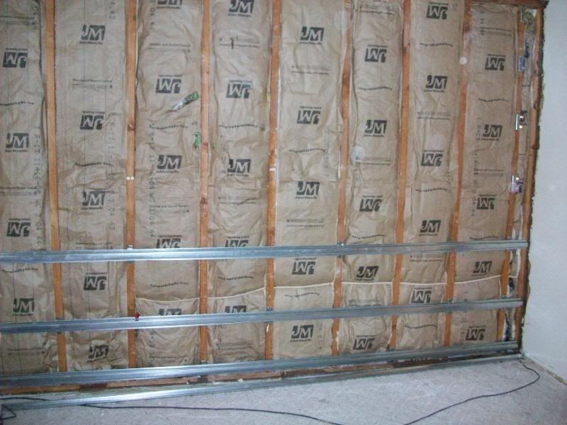

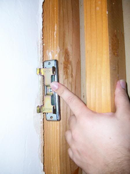

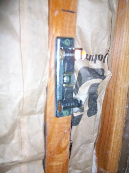

looks great man, but why did you use those metal clips for the plywood and drywall and not just screw the plywood to the studs?

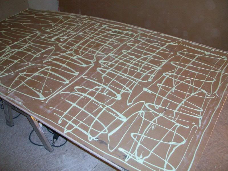

Because I soundproofed the wall.. One of the steps to soundproofing is to isolate the wall using hate channels. If you just screw the playwood/drywall to the studs it won't soundproof low frequencies.

Order some new speakers from The Speaker Company. Here's a quick pic I took of one of the speakers. I will take more once my speaker stands get here.
LCR3

post #24 of 40 Old 12-14-2009, 07:53 PM
tlllava's Avatar
Join Date: Apr 2003
Location: Elkridge, MD
Posts: 284
Oh thank God on the speakers. When I saw older photos, I wondered why you bothered with all the isolation. Those computer speakers you were usng weren't much of a threat. Anyway, I hope your hard work has paid off.

post #25 of 40 Old 12-14-2009, 08:29 PM - Thread Starter
Chrisx510's Avatar
Join Date: Mar 2009
Location: Bay Area, CA
Posts: 1,547
Yea those Boston Acoustic were from a HTIB that I had so I used those until I got some new ones. These TSC speakers sound pretty good and can't beat them for the price. But I am still going to upgrade to some $2000 speakers in the futue. Im hoping in the next 6 months but if these new TSC speakers keep me satisfied I might stay with them longer then 6 months and put the $2000 into something else. Possibly my Carada Masquerade Masking System..

Purchased a PopCorn Hour A-110 for my HT Room.. Loving it so far.
My First Home Theater
300 Blu-Rays, 150 DVD's loaded in my Movie Server!
Thanks AVS for making me addicted to this hobby!
Chrisx510 is offline
post #29 of 40 Old 01-08-2010, 04:29 PM - Thread Starter
Chrisx510's Avatar
Join Date: Mar 2009
Posts: 1,547
Nomore Blackout Cloth screen! Just picked up a Carada Criterion screen. I won't be installing it for a few months but couldn't pass up the deal. I am currently redoing my HT room and adding some new toys.
