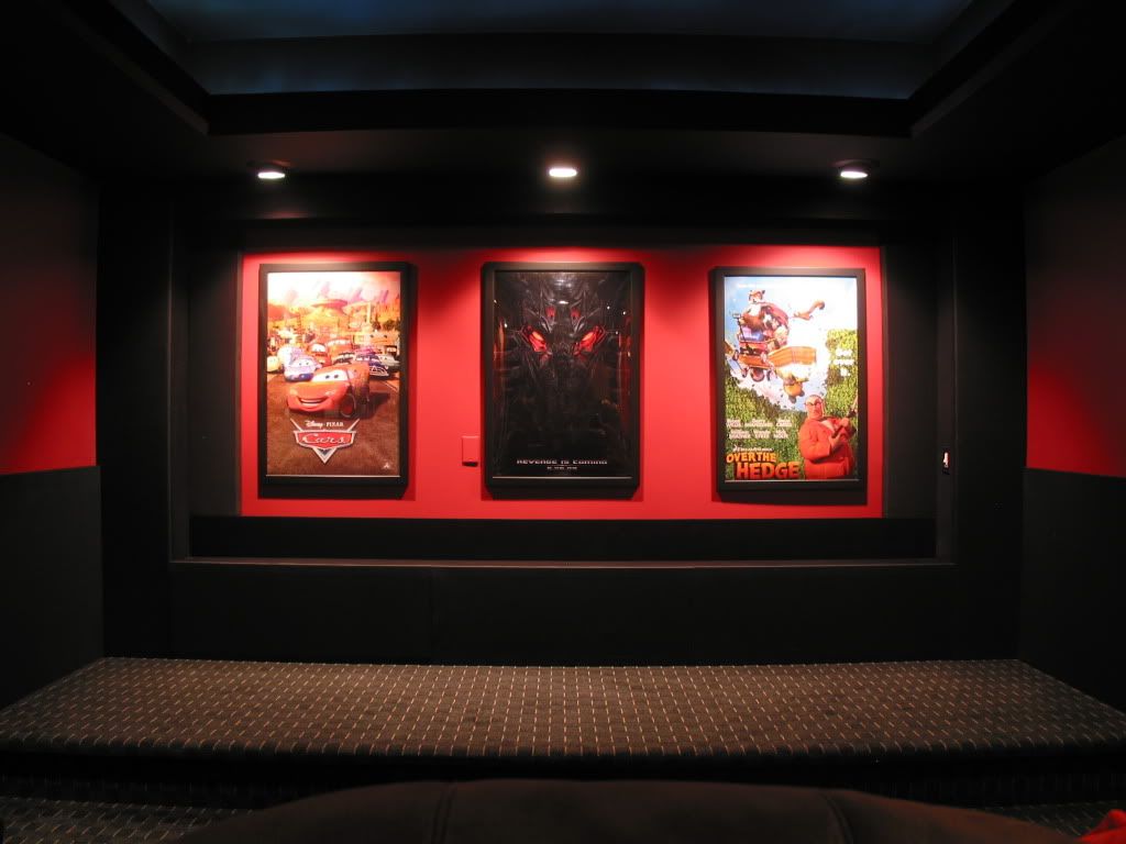

Here is an updated pic on my IB project. Four 18" drivers will be inserted into the screen wall with two on each side. The storage room behind will act as a 700 cubic foot subwoofer. I had to adjust the screen wall to accomodate the drivers and here are the before and after pics. The wife was concerned I would screw up the look of the screen wall (all for some silly old subs )
As you can see the impact is very minimal and easy to over look.
I scooted the posters in a bit to create room for the drivers. The grills cover the part of the drivers that would be exposed in the room - about 10" wide. The grills look like side masking. You would never know what lies behind, until you hear/feel it. When I get the final two drivers installed I will post a pic showing the drivers.
How it looked before, note the lack of grills to the side of the posters.
With the grill covers over the subs. Not too much visual impact on the room. But what they hide is oh so impactful.

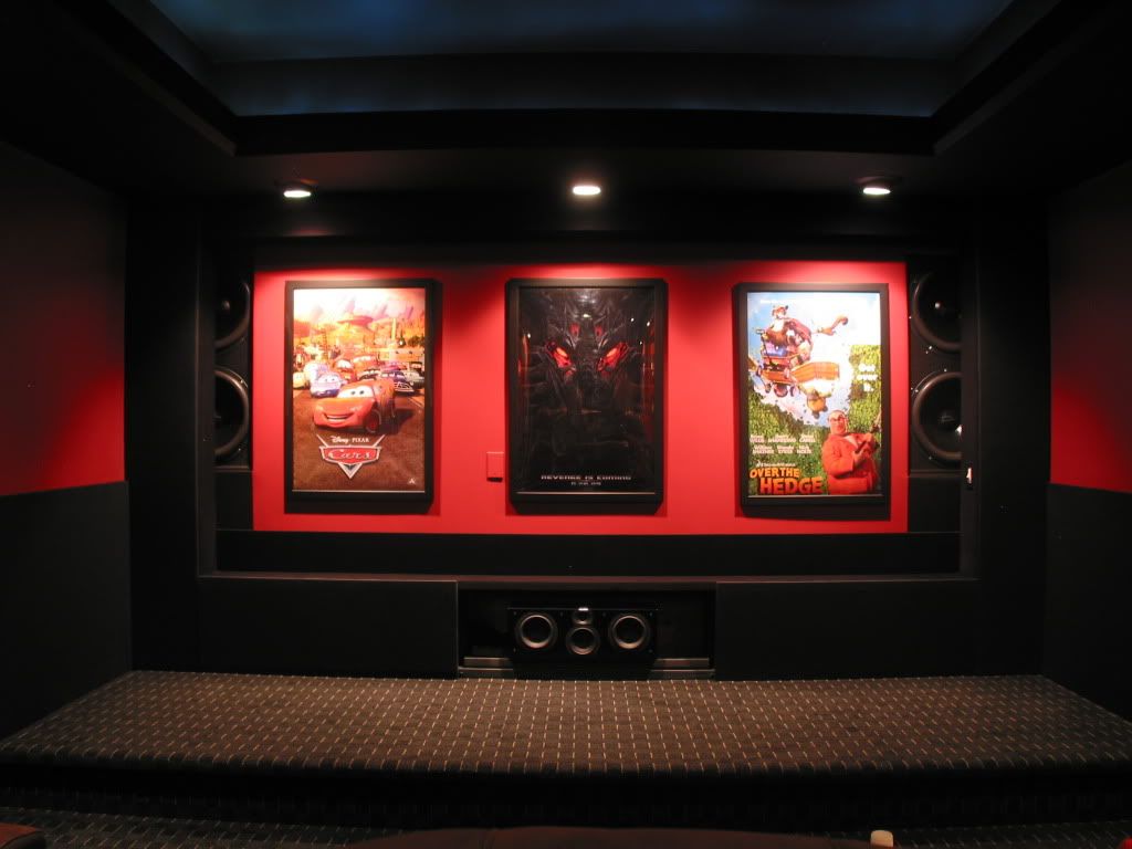

I found a picture with the grills off. You can get a better idea how the drivers are situated in the wall. The right side has the two 18" drivers installed. They look small in the picture but when you stand next to them you get a greater appreciation of their size.
The left side is just waiting for the next two drivers to arrive. I have MDF scraps to plug the hole until then.

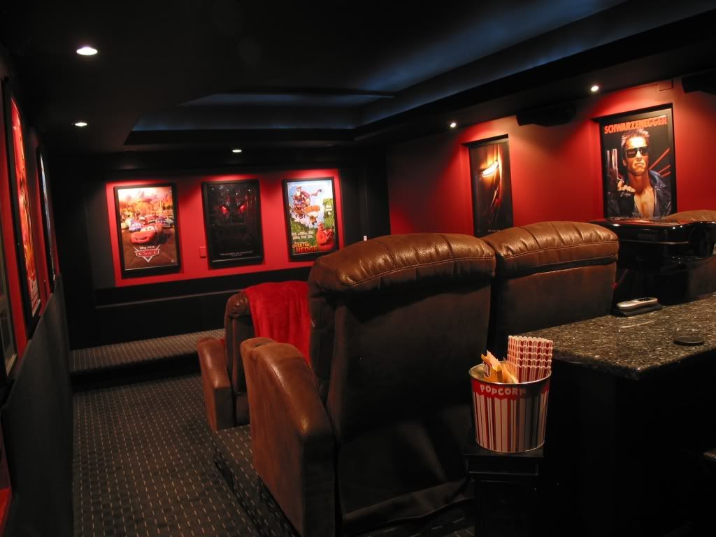

Originally Posted by GoCaboNow View Post
I wanted to post my finished pictures as many here have helped me in the process building this room. The advice and countless rooms to draw inspiration from have been key. Must say, I have had more fun planning, and building this room, than I ever could have imagined.
This is a single 13'x23'x9' room in the basement. It is hooked up to the central air but temperature stays between 66 and 70 degrees year round in this room without any help so I have the vents double closed all the time. There is an additional vent in the ductwork that can be opened or closed to help with sound proofing.
Facing the screen wall
Rear of the room
The plan was to diy a fixed screen but the high power screen fabric is a little touchy with that so I opted for an electric screen instead - which had a very high approval factor from the wife and my small daughters.
Facing the "screen wall" directly as you enter the room
Looking right over the top of the projector
Facing the seating
The rear of the room has a bar, with seating for three, the media niche, equipment rack and treadmill closet. The room was originally used as a grunge workout room and we still use the treadmill regularly. The TV on the wall makes an easy way to get the news in the morning while using the treadmill.
To the left of the treadmill is a lighted area where the AVR, Shaker amp, PS3 and HD Fios box interface with the wall jacks for the speaker wire and HDMI. Real easy to get back there and mess with the cables.
116" wide high power screen that is masked to a 2.4 aspect at 50" high 126" diag
or I can have a 57"x 101 116" diag 1.78 image if I lower the screen to the max.
This gives the same viewing area for scope AND 16x9 content
16x9 image
Here are some additional construction photos
The rack area primed
Screen wall framed
Enjoy!

The sub project is done! Eh, sort of. I will add eq and some tweaking but the four drivers are in and sound great!
No subs in the room
Ah, there they are.
The fronts are right below the screen. Here is a shot with the center channel exposed
