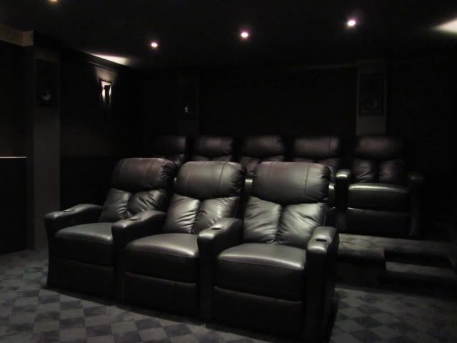

and finally, all 8 berkline 13175 motorized recliners installed and working. man, these things are sweet!

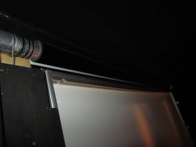

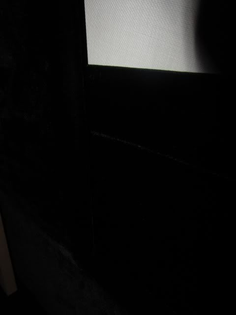

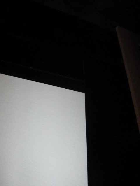

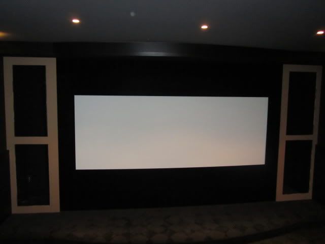

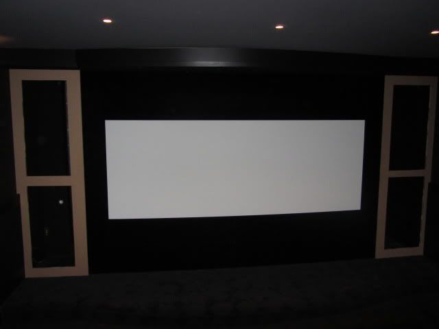

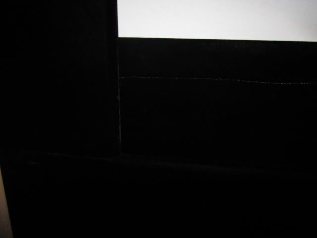

well, i can say for certain that its the WORST idea to setup your system before finishing your room!
i have been enjoying my theater immensely at the expense of leaving behind minor things to complete it. anyways, here are some further progress pics of what i've been doing these last few months.

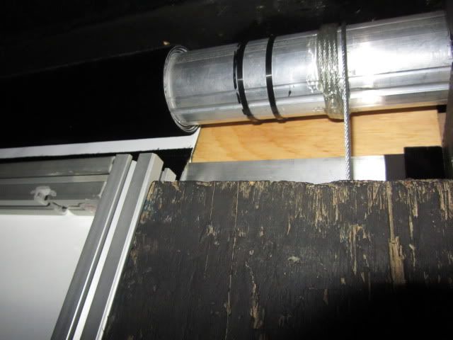

firstly, i built my own masking system from several DIY threads found here on AVS.
http://www.avsforum.com/avs-vb/showt...633842&page=25
http://www.avsforum.com/avs-vb/showthread.php?t=1251657
http://www.avsforum.com/avs-vb/showthread.php?t=941076
seems simple and straightforward, but requires a lot of tweaking and cursing to get it just right. for now, im happy and haven't touched a thing for probably about 2 months. its working about 98% perfect. next time i will most likely just buy one from carada or smx as i can't be bothered with the time and patience it took to build. anyways, here are some pics of its mechanics and final product.
WITHOUT FLASH
CLOSEUP
2.70 AR
2.35 AR
Anthony A. is offline

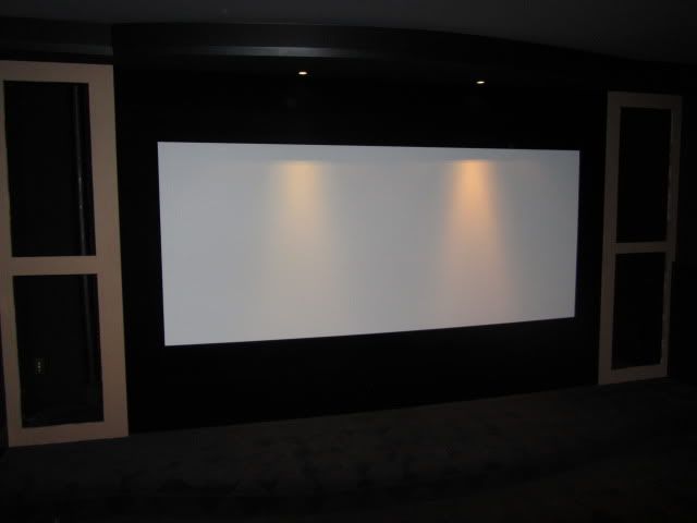

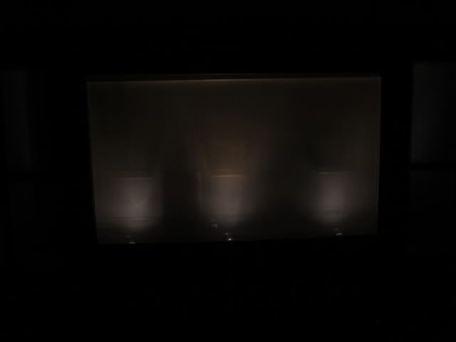

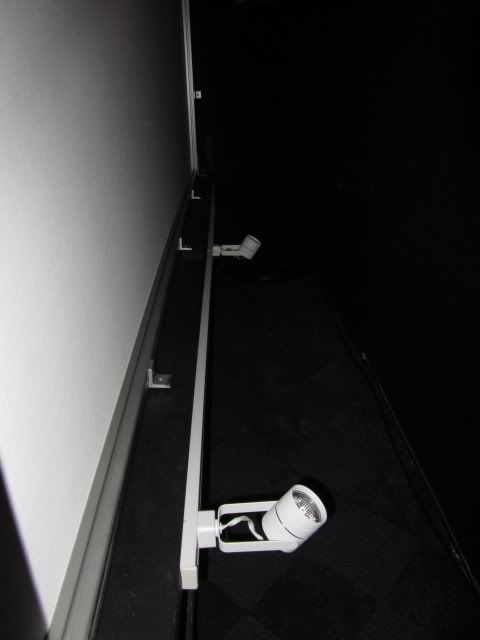

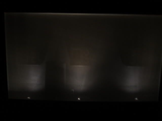

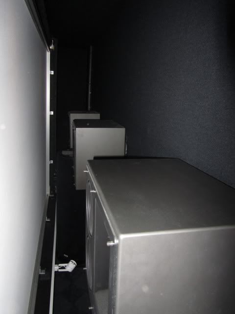

also setup the speaker spot lights behing the screen which are a really nice detail. i have it programmed as a macro in my remote that whenever a movie starts, it dims the lights to the "movie" scene which basically slowly dims everything off except the speaker spots for 5 seconds, then fades those too as the movie starts. everyone who comes over loves it and it puts a nice smile on my face.
heres the detail pics of how it looks:
its very hard to capture the right balance for a real-life photo of the effect. these pictures are not the same way it appears, but you get the idea.

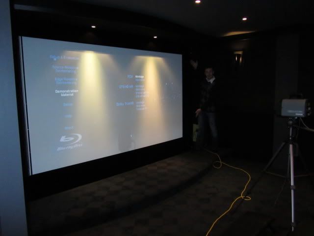

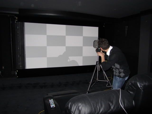

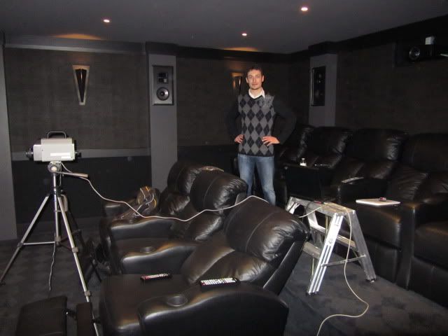

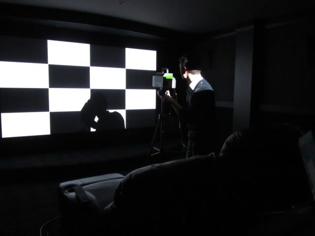

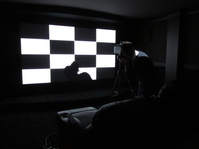

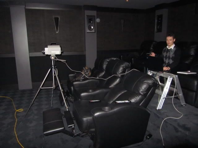

also had the pj isf calibrated a few months back by Michael Osadciw from The Highest Fidelity (http://www.thehighestfidelity.com/). great guy to deal with, very informative and experience. he is local in the toronto/GTA area and i would highly recommend him to anyone looking to have this service completed. here are some pics of him in action:

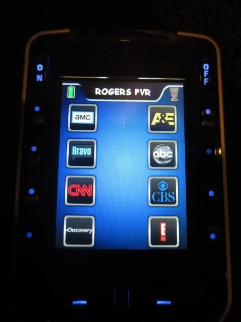

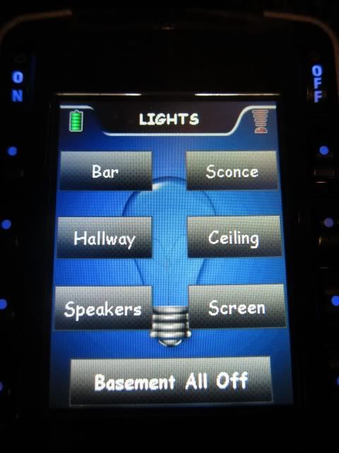

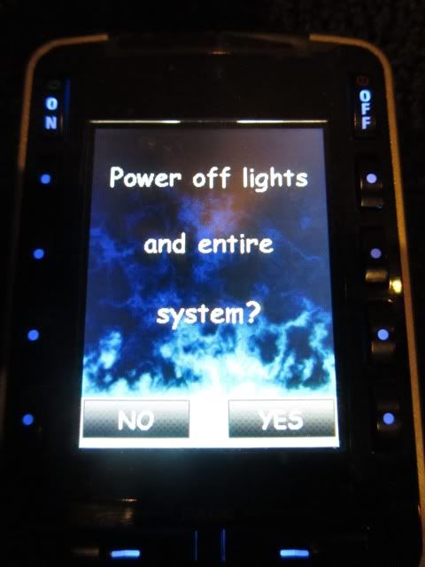

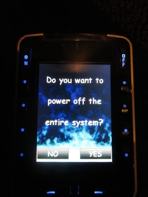

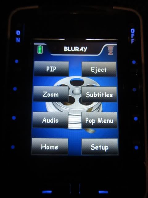

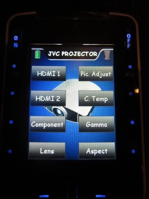

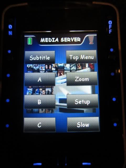

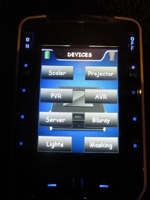

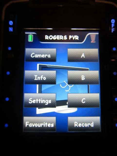

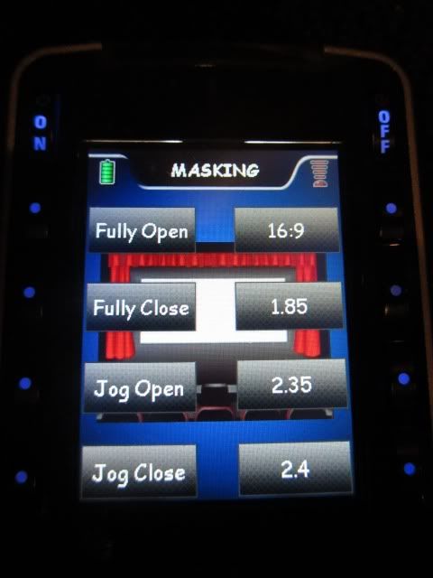

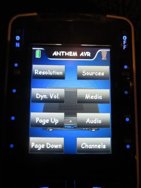

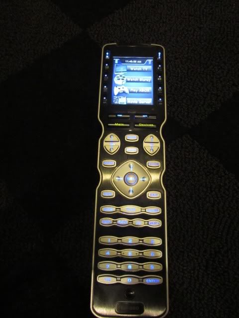

in regards to controlling the theater, im using a URC mx-980 remote paired with a msc-400 base station. the components are a mixture of ir and rs 232. here are some pics of the remote and the GUI i designed:
MAIN PAGE
DEVICE PAGE
BLURAY PAGE
SERVER PAGE
TV/PVR PAGE
PVR FAVORITES PAGE
MASKING PAGE
LIGHTS SCENE PAGE
LIGHTS PAGE
AVR PAGE
PJ PAGE
PLEASE WAIT PAGE
SHUTDOWN PAGES

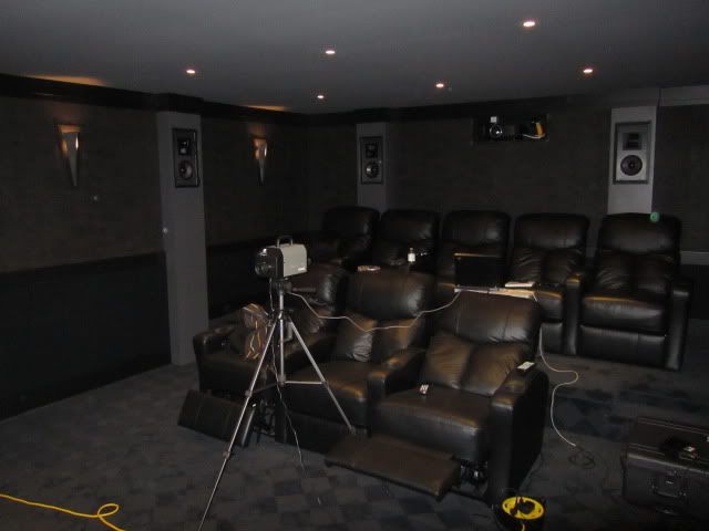

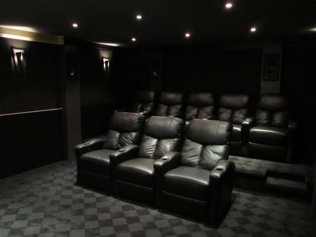

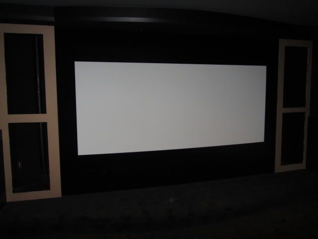

wow, 2 years since my last post lol. well i did indeed finish my theater about 6 months ago. the last item that took me a year to do was the speaker grill frames. the actual work only took a couple of days, but who feels like finishing their theater when its 98% complete tongue.gif
in any case, thought i would post some more pics of its completed state. these are the speaker grills made of a single piece of 1/2" mdf with edges routered. then wrapped in GOM. simple and easy. to hold the grills to the column, i used some speaker grill plugs (male end on grill, female end on column). epoxy sets them in for life and easy to remove when needed.
post #119 of 121 Old 02-28-2013, 09:18 AM - Thread Starter
Anthony A.'s Avatar
Join Date: Sep 2004
Location: Canada EH?
Posts: 2,577

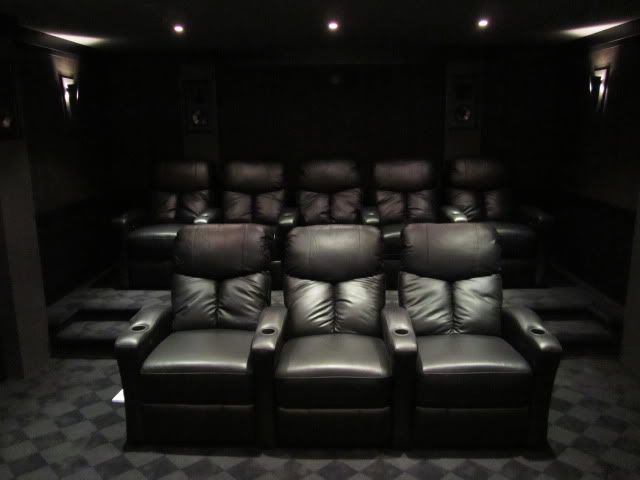

and some more room views.
Masking at 2.70
Bat Cave
