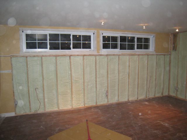

So now it's question time. First of all, as you can all see, I have two big windows on the left side. I don't know what to do about them. I have to keep them in the wall because of the overall look of the house. Here's what the house looks like from the outside:
The windows are on the bottom left. As you can see they kinda mirror the symmetry of the windows above them (the living room).
So, I have a ledge on the wall the windows are on (you can see if you look at the picture carefully). So I could quite easily build a structure to cover the windows and make a full straight wall. I am just wondering if this is safe and if there is a good way to do this. I will put some kind of reflective sticker on the windows so you can't see into the house and then I can put insulation, sealant, or whatever else to make sure there's no humidity build up, etc...
Can anyone steer me in the right direction here?

On those windows do you have any other emergency egress windows or doors from the basement. If no, don't cover them up. While they don't technically qualify as emergency exits because of the floor to sill height and the size of the window. I think you could get out in an emergency.

Bigmouth,
There are two other windows out of the basement, yes. Both are as hard to get up to but they're there.
I'm taking all the drywall down to have a clean slate for the construction phase. I'm going to be running a lowered portion of the ceiling to mirror where the duct is and then putting insulation everywhere so I need access. Not to mention for wiring.
I really like your idea of the step and I might just do that, thanks!
Any ideas how to cover up the windows?

Robert...I would just make plugs for the windows...You could construct them using a 2x4 frame with plywood covering (overhang)...Kinda like the front of a drawer...Then just cover it up with the acoustic panels...

Chuck,
Thanks for there reply. So I was thinking of putting some kind of reflective sticker on the windows so that people from the outside don't see insulation, then I was thinking of building a frame out of 2x4s as you mentioned, then stuffing insulation in there and then covering in plywood, also as you mentioned as I'll be using that surface to anchor the lowered part of the ceiling which runs around the theater (and eventually has crown molding and rope lights and such). So I guess there's no concerns for humidity. That's good to know! Thanks!

If you are going to be using any linacoustic in your build you can just stick some up in the windows with the black side facing out as part of your plugging process.
In my house I hung a vinyl blind in the window in the closed position to match others on that side of the house, Then I added some plywood, insulation and finally just drywalled right over the window.
In your case I would be tempted to do a good looking window plug if you are concerned about getting your house ready for resale quickly.

Yeah no problemo..."Bigs" idea of putting in blinds in the closed position is a good one...I'd do that first so it will look good from the outside...

Yeah so I was thinking of finding some kind of sticker with a mirror finish, and that's what people would see from the outside... then I wouldn't have to bury blinds in there...

you could always paint a piece of thin plywood black and cover it and from a distance it will just look dark and blacked out?

So I'm done what I set out to day for day 2... keep in mind that I'm working evenings after work, after supper, after entertaining the kids and sometimes putting them to bed... so I won't get much done on weekdays.
In any case, I took apart the left wall and prepared the windows to be covered up tonight. Here's the result (lots of dust in the room so the flash shows off the spots on my lens):
Tomorrow evening I'll attack the right wall or the ceiling, we'll see.
I ordered my seating today. They is a back row of 4 with the loveseat conversion in the middle, and a front row of 3. They are all black leather with power reclines. I ordered the EXACT same thing as dogone, so they will look like this (hope you don't mind I stole your pic Chuck):
For the windows, the final verdict is I'll be putting on a tint sticker from the local hardware store and then building the frame for the inset part of the wall with 2x4s on their side as I only have 1.5" clearance from the inset part of the wall to the 2x4s which make up the lower part of the wall. Just enough for 2x4s on their side. I was considering covering up the windows with a piece of black-painted plywood, but I just don't have the room.

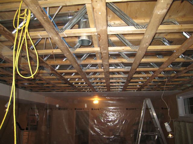

So day 3 has come and gone. Let's just say things are going slowly because I'm doing this alone and because I do it after work, etc...
Tonight, all I did was rip off half of the ceiling:
Hopefully all the DEstruction will be done soon so I can start the CONstruction this weekend...

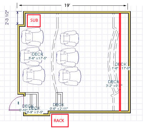

In my original plans, I have my equipment rack to the right of the screen and the sub to the left. I have since realized I can put my equipment in the right wall which adjoins to a storage area under my stairs. Because of that, I will relocate my sub to the back of the room to the left of the seats. So now I have the whole screen wall free to do what I want with it.
My question is... given that the room depth is "only" 19 feet, should I attempt a false screen wall and use up the extra foot of space to be able to have the speakers at the same distance as the screen, or is it better to increase viewing distance and have the speakers in front of the screen.
Here's a diagram of what I'm talking about:
Any feedback is appreciated!

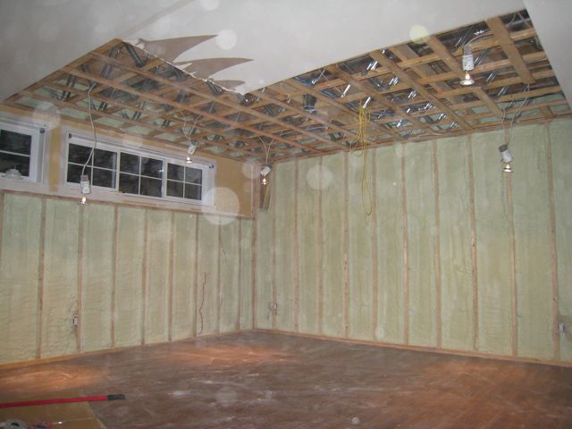

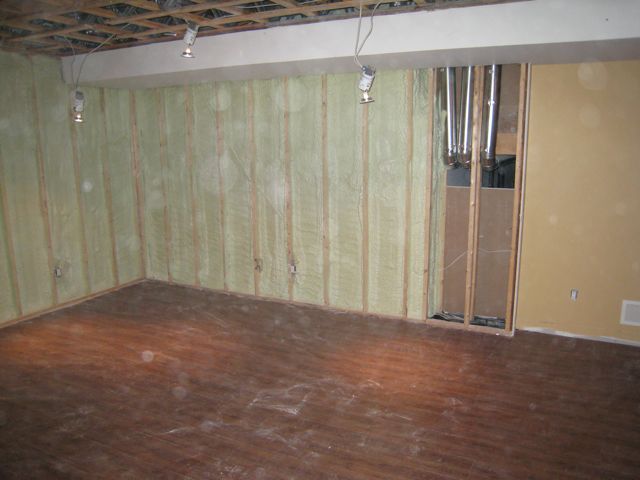

So day 4 of destruction is done. Slow and steady wins the race.
I've got most of the ceiling gone and most of the right wall gone as well. One more night of destruction and I'll be ready for construction.
As I mentioned in an earlier post, I've found a new place to locate my equipment. It's not an 8' high space, but I don't think I'll have that much equipment anyway. And the amps (7 monoblock Marantz amps) I can hide somewhere else (they don't need to be visible/accessible to the home theater). In this pic of the right wall, you can see the space (to the bottom right) where I will install the equipment:
That spot is actually in a storage area under the stairs. It will take some modification because part of the structure in there is load bearing but I'll reinforce when I open it up. I'll cover the space with a few fabric wall panels when using the theater so it'll be nice and hidden. This frees up space at the front of the theater to make a nicer screen wall. Please see earlier post -- still seeking advice.
I also finished most of the ceiling:
Hopefully tomorrow night will be the last night of destruction cuz, I admit, it must be extremely boring for you guys.

OK time for a question again.
I would get an acoustic transparant screen and hide the front towers and sub behind there...It really gives the room more of a "theatrical" feel...That little bit of room depth is worth the trade off to have empty space in front of your screen...My room is only a couple feet longer than yours and I have plenty of room for 2 rows even with a 150" screen. Helps if you decide to use 2 subs someday...I have just installed another sub under my equipment rack storage area in the back of the room...(see pic)...I now have one behind the screen and one in the back of the room...Really gives both rows more incompassing bass.
