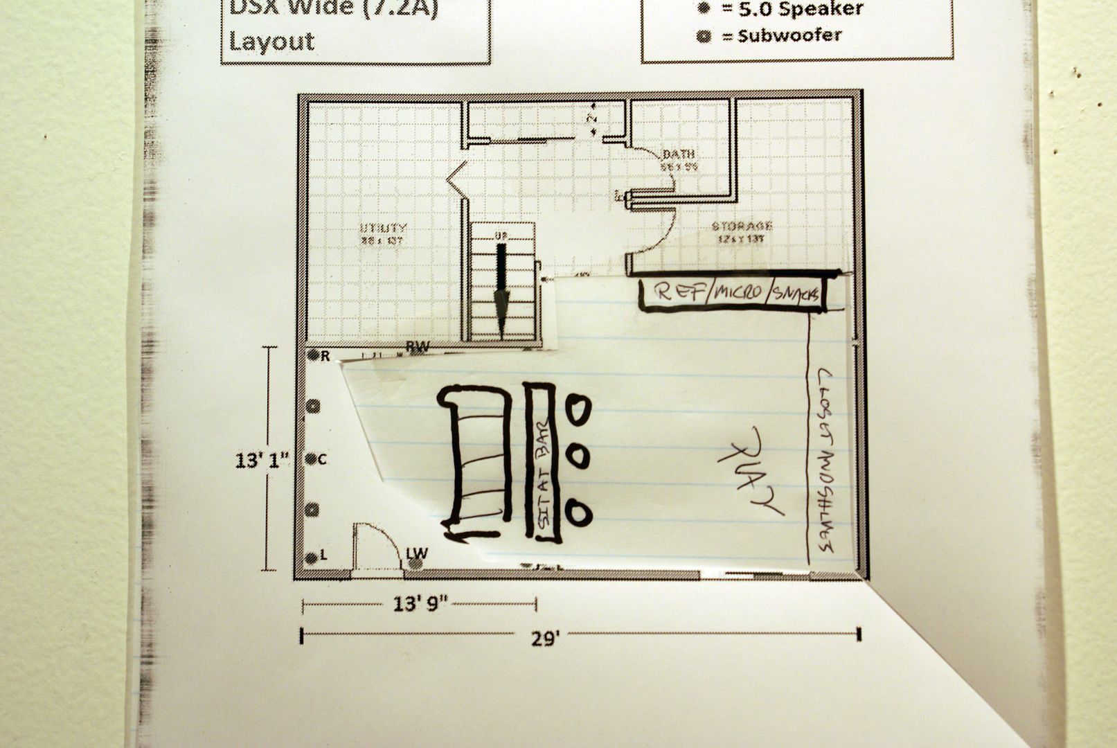

Planning: OK, now to get to the point of this planning thread. I have been staring at my basement for months trying to figure out how to make the HT happen with the existing structures. I've come up with a few ideas as to how I could go about doing this, and I could really use your advice in making my final decision for layout.
Each of these ideas comes with its own pros and cons which I will list above each sketch. If you can think of some more of each, or an entirely new idea altogether, I'm all ears!! (eyes?)

OPTION 2: Audyssey DSX 7.2A ("Wide") Layout
Information on DSX here:
http://www.audyssey.com/technology/dsx.html
I discovered this lovely new concept while researching speakers and receivers. It turns out that the Onkyo receiver I am almost 99% ready to buy has this wonder new technology built right in... yep, that's right, the magic is apparently in the little black box.. somewhere in there... hiding... just waiting to be unleashed... and stuff. (+10 Bonus for anyone who connected "magic" to the Harry Potter theme )
Bottom line: it's intriguing new tech, and I'm a sucker for new feats of engineering wonder. (Have you ever seen the toilet seats that close real slowly instead of slamming down, even if you try to slam them down? THEY'RE F'N AMAZING!!)
Anyway... sorry about that.
Pros:
  • One huge open room, and open space is neato. (See also: Cons)
  • Cutting edge tech with potentially amazing soundstage
  • No Glare from single door on the new HT side of the room
  • I get to annoy my crazy neighbor in the townhouse next to me with big booms!
  • Wide open play area behind HT makes it easy to watch our kid(s) break stuff
  • Adding wiring for future might lead to some cool 9.1 options when the tech and media for 9.1 eventually show up mainstream.
Cons:
  • (Big problem) The Left-Wide (LW) speaker sticks out from the wall in path between door and rest of room -- right next to the door! -- so my speaker selection for the wides is extremely limited to those with no depth!
  • More extensive renovations required -- moving closets, removing center wall, relocating breaker box
  • A future switch to traditional Dolby 7.2 (if DSX doesn't cut it) would require hanging rear surrounds from ceiling -- not optimal.
  • One huge open room, and open space means there's no way to hide from my kid(s) -- especially their noise! AHHHH! (See also: Pros)
Fig. 3 -- Proposed Audyssey DSX 7.2A Layout

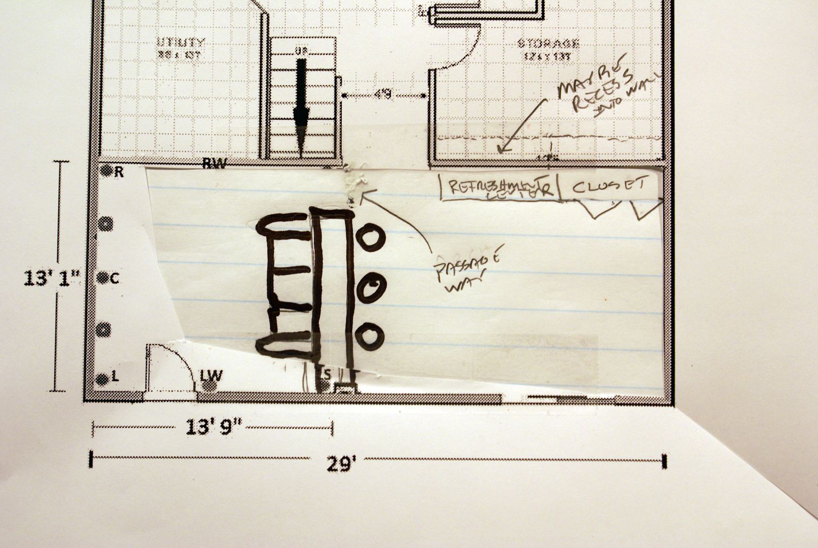

I would do a combination of shelves and hidden storage for the play area wall, then wrap around to a refreshment center.
OK, wow... that's not a bad option at all. My primary concern would be maintaining support for the floors above (load-bearing issues).
My townhouse is wide -- 30 ft by 30 ft square -- so I think some of the walls in the basement might be critical. Of course, I could probably solve that using beams and columns.
hmmm... I like it. I'll have to bring a pro over to assess the structure, and I'd need to find a new place for the stored items. Perhaps in my unfinished attic? I really love the bar and refreshments center... and the play area looks like it could handle a pool table / poker table further down the road. There were some amazing basement setups very similar to this idea -- with 3-seat bar behind seating area -- in some of the threads around here. I need to go back and look for those to help sell it to the WAF.
OK... damn, THANK YOU for the idea! I'm going to run with it and do another mockup. bbl.

Compromise
I am not sure what that bump out near the LS speaker is but anyway here is an alternative. I would still work to recess as much of the closet and refreshment center into the storage room as possible. I would cut your closet commitment back to just half of one wall. I don't think it is a good idea to use the original wall for a wall to wall closet as you start to crowd the sliders and make the room look smaller.
You also don't need a 4ft 9inch walkway so you might think about a nice floor to ceiling build in book shelf painted to match the wood work.

Compromise
I am not sure what that bump out near the LS speaker is but anyway here is an alternative. I would still work to recess as much of the closet and refreshment center into the storage room as possible. I would cut your closet commitment back to just half of one wall. I don't think it is a good idea to use the original wall for a wall to wall closet as you start to crowd the sliders and make the room look smaller.[/q]
OK, I see where you're going, and I might be able to scrape 2 feet from the storage room without losing much in the way of storage, and I might even be able to fit a rack in there with rear access in the storage room.
That bumpout near the proposed LS is a complete unknown to me, as I haven't pulled the wood panels off yet -- for that matter, the inside of all the walls is still an unknown to me...lol -- but something tells me it's part of the house's support structure. If it turns out that's not the case, I'll try to remove it along with the walls.
[q]You also don't need a 4ft 9inch walkway so you might think about a nice floor to ceiling build in book shelf painted to match the wood work.
The width of the hallway does lend itself to a nice shelf system. When we first moved in, the previous owners had a small ugly ikea shelf system rigged up to that wall. I will certainly add a nicer one to my list!
Also, before I forget to tell you, THANK YOU for all of your help and ideas. If you're still in/near DC, I could even invite you to the grand opening someday!
I'll drop your ideas into the all-powerful MS-paint and see what I can come up with...

Although it would require having your back to the kids, the picture with the shelves and wrap-around snack bar. For sound issues, I would keep a wall behind the seating area. Having a...29' long room is hell on sound, plus..kids?! I can barely watch a movie with one, he's LOUD!!!
Of course arrangements could be made to get around the length of the room, from setting up the separate channels to compensate to adding different sound-deadening materials to the walls. But I highly doubt arrangements could be made to get around the loud children(bet that climate controlled storage is looking good now).
My main concern would be that with the length of the room, the "reflections" when the sound bounces off the back wall would definitely take longer to reach back to the listening area, and might cause a muddy sound. These are just observations, it really would have to be determined. Either option you go with could be worked with, I wish I had a basement,
