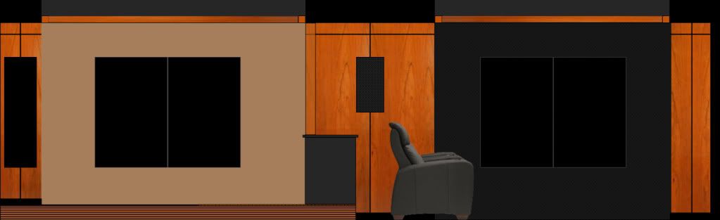

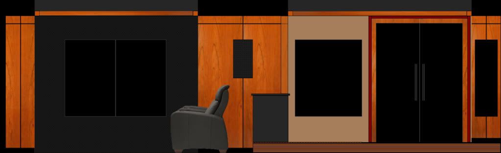

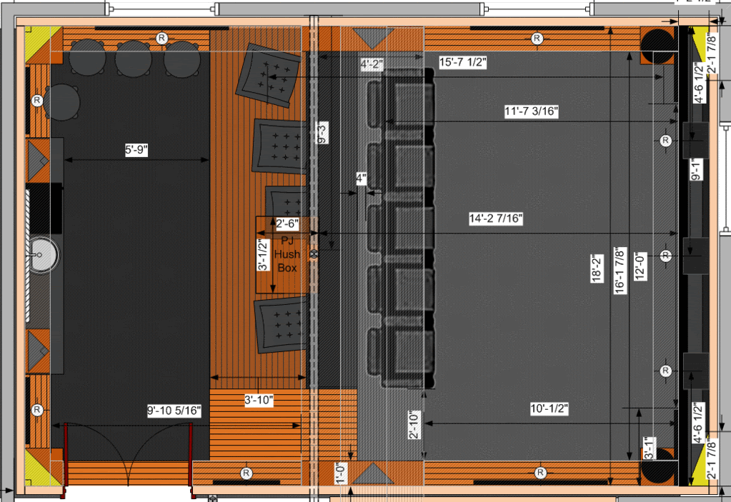

Yet another updated design.
-20" diameter Sonotube subwoofers (thanks a lot)
-Bigger bass traps in the rear corners
-Corrected I-Beam width which resulted in moving the riser/bar forward
-Updated acoustic treatment colors to black - I think the previous color was confusing. Added a few that were in my mind. Remember, I'm clearing my mind right now.
-I really always have endeavored for a black hole effect up front. Hopefully this is a better representation of that goal.
The BIG question is to related image size and throw ratio. With a 13' throw ratio, can I achieve a 144" wide scope screen? I've been watching the Panny 3000/4000 and guess that it will be a year before I'm ready to buy the PJ. But right now with my Epson HC720 I am at full zoom to achieve a 150" diag 16:9 screen at a 16' throw distance. Sitting at 1.5x screen width (~135" x 1.5) I think the image is great. Thoughts?
Audixium is offline
I would say that if you are happy with 1.5x distance on a 135"-144" screen, go for it. The purists will say it's too big but I always say go as big as you can stand. What I have read is it is better to NOT be at the very top or bottom of your zoom range. I made a 124" scope and want to go larger now. When I made mine, 720p was the only economical option. My seating is about 11' from the screen and it was right on the edge for SDE. Now that I have a 1080p projector, I'd like to go larger (between 143" and 150" scope). The wife thinks I'm insane and has graciously put about a dozen "more important" projects in front of it
From my read of the PT-AE3000 manual, it appears you cannot get 144" width at that short a throw. They show almost 16' minimum for a 138" wide screen. Anyway, be sure to check to make sure.
At a 10' seating distance, the front row gets a 60-deg image angle. As Ed Sullivan would say, that's "a really big shoo."
Roger,
LOVED your build from the first post. I specifically like your soffit access. I'm still extremely peaved they cancelled the series. It was one of my all time favorites. Too bad it cost too much to produce for HBO's tastes (just like Rome - another great production).
Thanks for chiming in on the throw ratio issue. I understand that I should not be at either end of the throw ratio limits for any given PJ (like Steve said). However, I have no problems at the max zoom with my Epson HC720. Well, except that I run in dynamic mode in order to light up that much screen (150" diag 16:9).
I need to spend more time on this. The way I understand it, for a 60" high 1.78:1 projected image I would be fine with my throw distance. However, for a 60" high 2.40:1 image I would indeed need a 16' throw. How does a lens factor into this? Aren't those numbers from the manual just for the internal zoom settings? I think in the end I'll end up with an outboard processor of some sort - leaving an anamorphic lens in place all the time...
I'm hoping others will chime in...because, my understanding is that if I can achieve a 60" high 1.78 image with my throw distance, adding a lens will "simply" stretch that width out. Of course a couple other factors come into play. Do I have this all wrong?

post #58 of 440 Old 09-26-2009, 08:51 AM - Thread Starter
Audixium's Avatar
Location: Rocky Mtn High
Posts: 1,635
Quoted: 30 Post(s)
Yet another updated design...I'm trying to get as much throw distance as possible while being at one with my immovable pole - mind like water, pole like stone. So, I may be compromising the audio but I think it will be somewhat ok.
-Now am designing based on Klipsch KL-650-THX. Over at the Klipsch forums some gurus have said it is fine to recess the cabinet in a wall. I won't go that far, but I will nestle them into the 3" acoustic foam wedges.
-Acoustic designers have said it is ok to not have right angle bass traps in the corner.
-Moved the subs out from behind the screenwall.
These three things gained some valuable throw distance (now almost at 14'3").
Also, I added some wood flooring around the perimeter of the room under the soffits. I know this kills my black hole in the front but I'm ok with that. It also probably messes up the audio, but it's ok: Matters of great concern should be treated lightly.
In the rear of the room I added the tile treatment above the sink like the first style pic in this thread. I'm thinking about doing something like the alcove with the vase, but for the sink. I think based on the tile texture and installation it may act (however poorly) as a diffuser.
The darker flooring in the rear is tile. I know this is a big no no for acoustics, but I'll throw in an area rug to try to compensate as much as possible.
The large soffit spanning the room over the front row will have an inch or two of linacoustic - or anything - to minimize reflections from the surrounds.
I plan to have a cloud hanging from the front ceiling in order to catch first reflections there. I'd love to do a star ceiling like Steve and many others but am not sure at this point if I'll have the energy when I get to that point. Luckily that can always be added after a refreshing break.
Comments, concerns?
My Zen master taught me: Make decisions in the space of seven breaths.
EDIT> #1
Colors (wood is too light, but black is mixed in, wood/tile combo, black footer of columns):
Colors & Tile treatment above sink:
Audixium is offline
post #59 of 440 Old 09-28-2009, 11:33 AM - Thread Starter
Audixium's Avatar
Posts: 1,635
Quoted: 30 Post(s)
Some layout updates...
A few changes have been incorporated related to the rear area (thanks Steve!) that include the following:
1) The riser will now span from the bar to the rear of the room. I was optimistically thinking folks wouldn't roll off, but after a few drinks all bets would be off.
2) I pushed the entry out to accomodate the step up. With the doors open you still have room to go straight ahead or turn right.
3) The two front columns won't be Sonotube subs, just downfiring subs in columns.
4) The front and rear soffits have been increased to match the depth of the corner columns. I'm leaving the left and right soffits at their current depth as it matches the large center columns.
5) Moved the sink over to allow more space.
6) Switched to inwalls for the surrounds.
7) Added visuals for the PJ and lens in the hushbox.
I think the overall layout is fairly firm at this point, so I started an elevation of the left wall. To cover up my pole I have it wrapped in a 6" wood column. That isn't part of the large column design, just something in the field of vision. It's hard to make out the soffits, but my plan is to use a flat piece of trim for the light tray. I haven't figured out my star ceiling/absorption yet so it's missing. I'm curious what input folks have.
Left Wall
Right Wall
Audixium is offline
