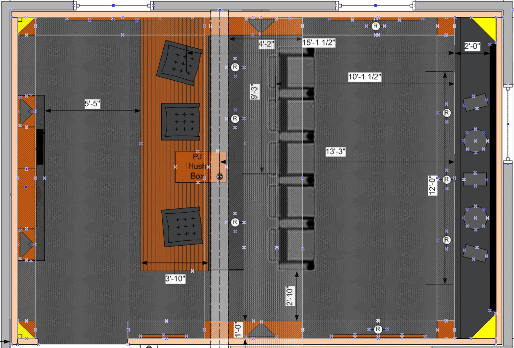

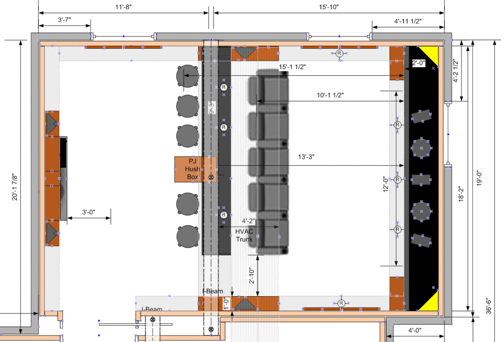

Here is the most recent revision...
I think my biggest problem will be getting a 12' wide scope screen with the throw distance constraints. That @!#$%@#$ pole is really killing me. Wait, no it isn't. In fact, I like that the builder decided to support my house. The pole will now become a focal point in the room. I am at one with my pole.
Now that I am peaceful again, what about those doors? The wife really wants it open, if not then french doors. Will I gain any isolation at all by using a pocket door plus the french doors?

I updated the design based on some of the style examples I just added to the second post.

Audixium,
One suggestion (at least from my experience)... We actually planned to do the bar seating in the back in our room and changed it to traditional seating in the end. We figured that for a 2-3 hour movie, the bar seating would get a bit uncomfortable. AND, you being the nice host you are, would let you guests sit in the money seats while you sat in the "less comfortable" bar stools.
So, I took the liberty to beat up your floor plan and make a few changes for you Of course, this is only my .02 -- so it is in no way binding
Change 1 -- use regular club chair type seating in place of the bar stools. Raise the floor about 10" or so to clear the heads of the people in front. I know that your ceiling are only 8', so it will bring the ceiling in a little closer. I would think that unless you normally have NBA pros over for the game, you should be okay.
Change 2 -- Add some lower bar stools in the back to "pack 'em in" when needed. If the club chairs swiveled, it would add a nice conversation circle. Case in point -- typically the men sit in the front while the ladies sit in the back during a football game. The ladies talk while the guys watch the game and yell at the screen.
Change 3 -- Added 2 more bass traps in the back left and right corners. You'll need them with the 2 sono-tube subs you'll have up front (and of course we'll need to talk about a few DIY monster subs down the road!!)

Thanks for reminding me about this. I had originally planed to use black leather office chairs like Big Red. He mentioned that they were great in his back row with the bar.
Agreed - I'll update the plan with a riser and chairs.
I'm still not sure what to do in the back area. I thought a walk up bar against the wall might work. At one point I had a poker table type setup in the upper left corner. That seemed too crowded. I need to clear my mind again.
I should consider the guests. I'll put more thought into what I can do there.
I had bass traps in there, but can't figure out how to cover that area while making it appear like a design element....?

Updated layout...

post #27 of 440 Old 09-21-2009, 07:19 AM
swithey's Avatar
Location: D/FW, TX
Posts: 2,639
The pic/design of indygreg's room is perfect. Elegant and comfortable.
One other thing to consider... we use our wet bar counter to put food on when we have guests. You may consider a zen-like buffet table in the back attached to the front of your bar (maybe a cool curved front with stone or stained wood along the bottom -- very clean lines). This might make a good accent piece in the back. Remember balance is key to any Zen room I think some of my wife's design theories are creeping into my conscious life
DIY subs? Ha! Surely you have me mixed up with someone who likes MDF dust.
Nothing like MDF dry heaves in the morning I'm expecting those (2) monsters to have 2' diameters and be 7' in height with 18" drivers! You'll feel that bass -- no need for any stink'n butt-kickers in your room.
Do you have any elevations to share with us (front, back and sides)?
swithey is offline
I think that is a good idea. I was toying with making that area something like that - walk up bar that could also be used for what you describe.
I was planning on two SVS subs up front. But now you have me wondering...could I convert the two columns on each side of the front row into subs in the bottom portion ? I have them at 12" deep and about 5' wide. Would that kill any attempts at isolation?
Not yet. I learned not to start on those until I'm completely, conclusively, absolutely, universally committed to a layout. Once I am at one with the layout I'll elevate it.
Audixium is offline
post #30 of 440 Old 09-21-2009, 10:55 AM
swithey's Avatar
Location: D/FW, TX
Posts: 2,639
SVS makes a good unit. The columns could be subs but they really do not have enough volume at 5' wide x 1' deep x 4' tall. The shallow depth may be an issue as well. As for isolation, you just want to make sure the walls are isolated 1st then build your columns in front of that. However, buying gets you there a lot faster
Understood!
