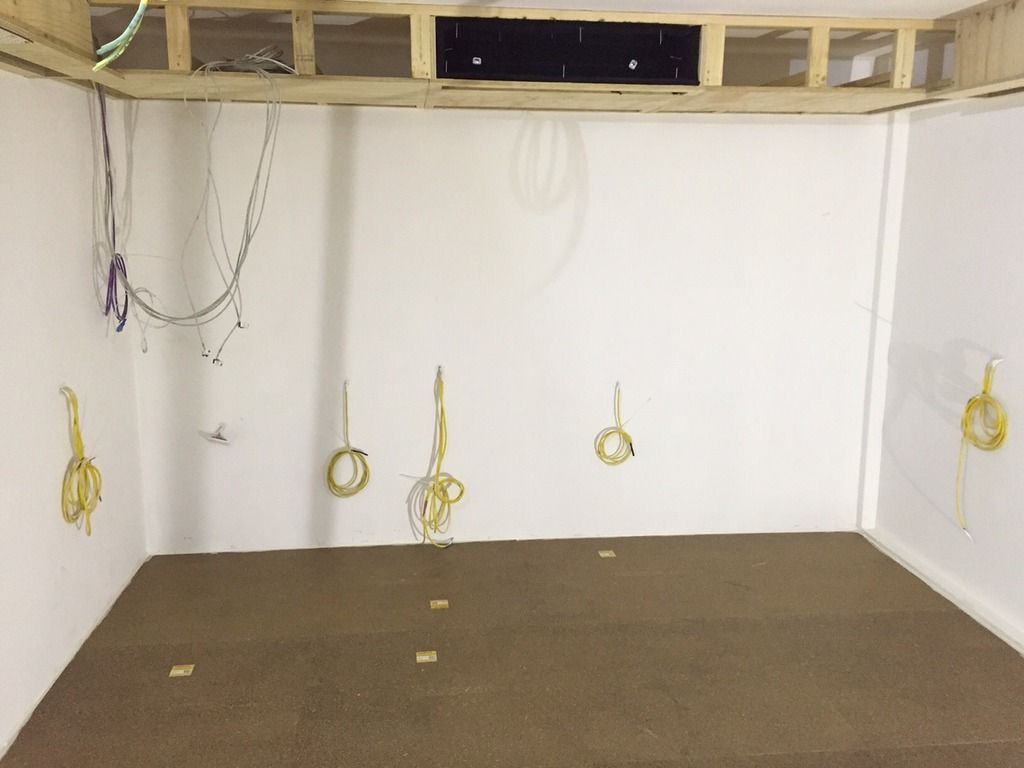

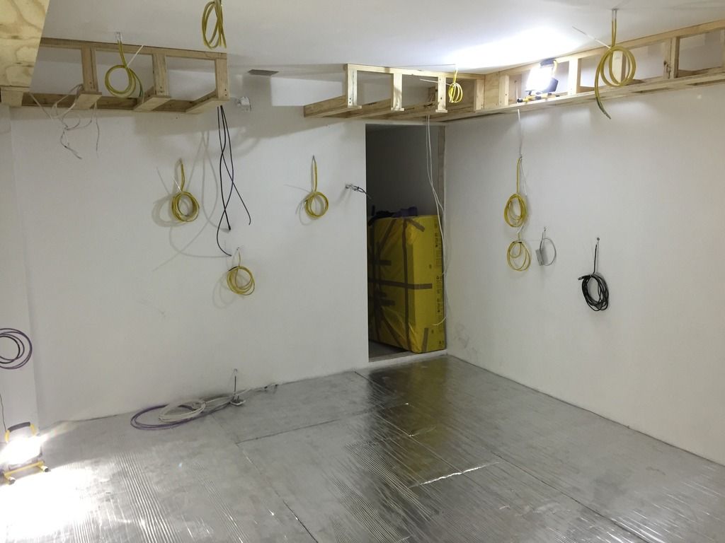

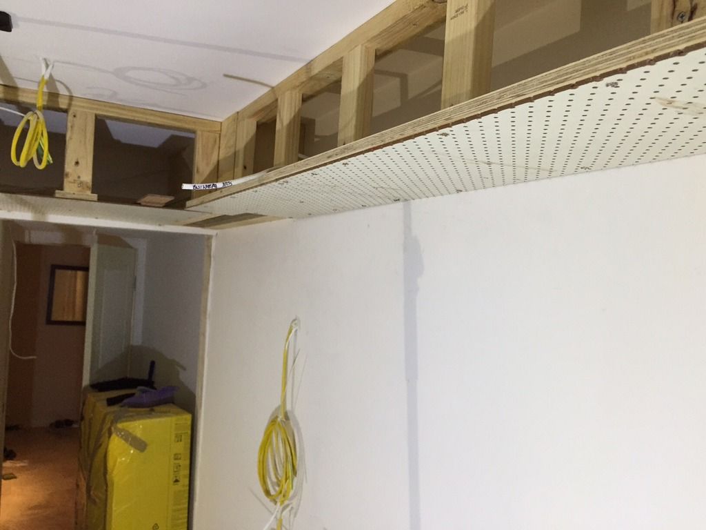

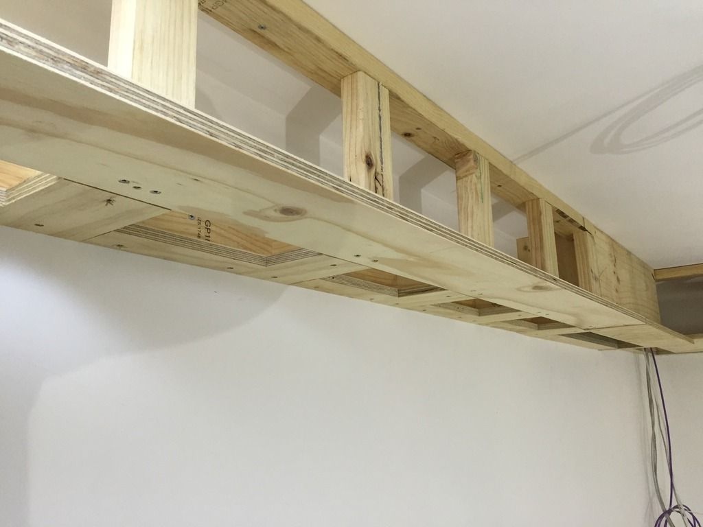

This week's work....took a surprisingly long time to get the soffits sorted, with the HVAC supplies and returns lined and boxed in. I also put the AngelStep underlay down (its a HD polyester on the bottom with some sort of visco-elastic membrane on top.....its darn heavy).
AngelStep detail:
Main AC Supply Box (this will have a front put on it)
Soffit detail - these will be filled with insulation and lined with Pegboard (not specified by Erskine Group - another PtG production):
Next up is putting the chipboard floor down.....going to be an ass to get in - I think I'll just have to chop it up and but joint/glue it

what is your soffit and ceiling height?

2440mm for the ceiling and 310mm for the soffits.
.....take 50mm off for the floor....well at the door at any rate, it'll be 38mm high everywhere else

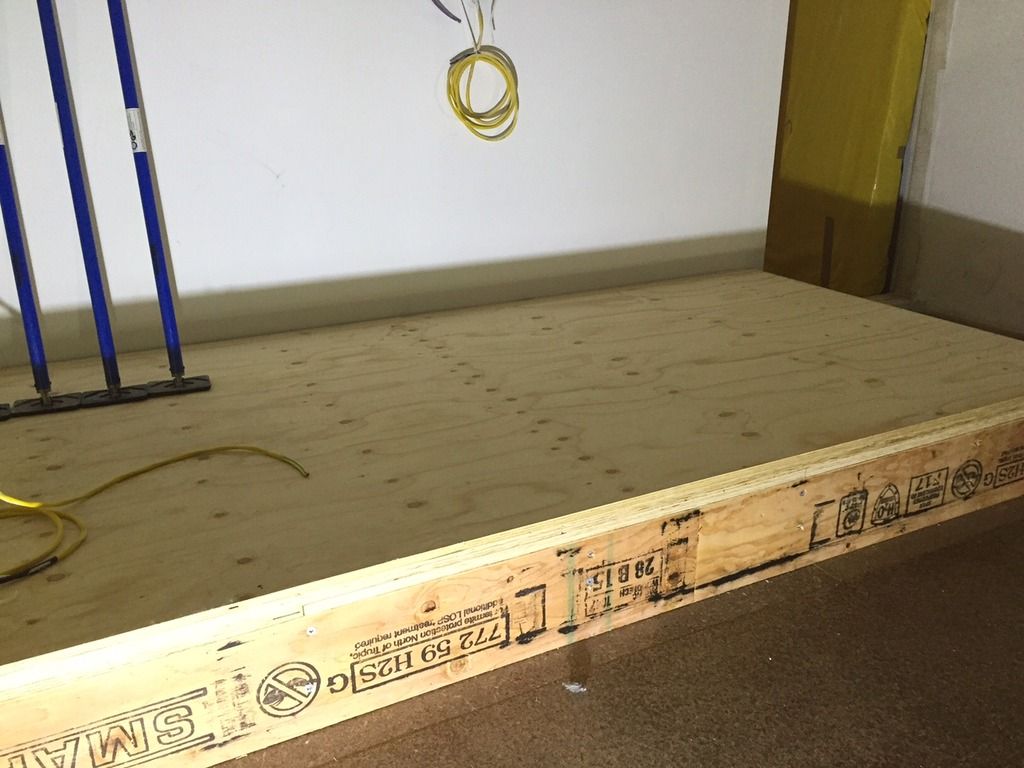

post #370 of 549 Old 05-24-2015, 03:42 AM - Thread Starter
Elill's Avatar
Posts: 1,702
Quoted: 90 Post(s)
Liked: 83

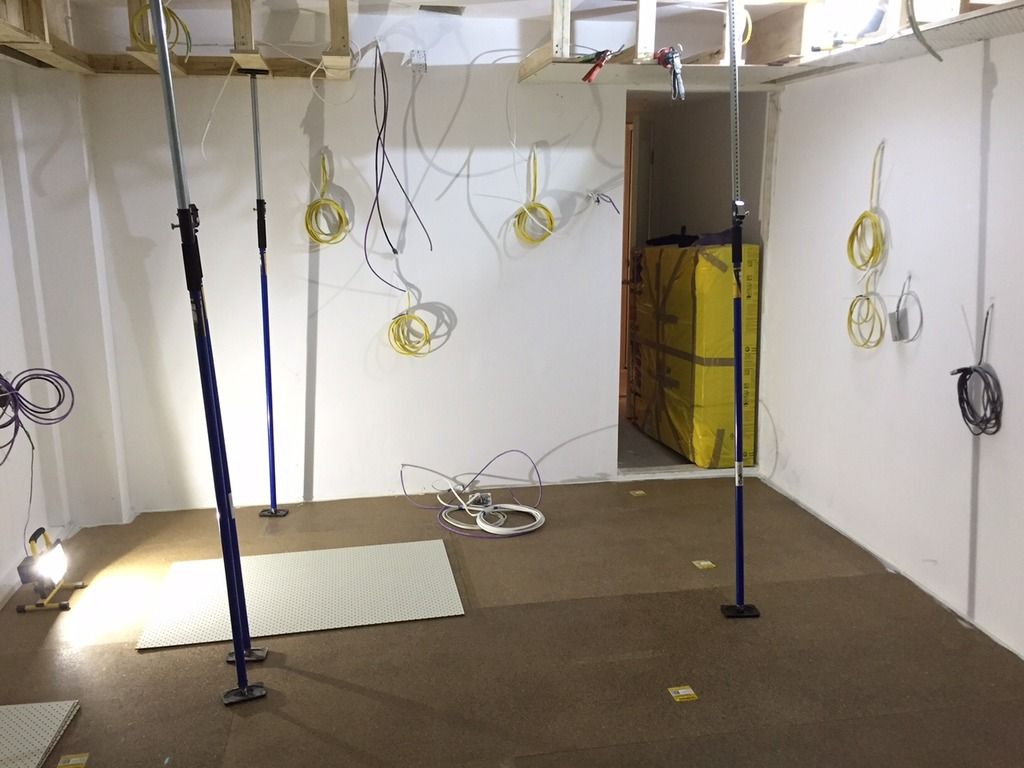

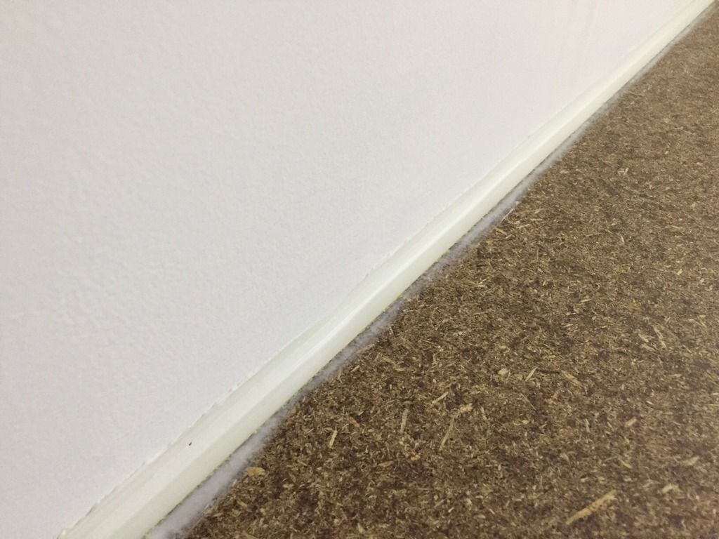

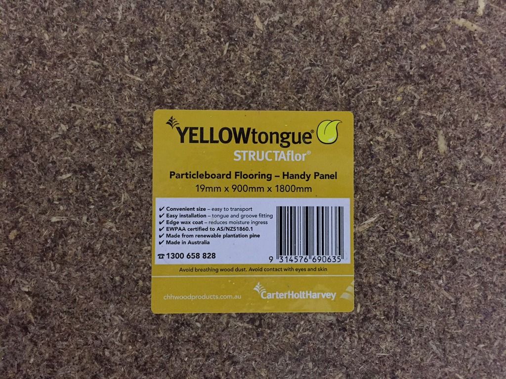

This week's effort. The floor is down and I had some time to line some of the soffits with pegboard
Floor is 10mm off the wall, gap filled with Green Glue's sealant
This is what I used on the floor (has good damping properties too)
Here is some of the soffit lined:

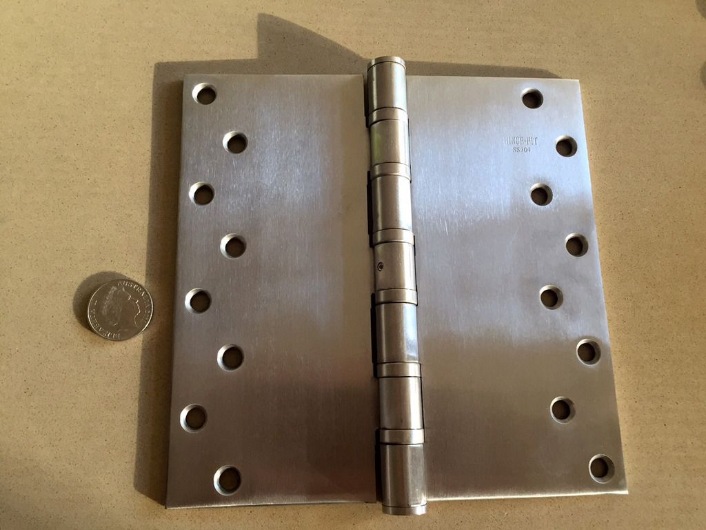

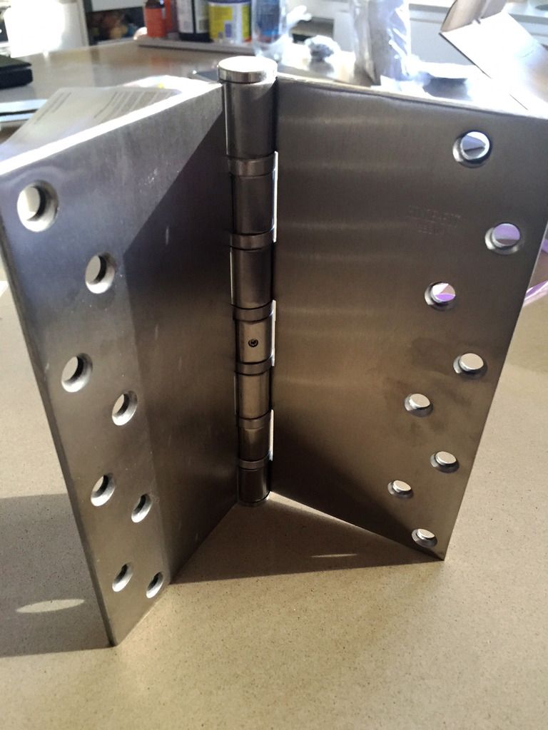

In the theme of "we make em big down erh" - Door hinges arrived today.....200mm by 200mm, stainless steel, ball bearing hinges - Aussie Made (From HingeFit in Melbourne). That's a 20 cent coin too BTW

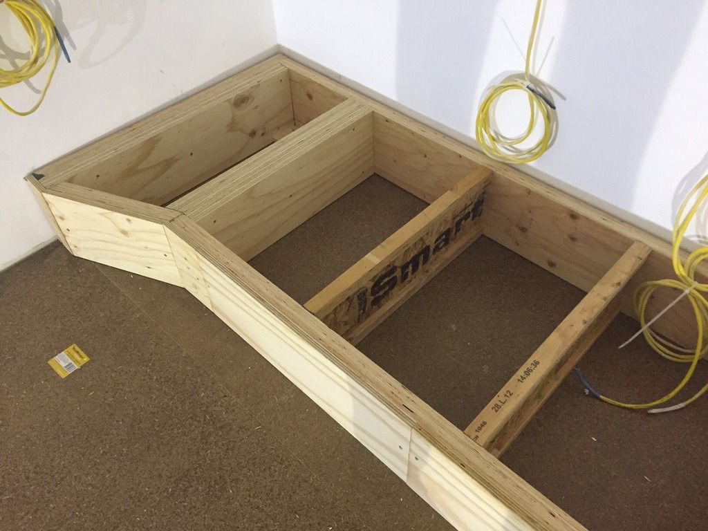

post #378 of 549 Old 05-30-2015, 01:28 AM - Thread Starter
Elill's Avatar
Posts: 1,702
Quoted: 90 Post(s)
Liked: 83

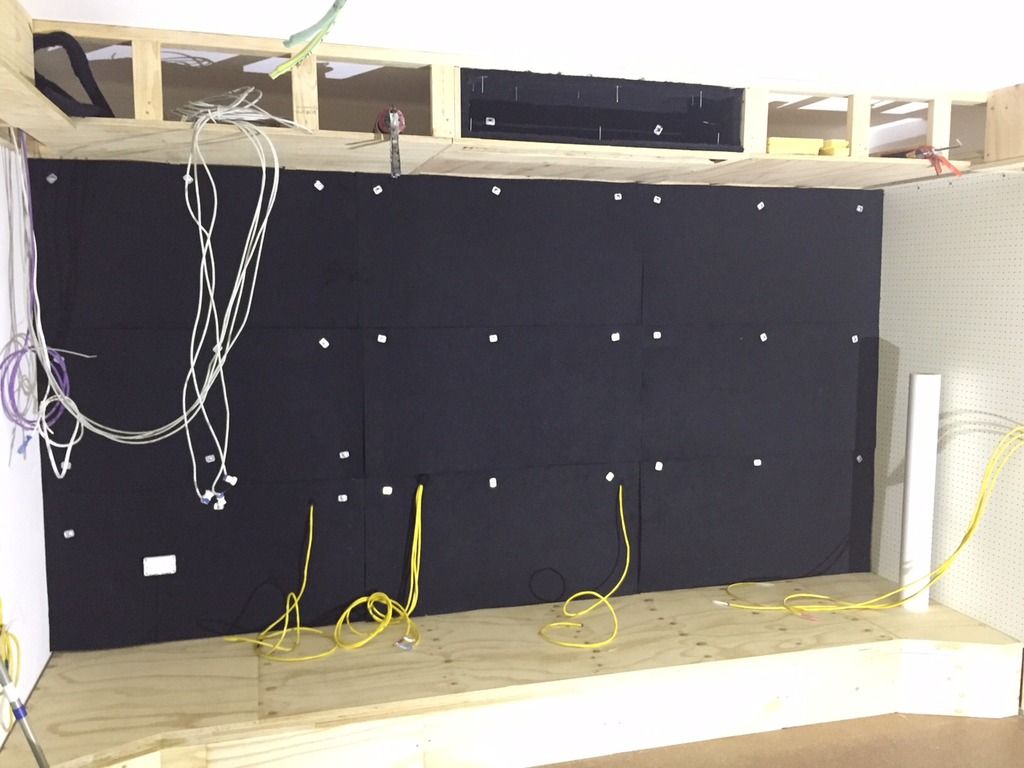

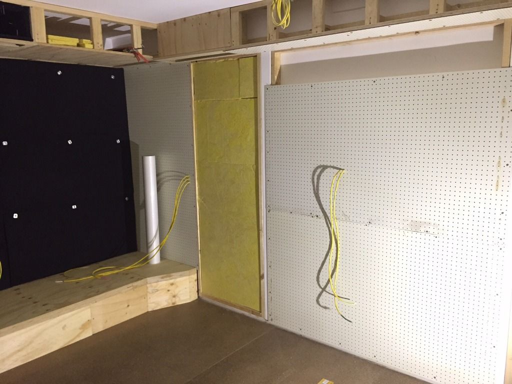

Weekly update.
Stage framing is finished. I also did a bit more of the soffits. I had a lot of surplus ply and also 1 long timber I beam, which I have used in lieu of more LVL.
Added some stops to stop it from shifting on me:

Looking good mate. Is it going to be stuffed with insulation? There's a fair bit of wood in that baby.

Thanks mate.
Plastic liner to go in, followed by sand

How much sand do you think? That will not be a fun job.

That's next on the to do list. I found a joint a while back that sells kiln dried sand in 20kg bags for synthetic grass....hopefully wont cost too much

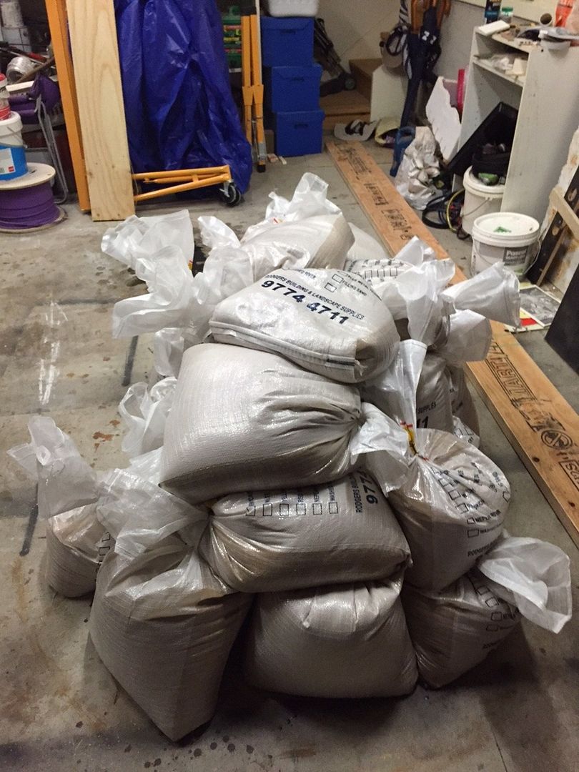

post #383 of 549 Old 06-03-2015, 04:59 AM - Thread Starter
Elill's Avatar
Posts: 1,702
Quoted: 90 Post(s)
Liked: 83
Well tickle me pink, a mid week update! Sand arrived today. I got most of it in the stage, just need to trim some more of the plastic.
Got the sand from these guys - http://sydneysyntheticgrass.com/shop...r-30kg/9055940

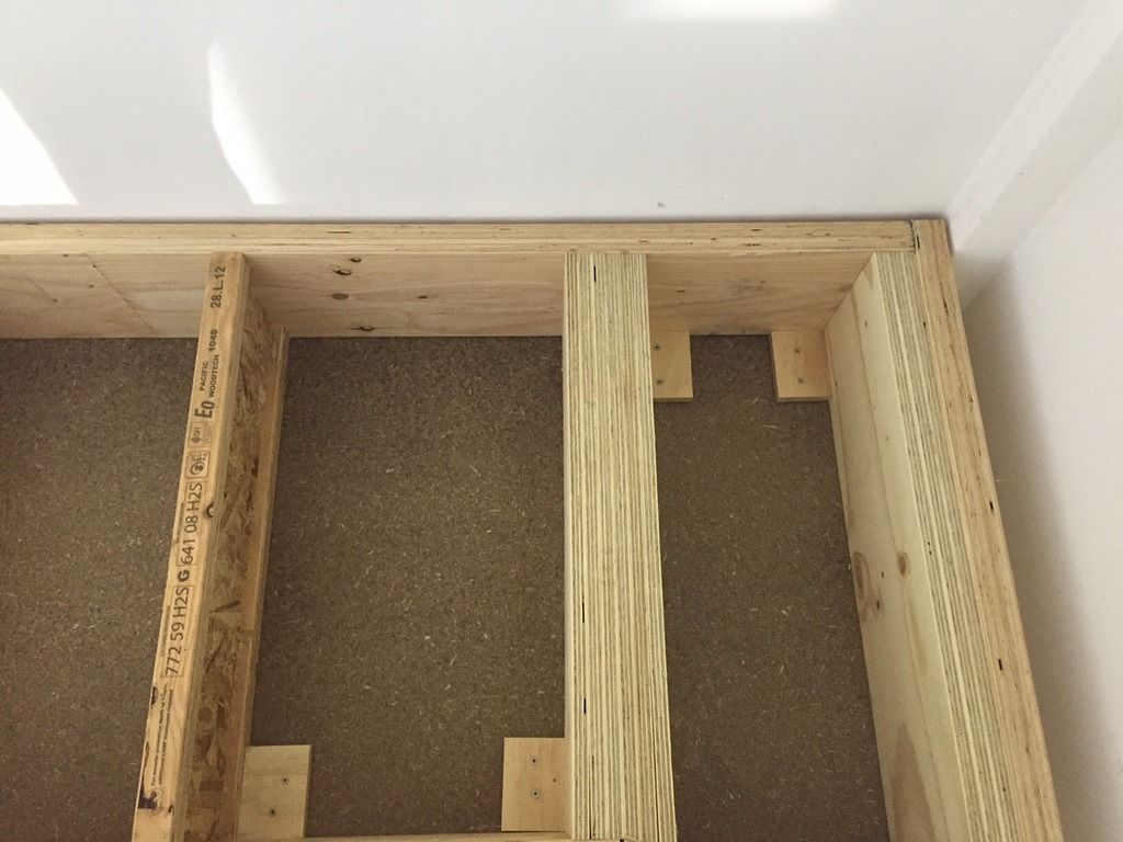

post #385 of 549 Old 06-08-2015, 04:47 AM - Thread Starter
Elill's Avatar
Posts: 1,702
Quoted: 90 Post(s)
Liked: 83
This week's update.
Stage is "finished" save the front step and the cladding. 3 layers of ply with GG in between. Also got the two layers of insulation on the front wall with 75 micron laminating plastic film in between (need to paint the stick pins black):
Riser frame is finished and I have cut the 3 layers of ply for that too. Haven't attached it yet as I need to install a light (which I don't have yet) and a power point:
I cocked up with the soffit dimensions and as such my little plan to add 75mm to the room width has failed....how to fix? well I could have ripped the front and right soffit down.....nup, or I could just fill in the 75mm space - that's what I have done. Used a variety of density insulation and pegboard thicknesses in various locations that will, I hope, assist with the bass performance of the room.......if it doesn't work hopefully I won't have done too much damage to the sound (that can't be fixed with EQ at any rate):
