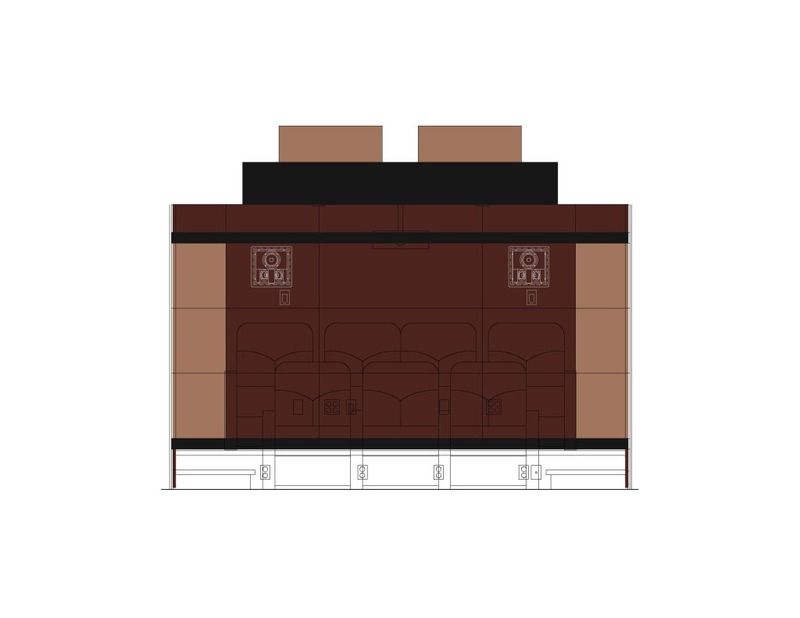

I love the plans and drawings you are using in your build. What software are you using to help with your design?
greenfish1308 is offline
post #363 of 1283 Old 07-27-2012, 09:39 AM - Thread Starter
Spaceman's Avatar
Location: North Houston
Posts: 2,015
Mentioned: 10 Post(s)
Quoted: 45 Post(s)
Liked: 150
Thanks Greenfish. I'm using AutoCAD for all the design work. Fortunately, I use it for my day job so I didn't have to go out and buy a copy to use just for theater design. It's pretty pricey and I would not recommend getting it just for your theater. Sketchup is fairly popular (and free). Microsoft Visio is used quite often as well.

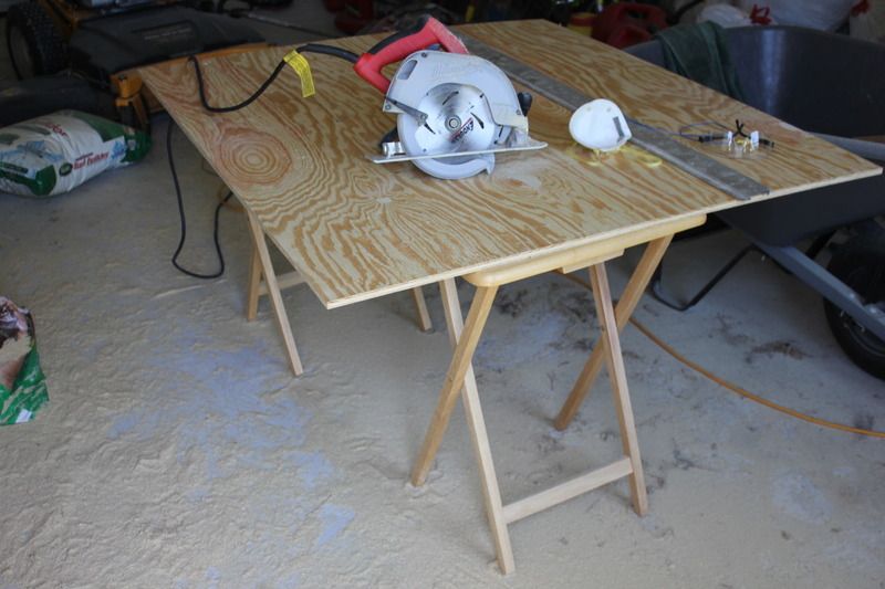

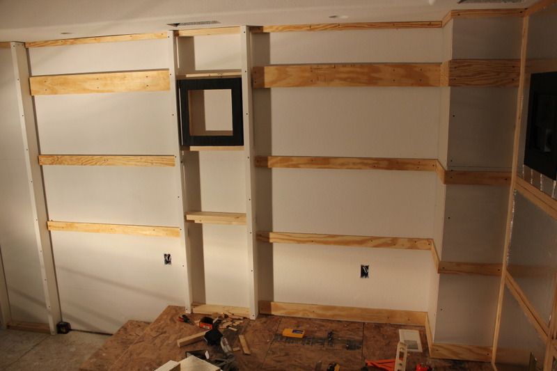

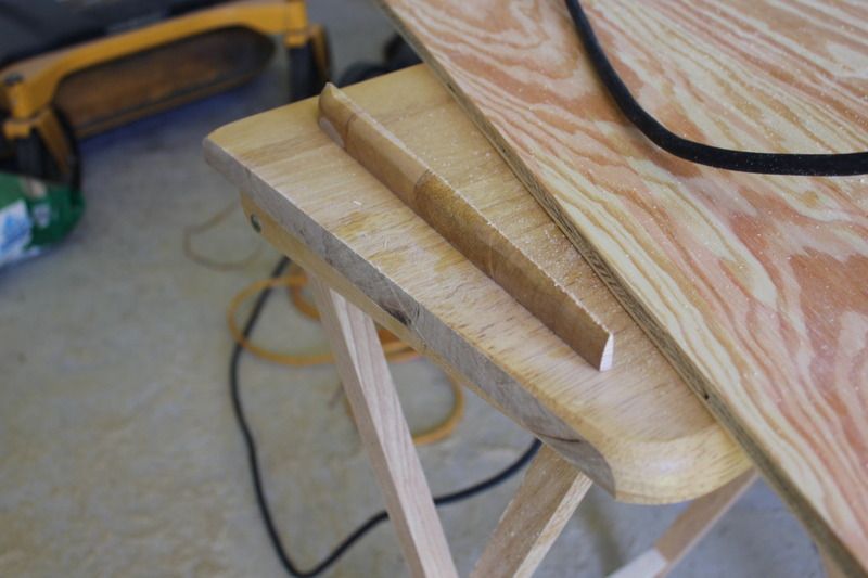

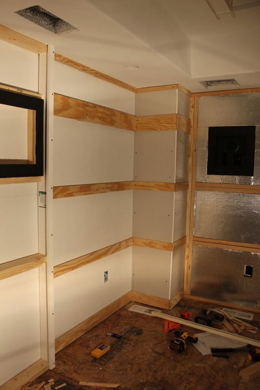

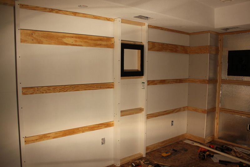

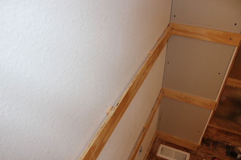

I'm getting closer to being able to construct my fabric frames. First order of business was to add the furring strips to the wall (cut from 1/2" ply). The furring strips will receive the socket ends of the speaker grill guides while the actual fabric panels get the ball end.
Between the furring strips and all of the individual strips needed for the actual frames, I have a lot of cutting to do. Unfortunately, I don't own a table saw and my tool budget is just about gone. A circular saw, edge guide and a few clamps will have to get me through.
My redneck table saw
My only sawhorses are holding up my workbench/tools outside the theater, so I dusted off an old pair of tv trays to support the plywood. Cutting the strips is actually faster than I thought it would be. Not as fast as a table saw, but fast enough. I only had one cut that gave me trouble. I couldn't figure out why this one particular cut was much slower than the others. Turns out I was cutting through the ply AND the tv tray.
As I mentioned earlier, I learned that my walls are not very plumb and I became a little concerned that the ball & socket approach would turn into a major headache if the furring strips went up out of plumb. So, quite a bit of my time has been spent shimming each furring strip to address irregularities in the wall, both horizontal and vertical. When I'm done, all the panels should pop right in without warping or twisting.
Shims, as required
Spaceman is offline

Is that a Milwaukee skill saw? It looks a lot like the saw I have, and I really like it. Nothing wrong with that table saw I might add smile.gif
Looks like a Milwaukee circular saw to me...Skil is its own company tongue.gif They just happened to invent it
As for the saw guide, I can't see what you have but I ordered from Amazon the Kreg saw guide and it is very good at cutting sheets from 1/8" to just over 24"
Kreg Saw Guide

Larry is correct. The circular saw is a Milwaukee worm drive and it works great. I've had it for about 5 years and haven't had any trouble.
Sorry, I can't remember what kind of saw guide I have. It started out as two 4' pieces of aluminum that slid together in some way for a really long extension, but I usually just use one of the pieces and clamp it where needed.

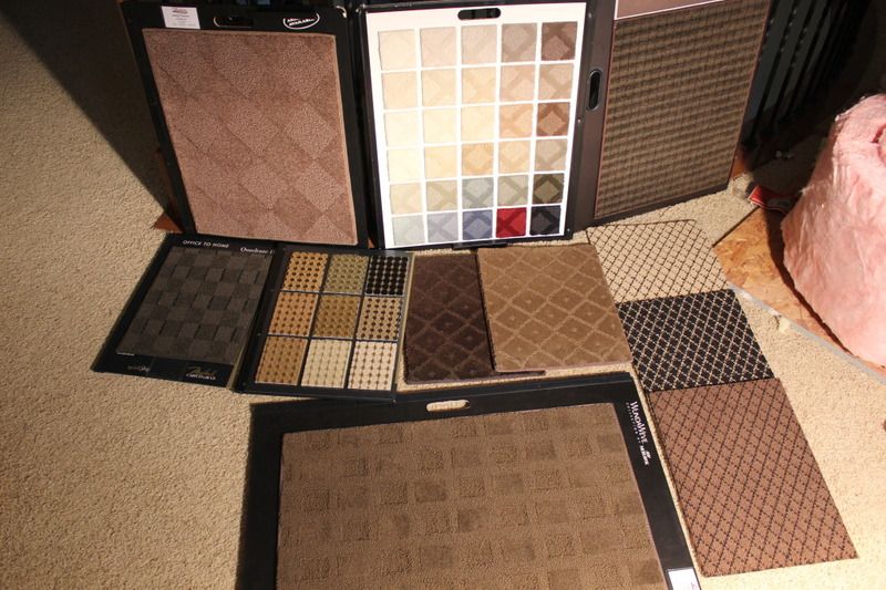

Carpet Samples-Round 1
Picked out a few carpet samples on Sunday afternoon.
Top row (l to r):
Dixie Active Life, style:Living Treasure, color:Mandolin
Dixie Ultra Life, style:Enticing, color: picked for pattern, not color
Tuftex, style: Wavelength, color: Brownstone
Middle Row (l to r):
Masland Office to Home, style: Quadrate II, color: Iron ore
Masland Office to Home, style: Cervantes, color: Quixote
Shaw, style: Gabriella, color: Java
Shaw, style: Gabriella, color: Practical Brown
Masland, style: Tristan, color: Ironwork
Masland, style: Tristan, color:Raven
Bottom Row (l to r)
Mohawk Ultra Life, style: Luxe Living, color: Tavern
Masland, style: Tristan, color: Onyx
I still need to track down a few Stanton carpet samples, but this was a pretty good haul for our first stop.

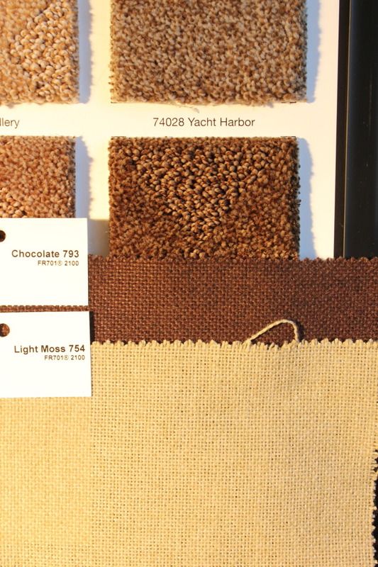

For wall fabric, I'm going with a two-tone color scheme (earth tones), with a light color going on the side walls and a dark color going on the columns and rear wall. The dark color will also be used as an accent band along the top and bottom of the side walls. Black trim will be used between the two colors of fabric.
Front wall:
Left Wall:
Right Wall:
Back Wall:

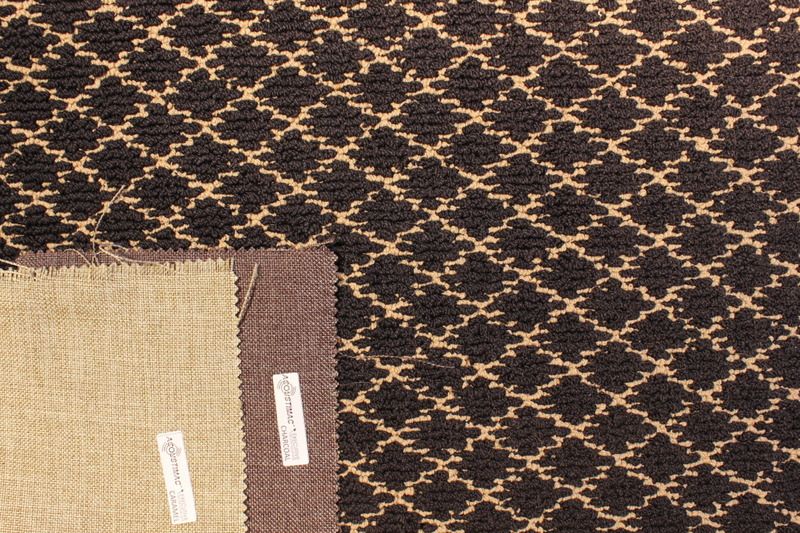

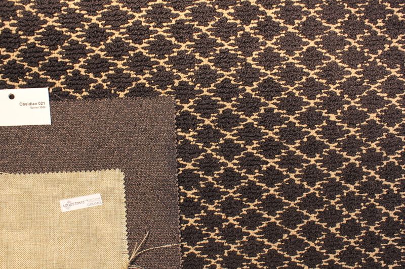

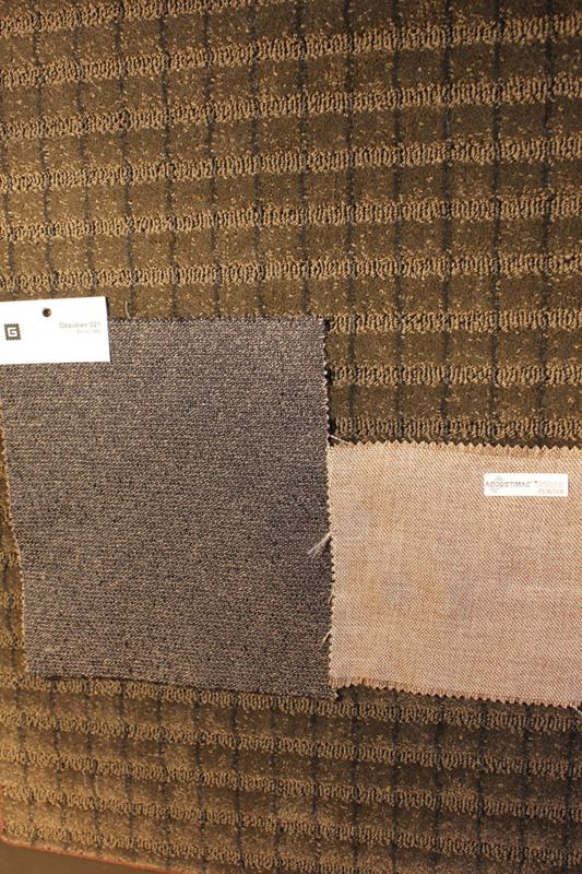

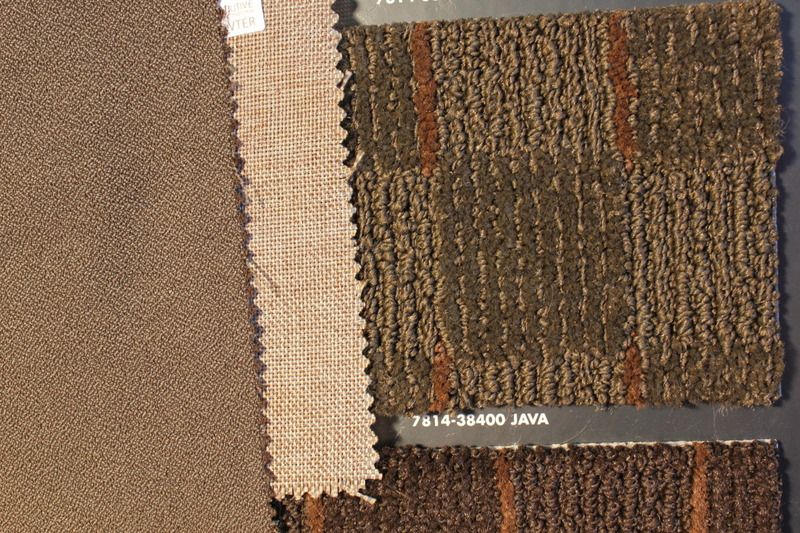

A first attempt at pairing some of the fabric samples to carpet.
#1
#2
#3
#4
#5
#6
#7
#8
#9
#10
#11
#12
#13
#14
#15
#16
#17
#18
#19
#20
#21
I have to be careful because I'm finding that I either end up with a very monochromatic color scheme with little contrast if I try to keep everything dark or I start to introduce colors that might be a little too light in order to gain some contrast. I really don't want a brown cave, but I don't want to compromise image quality with walls that might be too bright. Any initial thoughts or concerns?
Spaceman is offline
Since I'm trying to help: of the carpets I like
Dixie Ultra Life
Ironically when I went to the store a few months back, I think I picked the Masland as one of my favorites.
Of your color combinations, I think I like the following the most (I do like them all though)
#1, #4, #7, #8
Larry M is offline

Any opinions on whether I should stick with the same style of fabric for the 2 colors? I have a few color schemes that have fabric from two different manufacturers, so the weave/texture will be different between the two colors. Not sure that is a bad thing as it might add some additional interest. However, part of me thinks they should both be the same (either light & dark GOM or light & dark Acoustimac, instead of a combination).
Spaceman is offline

I'd definitely think about mixing the textures - certainly adds interest and also breaks up any "commercial space" feel you might get. Which is the same reason I don't like combo #1...
My vote would be for combo #7 (I think). I do like the Tristan/Ironwork carpet the best of those. If I did mine over I'd choose a carpet with some color patterns (mine is patterned but monochromatic) - can go a long way to hide the popcorn crumbs you will miss! Also, go with dark carpet as it will hide the inevitable spills that will happen when you put lots of people with drinks in a dark room. Stainmaster rescued a full red wine spill last month! (no damage - very happy about that)

I like option #1.
It seems like a good combination of a dark carpet and a nice wall fabric texture mix and color contrast.
But no matter which way you go, looking good Spaceman!

Combo #1 is actually one of the schemes that has 2 different fabrics. One is from GOM's Broadcast line and is fairly smooth while the 2nd fabric is from Acoustimac and has a visible weave. Is it the fabric that looks "commercial" to you or the carpet? The carpet is actually from Masland's commercial line, and I didn't like it at first but it became the easiest one to match fabric to, so it kind of grew on me. It's similar to what Mario just put in his Cinemar Theater.
Spaceman is offline

I may be the odd man out on this, but I am partial to 6, 13 and 16 but I have to say none of them really jumped out at me to the point I was saying "that's the one". I am not necessarily in love with the carpet on #6, but I like where you were headed with pulling out a subtle color from the carpet and bringing it to the walls. 13 and 16 have enough contrast to avoid a "sea of brown" which you wanted to avoid. Perhaps it is the lighting, but something is slightly off in the overall hue of the three samples in # 13 to my eyes. I don't see the same issue with the samples in 16.
I do like the variation in texture you have in #1, but considering you are doing all of your walls with fabric, I think there is something to be said for the consistency of the texture and letting the difference in colors make the statement. I realize my thoughts on this are clear as mud, but here they are nonetheless.
TMcG is offline
Unfortunately, none have jumped out at me either. I think I may have more success with some Stanton carpet samples. Hope to track some down this week.
I know even less about photography than I do theater building, so I had a hard time getting an accurate representation of colors, especially from one photo to the next. I believe the worst offender is #10, but there are a few others that aren't very accurate.
I'm leaning this way too. Thanks for the input.

Those are nice. A little too fancy for my room, but I like all of them. I'm on the lookout for these:
Stanton Osborne-Ebonized
Stanton Lake Boden-Black
Stanton Hickory-Marble
Stanton Gentry-Ashwood
Stanton Seda-Ebony
chinadog likes this.

I have a sample of the Lake Boden...it looks nice on the web but I was really disappointed when I saw it in person. BTW, Stanton will send you 6x6 samples of any carpet you want free with no limit. You do have to order the samples through a dealer, though.
I will also say that Stanton dealers had HUGELY varied pricing. I got quotes from $54 per square yard up to $92 per square yard for the exact same carpet. I couldn't believe the range of pricing. I would say if you are able to get in the $50 / square yard range for the polypropylene carpet you are doing great.
That's good to know, since I live in the land of furniture and carpet stores and only found two local dealers for Stanton. Not expecting to get competitive prices on that particular brand.

Stanton Lake Boden-Black This is my choice
