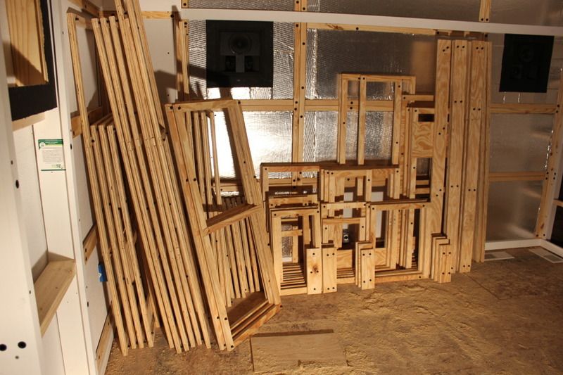

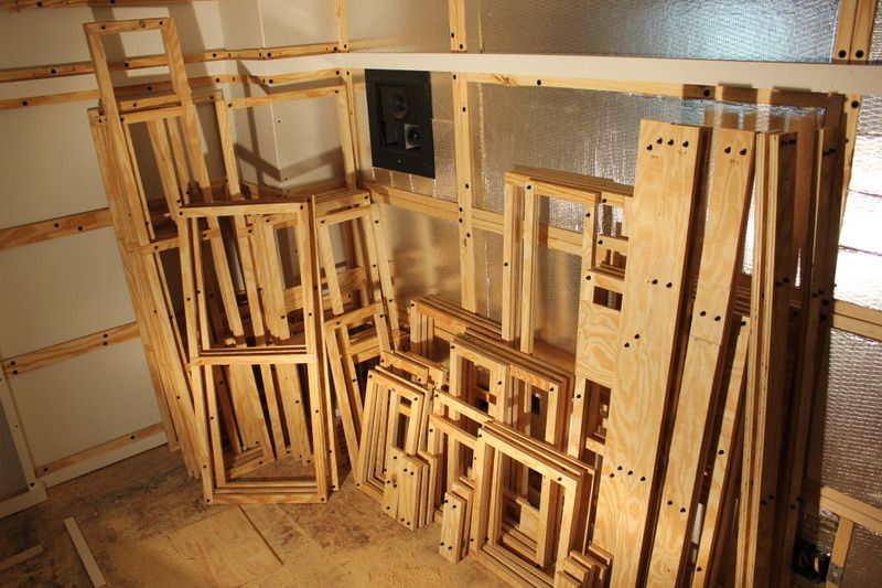

66 Panels done...30 to go. Somehow, every time I count remaining panels I get a different number, but I think I've settled on 30. I've been using more speaker grill pegs than originally planned, so I placed an order for another 16 bags. For those keeping count at home, that would be 49 total bags at 12 balls/sockets per bag. I'll let you do the math to see how many holes I've been drilling. I blame my lack of progress on having to change drill bits when going from drilling socket holes to drilling ball holes. Note to manufacturer - One size fits all would have been better.
With the exception of the panel on the front of the right column (that will swing open to access the equipment rack), I'm pretty much done with the left wall. I'm waiting until after the carpet is installed to build the two odd-shaped panels around the stage and riser steps. On the right, by the stage, you will see the opening I will use to access the equipment closet. I can just pop the 3 large panels off and step over the fixed trim to gain access to the closet.
Like the right wall, these are all long, rectangular panels. The mid-supports make it look like a bunch of square panels.
I also marked the edge of the screen frame on the false wall before taking that back down for safe keeping. I'm now working on the panels that will fit around the screen.
The back wall is still at 90% and the right wall sits at 50%. This is taking FOREVER!
Keep up the good work.

I was doing ok when my brother-in-law left his drill at my house. Then I had a drill for each bit. Unfortunately, he had to take it back, so I'm stuck changing bits. I can't really say that is what is slowing me down. There are just a lot of steps between cutting the plywood strips and actually hanging the panel that really add up when you have so many panels. I'm happy with how it is coming out, just not too happy with my pace.
Speaking of buying more tools, I ordered one of these yesterday. http://www.gleempaint.com/noname.html

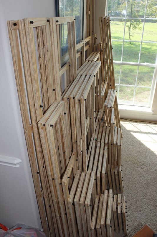

Nothing exciting happening here....just more #$%&^? PANELS!
Everything taken downstairs, ready to be painted this weekend.
I managed to get through 85 of the 100 panels before getting the itch to clean out the room and get the ceiling ready for paint. Yes, the final count now sits at 100 panels. I finally broke down and numbered them on the computer since my quick counts in the room were not yielding consistent results. I really don't have a complicated panel layout, but the way I designed the columns brought me to the century mark. 30 of the 100 panels occur on the 4 columns, so the balance of the room ONLY needed 70 panels. I guess that's still a lot.
I spent yesterday hauling all of the panels downstairs and then vacuuming the entire room (floor, ceiling and walls). Sawdust was everywhere. I can only imagine what my lungs look like, even though I wore a respirator (most of the time). The only panels left are a few on the screen wall, a few on the entry door and a few that need to be measured after carpet.
I've selected the following carpet and fabric, except I'll be using black velvet instead of black FR701 on the screen wall.

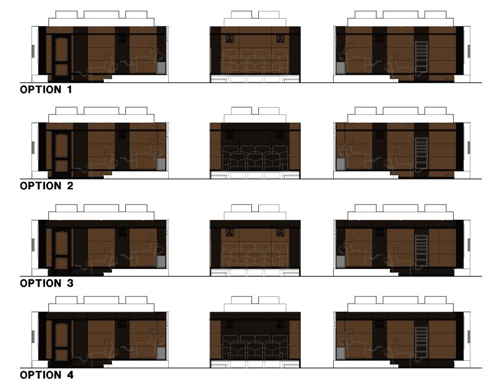

I'd like to throw out a few different schemes for a vote.
All have Cocoa fabric as the primary wall color with Chocolate fabric on the 4 columns. 1x3 black trim is used as an accent.
Option 1 adds chocolate fabric to the 2 bump outs in the back corners, visually adding 2 more "columns" to the room.
Option 2 removes the chocolate fabric from the 2 bump outs and places it on the back wall, creating an accent wall.
Option 3 is the same as option 1, but uses chocolate fabric above and below the 1x3 black trim.
Option 4 is the same as option 2, but uses chocolate fabric above and below the 1x3 black trim.

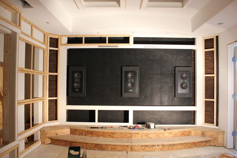

Here is an actual photo of the left wall so you can visualize the columns, rear bump outs and panel placement.
