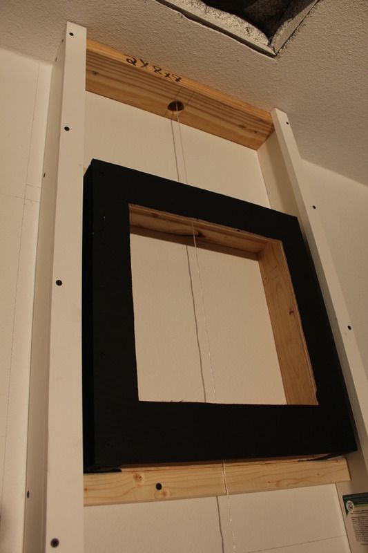

I just ordered my Insteon gear (minus the custom etched buttons for the keypad) and am starting to think about how I'm going to mount everything in the column (2 dimmers, 2 switches and 1 keypad). Can someone explain to me or point me to a thread that shows the correct (code-compliant) way to mount the electrical boxes in a column that sits inside the drywall shell of the room? Do I need to use metal boxes? Does the exposed portion of wiring between the ceiling and the dimmer/switch need to be in metal conduit or do I just need to make sure it is properly stapled? If I do the same as my riser, I'd stick with plastic boxes and simply staple all of the wires at the proper spacing. I'm just wondering if this is the right approach.
I'll have one line wire coming in to the column and 5 load wires leaving through 2 short sections of 1-1/2" conduit stubbed in through the drywalled ceiling. What is the best way to seal up the conduit once I make all of the wire connections, so I don't have holes open directly to the attic. Do I simply stuff insulation into the conduit around the wire bundle or should I use the expanding fireproof spray foam? I know if the boxes were in the wall, I'd need to spray foam the openings in the top plate. Would the same apply here?
The photo below is actually of one of the speaker columns, with a pull rope for speaker wire coming in through the ceiling. The column that will hold the dimmers and switches is similar, except there are 2 holes at the top instead of the 1 shown here.
Spaceman is offline

If the column is 3-1/2" deep like the one you have pictured, you could just staple the wires to the 2x4 on both sides or on a single side with a stackit.
You can secure two cables with one staple and have two cables side-by-side, maintaining 1-1/4" distance between the cable and the edge of the stud.
You will want to run the cables through both holes (ie 3 through one and 3 through the other). If you were to run 5 though one hole you will have derating issues. There is no spec for the sealant you use. You could use caulk.
Metal or plastic boxes, whatever you prefer.
Tim
Tim
Thanks Tim!

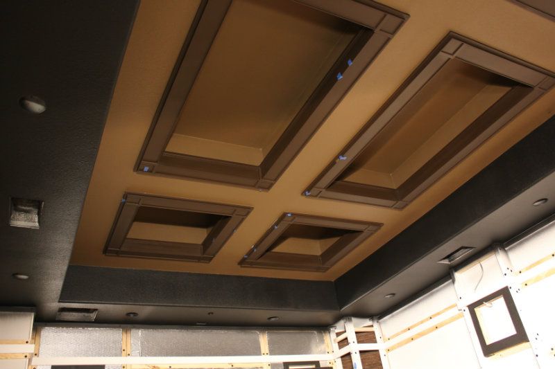

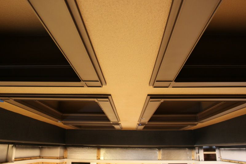

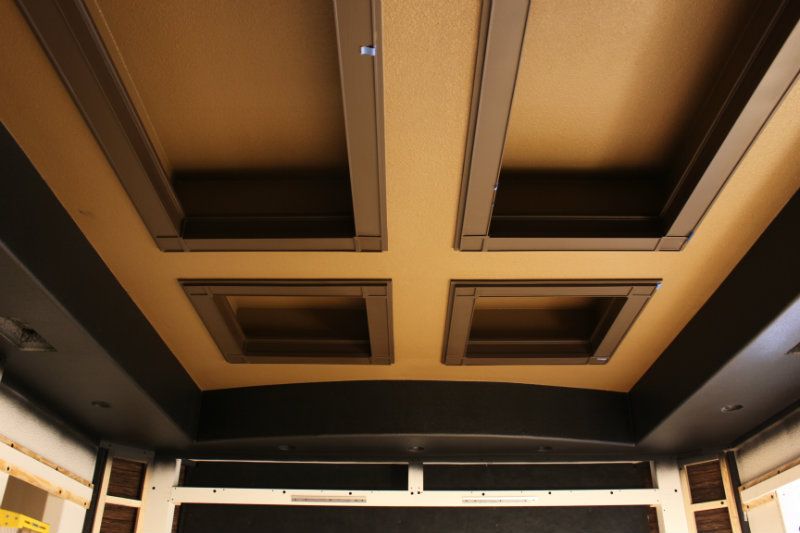

Finished with the 2nd coat on the ceiling. Besides touching up a few areas, I think I'm done. The black soffit is still a little wet, so hopefully it will lose some of it's sheen once it totally dries.
Towards screen wall
Towards back wall
Black: Behr Interior Flat Enamel Mouse Ears
Light Brown: Behr Interior Flat Enamel Melted Chocolate
Dark Brown: Behr Interior Flat Enamel Bitter Chocolate
My two-tone fabric scheme for the walls matches the two browns on the ceiling.
Still need to paint the door as well as the trim on the walls. Was going to stick with the Mouse Ears, but switch to Eggshell for easier cleaning.
Spaceman is offline

Originally Posted by cdika17 View Post
Looking great man, keep the updates a com'n!
Originally Posted by Brad Horstkotte View Post
sexy ceiling is sexy
Originally Posted by vanice View Post
That ceiling is looking really nice!
Thanks guys!
