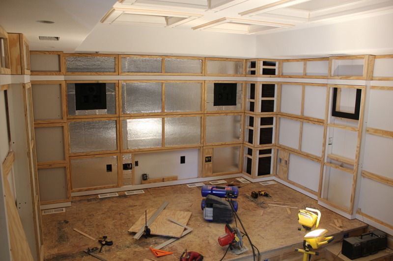

I'm guessing your method for panels might suite me as well, only thing different is I am going 2" on front and sides and 4" on rear wall, perhaps 1" furring and 1" panels on front and sides and 2" furring and 2" panels on rear wall.
With that weight, I am not sure ball and sockets will suffice, might have to use BIG's method and use liquid nails and finishing nails shot through the fabric.

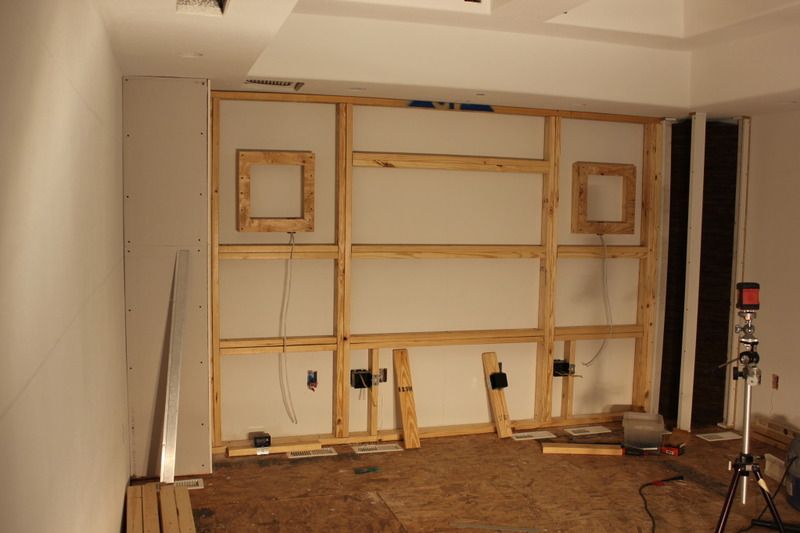

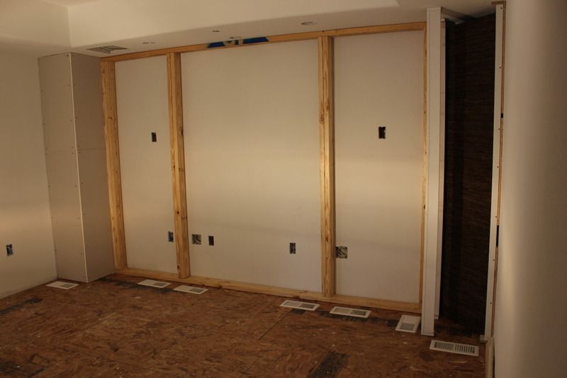

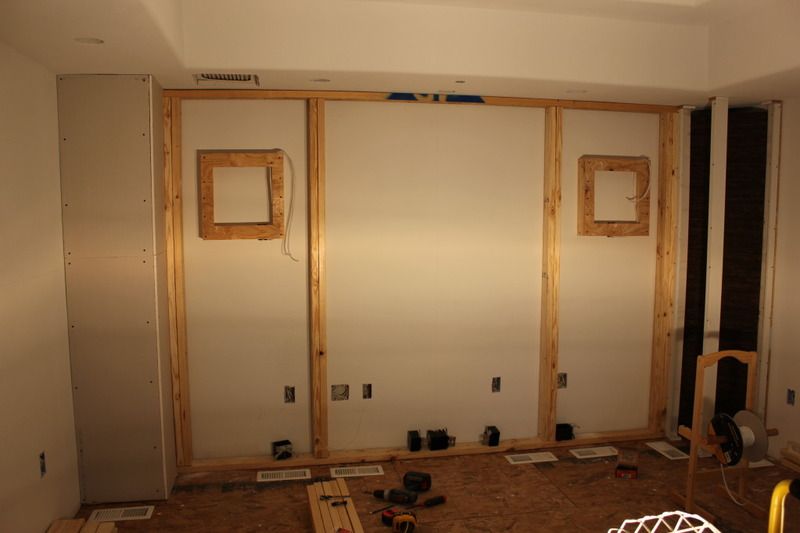

Is your front wall a false wall? If so, the 2" treatments will be behind the screen. The panels that hang on the false wall will be empty so weight is not an issue.
What kind of treatments are you using on the side walls? Are they 1 piece that is 2" thick or 2 layers of 1" material. Looking at what I did, I could see where it would be pretty easy to place a 1" treatment panel between your 1" deep furring strips and then place a 2nd 1" treatment inside the panel so once the panel is attached to the wall, you get your 2". Probably more expensive this way. I used 1" of Linacoustic on my side walls, but since I ordered a 100' roll, I probably have enough left over where I could have done two 1" layers.

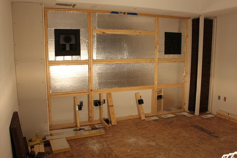

For the rear wall, I framed a false wall 1/2" off the face of the existing wall, to give me a 4" deep cavity that I could fill with 2 layers of 2" treatments. In the case of the back wall, the framing acted as the furring strips, giving me a place to put the ball portion of the panel connector. The actual panels that go on the rear wall are empty, like the ones that hang on the screen wall. They are also 1" thick like all the other panels. I don't think you need to go with 2" thick panels if you do something similar.
Here's what I did for the back wall.
1st layer of 2" insulation board
2nd layer of 2" insulation board with FSK facing. Notice the 4" of treatments all sit within the framed "wall". The standard 1" thick panels just sit on top of all this.
1" thick panels secured to framing (panels are empty)
Spaceman is offline

I will be using 2" OC703 for everything. I have 384 sq ft of the stuff.
Front wall will use adhesive and screws with fender washers or something.
So your rear wall will actually be 5 inches?
Might be easiest to build what you did for rear wall for all my walls, 2x4 for rear(actual 1.5x3.5) and half inch gap and rip a 2x4's to a 2x2's for sides walls, but then to add a 1" frame on top would decrease my dimensions further and don't know if i want to spare another inch!!
Chase "Fetch"

So the plan on the side wall is to place the 2" treatment inside the 1" panel? The remaining 1" that sticks out proud of the panel will slide into the space created by the 1" furring? You'll need to be careful when cutting/placing your furring strips to make sure that the entire length will be hidden behind the panel frame. Any portion that sticks out past the frame will prevent your treatment from sliding in.
Yes, the back wall is actually 5" thick (1/2" gap + 3-1/2" of framing + 1" fabric panel). That's one reason I built an 8' deep riser. I knew I was going to lose a lot after the panels were up.

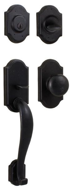

I've started researching door hardware. I don't want to use the same door hardware that was used in the rest of the house because I want the theater entry to be a little different/unique. I'm actually considering an entry handle typically found on an exterior entry door and just not installing the deadbolt hardware.
The door (now painted black)
The hardware (not necessarily this style or finish, but the combination of a handle on the outside and a knob on the inside)
I'm assuming this style can be installed without the deadbolt. Anyone know if they can be purchased without the deadbolt? Will the "handle" style look odd on an interior door?

You do not need to install the deadbolt to make the handle portion functional, you just would not be able to lock the door (not a big deal) and it would be regarded as what is called a "passage" door set.
As to the style, I think you have a fairly modern look with clean lines with all of those panels. The handle you show above seems very traditional to me and wouldn't be my first choice if looking to line up the inside of your theater with the external handle set.

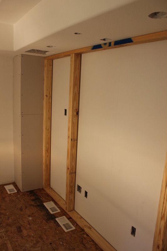

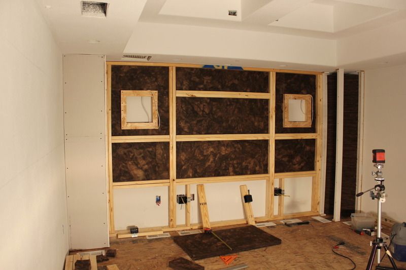

Panels are 80% done. Still have some to fabricate, but will do that after carpet. Pics with them on the wall are a few pages back, but I have them off the wall at the moment. Currently respraying the ceiling with a different color. Hopefully, this new color will match the fabric a little better. The black speaker fabric came in on Friday, so while the panels are down, I'm going to cover the acoustic treatments on the back wall to keep them from showing through the fabric. I also gave all the trim another coat of paint.
Jeff with Night Sky Murals will be here next week or the week after, so I had to make sure the ceiling was ready.

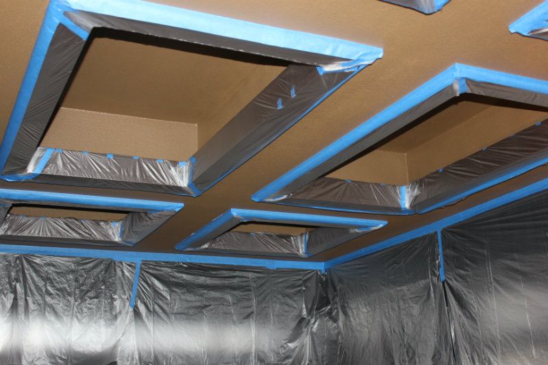

3M reports that they will meet quarterly earnings after a sharp increase in sales of their popular blue painter's tape. Sales have been unexpectedly high in the Houston market, despite the struggling economy.
Ceiling Prep: Take 2
Before taking down all of the fabric panels for safe keeping, I tested the new color in the corner of the ceiling and it seemed to be a good match. But guess what? It doesn't matter, because I'm not doing this a 3rd time.
New paint is drying overnight. I'll throw a few panels back on the wall tomorrow to see how things look.

What a total PITA, but very nice work as always.

Spaceman you should offer to rent out the room to Showtime to film a 'Dexter' episode... Might pay for a few rolls of tape... biggrin.gif
I guess the good news is that you probably saved Jeff some time by already masking the whole area for him, too!
Thanks TMcG.
Not really. I took it all down this morning mad.gif I doubt he needs much besides a few drop cloths on the floor. He's working with tiny little brushes.
Originally Posted by Brad Horstkotte View Post
Soldier on buddy! A lot of work to remask and repaint the ceiling, but I'm sure you'll be much happier getting it done if it was bugging you.
It was bugging me, so I'm glad I redid it. Nobody else would have noticed, but I'll sleep better at night. The new color is so close to the old one I had trouble sometimes keeping track of the spray pattern, particularly when painting in the shadows of the coffers. As usual, prep took longer than the actual painting, but it came out fairly well. Moving onto bigger and better things...
