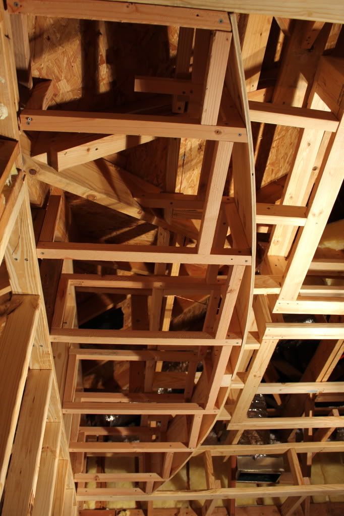

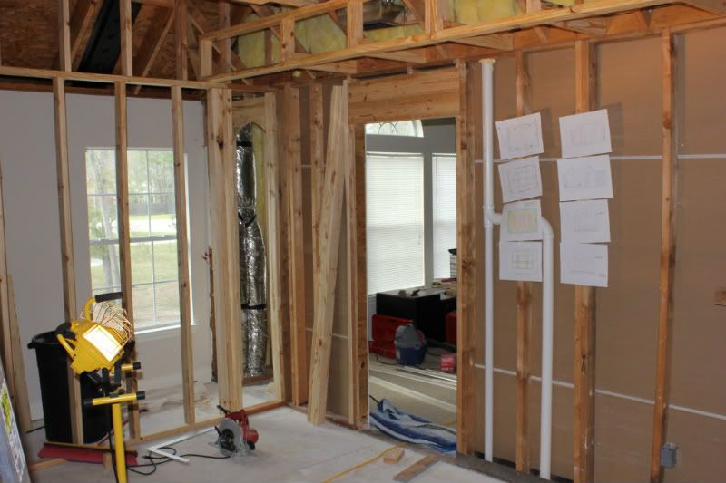

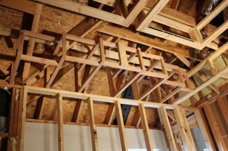

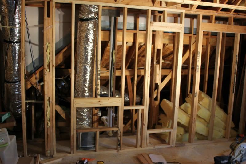

Quoted: 45 Post(s)
Liked: 150

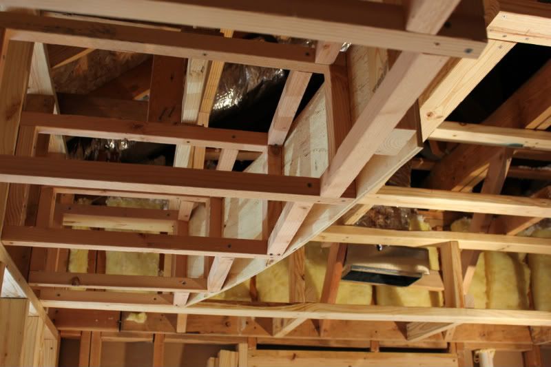

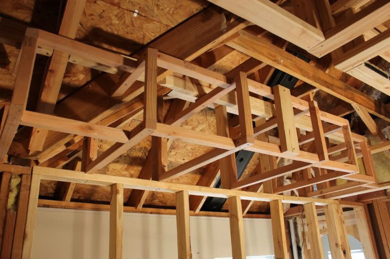

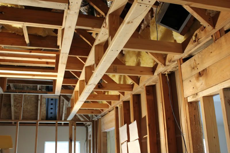

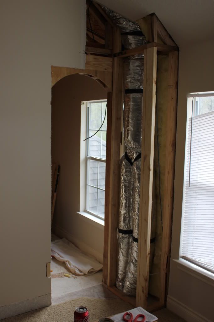

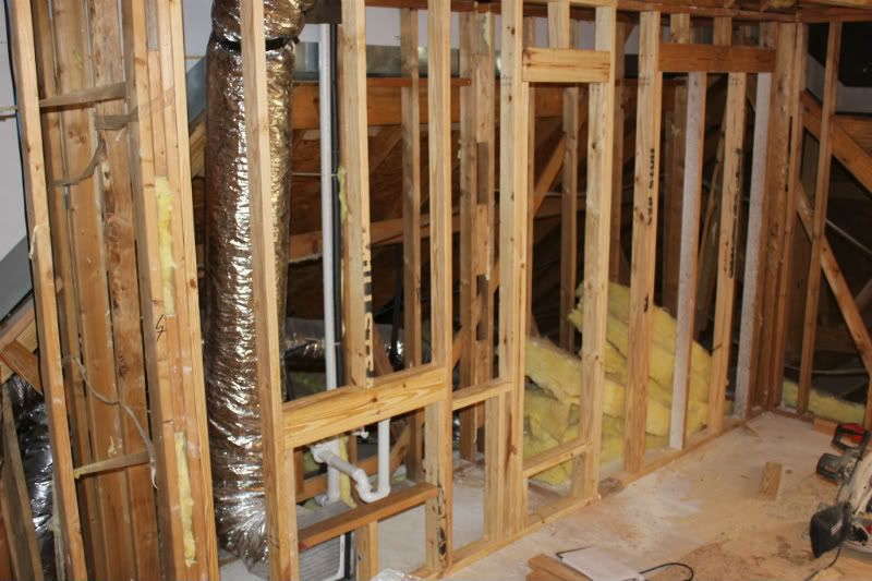

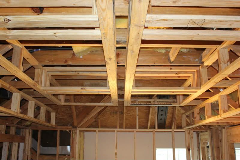

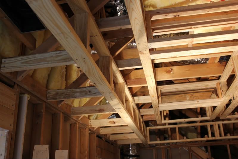

More framing photos. I know...they aren't sexy, but it's all I've got.
From screen wall towards back wall
Perimeter soffit
From back wall towards screen
Perimeter soffit
Opening for rack and HVAC return
Opening for new entry door
New entry door (left) and entry to media closet (right) (view from game room)
New entry to media closet (finished framing around flex ducts)
From media closet to game room
Next order of business is finishing the bottom supports on the left soffit and then tackling the curved soffit above the screen. I think I may order the ELCO recessed lights as well so they will be here when I'm ready to start electrical.

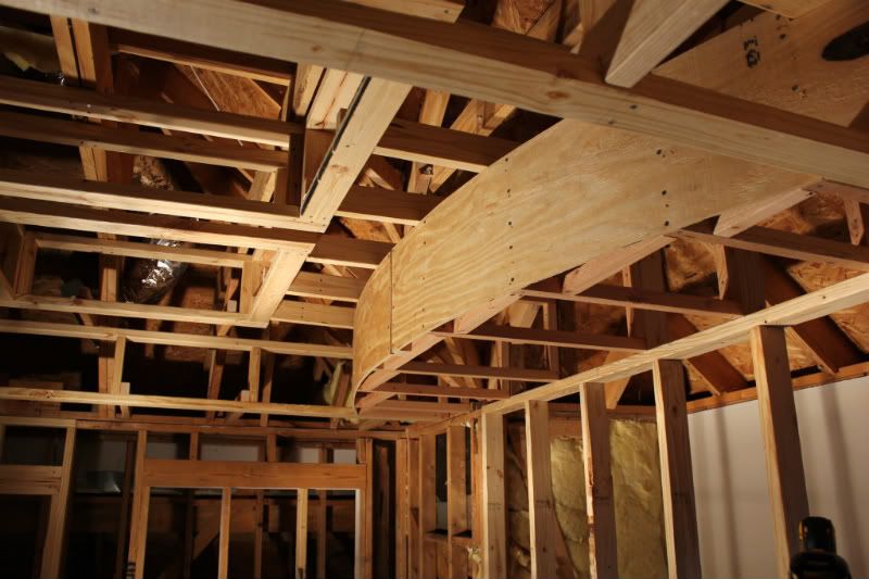

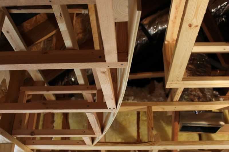

post #66 of 1283 Old 02-10-2012, 06:48 PM - Thread Starter
Spaceman's Avatar
Location: North Houston
Posts: 2,015
Mentioned: 10 Post(s)
Quoted: 45 Post(s)

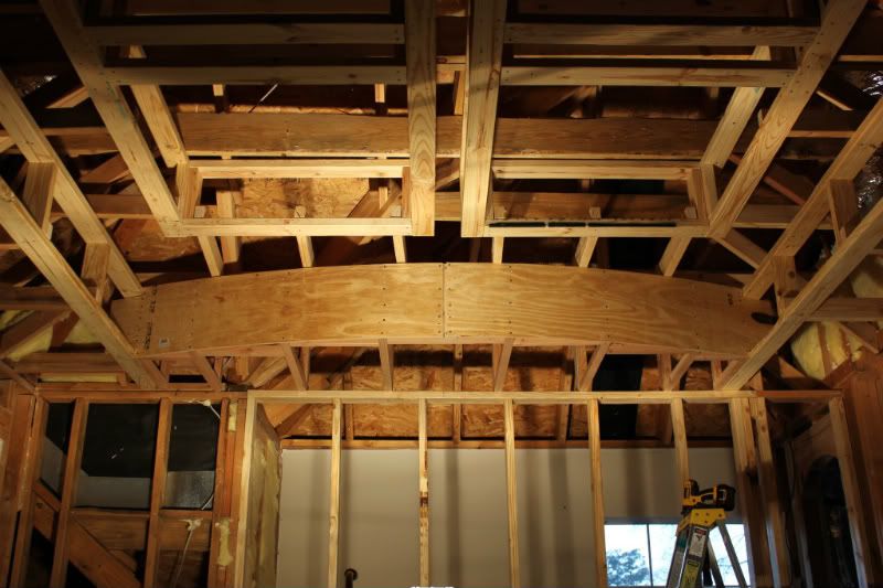

Liked: 150

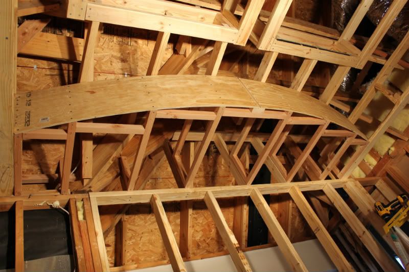

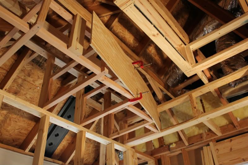

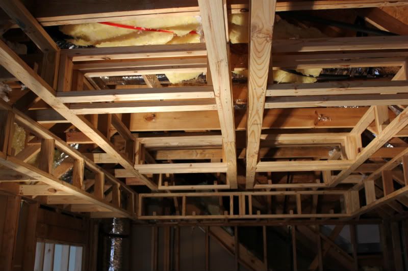

Worked on the curved soffit in the front of the room today. Lots of 2x2s, some 1/2" plywood, a few screws and my laser level.
Framing before plywood
Start of plywood
Right about now, I'm wishing I just bought the big bucket of screws at HD instead of making numerous trips for 1lb & 5lb boxes. I've used almost 17lbs in the walls & ceiling. I still have my stage & riser to do, so I'll probably grab a 25lb bucket.

Thanks Stockmonkey. I really don't have any construction experience so I'm just trying to take my time, and plan, plan, plan. Everything gets done on the computer first and I still end up doing some things twice. Fortunately, with limited skills, it doesn't take much to feel a sense of accomplishment. When things actually come out level, I get a little giddy. Frankly, I'll just be happy if I finish this project and the ceiling doesn't fall down and I walk away with all 10 of my fingers.

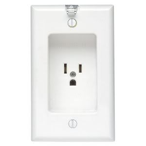

My coffered ceiling has 6 recessed areas. I'll be placing an outlet in the corner of each recess for rope lighting and daisy-chaining all of the outlets to a dimmer.
The original plan was to use (6) single receptacles for each section of rope light
...but for a few bucks more, I could install (6) duplex receptacles
I'm not sure what else I would need to plug in up in the ceiling, but having the flexibilty might be nice. Are there codes or common practices that make one choice better than the other?
Spaceman is offline
post #70 of 1283 Old 02-12-2012, 01:11 PM
jautor's Avatar
Join Date: Jun 2001
Location: NW Houston, TX
Posts: 10,698
Mentioned: 30 Post(s)
Quoted: 1331 Post(s)
Liked: 852
Could have fooled me! Looks better than the "pro" framing on most work I've seen in Houston
Since they're the same size the duplex may give you more flexibility in getting the cord to sit flat. I'd install those horizontally so you've got the best chance of them not being visible. And of course paint them to match the wall...

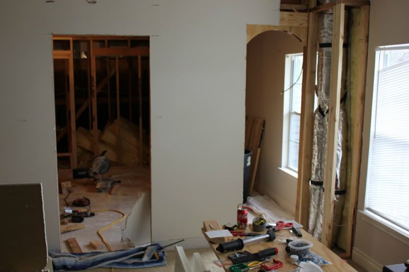

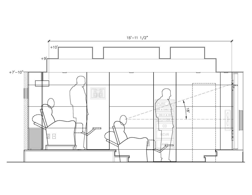

I need to make the necessary framing/electrical provisions for the projector. Am I correct that if I plan to zoom between 16:9 and 2.35:1 on a 16:9 screen, the lens needs to be lined up exactly with the top of the screen, i.e. no vertical lens shift allowed? If so, the projector will sit fairly low relative to the top of the riser. As you can see below, I think the only place I can put the projector is below the rear soffit. Any further forward and people would be banging their heads on it as they get in and out of the rear seats.
I can't really move the screen any higher. My viewing angle is already at 18 degrees, slightly more than the maximum recommended angle of 15 degrees. Does anyone see a problem with where I show the pj? One concern I have is the heat and fan noise generated so close to the heads of back row viewers. I haven't researched them yet, but I'll be looking at ones in the $3-4K range. I'm assuming most can handle a 16' throw on a 100" screen.
I'm not sure the next step up in my ceiling (9' height) is wide enough for the projector anyway, even if I could mount it higher than the top of the screen. I'd still have to let it hang down below the lower soffit, just maybe not as much as currently shown. Perhaps where I have it is my only placement option.
Below is a picture of the rear soffit. Bottom is at 7'-10" (relative to main floor, not riser). It steps up to 9' and then the recessed areas each step up to 10'. I could make some adjustments back there if I need to if the proposed projector placement looks problematic. Any thoughts?

UPS & FedEX should be busy over the next day or two delivering various electrical orders. I have can lights coming today, followed by receptacles, face plates and other various goodies.
Before starting electrical, I had the electricians come out this morning and run (2) 20A circuits to the theater. One will be for the equipment rack. The other will be for both lights and outlets. The original plan was to add (1) 20A circuit for the equip and (1) 15A for the new lights. I was going to keep the outlets on their existing 15A circuit, which is shared with the adjacent game room. The electrician recommended separating the game room outlets from the theater outlets and simply put all theater lights and outlets on a 20A circuit and let the existing 15A circuit serve the game room only. While it would have been nice to have the lights stay on if the outlets trip, I'm ok with this configuration. Considering the original layout had both theater and game room lights and plugs on just 1 circuit, it's still an improvement.
Before setting an outlet for the projector, I'd like to know if my proposed pj location looks ok to everyone (see post above).

Just curious as how you measure the viewing angle? I have no idea how to do that, it is probably an important thing to know, lol.
-Sean
This is what I have used for measuring viewing angle:
http://myhometheater.homestead.com/v...alculator.html
barlav is offline
-Sean
AutoCAD did it for me. Someone that did better in trigonometry is going to have to weigh in.
-Sean
You can use trigonometry to calculate the viewing angle. Measure the vertical distance from your eyes to the top of the screen. Then measure the horizontal distance from your eyes to the surface of the screen. This gives you a right triangle with these two distances as the legs. To find the angle you use the inverse tangent function of the opposite leg over the adjacent leg.
So it's tan^-1(vertical distance/horizontal distance)
This will give you the angle that you will need to tilt your head to have your eyes pointing at the top of the screen.
