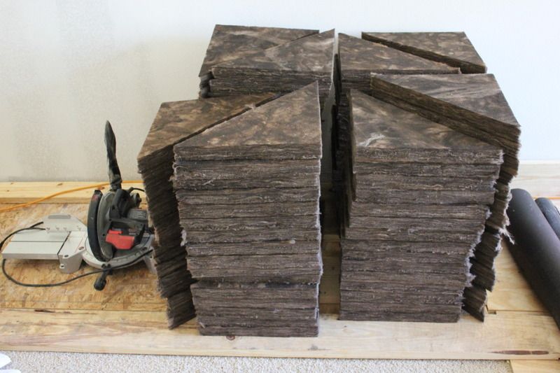

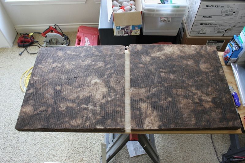

Started cutting in the primer this morning. Hope to break out the roller tomorrow. In other exciting news, I have my corner bass traps cut.
2' x 4' x 2" insulation board
I didn't feel like running out to get an electric carving knife, so I tried what was on hand. A standard utility knife did not work well as the blade does not extend enough to cut all the way through the 2" material. However, I did find one of these in my tool box, left over from an old wallpaper kit. I was able to extend the blade 2 1/2-3" which worked out pretty well.
Sliced in half, forming (2) 2'x2' squares
Each 2' square cut into 4 triangles
Lots of triangles for 3 corner bass traps
I did try stacking them in one of the corners and the stack wanted to tip forward. Is there a trick to keeping everything upright? Do I need to build some type of frame to hold them up or will the Linacoustic that runs between stacks hold them up?
Spaceman is offline

I think what most people do is screw a 2x2 onto the wall on each side of the corner and then the triangles can fit right in and are held in place.
Yeah, that's what I was thinking I would have to do. Has anyone put a thin shelf half way up the stack? Would that reduce the acoustic properties?
Spaceman is offline
I used OC703, but there was no need to put a shelf in half way up, the boards holding them in the corner was enough to keep the triangles stationary. From your pictures, it looks like it should support itself pretty well.
brausch is offline
I was thinking a shelf might allow me to eliminate the vertical 2x2's in the corners. I can get about half way up the wall before it starts to tip. Thought a shelf might be an easy fix but maybe the 2x's are the best way.

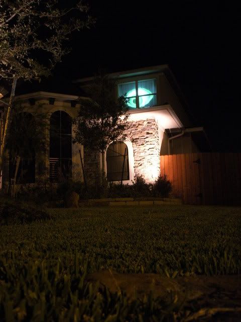

I would like to extend another big "Thank You" to Jautor for having my family over today for the exclusive behind the scenes AVS member tour. Being able to test drive different image sizes from our proposed seating distance was extremely helpful. We all loved your space.
Folks that help stock the bar are always welcome for test drives!
(note for future reference: While Planet Earth makes for good, big expansive images, every scene ends with something getting eaten.)
Letting us borrow a spare projector to test things out in our own home was very generous and much appreciated.
You're welcome - I found testing the screen size long before the room was finished to be very reassuring that I was on the right track. I did it twice - once with a little business PJ in the unfinished room before theater construction even started, and again with the real PJ before finalizing the screen order...
But let's not overstate that "spare" projector - a new-but-8-year-old business PJ from the surplus auction isn't a backup for the real one! Those units are good for testing screen size - but the image isn't going to be pretty! I bought it for Halloween usage - rear projecting on a window has been a big hit:
http://hallowindow.com/
Look forward to seeing the finished product - y'all have popcorn, right?

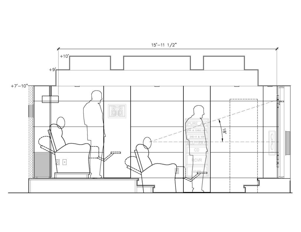

Yes, an AT screen on a false wall. I'm currently updating my plans to reflect a 115" wide 2.35:1 with all 3 speakers behind instead of a 100" 16:9 with only the center behind. Looks like it should work just fine. Everything is REALLY tight however, so I need to sketch it all out ahead of time to make sure all the pieces come together correctly without any conflicts.
The space behind the false wall is very narrow (only about 9" from the face of the acoustic treatments on the front wall to the the back of screen). My speakers are closed-box in-walls, although they will be installed more like on-walls so they sit proud of the 2" treatments I have on the front wall. I'm working on the mounting detail right now.

Where are the subs going since you only have 9"s to work with?
Behind the back row.

It's looking good. I have the same insulation for my front bass traps, and also for a 2" thick treatment covering the entire front wall behind the screen. You have a beautiful stage but I think most of it is going to be covered up and you won't be able to see much of it.
It looks like you have a door on both sides of the stage, have you got some soundproofing ideas for them?
Yeah, unfortunately I didn't have the room to build a deeper stage so a little less than half of what you currently see on the top will be hidden behind the false wall. The top is currently 28" deep at the widest point and 11" of that will end up behind the screen (9" open space + 2" of acoustic treatments).
The opening to the right of the stage is the entry to the theater and will receive a solid door. No special soundproofing there as I don't really have any sound isolation measures elsewhere in the theater. The opening to the left of the screen will not get a door. The fabric panels at that location will simply run across the opening as if it wasn't there, and they will be removable at that location to allow access into that closet and the back of the equipment rack. I don't expect having to get back there very often so I didn't want to clutter up that wall with a door. The column to the left of the opening will swing open for access to the front of the equipment rack.
The dashed rectangle on the wall is the opening behind removable panels.
I thought it looked a bit tight up on the stage. I'm going to move my screen wall back six inches to gain some viewing distance for the first row. I'll have about 1'6" behind the screen. Speakers are 12" deep and subs are 15 5/8" diameter.

I'll be putting Linacoustic on my front wall tomorrow. I'm planning on 2 layers of 1" material. It looks like quite a few of the more recent builds, including most of Dennis', include a layer of poly sheeting between the 2 layers of Linacoustic. Would I be getting myself into trouble by doing the same as part of my "one size fits all" acoustic strategy?
My current plan is as follows:
-(2) 1" layers of Linacoustic on the front wall, either with or without 3.5 mil poly sheeting between layers
-1" Linacoustic on the side walls (floor to ceiling for the front 1/3, ear height for the back 2/3)
-4" of 3pcf boards on the back wall (actually 2 layers of 2" boards-outer layer has FSK facing)
-corner bass traps in the front two corners and back left corner
-no ceiling or soffit treatments
Any thoughts on either the overall approach or specifically, whether the the use of 3.5 mil polyethylene sheeting between the layers on the front wall is appropriate?

I was told to put Polly only on the rear wall, that coming from Bpape, but could of just been for my application.
