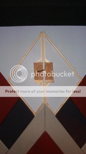

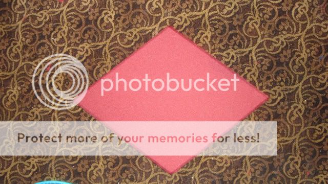

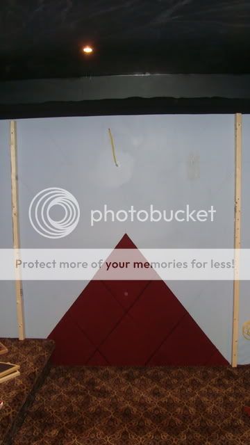

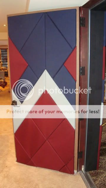

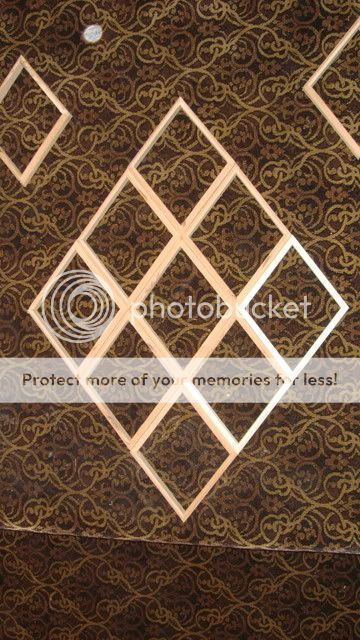

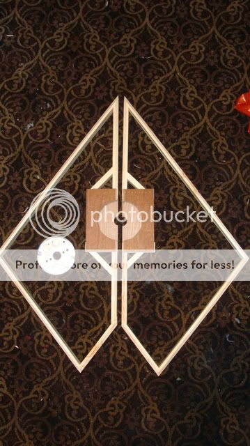

We'll I spent a couple of hours Friday night making all the common diamond patterns for my first wall segment. Everything went as planned until...
I layed them out on the floor and confirmed my concern that the small patterns would be too dense for a surface that was supposed to absorb sound. The frames just seemed to take too much of the surface area.
I made them from 1/2" MDF and a couple from some 1/2" popular I had laying around. I chose 1/2" to maximize the amount of Linacoustic. But after seeing it first hand I thought better about it. Also I tried to attached fabric to an mdf version and it just came apart from the stress of the stretched fabric . Small pieces of the Achorage GOM do not have a lot of give to them and pulling them hard enough for a tight fit caused the mdf joints to fail. So I've decided to stick to solid wood.
I asked my better half for her artistic opinion. She thought a larger diamond pattern would look better as it would balance out to upper and lower halves of the wall . So I spent some time on Saturday sketching out options again. So here is what we decided looks the best and keeps the original intent we were looking for.
With the flash on the camera I can see some wrinkles in the fabric which are not visible in natural light so I will need to work on my technique. Fortunately these panels are only held in place with a few well placed pin nails so I can removed them, restretch, and reinstall. I will also fix a few gaps I see between the panels.
But overall that is the look I will replicate on the rest of the wall segments. I will take more detailed pictures of the next wall segment for those interested in the technique I am using. Kibitzing is welcome..
Oh well, the best layed plans of mice and men and HT geeks....

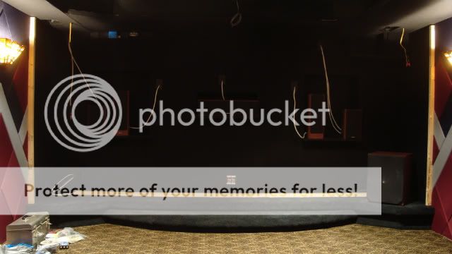

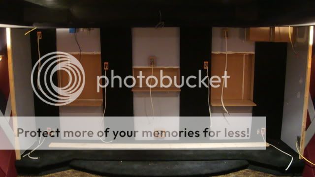

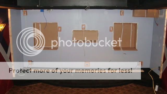

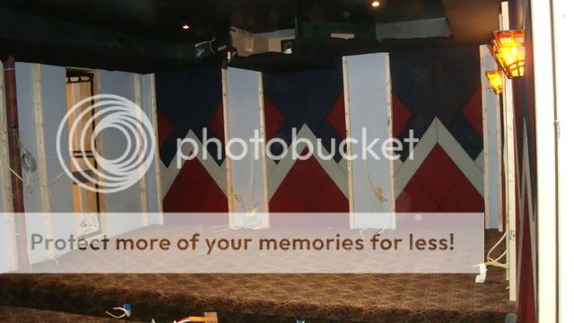

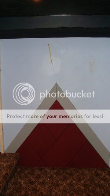

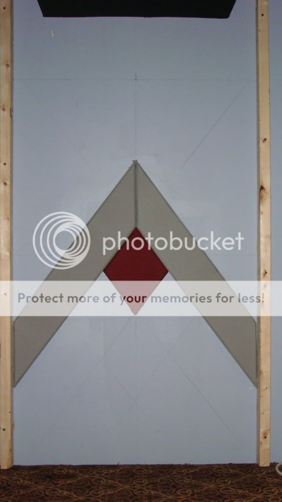

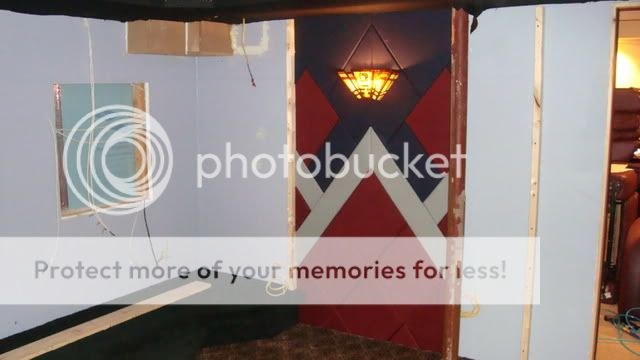

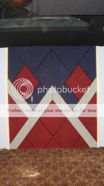

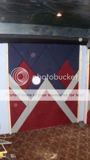

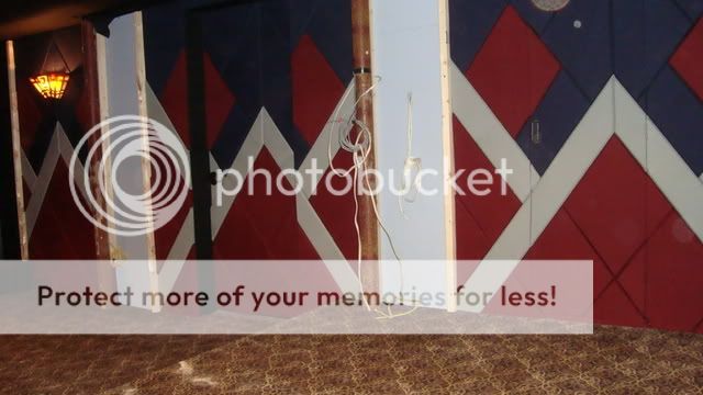

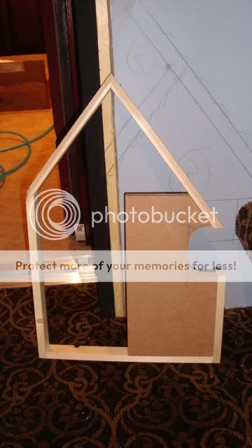

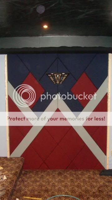

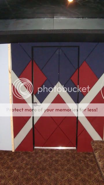

Still working on wall panels. Spent the labor day working on the next major segment. I decided to work on the large wall segments first to fine tune the design and install the walls scounces so I can get additional lighting in the HT. Here are a few pictures...
Main wall segment you face as you enter the HT. Starting at the bottom first and working my way up...
I am working on the diamond patterns in this order to get tight joint in a straight line:
.....6
...4...5
7 2 1 3 8 9
Then the border...
The fill in the left and right upper segments...

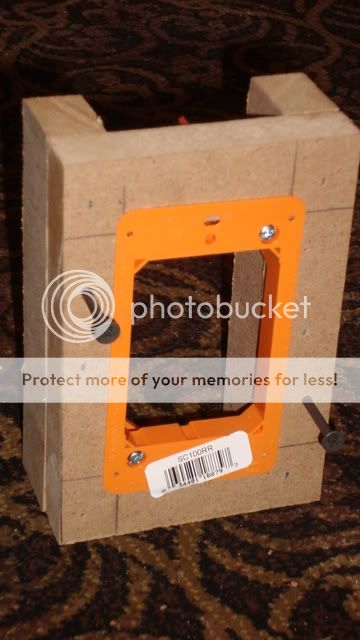

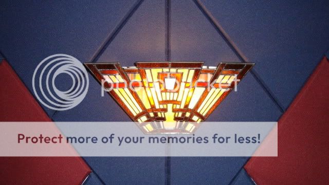

The center frames show how I am handling the scounce box. Basically making a wooden box for the shallow round ceiling box to fit into. The ceiling box is installed after the left and right center panels are wrapped in fabric and fastened in place. The box is then screwed down into the wooden box for a nice tight fit.
Finished wall with wall scounce installed...
Close up of the wall scouce. The angles on the fabric panels match the angle of the glass surround...
It took me some time to get the panel fabrication down and attaching the fabric. My next post will be a detailed step by step of how I tackled the problem to avoid sags in the fabric...

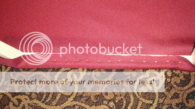

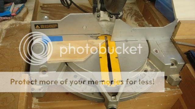

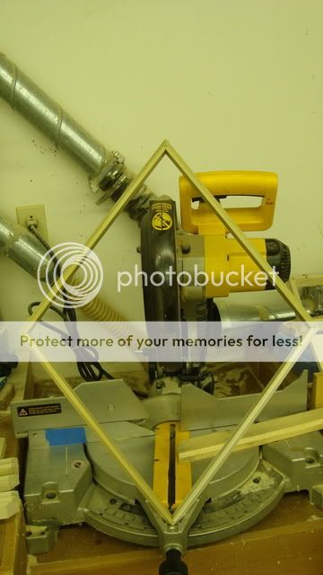

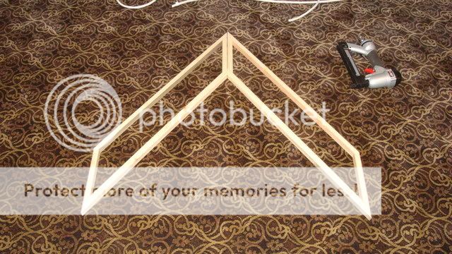

Here is my storyboard for making the fabric wall panels. There are several good threads out there. Here's my contribution. Feel free to kibitz..
Make frames...(use wood not MDF per my previous post)

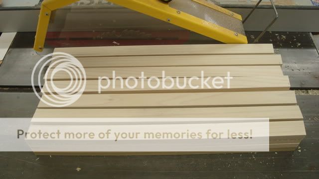

I started with 1/2" aspen from HD.. But I found this to be expensive so I've switched to 3/4" pine and ran them thru my planer to get to 1/2" thick material.
Ripped them on the tablesaw to 1" wide stock ..
Cut the 1" strip to length. For the basic diamond shapes, I went with 16" on a side.

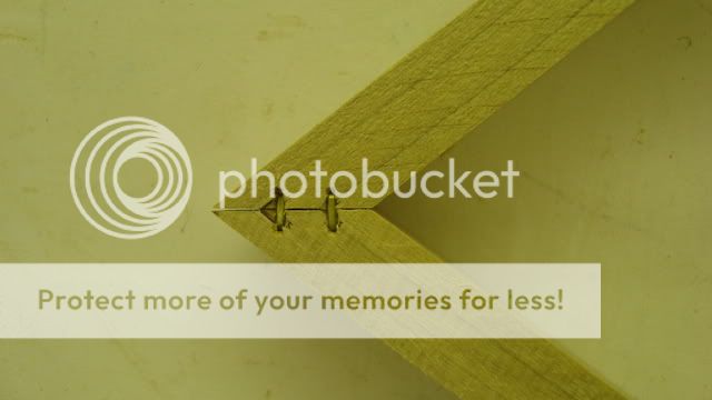

Then mitered each end on the power miter box. The angles I worked with are 75 degrees and 105 degrees included respectively. The 75 degree side match the angles on my wall scounces. I used jigs to accurately set the miter box to the right degree for each set-up. Since a miter box only cuts at 45 degree max I made a cheater jig shown below to hold the wood at 45 degree and then set the miter box for the remaining degree to get to the right finished angle....
Once all the sides are cut, I ran each piece thru the shaper with a 1" 45 degree miter bit to put a 1/4" chamfer on the outside perimeter...
Once I had all (4) sides done I pin-nailed the diamond together and finished each joint with (2) 1/2" staples on the bottom and (1) on the top of each joint.
Finished frame...

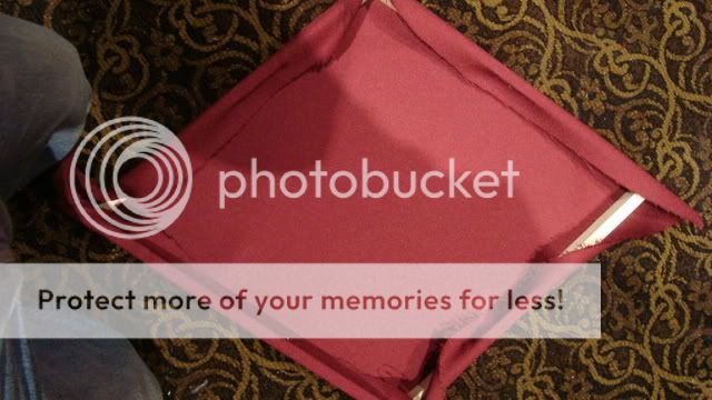

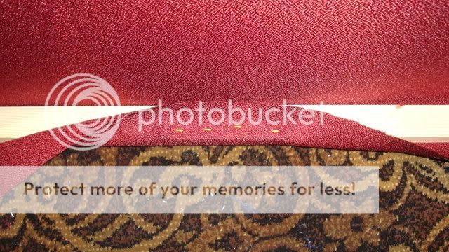

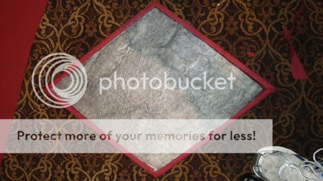

I then layed the frame on the linacoustic mat and cut out a piece with a razor knife using the frame as a template. I then cut fabric so it was approximately 2" to 2-1/2" wider than the frame..

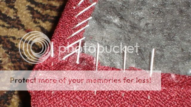

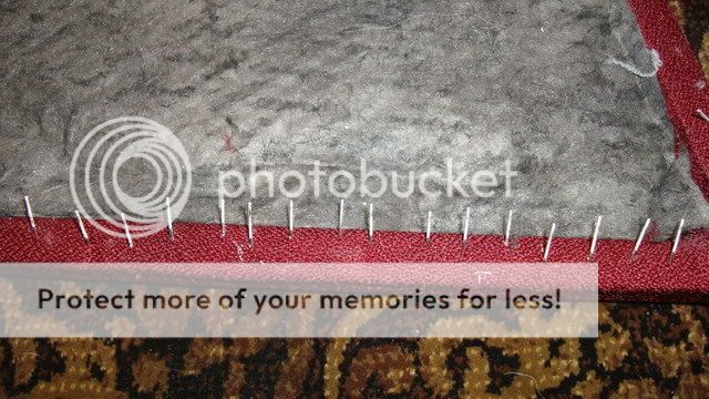

I then stapled one entire side of the fabric to the inside edge of the frame leaving the last 2" on each end unstapled.
Then I lightly stretched the opposite side and put 4 staples in the center...
I then did the other (2) sides and placed 4 staples of each side with just some light tension. The frame looked like this at this point...

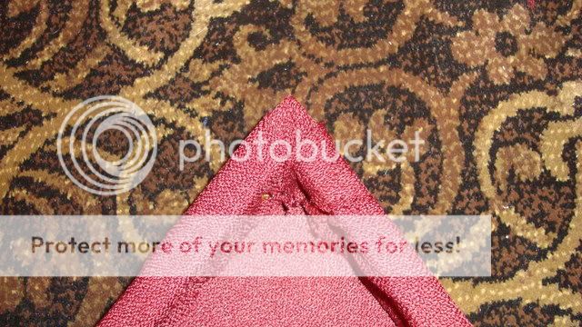

Then at each point I pulled the fabric and placed a staple in each corner..
I then worked in opposite corners and pulled the fabric and finished the remaining staples on 1 side of the center ones. Basically like tightened the wheel lugs on your car. I then finished off the corners by tightly pulling the excess fabric and placing another staple in each corner...
The finished stapled frame looked like this...
The excess material was trimmed off with scissors just below the staples. The linacoustic was then place inside the frame, black surface down...
The finished panel looks like this...
I then install the panel on the wall and secure it with a gazillion 1" 23 gauge pin nails set at a 45 degree angle. They hold plenty good. I know as I had to remove some from the wall already that I had lined up to the wrong witness marks.... It took a claw hammer and some work to pull the bloody thing off the wall. Picture below of wall the pin nails look like installed...
Another angle...

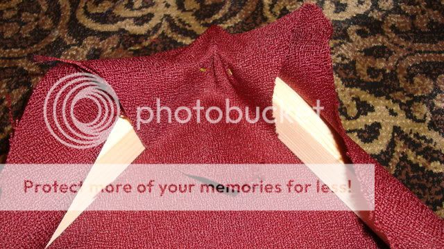

This is what the wall looked like when I pull them off. Won't make that mistake twice .....I hope...
Another shot...
All in all it takes me an average of 1 hour to make each panel. Less for the common ones like the diamond shapes. More for the special ones on the corners the have 5 sides and cut ins for the for riser and procenium. So I figure I have at least 2-3 more weeks of panel construction before I move onto the next phase with is installing the screen wall and front speakers.

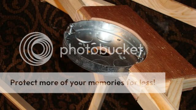

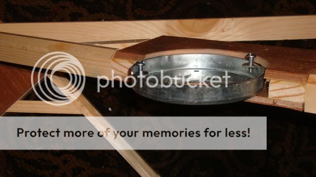

Well I finished off (2) more wall sections. I am was able to hook up 3 of the 4 scounces to the Lutron controller. Below are some pics....
First, a close up of the fabric frames for around the scounces...
Here is what one of the panels looks like from the side with the shallow ceiling box.
Slight different perspective. When the frames are wrapped in fabric the cans are pressed into the pocket and screwed in place with drywall screws. The can gives the fabric a last good tightening.

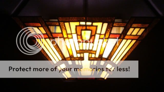

Picture of scounce lit with (2) 40w cool white bulbs (with flash)...
And no flash...
I am very pleased with the look of the scounces. The brown tiffany glass gives off a nice warm glow.

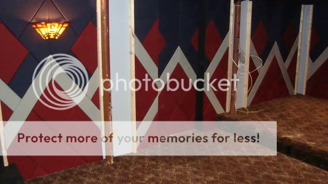

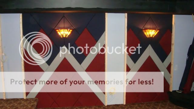

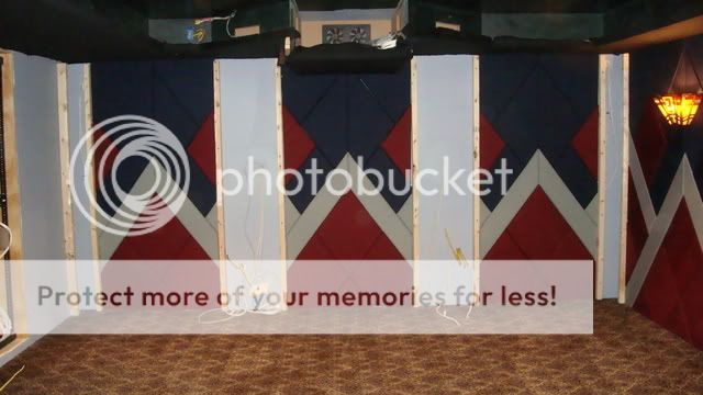

I'm continuing to plug away at fabric panels. I now have (2-1/3) walls completed. Next step is to finish up the equipment rack wall segment. I plan to construct a door for the equipment to mount fabric panels to keep the continuity of the pattern. I looked at the Middle Alantic doors and they want an arm and a leg for a plexiglas door . I figure a custom door to match the decor will look better anyway. A few pics for your enjoyment...
Back wall now completed. I redid the center section to match the others and to restrech the fabric properly to avoid sags/ripples....
Shot of completed left side wall....
View from the front left corner towards the riser...

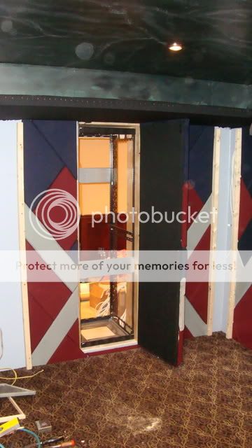

Once the equipment rack section is done I will move to complete the front wall. Then I will stain and seal the HT entry door and finish up the right wall. Then onto the screen wall, screen installation, and procenium columns.

One more section of wall completed. This one is the portion where the equipment rack is. After some thought I decided to build a door to mount fabric panels to keep the look of the room consistent. Below are some pics.
With door closed...
With door open...
And a view of the back wall and equipment rack section...
Now I'll give myself a small break and finish up the front wall. No fancy panels or cut; just simple squares and GOM. After that I will work on finish up the door installation and remounting the door seals, etc. then finish up the fabric panels. I will be glad when this is part is done. I think I will swear off miter joints and staples for a while...

post #112 of 198 Old 10-28-2010, 07:02 AM
jelloslug's Avatar
Location: Greenville, SC
Posts: 739
With door closed...
With door open...
I love the secret door.
jelloslug is offline

Guys - thanks for all the nice feedback. Everyone here knows we toil away at our own little DIY projects. Feedback is always appreciated...
I'm pleased with how it came out. I still have some tweaking to do. I have some spring detents coming in from Rockler to keep the door closed. I came up with a simple way to hide the hinges for the door that I will post some pictures on a little later on.

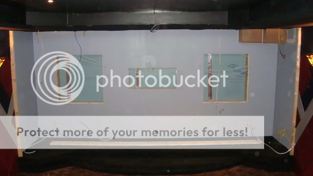

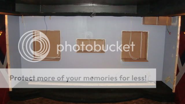

A few more progress pics for you. The front wall is now complete. All it needs is a screen and speakers.
What I started with...
Boxed in the speaker cavities w/3/4" MDF and caulked around to perimeter....
Then I made some boxes for the Carlton boxes out of 3/4" MDF. I had to make them 2" deep to accomodate the plastic inserts...
I applied constructon adhesive to the back and screwed them in place....
I constructed 2" deep fabric panels to match the LV boxes. Wrapped in GOM FR701 black fabric and layed in 1" of Linacoustic....
And the finished product. Just need some covers for the speaker wire...

I've finally have gotten past this stage of the build. The HT door has been stained, sealed, and remounted. Door seals and threshold have been reinstalled. The last of the panels have been installed. The final tally:
264 fabric panels
40000 staples
12000 pin nails
Here are a few pics...
HT door exterior...
HT door interior...
Pic of how I frame around the riser...
Interior of the HT door section...
And of the entire wall...
This was a lot more work that I originally envisioned. But once I had that first wall section completed I knew that was the look that I wanted so there was no choice but the finish it. I am really pleased with how it looks. The wife and kids love it. So now I can move onto the next step; installing the front speakers, subwoofers, receiver and run a wiring check. Then get the screen up and finishing the procenium.

Hooked up my speakers and AVR yesterday. Everything checked out. I have a series of Axiom speakers that we used in our familyroom big screen TV set-up. Here's the inventory:
Center - VP150
Left, Right - M22i
Left, Right presense - M2
Subwoofer - EP350
The EP350 is in question as I'm not sure if I can fit this in the front given the size of the screen. I'll move this around for the best sound and see where it winds up. I did go ahead and purchase an in-wall Triad Bronze subwoofer with sub-amp for placement in the left front column. I'm going for a 2 subwoofer arrangement.
We thought we would try these first to see how they sound. Our family room is similar is size to the home theater but with the back wall open to the breakfast room/kitchen area. When we watch movies we have no problem with filling the room with sound. I am no audiophile so we'll see how things sound and test out when I'm all done. We'll see where we go from there.
Here's is what it looks like...
Now the heartbreak. I started unpacking the Stewart Filmscreen screen to start the installation. I opened the bag for the lower/upper rails and found this ...
No signs of impact damage. Looks like a stress fracture from the attachment process ....
Anyways, I'm working with my contact at AVS to get a replacement part. After the shock settled in I viewed this is a minor setback. For as long as this build has been going I can't get too jacked out of shape for everything that goes wrong. If I did I'd be in traction for the rest of my days.
I'll just move onto building the columns next and get back to the procenium once the part shows up.
