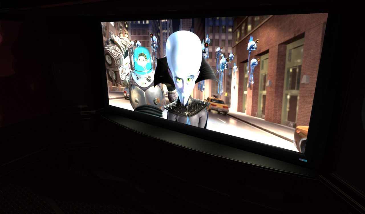

I was working on this while you were typing to demonstrate what it will look like with the lights off and a movie playing.
Thanks Big.
If I had an extra 2' of space in the room and the subs didn't need to sit in front of the screen, I would have designed a completely different look for the screen wall. The black velvet will solve the the reflection issues near the screen. But the front wood steps will still produce some. A bit of balance between look and function.
