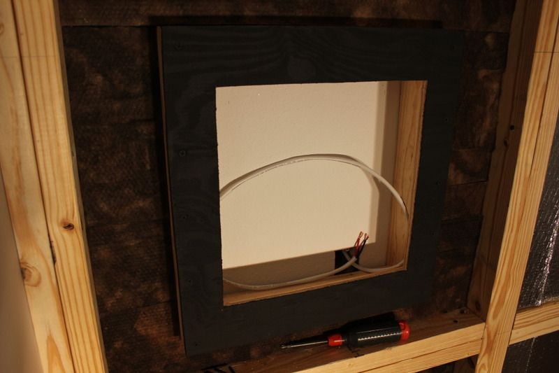

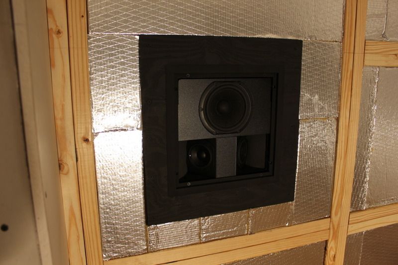

My front wall has 2" of acoustic treatments on it and the back wall has 4", so I built small boxes to bring my in-wall speakers flush with or slightly proud of the acoustic treatments (sort of turning them into on-wall speakers).
Box to house rear surrounds (Triad Bronze in-wall)
Similar box to house front LCRs (Atlantic Technology 727 in-walls)
Also used the same box to hold the side surrounds inside each column

spaceman...very interesting how you did all that. Most cool. I could POSSIBLY do something similar; only problem is, those speakers may be too wide for my columns (and the columns are already "framed" and drywalled around.) Hard to tell; I may be able to accomodate the size of the L and R, not sure, but using that same speaker as a center channel speaker, not sure...I don't think I could fit it...
I'll have to check some measurements of those "surrounds" or "frames" and see what I'm looking at...hopefully I can find that at the website.
