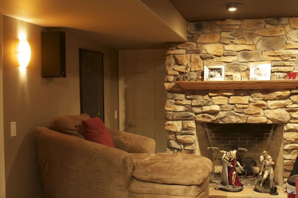

Ran into a few installation questions on the room within a room. First how do you end the drywall. If the wall is mounted 1 inch away from the foundation how do I make a corner and attach the drywall on the corner? I am thinking I just butt the drywall against it and seal it with caulk? I also have an issue with the ceiling around the fireplace. Right now the rock was installed after the drywall was put in originally and finishes up against it. If I am to add rails and clips to the ceiling and use dd with gg I will add at least an inch further down. On top of that I am thinking of adding a fauk ceiling with a star field to it bringing it down possibly another 1-1.5". Since the rock on the fireplace is so jagged it would make it a very and I mean very time consuming method to try to cut the drywall to its shape. Has anyone ever trimmed their stone fireplace? Or is there a better method to resolve this?
I also am getting a quote from Fosi. We'll see what their star ceiling pricing is.
Here is a pic of the fireplace

Nice fireplace.
The drywall comes together in the corners where there is standard corner framing for nailers. Butt the board tight everywhere, then seal.

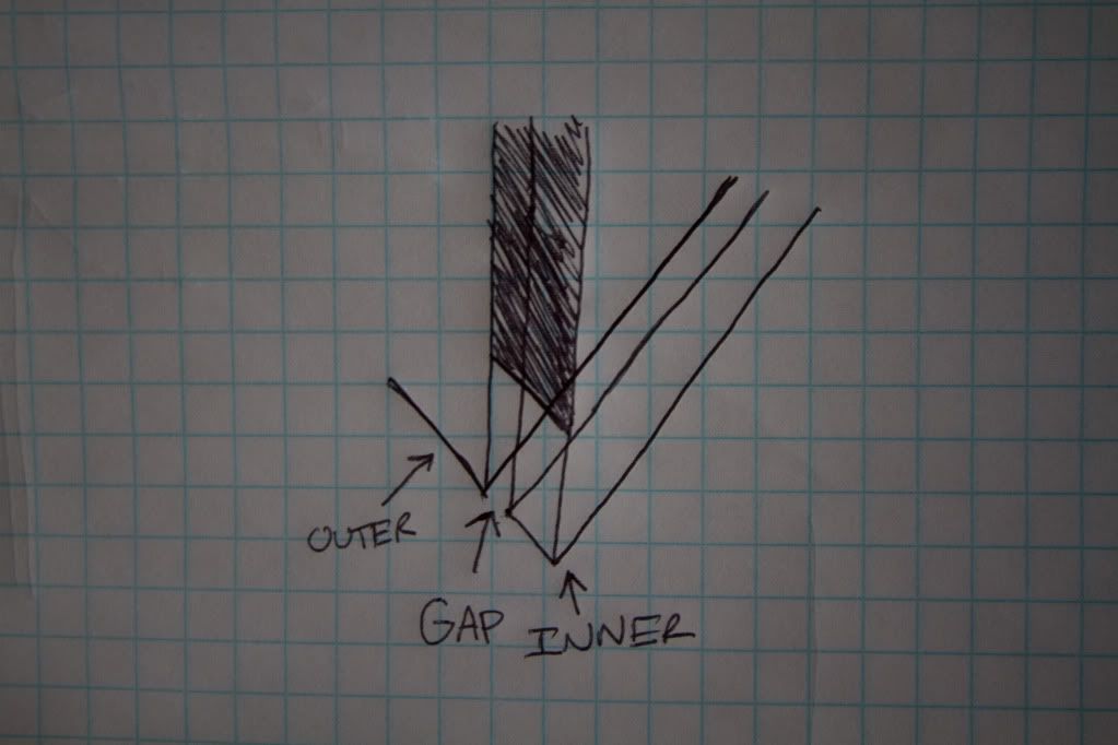

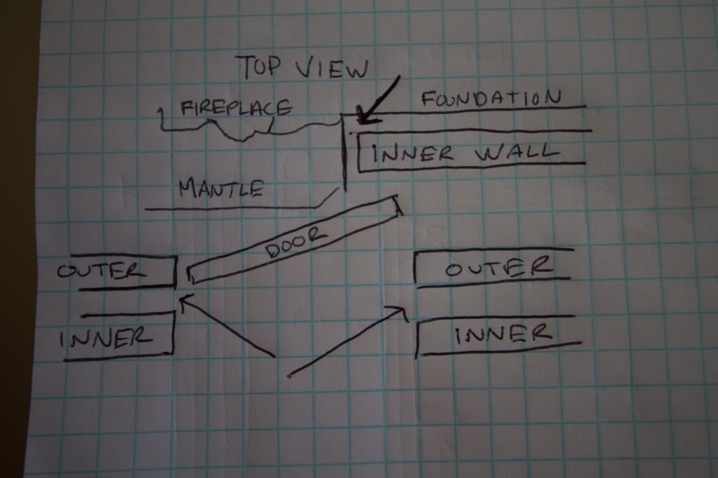

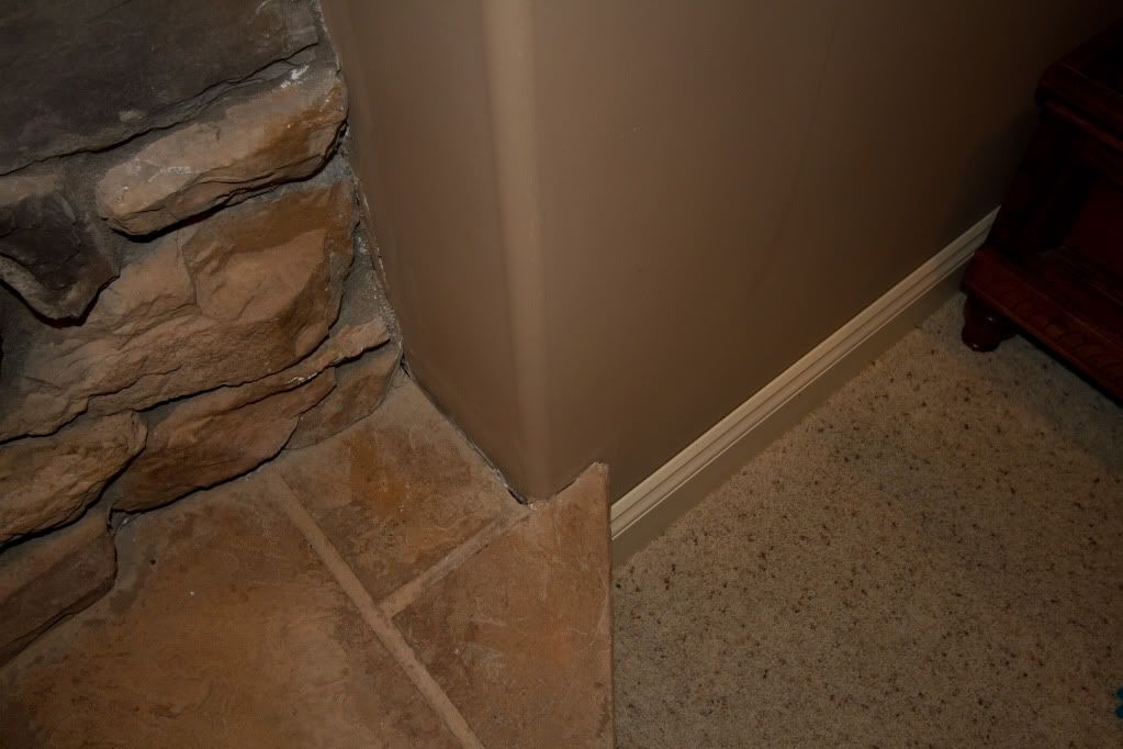

This time I am including pictures of the area of concern. To me it would be very similar to what someone would need to do for a door opening. At some point you have to attach the inner wall to the exterior wall in order to get in and out. I included a diagram to a similar situation to a door opening below. the one of my fireplace. The fireplace is actually further in than the wall itself so once I build an interior wall it will have the gap between the interior and exterior wall. I hope this makes more sense. If not think about just the door situation and I can adapt from there.

That gap in between doors is simply filled with a bead of sealant and covered with a piece of wood trim. You can attach the trim piece on one side of the gap only. That's about as decoupled as is practical

OK. I'll rip a board down to 3/4" to fill the 1" gap and fill the rest with caulk. Then lay the drywall over that and caulk the edges of that.
Any advice for cutting the fireplace rocks near the ceiling to accomidate the height difference?

QUOTE: "Any advice for cutting the fireplace rocks near the ceiling to accomidate the height difference?"
Man... That's going to be interesting... I'd imagine you'll be rough cutting the drywall and then using sealant.

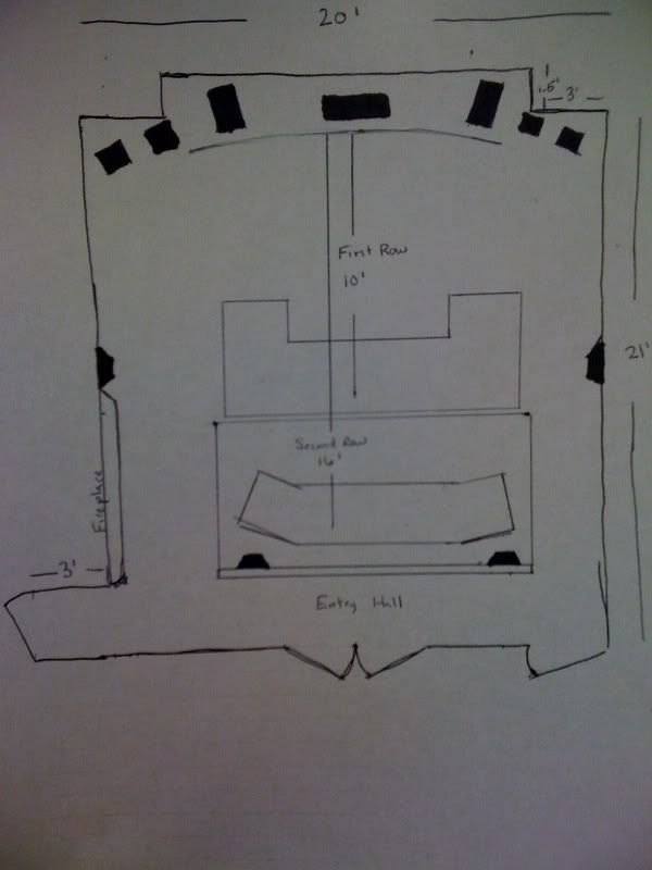

No it is not. Here is a sketch up I did for my room. It is pretty rough as I dont know what program or how to use an actual computer program for this. I am a bit worried that the room is almost a square and dont know how to correct this. Advice from my plan from anyone would be greatly appreciated. I believe that my front row is alot closer than people normally would sit especially to a 12' screen but I dont mind it and actually have preffered to sit that close. It is 2x the screen height and that may be normal Im not sure.

I've been trying to think of a way to narrow down the room for acoustics reason but am having trouble finding the room calculator that I had before to determine what is best and also what is best for this room. Essentially it is 22.5x20.
Help would be much appreciated. Is there anything else I should consider before complete teardown of the walls and ceiling.

I wouldn't sacifice room so that you have a better "ratio". It's fine as it is.
