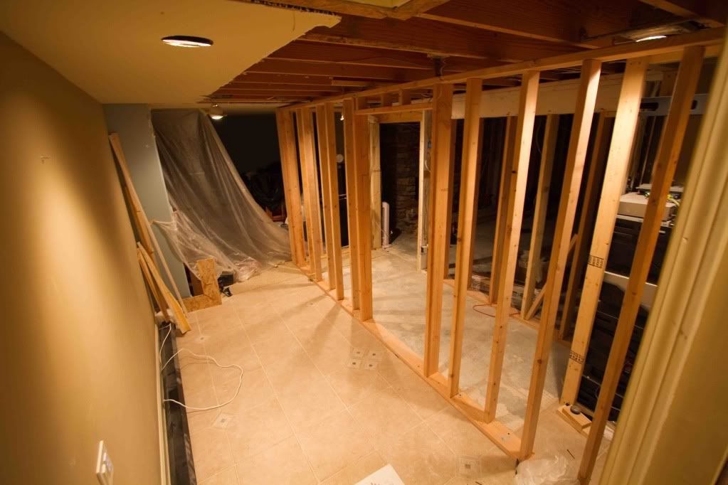

post #200 of 840 Old 01-26-2010, 05:45 PM - Thread Starter
adammb's Avatar
Location: NE Indiana
Posts: 1,264
Quoted: 21 Post(s)

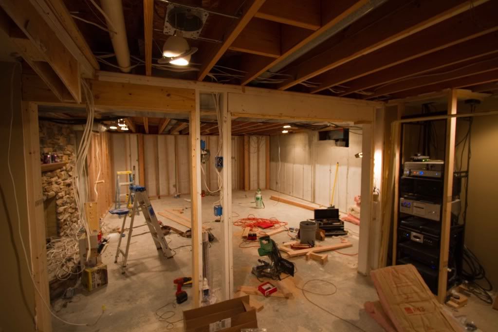

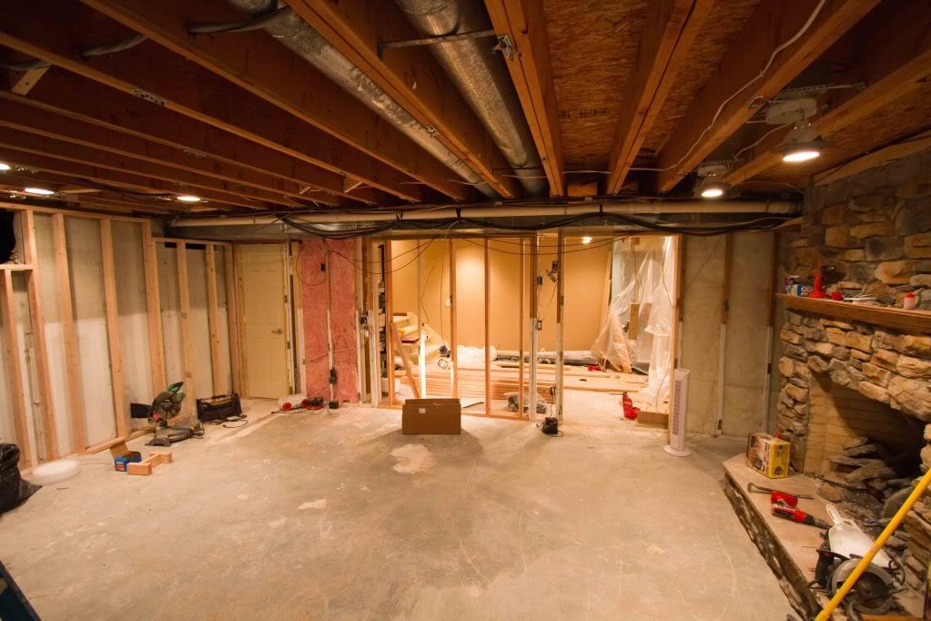

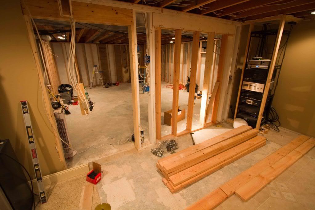

Picture update
You can see the new opening from the hallway to the theater and the framed walls. Should be finished framing by tomorrow. I finally found the hat channel to mount in the whisperclips.
Can anyone give me some advice on the rack exhaust and the hush box exhaust. I am having trouble deciding which way to go

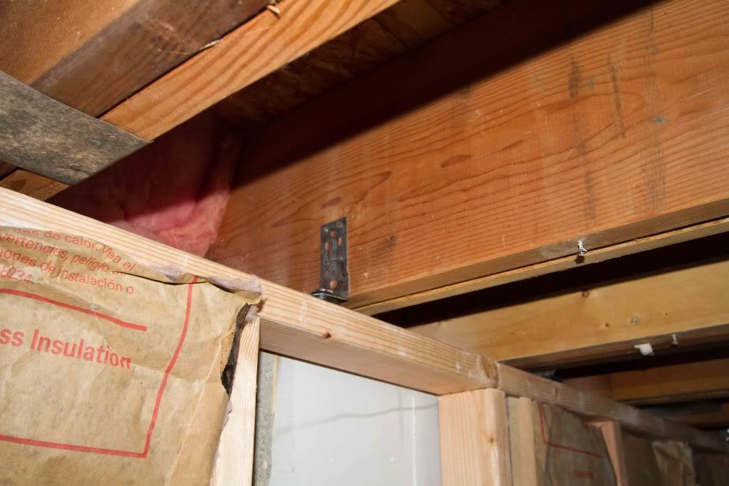

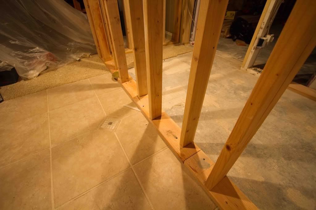

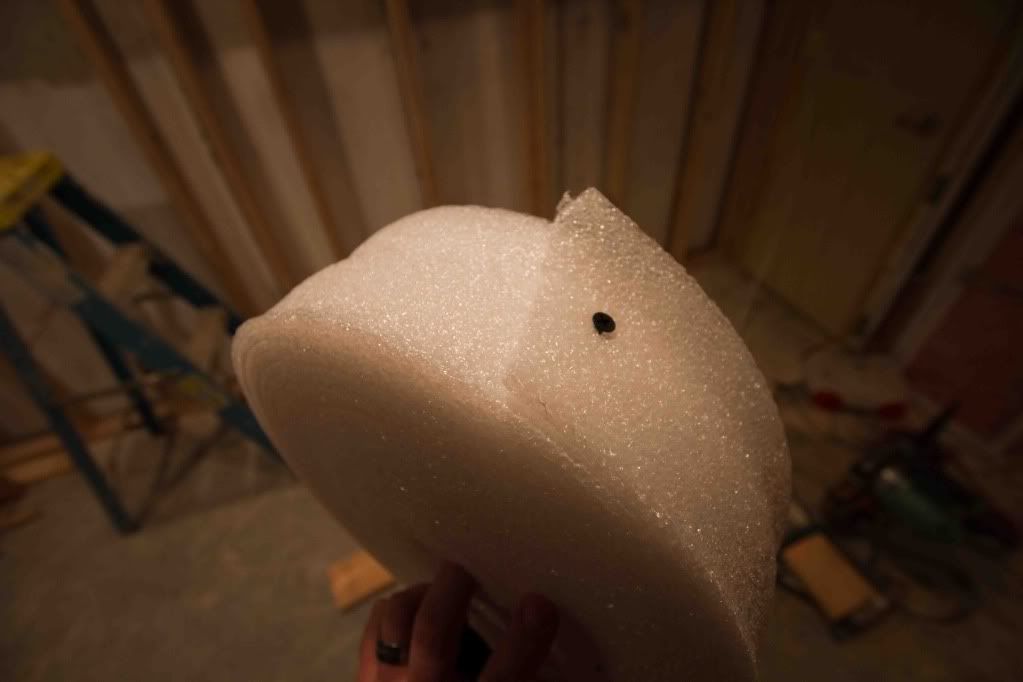

More picture updates
Here is the same view with a few more walls put up.
Here are the walls held up with the DC-04 clips. I can already notice a huge difference between transfer to the upstairs.
Here is an inside view going into the hallway yet to be framed.
Last pic. Here we had to take out the top row of rocks to simplify mounting the drywall to the wall and getting a good seal. Once the drywall is done and the soffit done I will figure out how to make this look pretty.
I found a great product to use as a pillar and it is local. I am also going to use it as a soffit trim that I think will look awesome. I'll post some pics when I get it moving but basically I am going to cut down a sonotube.
I am trying to figure out how to seal all of the needed holes through the drywall. Most likely I am going to build somewhat of a dead box at each puncture and hope that does the job. If anyone can chime in on how they ran their conduit and what they found that worked and didnt as far as product and routing tips.

O, I am back to work. The one that pays for all this stuff. And while I'm at it I have to get some stuff ordered so its here in time and we arent at a stand still.
Walls are finally all framed up and the electrical demo from the old items is in process along with some electrical issues we've had with the rest of the house.
Along with the drywall came the hat channel so as soon as the HVAC ducts are done tomorrow we can start throwing up some drywall as long as the electrician gets done what he is supposed to and that should be no issue.
Adam

Alot of the stuff done today is hard to take pics of so here is the stuff you can see. The framing is done so now I can get my carpet installer out to measure for carpet and order it.
For this outside wall I did a stagger stud assembly because it is new I don't have to use clips and rails on it. On top of it being a stagger studded frame I also am using DC04 clips to keep it from rattling upstairs. Seeing this makes me feel so much closer to being done. I may get some drywall up this weekend if I can get all the electrical roughed in.
Last for you here is the foam I am using under all of my walls as a vibration reducer along as a sealer to the floor. It is pretty common at any major hardware store but alot of people skip over something like this. It is very cheap and almost no effort to add it.
