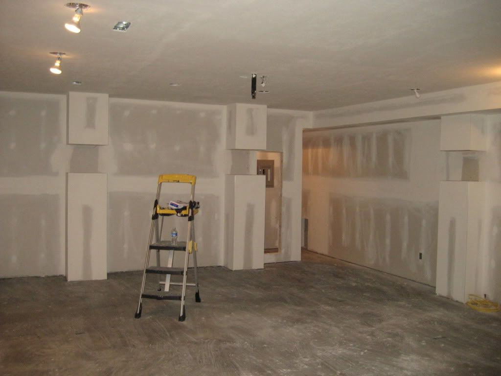

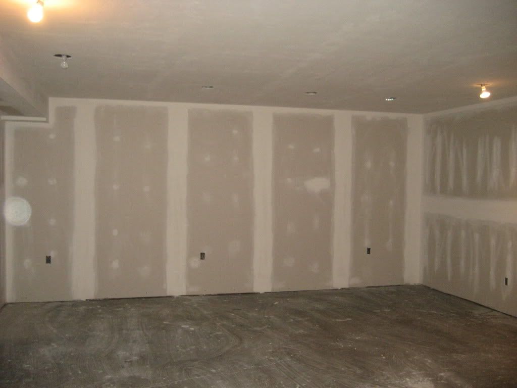

Sorry to those who have been following this my build thread....... Progress has been slow but hopefully a fire has been lit under the rear of my drywall guy. He assured me he will have it mudded, taped, and finished by the end of the month. We will hopefully have things completed by early September (I hope).
The drywall is hung both inside and outside of the room......
The speaker boxes have come together. Just a little more corner bead to get hung up.
A shot of the back of the room, where the equipment rack will be placed.

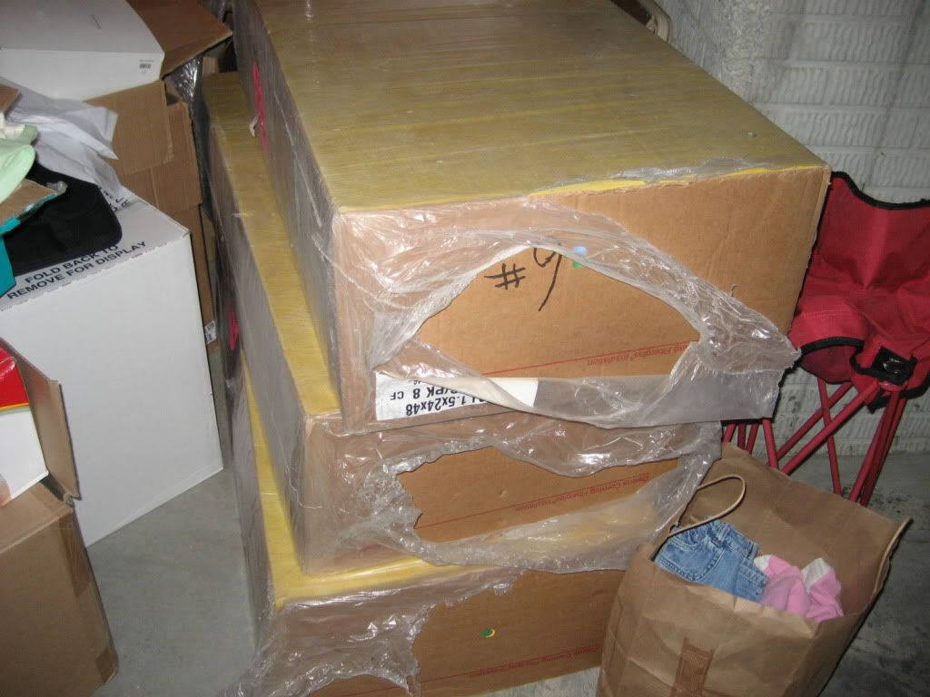

Here is a pic of eight Berkline boxes...... The wife helped me haul them down to the basement. What a trooper.
I ordered a total of eight seats (Berkline 12000) from Roman (two rows of four) a couple of months ago. He did not have them in stock and I had to pay half down as a deposit to hold them. Paid the other half about two months later when they arrived. All I have to say is Roman is the real deal. He answered all of my questions and was very patient and knowledgeable.
I am a very skeptical person so it is kind of crazy when you think about it. I sent two personal checks to man I had never met who cashed the checks before sending me chairs that I had never seen in person let alone sat it. In the end, the whole process was flawless. If you need chairs, don't hesitate to contact Roman.
All of the chairs out of the box before they were covered over........
Hopefully the progress continues. I will post pics as it happens.

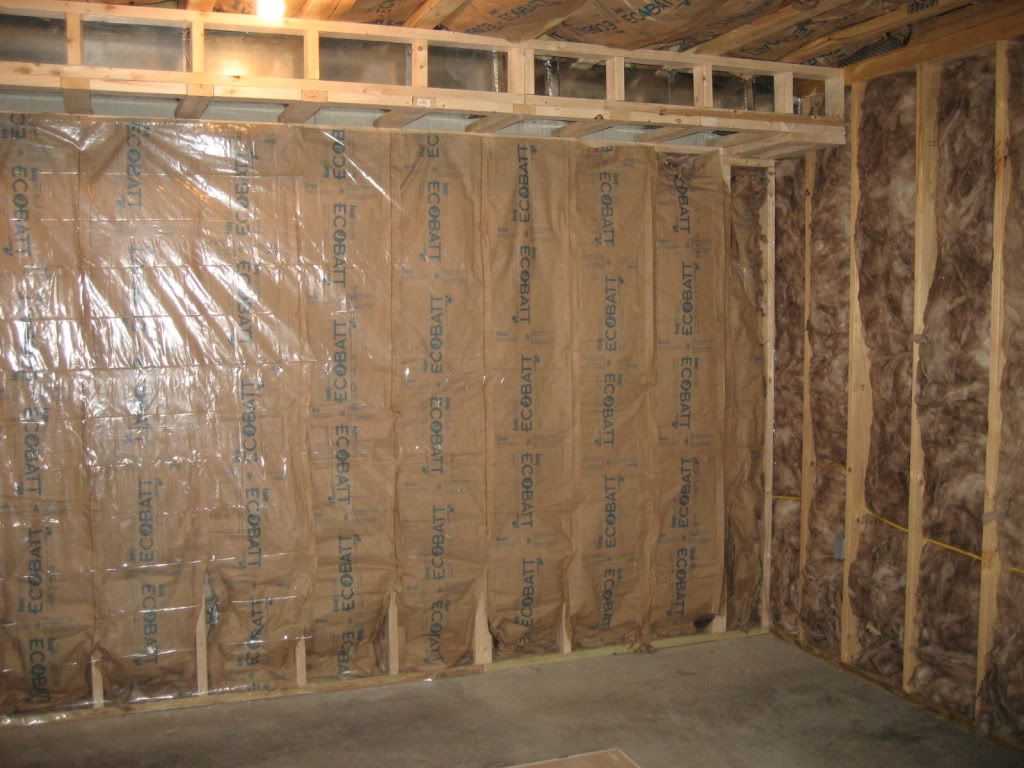

With the paper-faced insulation do you still have to do the moisture barrier? I need to do some reading on insulation, I see you have the un-faced and the faced, how did you know when to use each kind?

nebrunner- I used a vapor barrier only on the studded wall that was next to my poured basement wall. I used faced insulation on all three walls and the ceiling. It was much easier to install, IMO. I just chose to put the "paper side" on the outside of the room of the other walls. I could see where that would look confusing. I didn't need to use a vapor barrier on the other walls because on the other side of them is the rest of the basement.

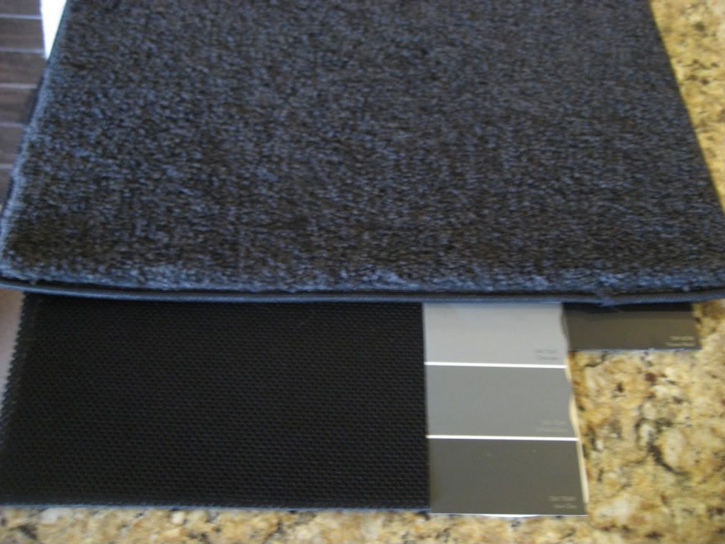

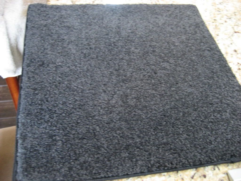

Well here are some updated photos as promised..........
Here is a shot of the front wall. I will order the ductliner on Tuesday to cover the front wall. I already have some OC 703 that I am going to cut to make the corner bass traps.
Here is a shot of the back of the room.

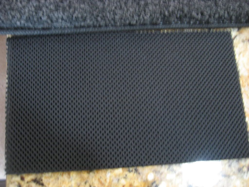

Here is a sample of the carpet that we picked out.
This is the material we are going to use to cover the AT Screenwall. It is Audiomesh Panel Fabric from Fabricmate. I like the looks of it much better than the GOM FR701. I am most likely going to use the GOM Anchorage for the acoustical panels when we get to that point down the road.
We are still up in the air about what color the walls will be painted. I are leaning toward the dark gray color at the bottom of the color sample. I am still up for suggestions. I think these colors go well together nicely and should keep things nice and dark.

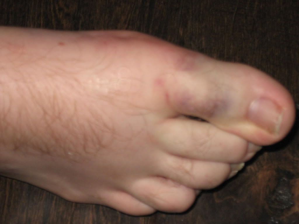

Lastly, here is a shot of the infamous toe after my fall down the stairs. Please forgive the ugly man foot. It has started to bruise all the way down the side and underneath my foot. It is either broken or jammed real bad. Hurts like hell. Oh well, thankfully it is only a toe and it will heal. Not sure if I want to try to put on a hockey skate and try to play hockey on Tuesday night.
