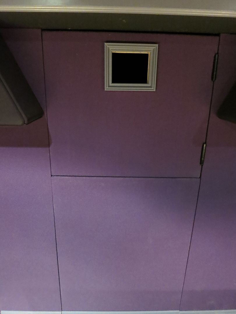

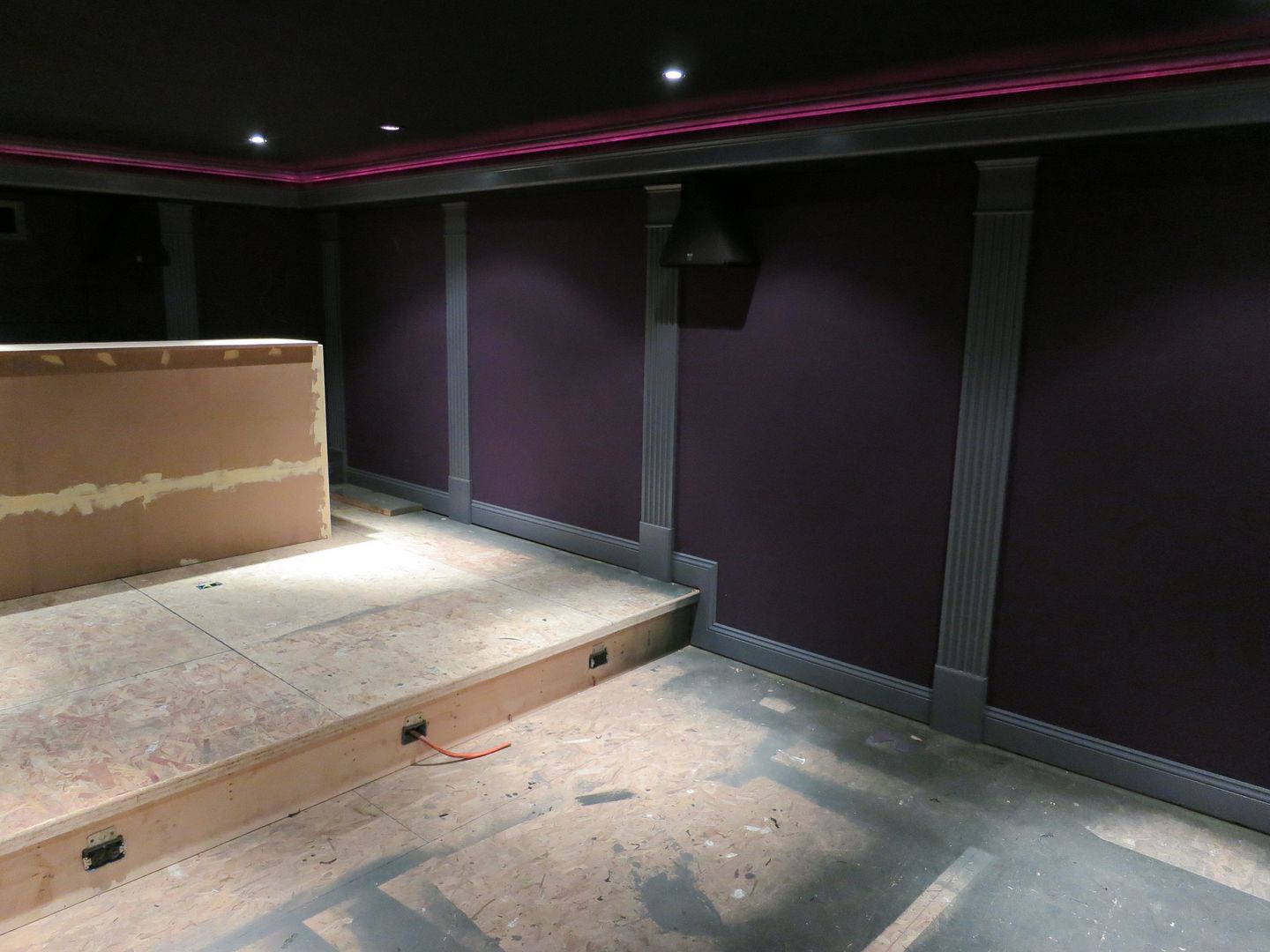

just completed an "Old School" fabric job, fabric stapled to wood furring all staples hidden.

just completed an "Old School" fabric job, fabric stapled to wood furring all staples hidden.<br><br><img alt="" src="http://i23.photobucket.com/albums/b393/bigmouthindc/Ohio%202011/IMG_7606.jpg" style="border:0px solid;"><br><br><br><img alt="" src="http://i23.photobucket.com/albums/b393/bigmouthindc/Ohio%202011/IMG_7582.jpg" style="border:0px solid;"><br><br>
Projection booth<br><br><img alt="" src="http://i23.photobucket.com/albums/b393/bigmouthindc/Ohio%202011/IMG_7599.jpg" style="border:0px solid;">
Hate to bring this up from the past ... but I have been researching on how to retrofit my current painted drywall walls with some sort of fabric solution. The track systems look interesting, but I'm also fine with exploring fabric stapled to strips ... my question is, how do I hide the staples if I decide to go the DIY route? The design would be basically base board to ceiling and wall to wall, with cutouts for elec outlets and light switches.
I would have some exposed edges due to columns or other areas I don't (or can't) cover with fabric.

Just fabric? Or acoustic treatment and fabric?
You do need a strategy for hiding staples if you go old school. There are a lot of tricks but I would need to see your room (pictures) to offer suggestions. Don't worry about the heat, unless you have really hot lights, in any case swap the bulbs for LED versions.
Jeff, thanks for getting back to me. After doing some research, I found the electrical box extenders which would raise the outlets and lights to the proper position above the new fabric covering. So I think I am good there.
I would be using fabric and acoustical material (1/2 to 1"), the room itself was pretty well treated when it was originally built so I am happy with the level of external noise bleed.
Thinking about the panel construction, I've review a couple of your past builds and feel good about pre-building the frames, and then stretching the fabric over the frames, but where I get stuck, is how do I secure the frames to the walls without the fasteners being obvious?

there are a host of ways of attaching panels to walls, Finish nails shot through the fabric, Magnets, Glue, Velcro, Ball and socket speaker grill posts, Friction fit, Zclips, Impaling clips. I've probably used Friction and Velcro most often, followed by nails and glue. Magnets and ball and socket is just too much work for me.

Nyal did a redesign for Atmos and JBL speakers. We kept the perimeter soffit, but I asked him to drop the columns, wainscoting, and coffered ceiling to reduce construction costs.
Maybe I can do micro-columns and come down from the surface mounted junction boxes in the soffit, like you said. Something like two 2 x 6 on edge with a couple inches of space between them. Just enough to use as a wiring chase. Then cover with a piece of wood. So like a 4" wide column
Is fabric on the ceiling an impractical?
This quarter's Fine Home Building magazine has an article on light weight polystyrene coffered ceilings. They say you basically glue it up there with a few nails to hold it while the glue dries. Then pull the nails, fill the holes, and paint. I'm wondering if I could carve out a small channel to run speaker wire.
Thanks for the tip on code.
