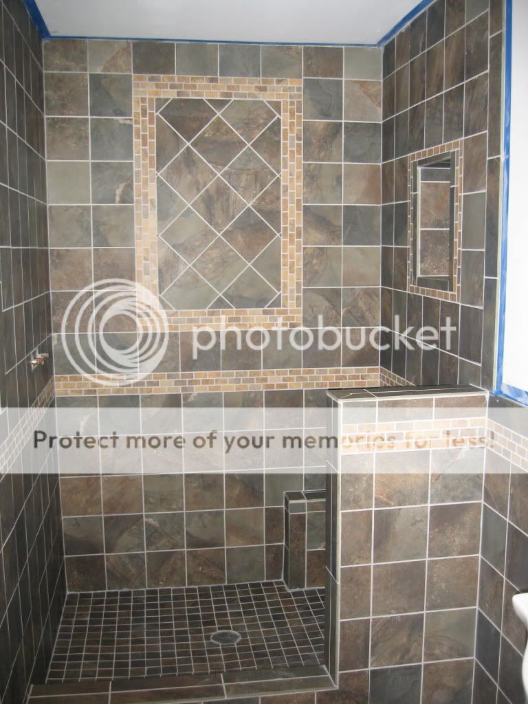

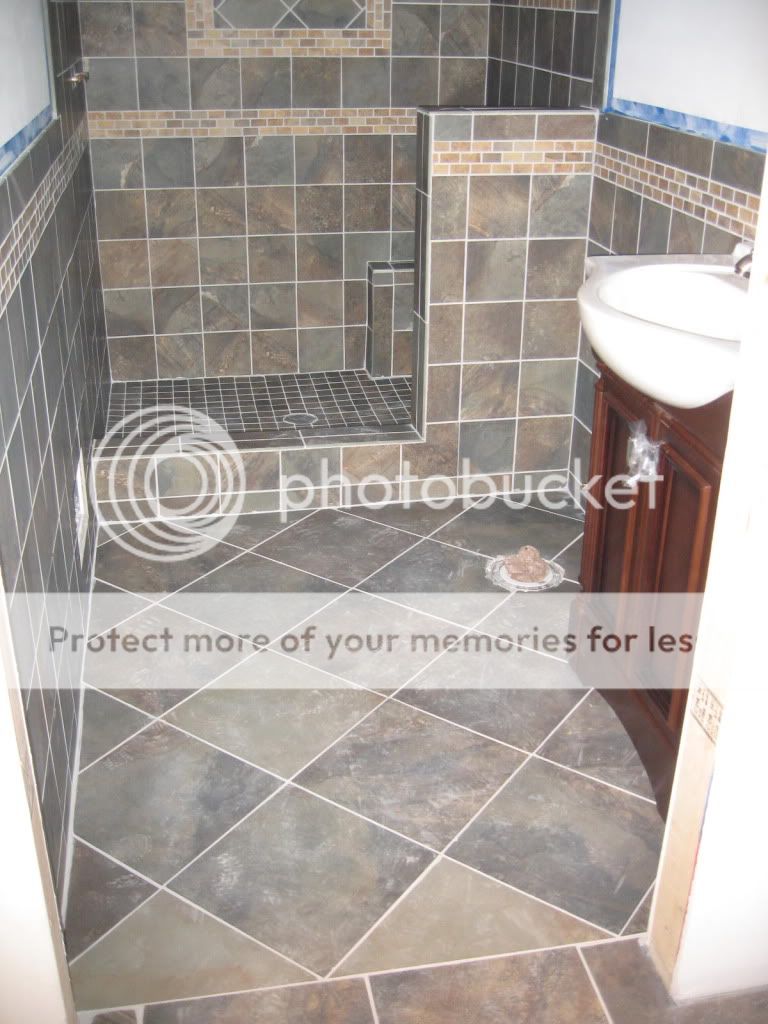

Shower grouted and sealed:

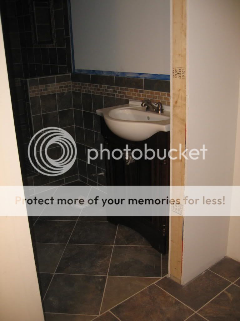

Bathroom floor done, 45º diagonal layout:
Looking into bathroom, you can see the vanity I just bought, have not installed yet:

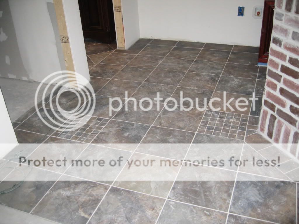

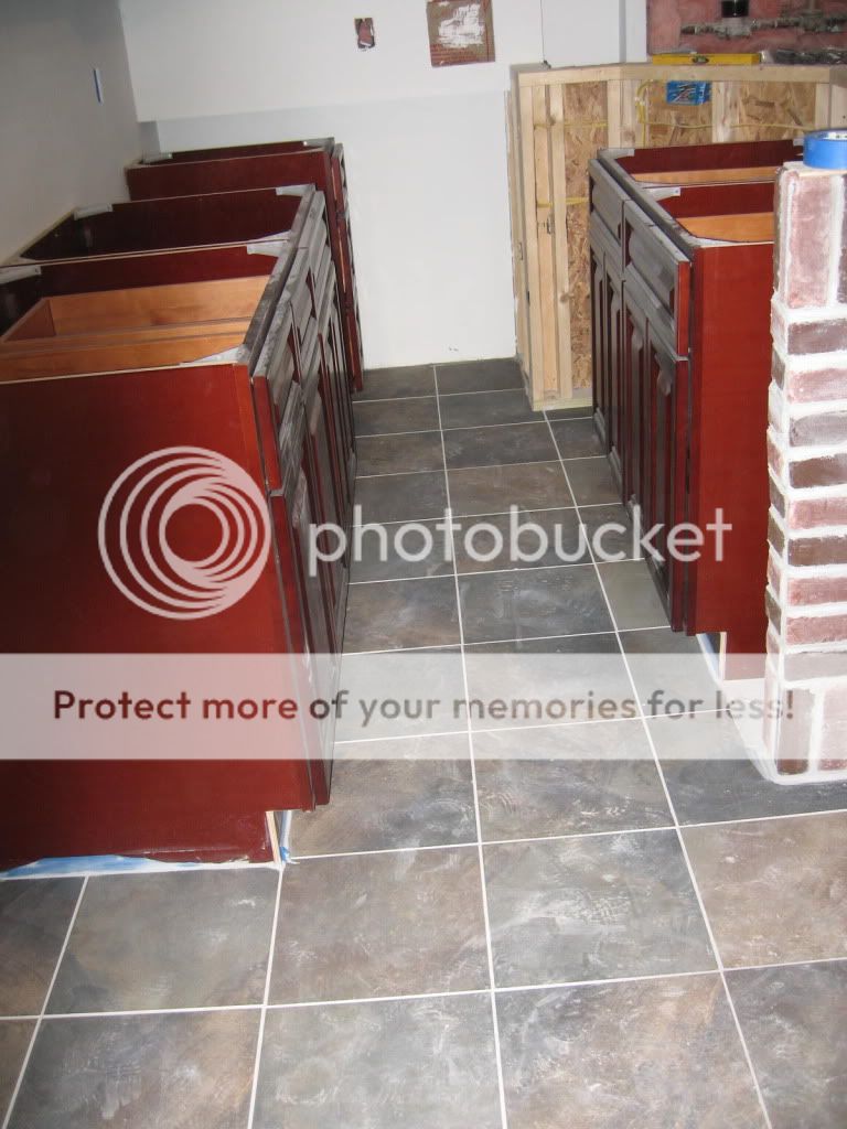

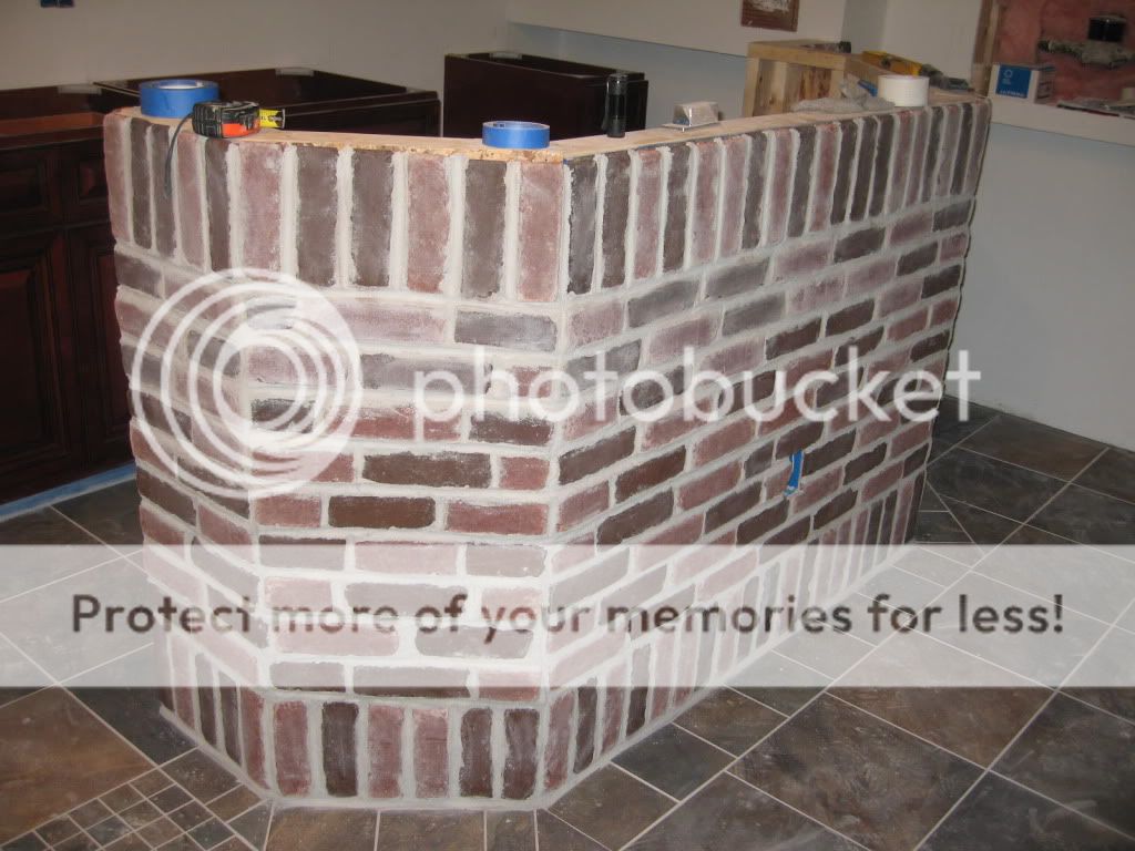

Bar area floor, tiled straight, I decided against 45º diagonal pattern, too much cuts and I have to make my own 45º bracket to cut large 13" tile diagonally, very difficult on a small wet tile saw, but it still looks pretty good, little dusty because I was walking on the finished tile floor with dirty shoes.
Also, you can see two pieces mosaic sheets one by mechanical room door and another is by the bar, they are left over from shower floor, the one next to the bar was because the concrete slab under it was not leveled, so no matter what I tried, the 13" tile won't set correctly, one corner down and another corner up, so I used this mosaic sheet there, it is perfect, not only it solved uneven floor problem, but gives some interesting look as well:
This is tiled floor between bar cabinets:

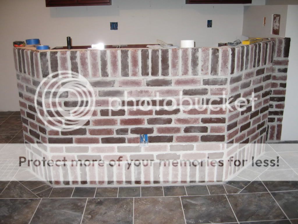

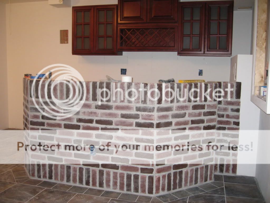

Now brick veneers on bar:
I used two colors random pattern, installed with liquid nail glue over OSB, I cut many 3/4" spacer strips for use in between two rows, let them set over night, then use mortar to grout the tuck joints, very messy job, dropped a lot mortar on floor, of course, I used dropping cloth to cover the tiled floor. The effect of two colored brick veneers look pretty good, the veneers are rustic style so the beauty is the imperfection:
Since the bend there is 135º, I can't use corner veneer, so I just make the tuck joints at the bend line. The veneers at top and bottom rows were installed vertically, and I think this pattern looks better than everything installed horizontally:
