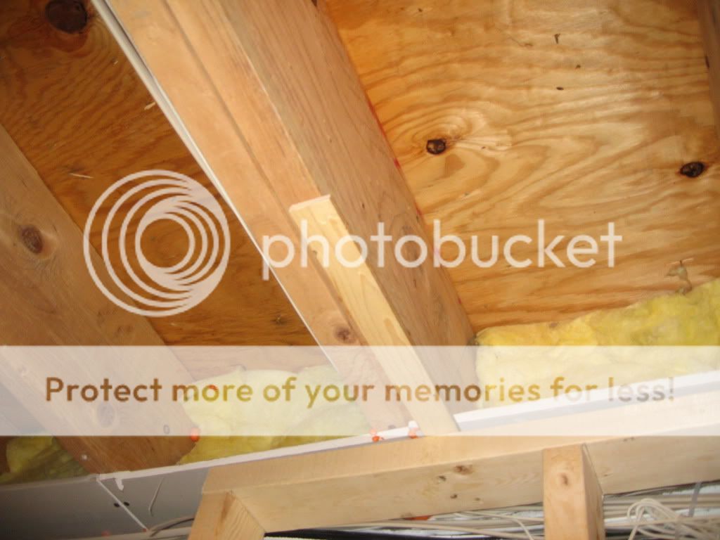

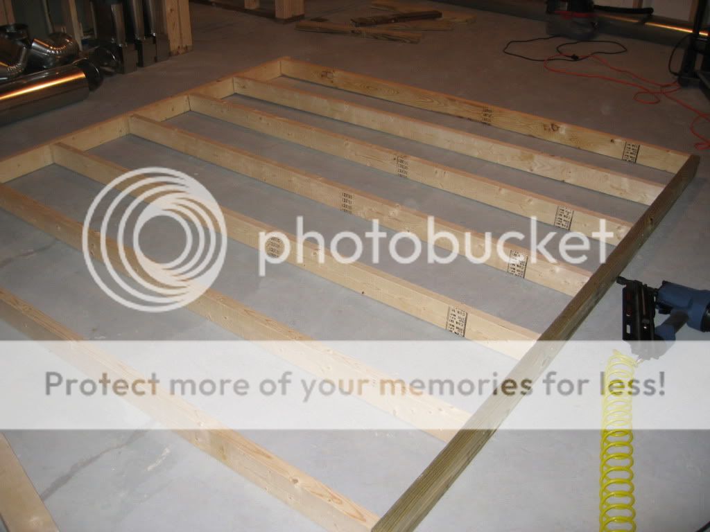

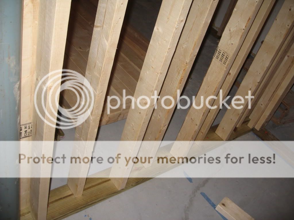

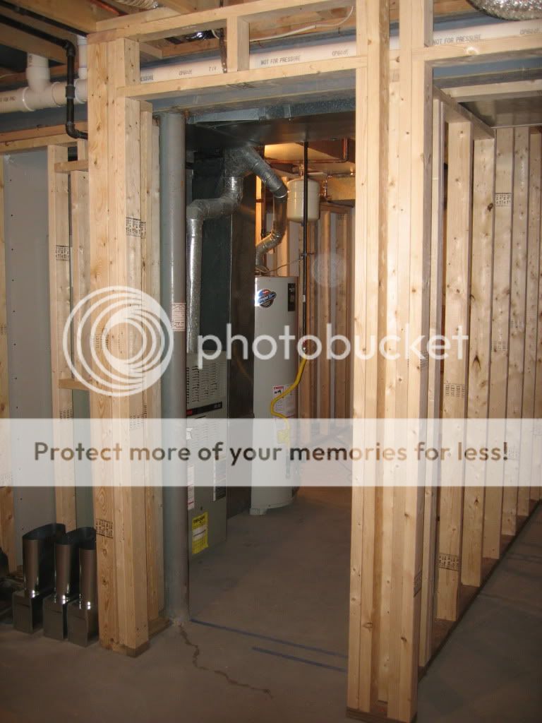

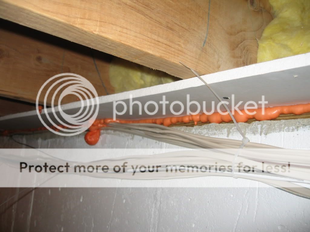

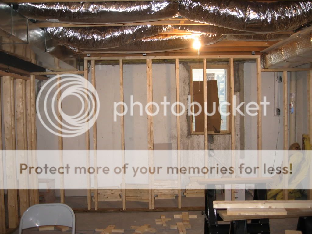

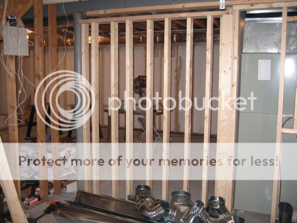

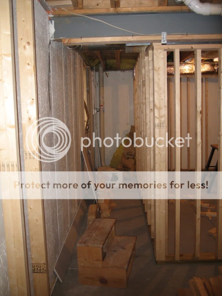

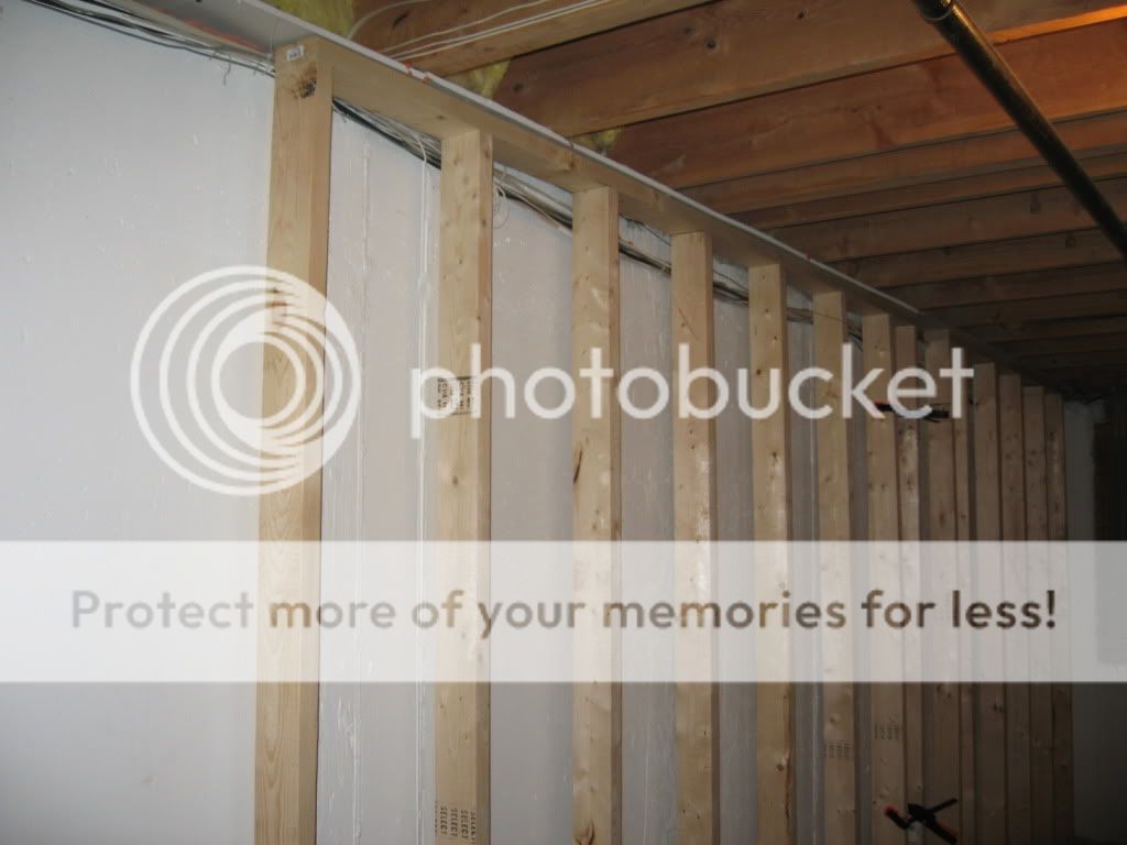

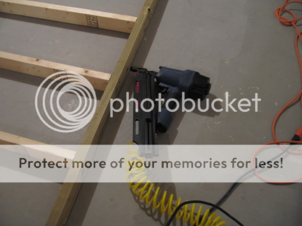

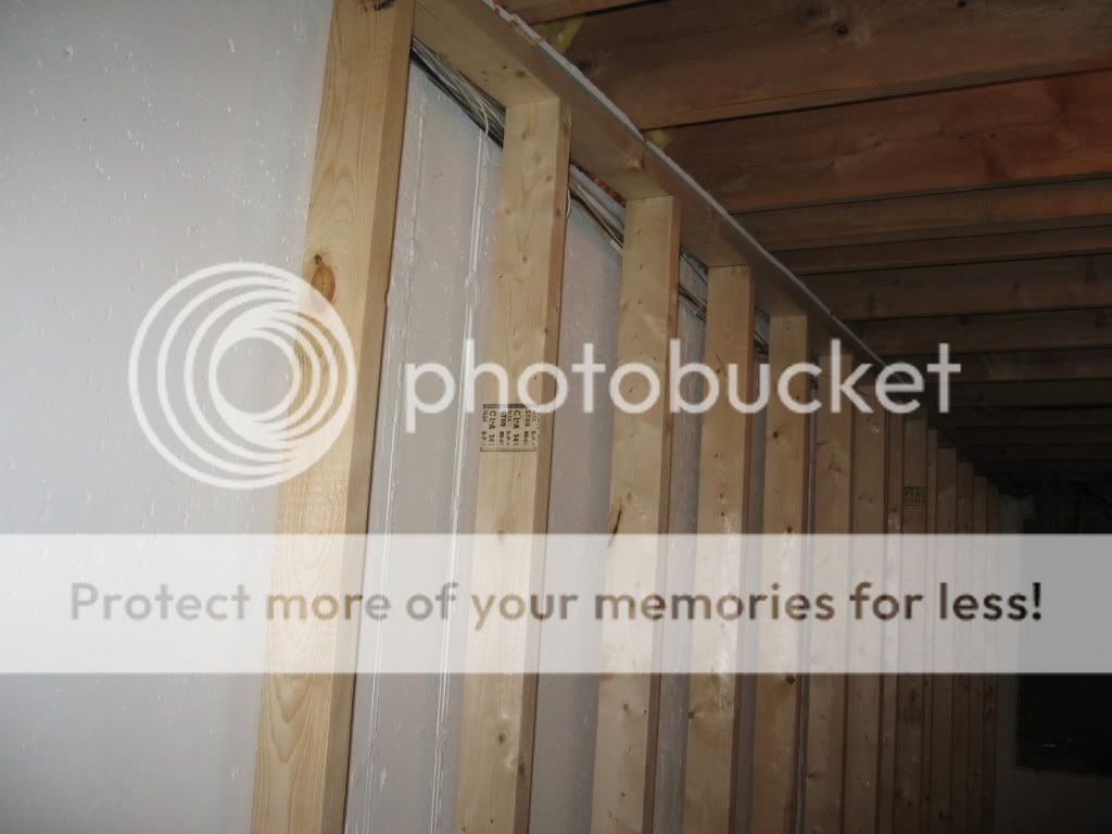

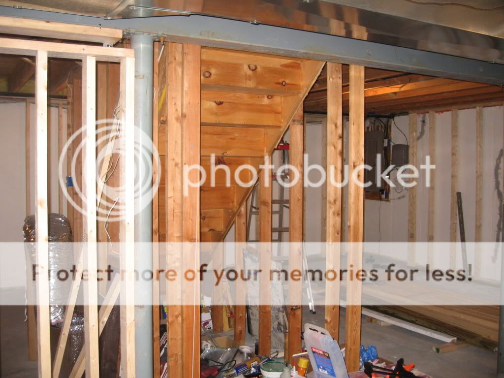

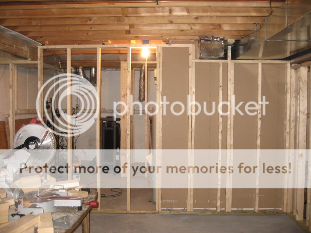

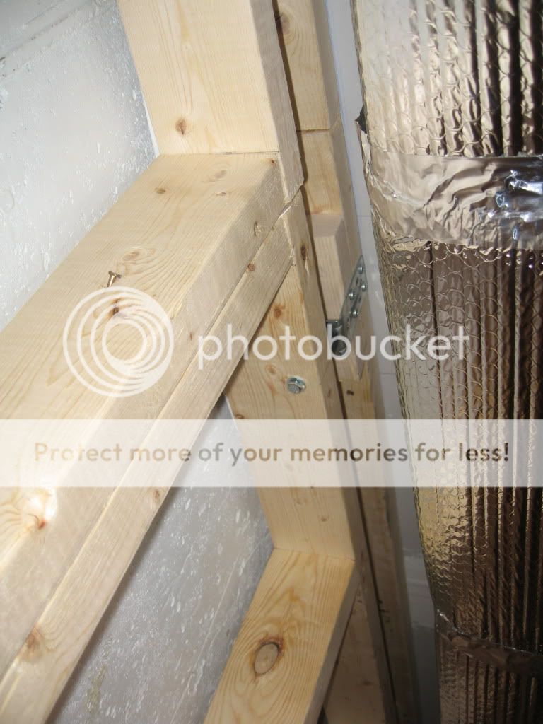

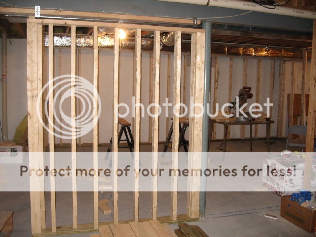

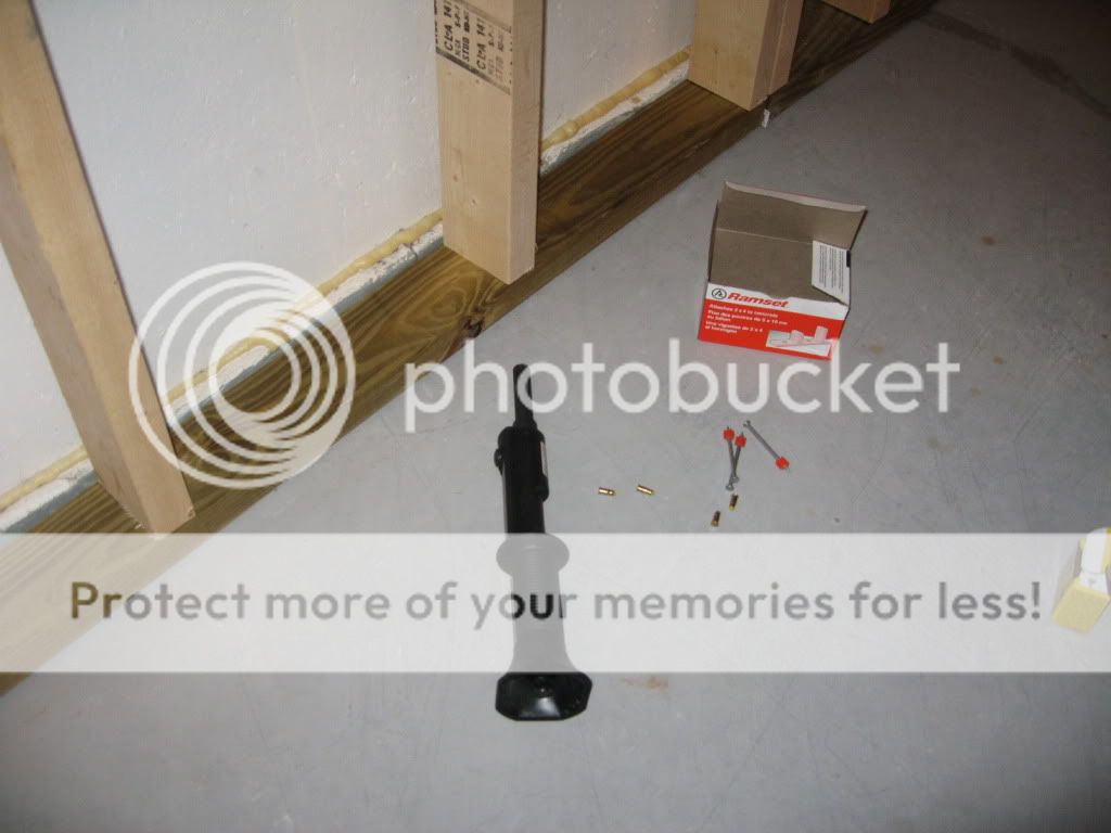

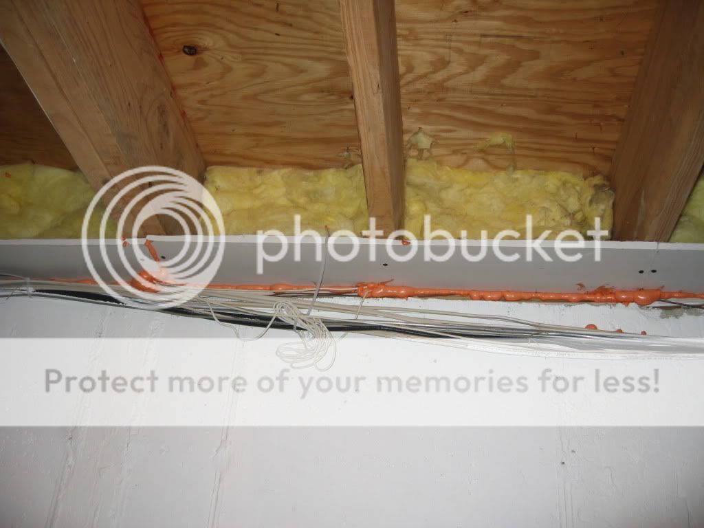

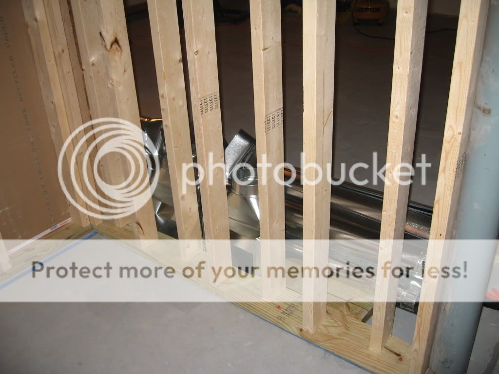

Framing is in progress, I would say 80% done, just few areas left, here are some pictures:

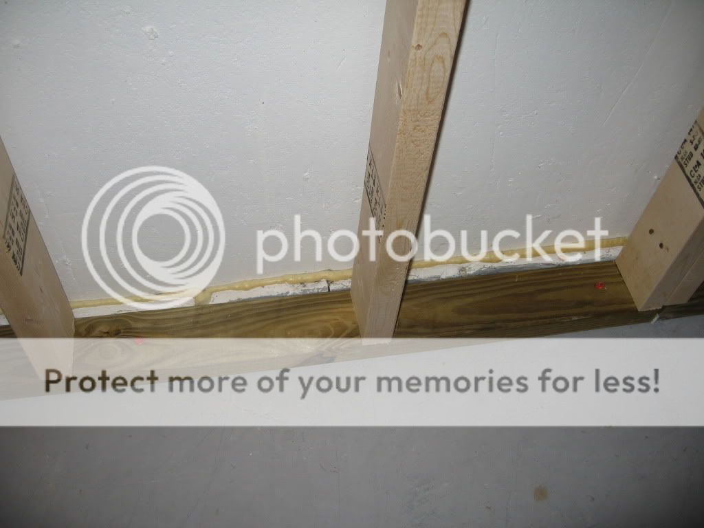

Fireblocking, I use 1/2" drywall, the orange seal is Great Stuff fireblocking expansive foam seal, I cut 6" drywall strips and attached to the joist along the sill plates, the top plate of 2x4 stud wall will be under the drywall:
Another one:

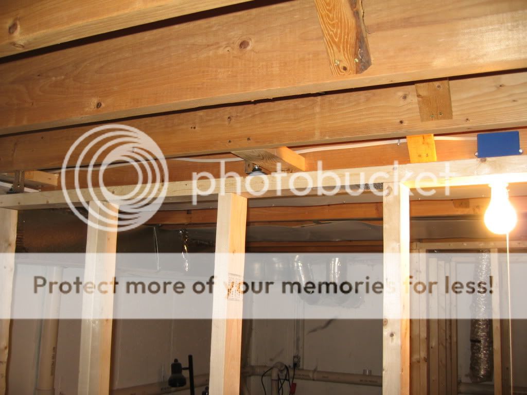

Framed wall on the floor, I framed wall about 1/4" shorter than the height from the floor to fireblocking drywall strip so I can move the wall in easily:
Best $80 ever spend, never miss a fire:
Wall is up, you can see the top plate goes under the drywall strip with some gap:
Shim the top plate to get wall leveled and straight:
Read to fasten the bottom plate with Remset hammered gun:
Bottom plate fastened:

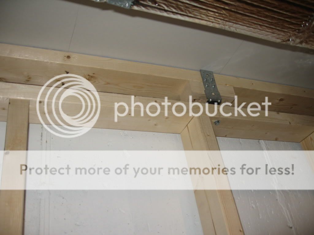

Top plate fastened to the joist through the fireblocking drywall strip:
This is the theater room back side staggered wall:
Theater room front side staggered wall:

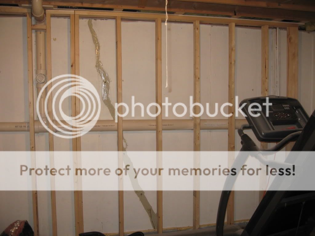

This is the theater back wall:
Finally, the screen wall, you see, I have not mocked the screen with the blue tape yet:
Space under stair and entrance opening, not framed yet, haven't decide what to do with it yet, could be equipment closet, but that is too small for the server rack I got from craigslist:
RSIC DC04 clips along the return trunk:
Another view:

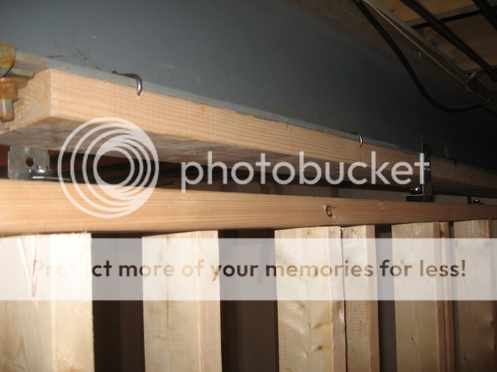

DC04 under steel IBeam, I attached a piece of 2x6x8, with liquid nail and 16D nails bended over to clip on the IBeam:

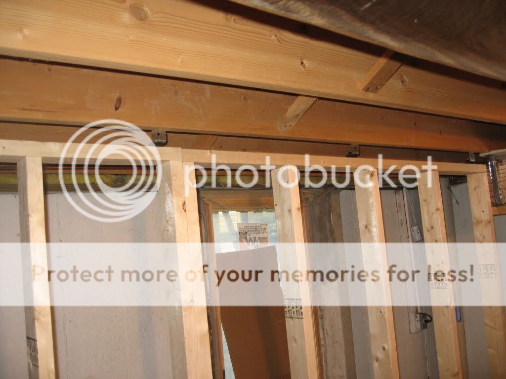

Decoupled screen wall with DC04 clips, I was able to attach DC04 clips directly to the joist for this wall:
Decoupled back wall, I have to attach DC04 clips to pre-installed blocking:
Framed bathroom and door rough opening:
Mechanical room door rough opening:
Looking into theater room from back side:
Looking into theater room from entrance, I haven't frame the door yet, I may frame the equipment closet outside the staggered side wall, undecided yet:
Future bar area, wife is against the bar, it would take up a good chunk of space:
Egress and sump pit access path, will not be finished, behind the screen wall, 3' wide by code:
Still need to frame a door for service panel access:
I am stuck here, can not decide what to do this section, the clearout sticks out 15", the pipe is out about 10", water meter is about 6" out:

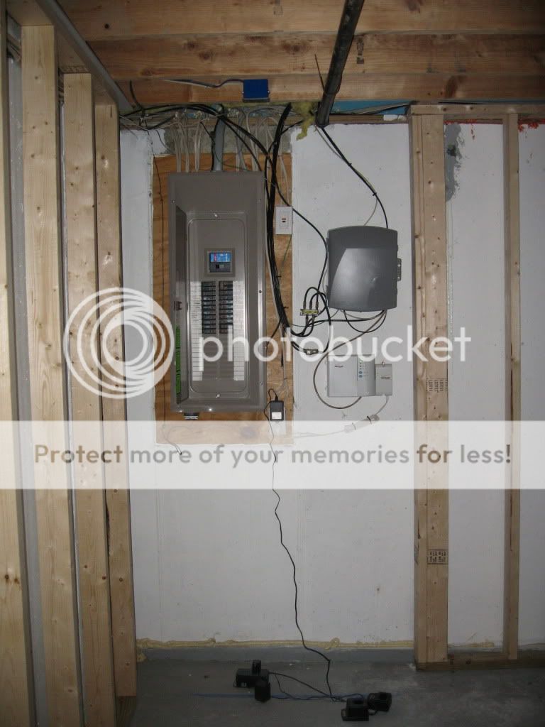

This is my services panel, 200amp, you can see, I have plenty slots left, so I originally thought to install a separate sub-panel, but I may not need to, what do you think?

You're a framing machine there Walkinator...looks great
IMHO, if you have the spaces available in your main panel I don't see any good reason to add a subpanel. As far as I know, the lack of spaces is the main reason to add one, and maybe subpanel location being another, although the cost of the higher amperage cable to connect the two will probably be higher than the individual 12/14ga runs just going to the main load center.
Thanks Fotto. Yeah, I think I don't need subpanel, I originally planed to install a subpanel just for bringing wires to a centralized location in the basement so every circuit comes out from subpanel will be easily to wired.

Originally Posted by theWalkinator View Post
Moggie, the reason is that if I run the flex duct for this one, then I have to replace pretty much every single pipe off the main trunk, I think there are 5 or 6 pipes running off main trunk within the theater room parameter, otherwise, not much added benefit just running one flex duct. But I will make sure that all the duck pipe running across the theater room will be flex duct, hope it won't be too bad.
Actually, it is a good question, has any one replaced all metal pipes with flex duct off main trunk from the theater room?
I had three metal runs going across width of my HT (within joist cavity) that fed bedroom/bath on first floor above. I replaced all three with flex. If I had it to do over again, I would have left them rigid. Ted White said in another post that those would be ok to leave alone if you just stuff insulation around them and are doing clips/DD on your ceiling. The runs for your actual supply(s) and return(s) that feed your HT room are another story though and need dealt with. Those will be direct openings into your room where sound can propagate directly back into your trunk and the rest of the house. I ran only one supply and return into my HT, but wish I had ran two each. I think that the flex definitely cuts into CFM through it due to the ridges of the flex, and I don't think I have optimal airflow due to that, although it may improve a bit once the doors shut and is kind of it's "own zone". Time will tell.
BTW....HVAC work is a real "pain in the trunk" isn't it?

Use short sections of flex connecting the takeoffs to metal duct, if you need the flexibility. Connect the flex to the sheet metal with some zip ties. A couple of sheet metal screws so the zip ties can never slide off. Then silver tape.

You might want to rethink your HVAC termination if you care about sound isolation. Check out what Ted White said in this thread with similar metal ducts.
Good point fotto, I am thinking the same, the rigid metal pipes off the main trunk are feeding upstairs, some to first floor and some to second floor, so I am afraid of cutting air flow by replacing with flex duct. On the other hand, I will definitely use flex duct for the supply and return feeding the theater room and I also have replaced one supply and one return running cross theater room with flex duct. I realize that HVAC could be the weakest link in my situation, so I will try to insulate around the duct takeoff area as well and hope it won't be too bad because I will do DD+GG.
theWalkinator is offline
Yes, Moggie, you make me think again since I will do decoupled wall, staggered wall, DD+GG on wall and on ceiling, so, I don't want to waste money and time doing all that while HVAC duct work ruining the effort. I care more sound out than noise in because of wife and kid.
Tedd, I like your idea, I think this is probably a compromise between sound isolation and maximize the airflow and I may do that after mechanical inspection.
