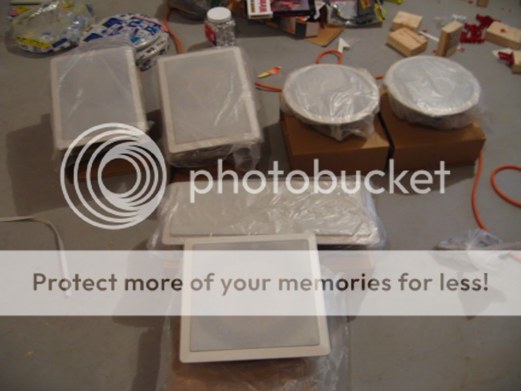

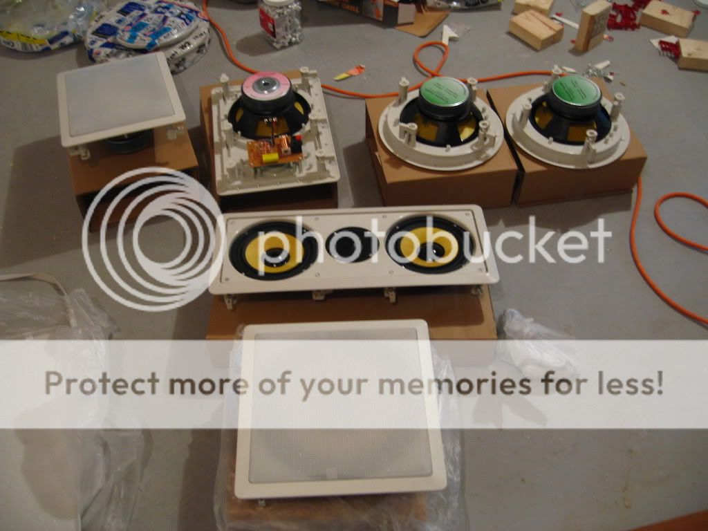

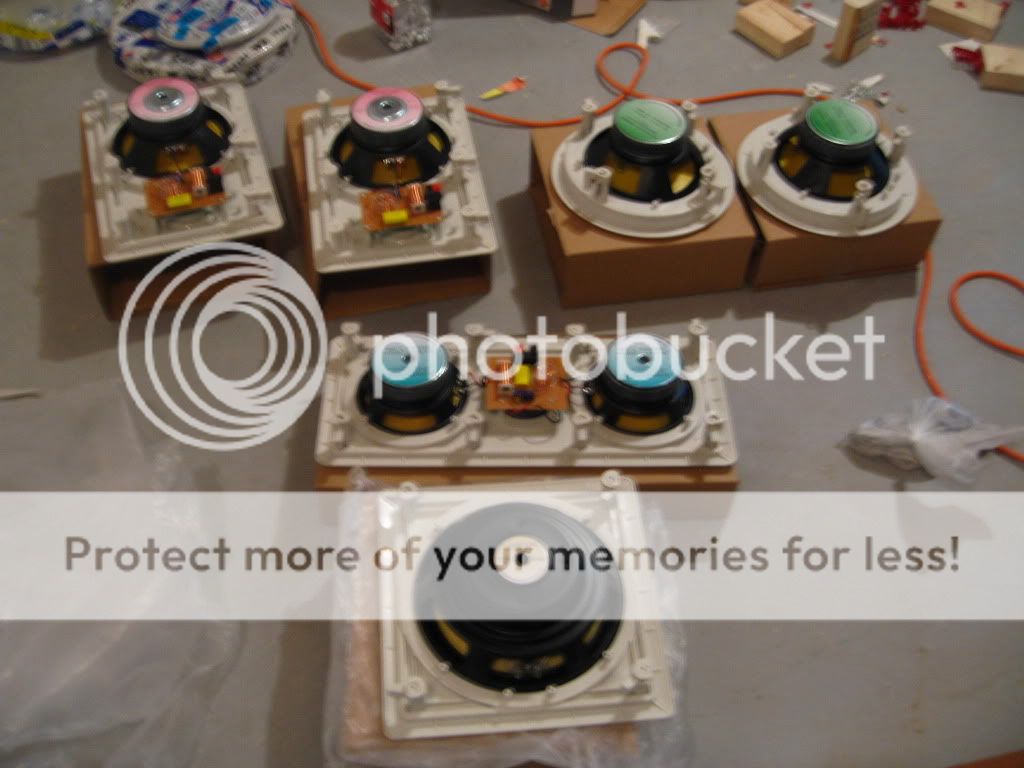

I just got this set of in-wall 5.1 speaker for cheap:
  1. LR: 8" Woofers, Pivoting Titanium Tweeters, 175 Watts RMS to 350 Watts, 27Hz - 22 KHz + 3 dB
  2. Center: Two 6-1/2" Woofers, Soft Dome Tweeter, 175 Watts RMS to 350 Watts , 33Hz - 22 KHz + 3 dB
  3. Rear in ceiling: 8 " Woofers, Titanium Tweeters, 175 Watts RMS to 350 Watts, 28Hz - 22 KHz + 3 dB
  4. Subwoofer: 10", 150 Watts RMS to 300 Watts, 26Hz - 200Hz + 3 dB
Packaging:
Opened:
Back:
Center Grill off:
No, this 5.1 system is not for the theater room, it is for the TV room just outside the theater room, will be installed outside the rack closet wall. The center is wider than 16" studs space, so I have to alter this wall to mount the center.
The sub does not come with built-in amp, so I need a decent amp to power it. Do you have any recommendation? Other option is to buy another sub, then buy a two channel amp to power two subs.

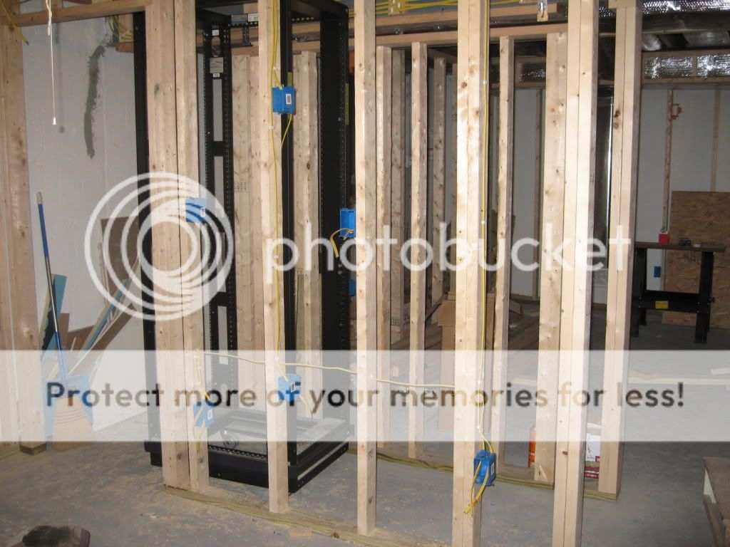

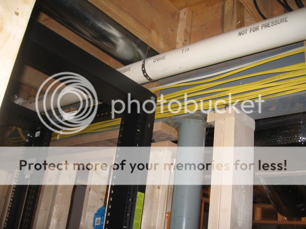

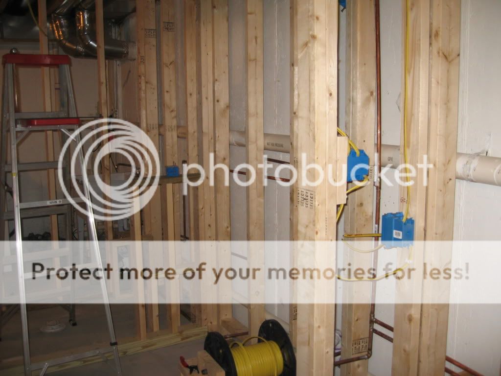

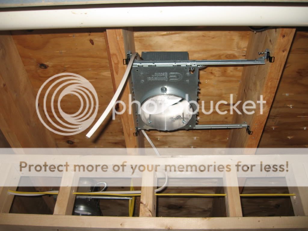

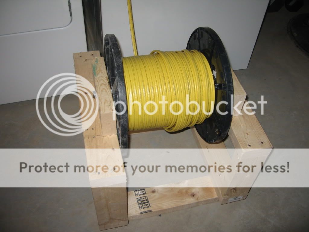

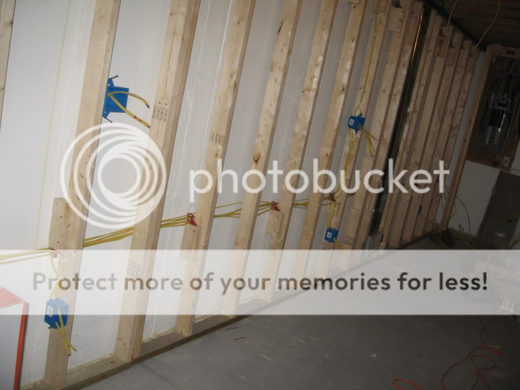

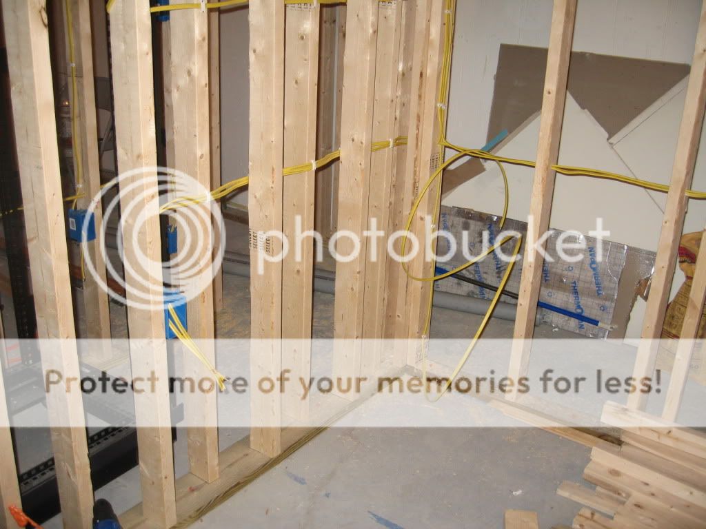

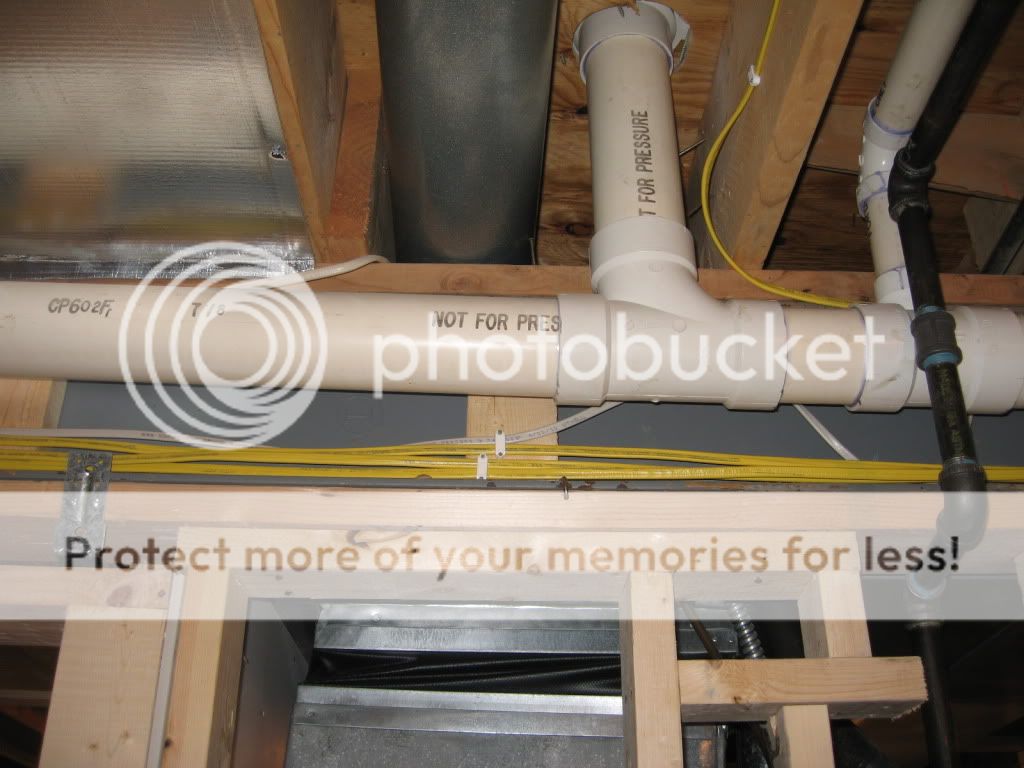

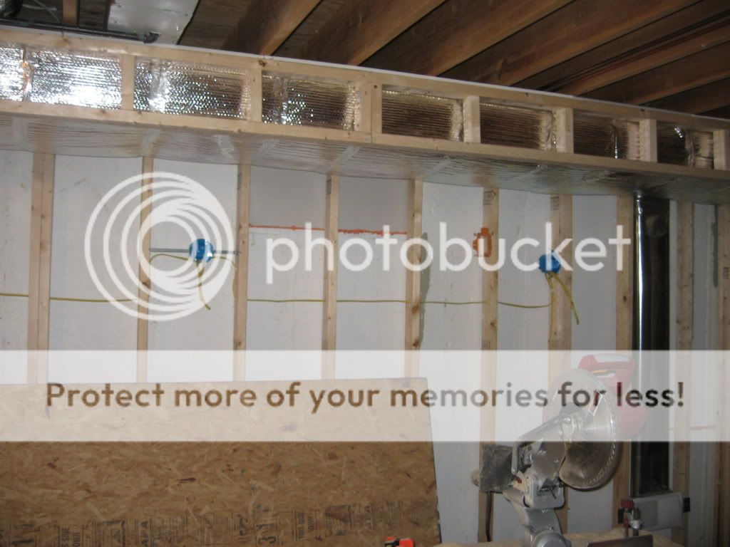

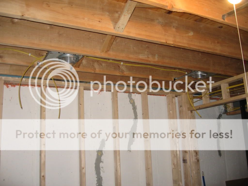

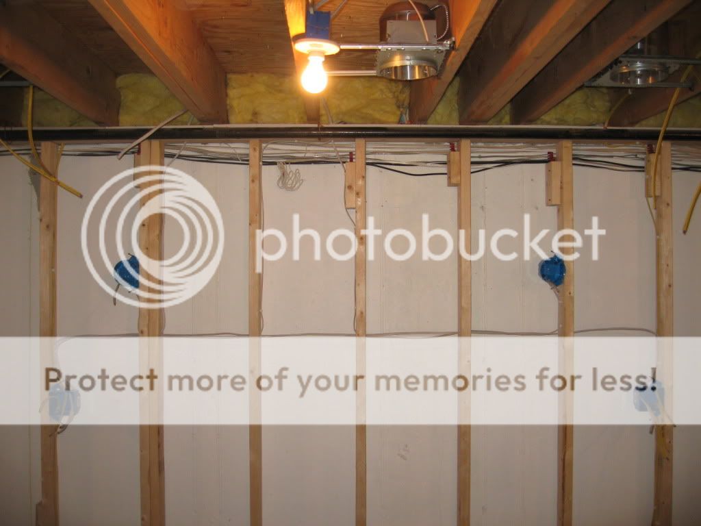

I promised to update electrical rough wiring, here are some pictures:

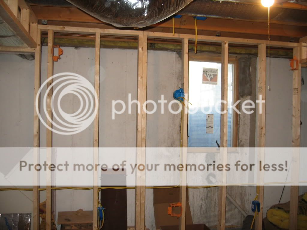

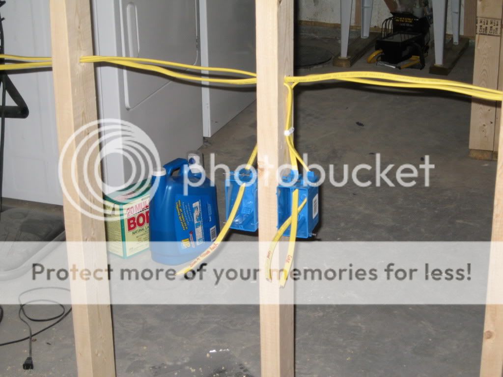

Pulling wires along the south wall, I did not drill holes on this wall, used same method to secure wires with the plastic clips:
After pulling few wires, I didn't like the work, the wires keep twisting, so I made this reel rack to minimize the twisting and it make the job a lot easier, not only wire won't twist, pulling wires also become very easy:

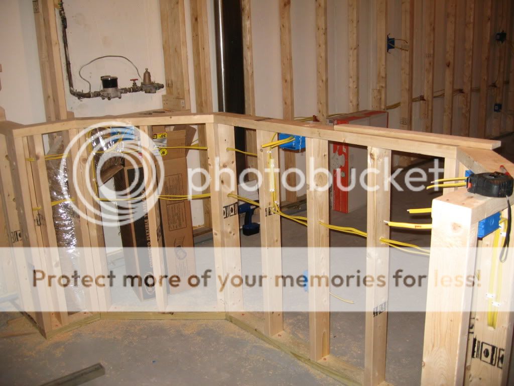

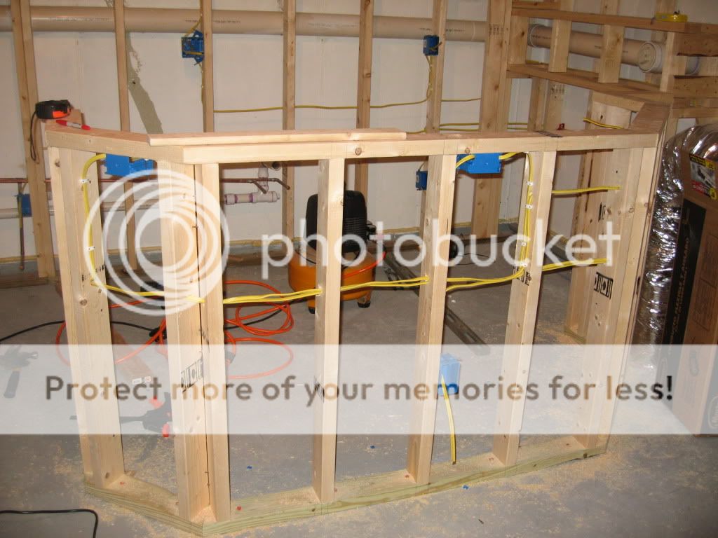

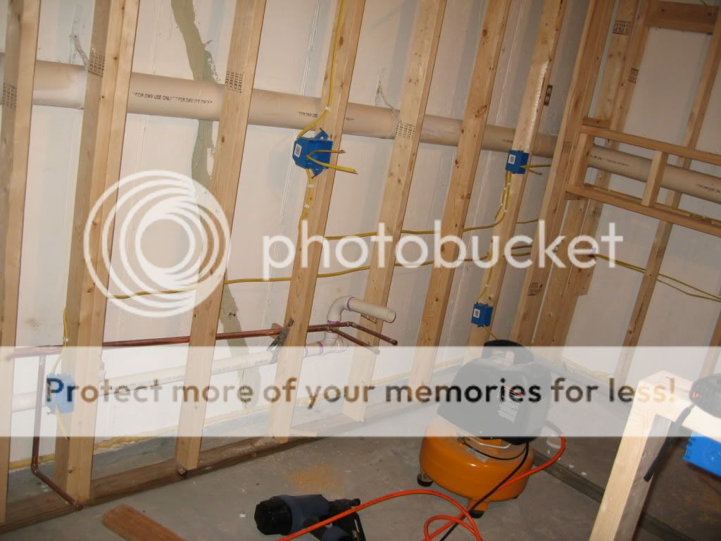

Bar area wiring:
Front, I wire a outlet on the front bar wall to meet the code, it is on the same south wall receptacle circuit:
Bar back wall wiring, there are two separate circuits for the lower outlets, one for wine cooler and one for a refrigerator thought I don't know at this point I will pull one refrigerator there or not, just wire a dedicated circuit in case, upper boxes will be GFCI protected counter top outlets and on the left 2-gang box, a switch for back wall ceiling fixture:
Back side of front bar, I wired 3 outlets, GFCI protected, on same circuit as the back counter top outlets, and a switch for over head fixture:
Outside view of bathroom wiring:

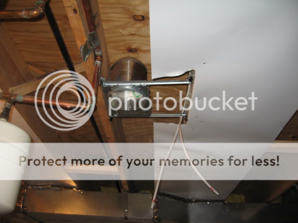

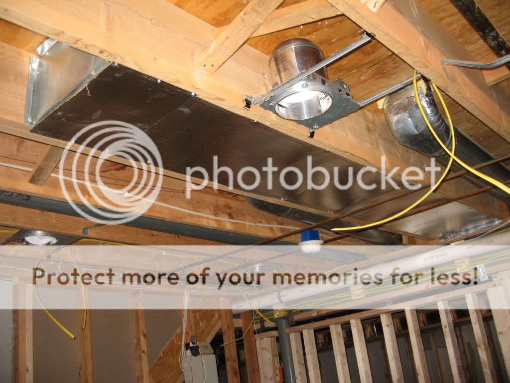

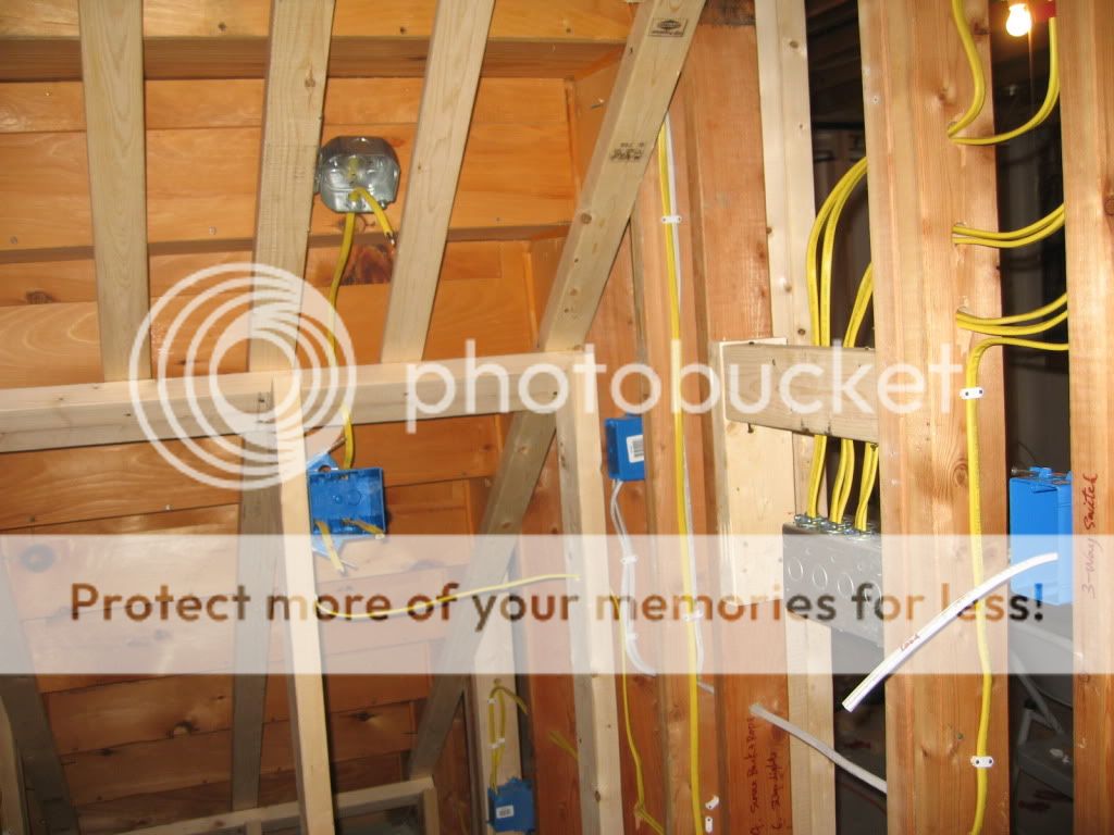

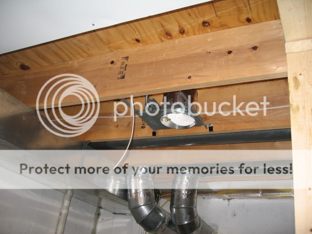

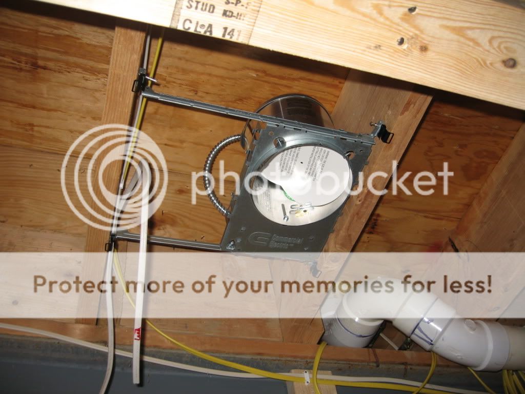

Recessed light rough in, I temporarily put the recessed light can between the joists just to give me an idea where the wires should go, as you can see, the wires are hanging down from the joist, I did not connect them to the cans:

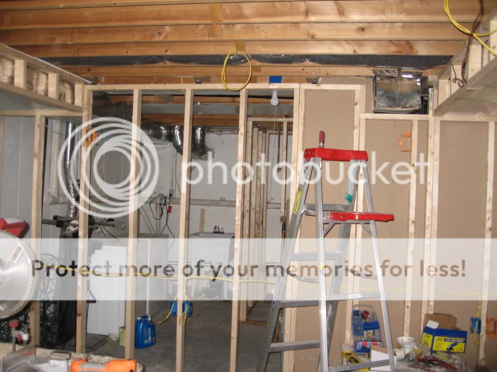

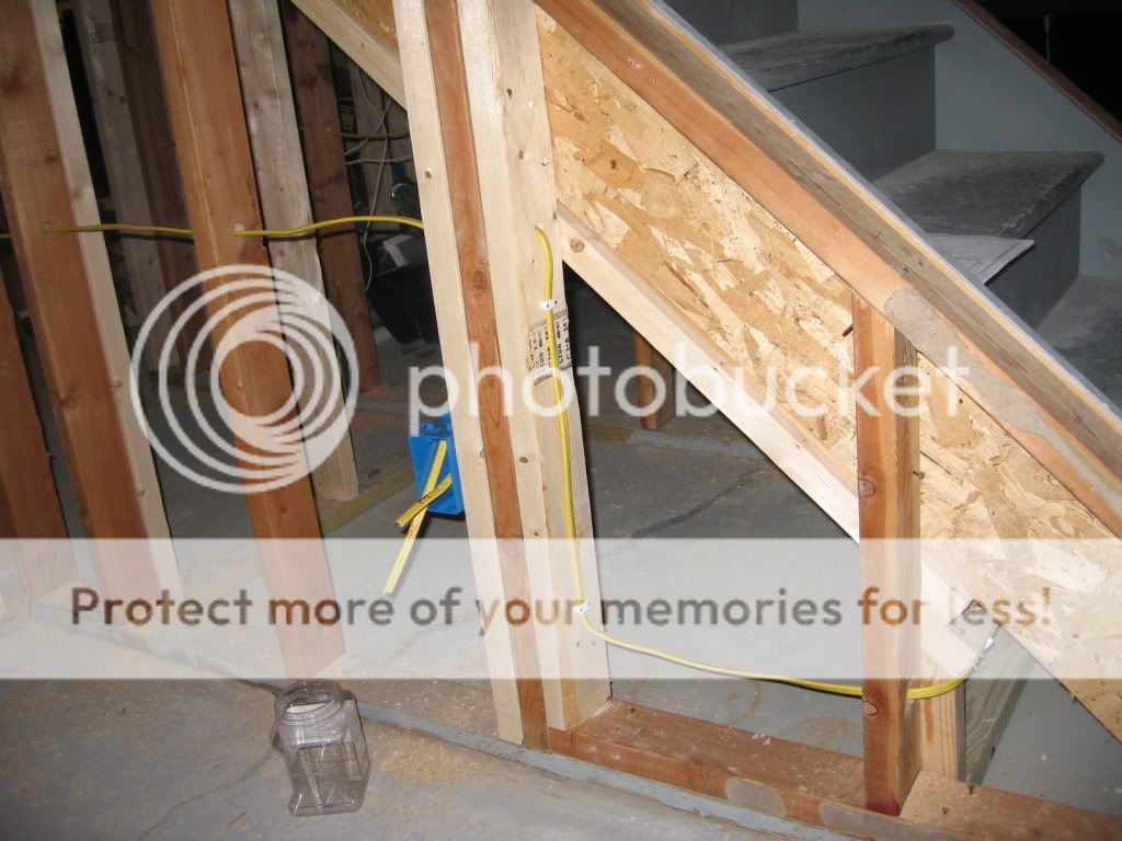

North wall (outside theater room) wiring:

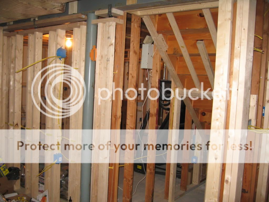

Wire has to cross the stair so I run it under the stair as you can see in this picture:

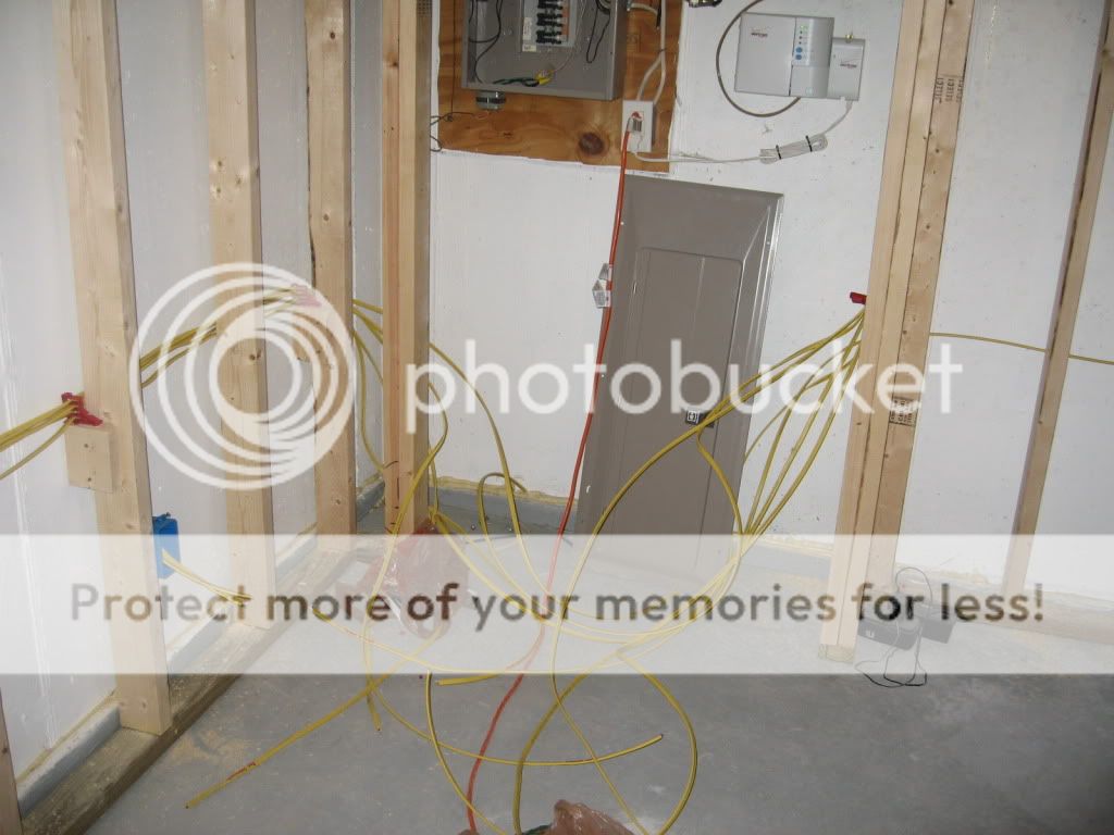

All wires start at service panel, I make sure I leave plenty long wires here:
I should have more pictures, I still need to wire lighting fixtures for the theater room, and this is this weekend's work.

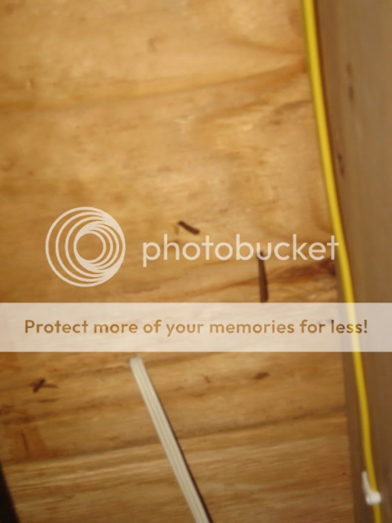

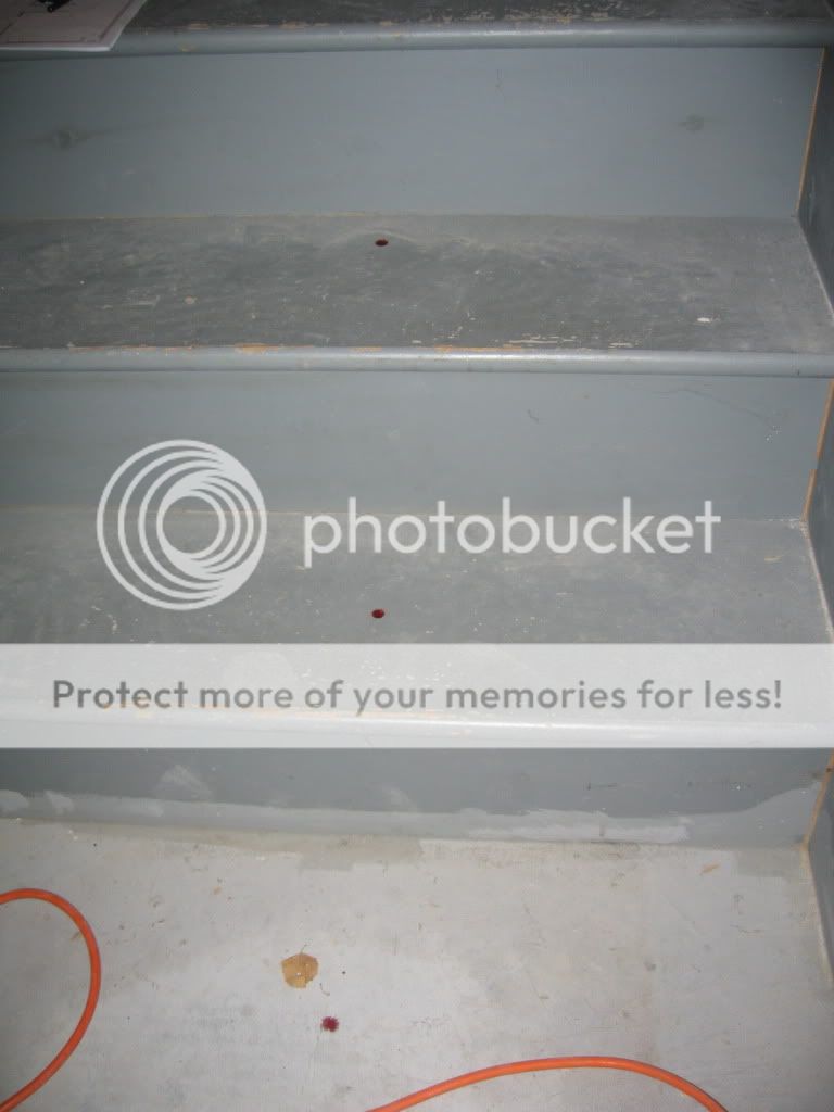

I had experienced my first basement build injury. I bumped my head to a ceiling nail in the joist cavity while trying to reach wire over the duct, the mail stuck my head and blood rushed down like a small river and all over my face, my wife got scared and wanted to call ambulance, but I just got a cotton ball and pushed on the wound, 20 minutes later, it stopped bleeding and I cleaned my face and back to work again:
This is the bad nail:
Blood on floor and on stair:

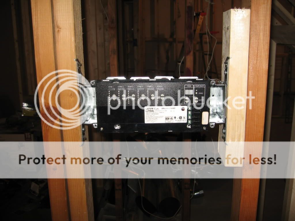

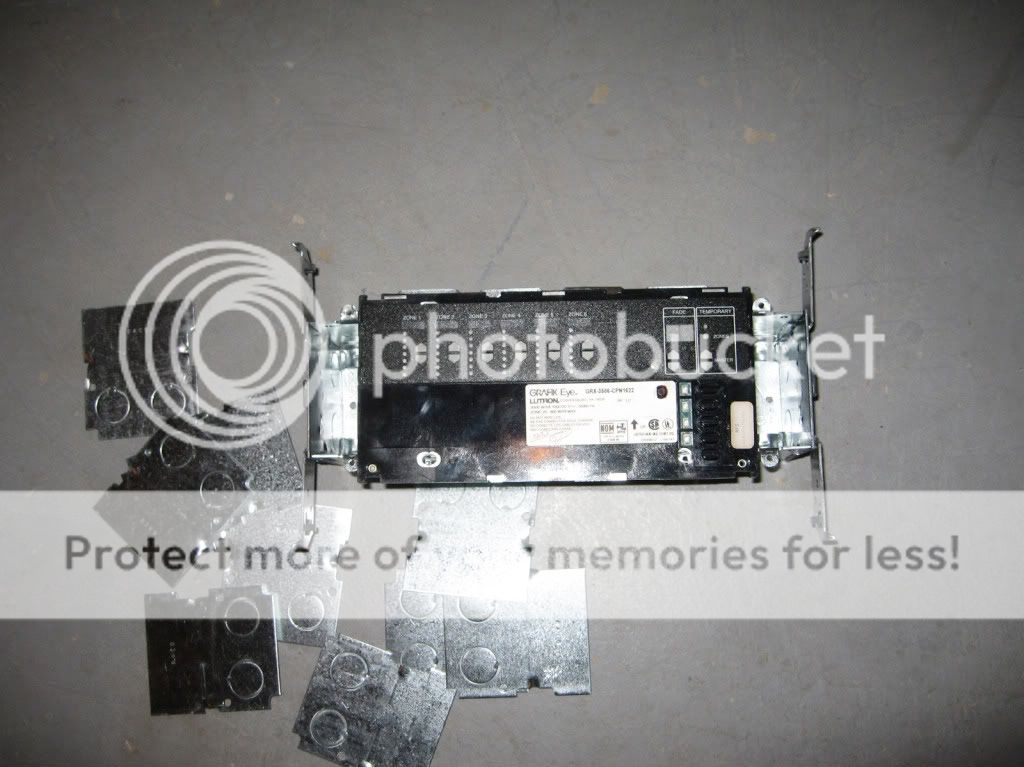

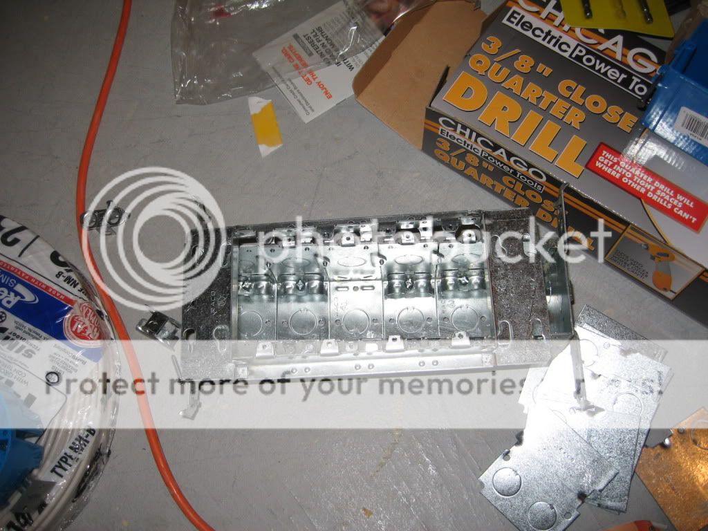

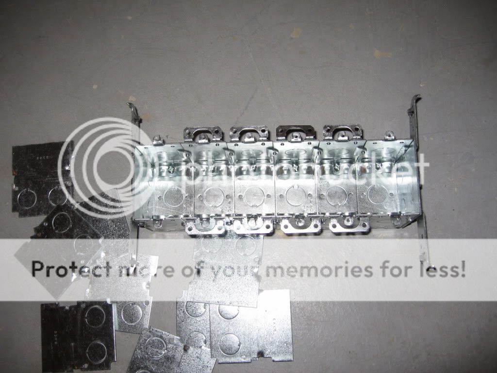

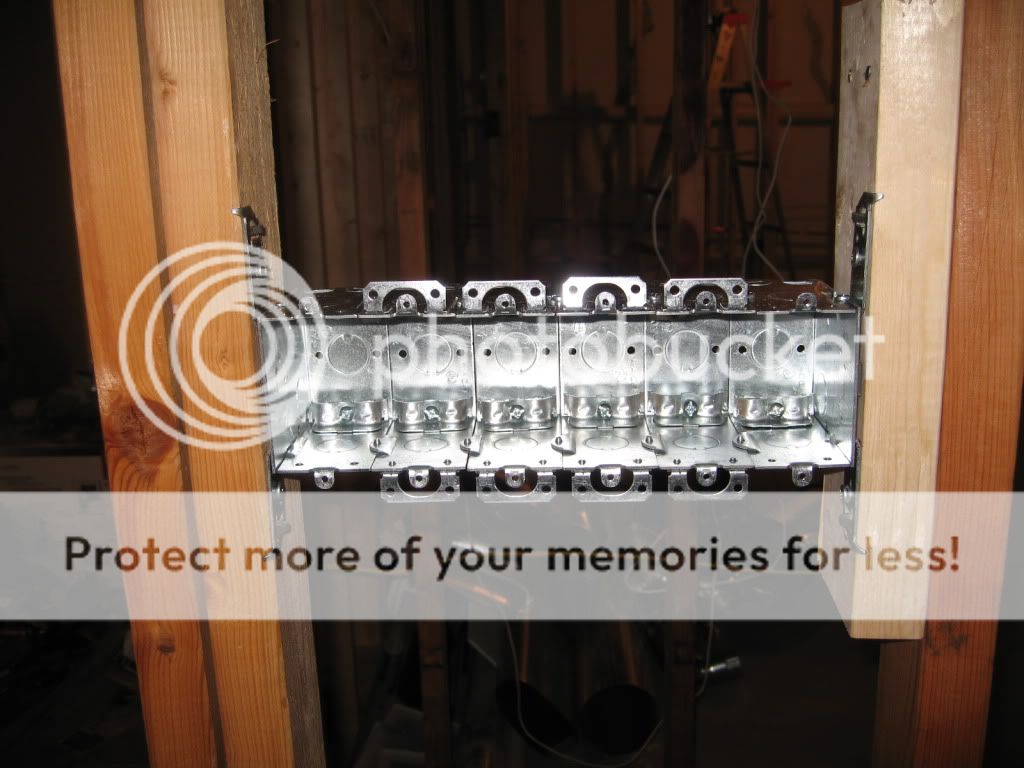

I did not find a 4 gang metal box in local store, but at local HD, I found 3.5" deep Raco metal single gang boxes that I can gang them up, so I bought 6 of them to make a 6 gang box, there should be plenty of space, the only thing is, it is only 3" tall, GE just fit in without much room on top or bottom, but I think this could work out:
Gang up 6 single gang boxes:
GE fits in:
If need more space, I can gang up more but I think 6 are good, has anyone tried this route?
theWalkinator is offline

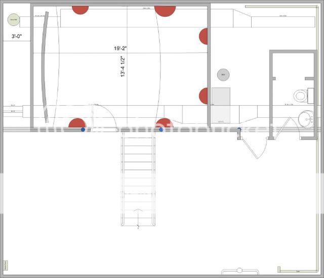

I decided to flip the theater orientation, making the back wall screen wall and screen wall back wall, thus the wiring is shorter especially for running projector conduits, instead of 30' conduit and many turns, this way the conduits will just be 10' long with 2 turns, basically, straight from rack closet to the projector location and two turns being one up to the joist cavity from the rack closet and one down from joist cavity in theater.
In my previous plan, I forgot to include the rope light into one of the zone, here is the updated plan, rope light will combine with wall scones:
Zone 1: Recessed lights along south and north soffit
Zone 2: Wall scones and rope light
Zone 3: Recessed stage down lights and back soffit down lights
Zone 4: Stage screen back lights
Zone 5: Star ceiling
Zone 6: Step lights
post #190 of 592 Old 06-26-2010, 11:51 AM - Thread Starter
theWalkinator's Avatar
Location: Philly Suburb
Posts: 727

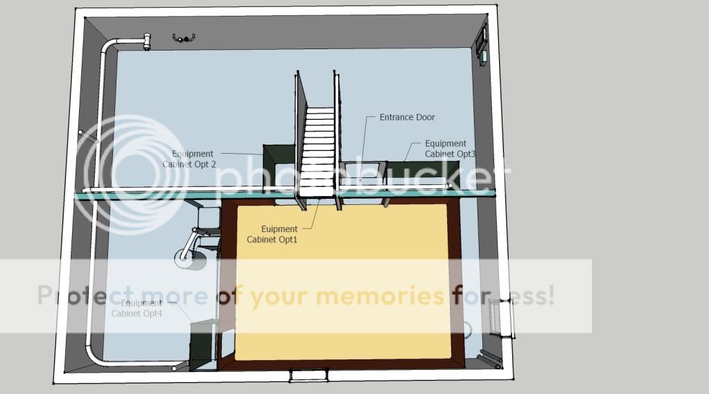

This is the original design, turn it 180 degree in the new design:
Rack closet is option 3 in this picture, as you can see, the right side will be the new back wall, the conduit run is much shorter:
Zone 6: Step lights

what are you going to do with the open spaces at the sides of the GE?
order it online, do it right. Hanks electric is great, plus they sell the control wire by the foot.
http://www.hankselectric.net/detail.aspx?ID=403
Would that be wrong if I just cover it with drywall, or metal plate to cover on each side? I mean it is code violation?
Thanks for the link, I do need control wire.

You need a six gang mudring by Raco.
http://www.lowes.com/pd_122338-427-823_4294896172_4294937087?productId=3136261
Cool, this is better, I was searching on HD and Lowes websites yesterday and didn't find this one. Thanks.

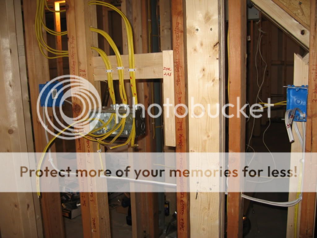

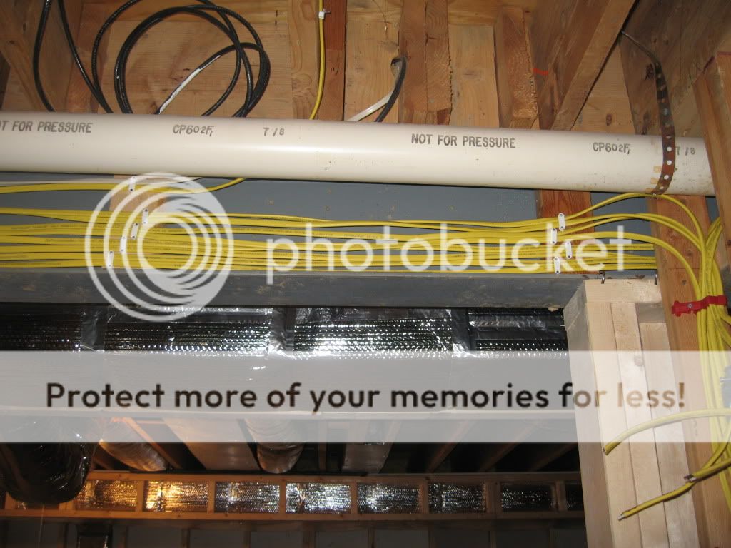

Electrical rough-in is finally done, nothing is easy, need to figure out where to run wires to use shortest wires and how to better organize all the runs, etc., here are some pictures:
I previously gang up 6 boxes and here is it is attached between two studs:
GE fit:
Later, as suggested by smakovits and Tedd, I was able to find both from a local electrical supply store, and I got both:
4 Gang mud ring:
I thought if the mud ring fits the 6 box, then I will be using it, but it turned out that there is no way to attach the mud ring to the 6 gang box, so I ditched that idea and just swapped to the 4 gang box:
I user two wood screws to attached the box to one stud, very sturdy. Is it fine with two wires go through one hole into the box?

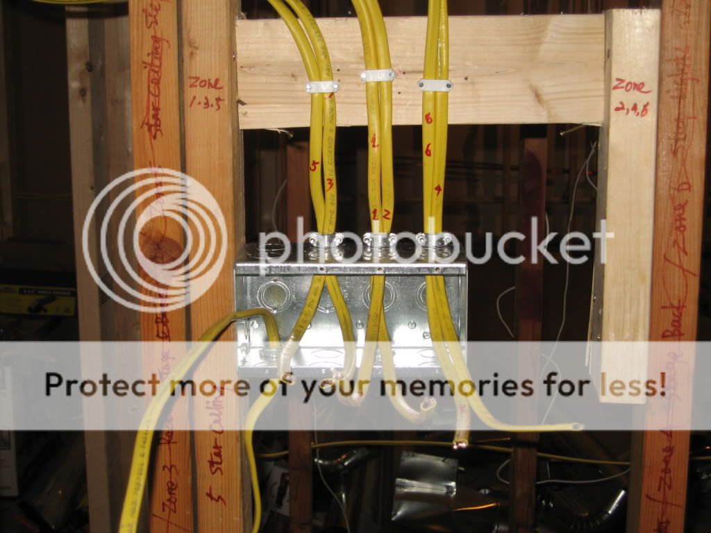

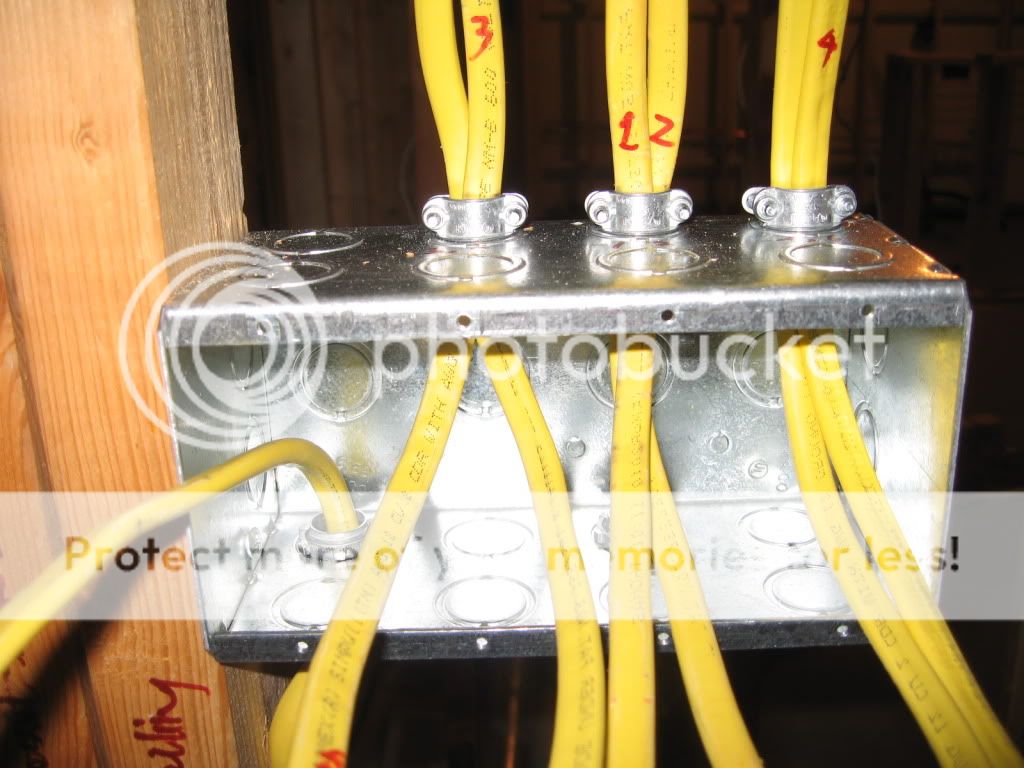

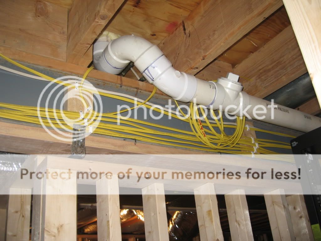

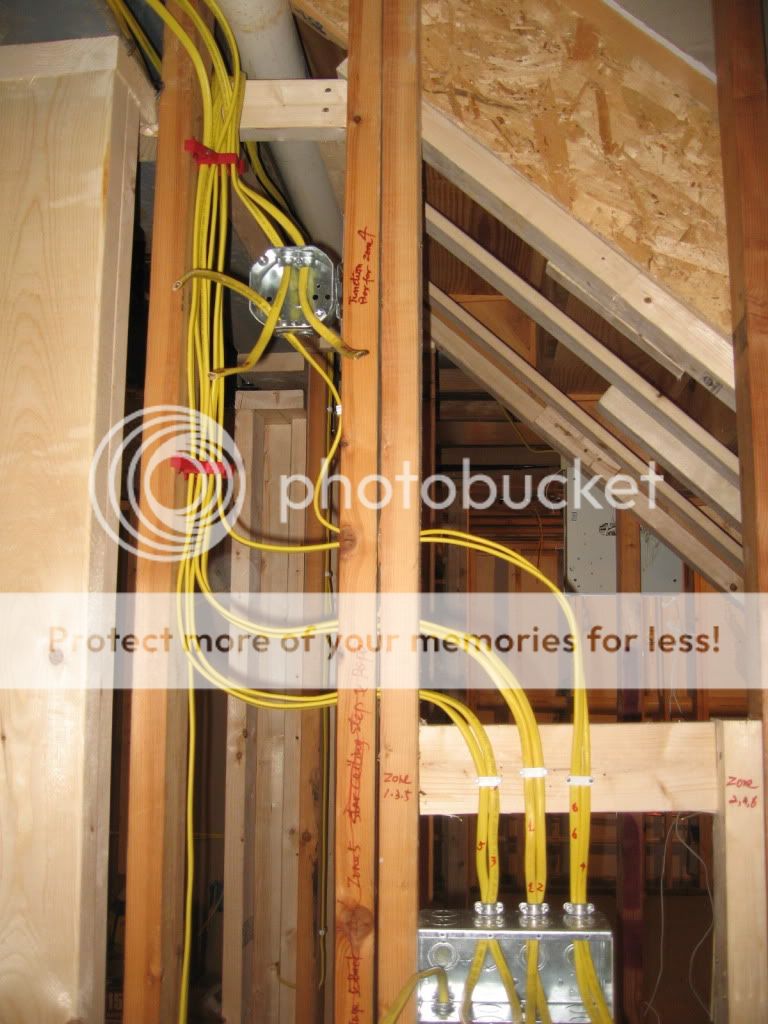

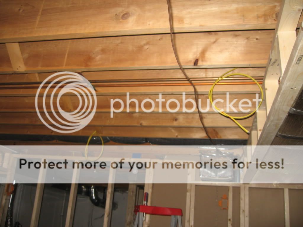

Wires for 6 zones coming out of the GE box, note the square metal box on top, it is a junction box, since I combine screen back light and rope light (plug in the back near the projector) in one zone, I need to splice one wire coming out of GE:
Wires, nothing but wires:
Note the extra wire there is for star ceiling, not sure where to run it, but I make sure that I leave ample wire for it:
This dangling wire is for side and back recessed lights on tray (or lip, whatever you call it):

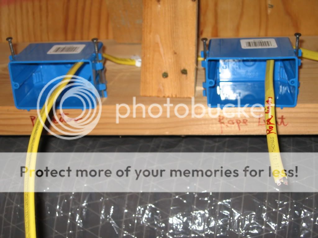

The two receptacles, right is the wall receptacle, the left one, will be dimming receptacle for screen back lights:
The dangling wire in the middle is for screen down light:
Wall scones, all scones are in zone 1:
South side wall scones, there are 3 of them:
Back wall scone, only one of them:
North wall scone, two of them, showing here is the front one:
Projector and rope light receptacles, rope light receptacle should be dimming one:

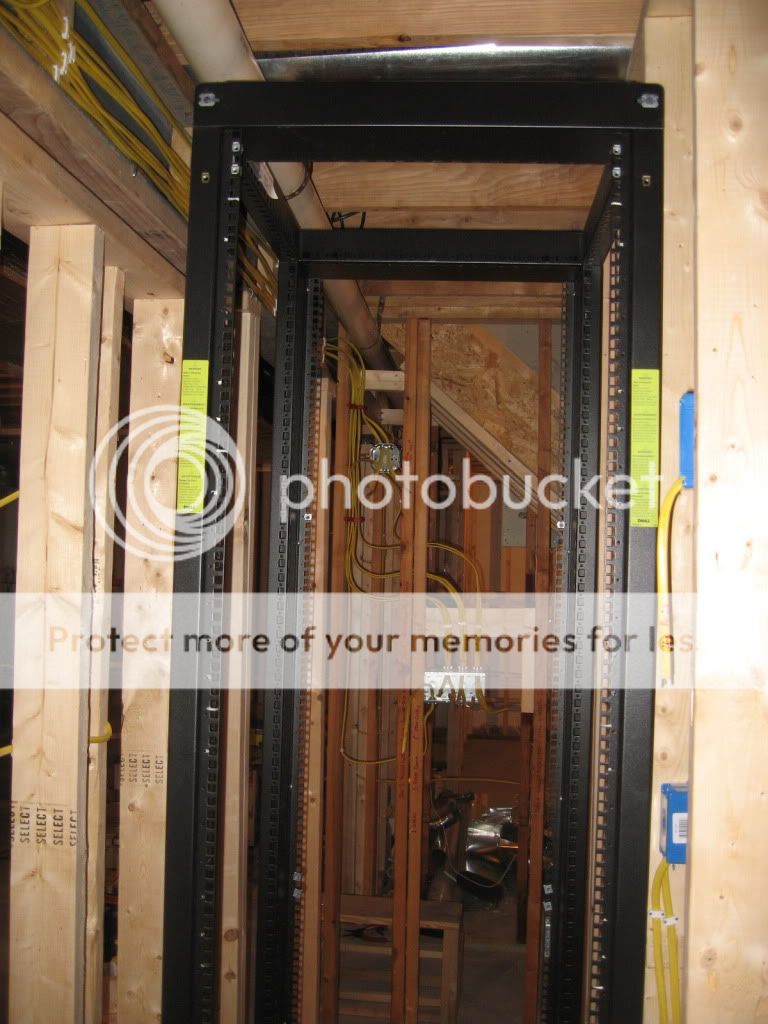

Back of the AV rack closet, you can see GE box:

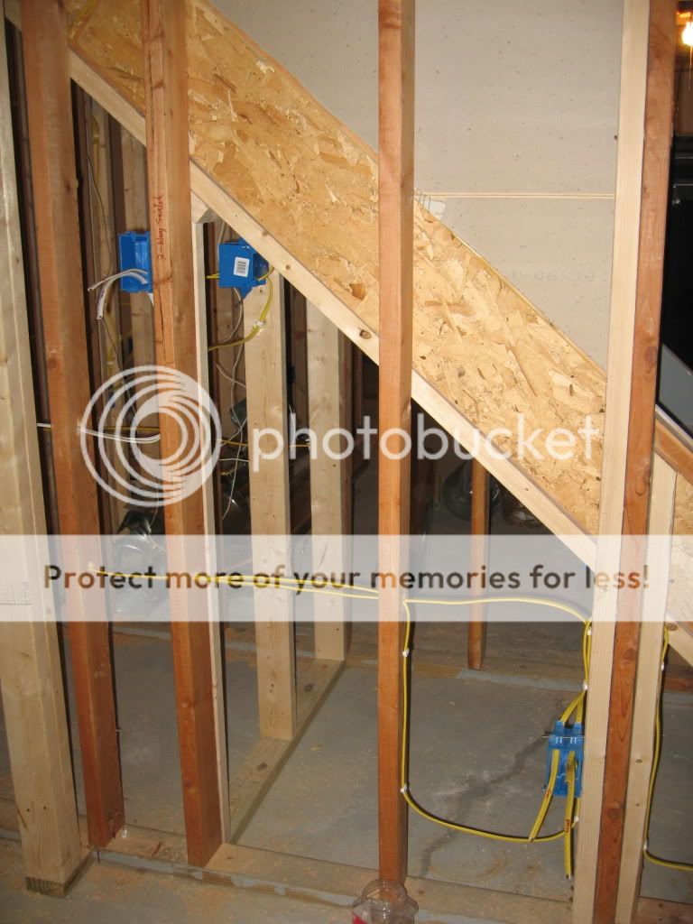

Understair circuit for one outlet and one light, branched from north wall receptacles of non-theater space:
Understair space is like a small cave, I will put a small table and chair here for remote or a monitor or something:
This is a 3-way switches rough-in using the existing circuit, for controlling the theater entrance over head light, the right box is one 3-way switch outside the theater, the left box, facing inside, is the other 3 way switch:
This is the entrance overhead light:
AV closet light + egress alleyway light:

Two mechanical room lights:
This is the wall when you come down the stair, I rough in two wall scone, Daisey chained with the stair landing light, and also I will be using 4-way switches, one on left and one on right, and on at the top of the stair in the first floor, again, using existing circuit, 14awg wire and 3 conductor with ground:
Overall, I bought 1500' 12-2 wire, 250' 14-2 wire, 25' 14-3 wire, still some 12-2 and 14-2 wire left, just enough to finish the rest run in stage and riser. I didn't count how many electrical boxes I used, but I bought 30 one gang boxes, some two gangs and round boxes, later, I bought some more, so except some round boxes left, I pretty much used all boxes, and I still need few junction boxes, mainly to extend existing circuit wire to new fixtures.

Two boxes of cables and accessories from Monoprice arrived on Friday:
350' CL2 12awg speaker wires:
Cables and accessories:
I also bought 2.5' rigid PVC conduits for projector, and a roll of 1/2" 250' long Carlton blue flexible conduit. One question, is it necessary to run speaker wires in flexible conduit?

I went to Homedepot to buy connectors to connect 1/2" flexible conduit to the low voltage boxes, but couldn't find any, all they have are for 3/4" tube, the boxes are also for 3/4", and they don't have 3/4" flexible tubes for 200', only find one roll 3/4" of 100'. So I will try Lowes.
post #201 of 592 Old 07-04-2010, 04:09 PM - Thread Starter
Posts: 727
I went to Lowes and got 2 rolls of 100' 3/4" blue Carlon coil conduit, for speaker wires and other low voltage wires, still need to figure out how to run it, it probably need to dill 1" holes on studs, so if I can, I would like to run it on outside the wall (between foundation and studs wall, or outside wall in unfinished space).
I run two 2" rigid gray conduits to projector location, one will leave empty for future upgrade. Since I flipped theater room 180 degree, now I only need to run very short conduits, the wires and cables are 15' long.
Got a cheap $6 Harbor Freight 50' fish tape, works pretty well:
You can see one conduit is empty for future upgrade:
Two conduits end in AV closet:
Done:
I run 2 HDMI cables, 1 RCA3 component cable, 2 Cat6 shield wires, 1 Cat6 unshielded wire, so what else do I need to run to projector?

Finally I got theater room low voltage wiring done and also got fireblocking done with one bag 2x4' 2" mineral wool that I bought earlier. I also terminated all the electrical boxes, finished few last pieces of framing that I left because wires need to go in first, and wrapped return trunk in unfinished mechanical room. This evening after work, I cleaned the floor and get things organized a little. Now I am finally ready for inspection and will give the township a call next week. For the past 7 months, I have been working down in the basement almost every weekend, so this weekend, I will give myself a little break.
I will take and post some pictures tomorrow.
