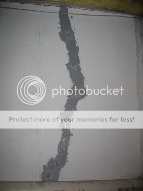

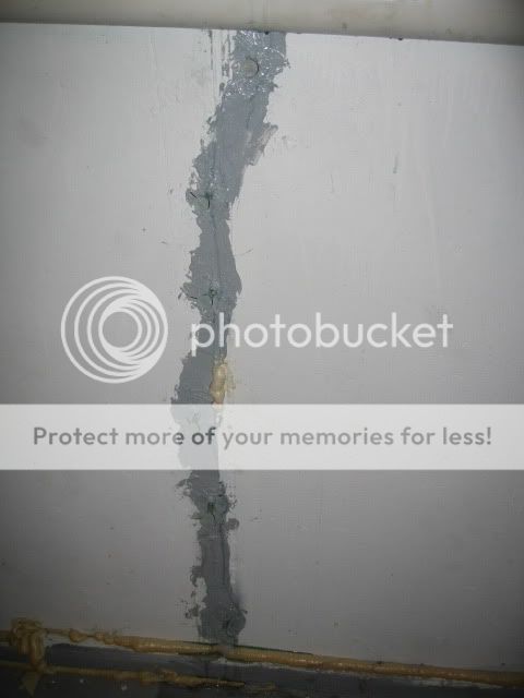

Found couple of cracks on the foundation wall that need to be repaired:
Another one one the same wall as the egress window, I suspect it was caused by the sludge hammer when doing the egress cutting and knocking:
I ordered foundation wall repair kit from Concrete Charlie, suppose to be very good, will arrive in couple of days. But with the freezing temperature outside, it is probably better to wait until the weather gets up 40s.

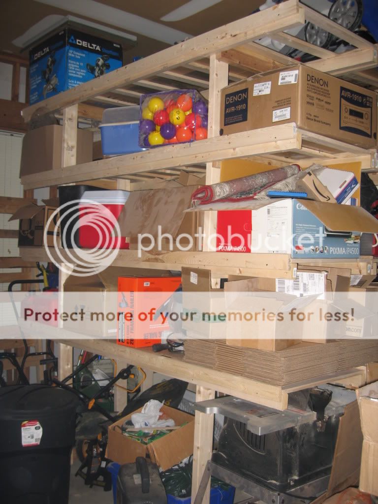

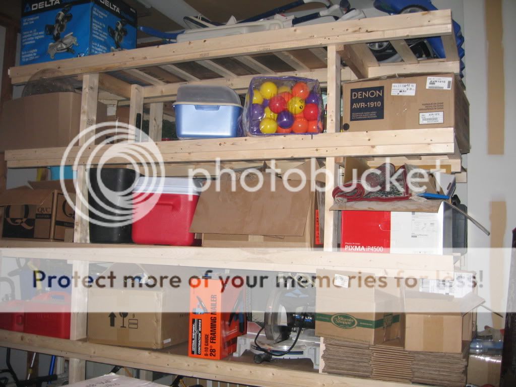

Here are couple of shots of the shelves that I made to store things that used to be sitting in the basement, now they are organized and stored in garage:
The shelves are on wheels and the bottom of the shelves is open so I can slide some big items like lawn mower under. You may not be able see in the pictures but there are two of them, if I need something stored in the back shelve, I can just pull the front shelve and get access to the back one and push the front shelve back, it is really convenient and can really store a lot of stuff.
Nice! What are you using for wheels, with all that potential weight to support? Any more photos of these you can share?
Thanks Hanesian, the wheel are from HD, go to the hardware section and you can find several different size casters. I think mine can hold 350lb so it is really strong. I am at work so I don't have pictures with me, I will post some more pictures of the shelves.

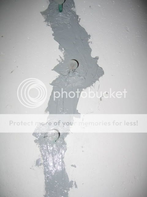

Today I got foundation wall cracks repaired with the Epoxy crack repair kit, the process went relatively smooth, just follow the instructions and it is definitely DIY-able.
First, prepare surface by wire brushing the cracks, clear any loose dirty and use you hand to pad the cracks to drive out the dusts, then mixed two parts epoxy compounds to make the surface seal, then surface seal the crack, with injection port mounted as well, after about 30 minutes, the surface seal is set, then I started injection.
Surface seal applied and injection ports mounted:
Epoxy resin injected and ports sealed:
Closeup shot after the repair, it takes few hours to allow epoxy resin to set:
It was little messy but in the end, I managed to get it done.

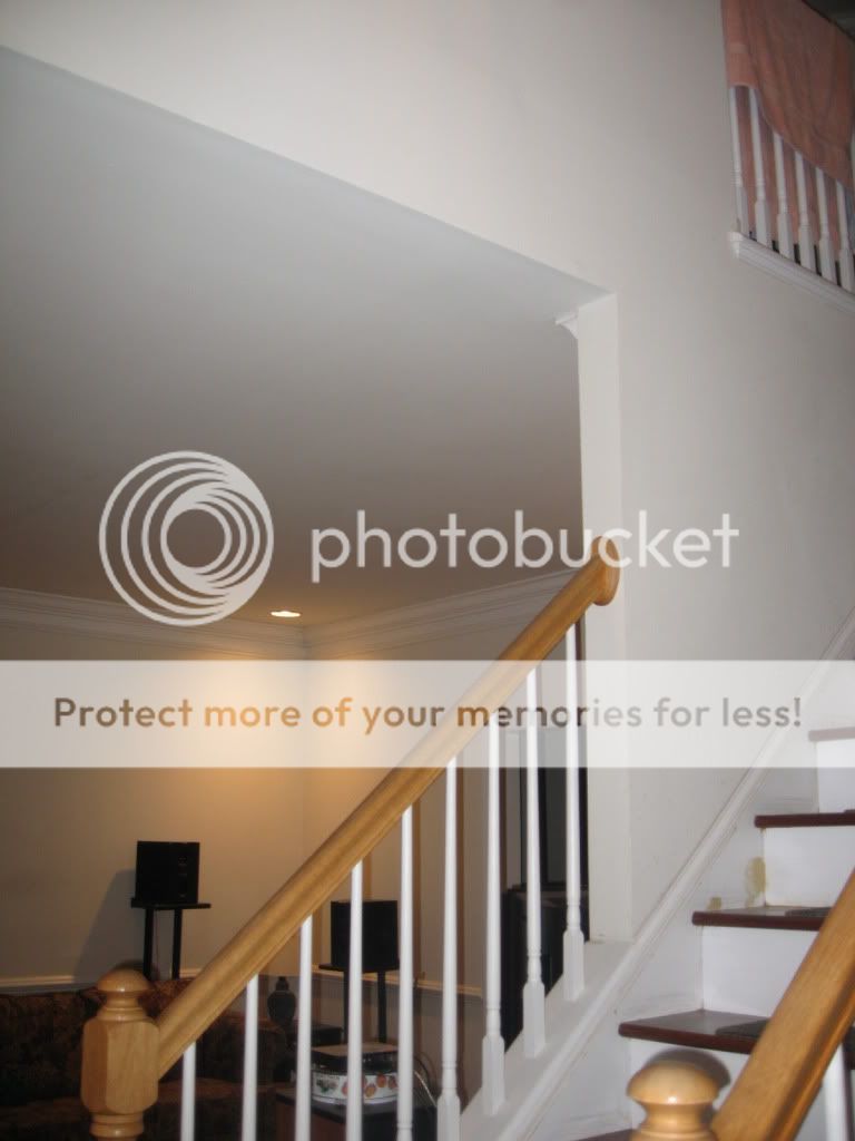

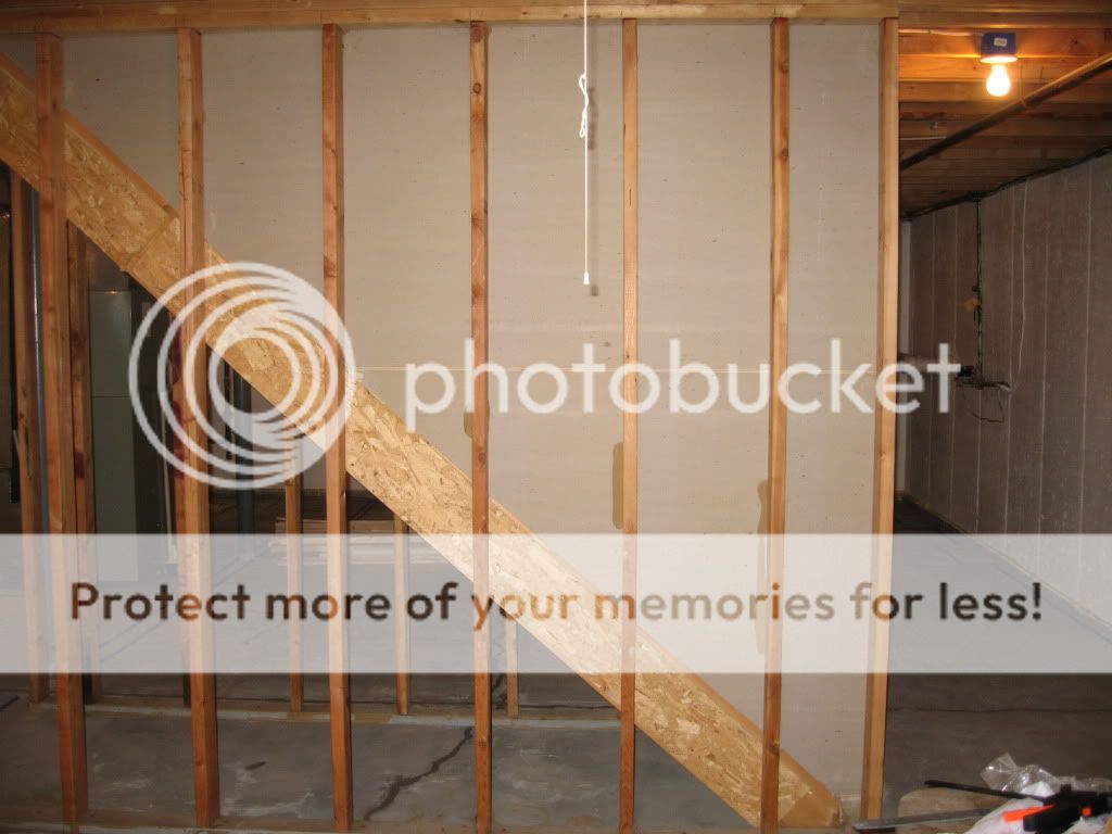

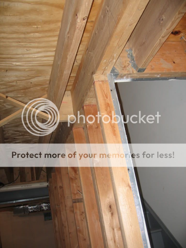

This side of stair case wall is load baring wall, I plan to take out the first 3 studs from the right to open it up, the 4th studs is 9' from foundation wall and 7' from the I-Beam on the left, top plate attaches to double joists (16' cross). Do you think it is fine? Also, do you usually cut out portion of the top plate?
theWalkinator is offline

The stair wall you show in the photo doesn't look like a bearing wall. Can you clarify what you're asking?
I think it is load bearing, there is a half wall right above it (stairs to the second floor) in the first floor and a full wall on the second floor. I will post a picture of the upstair walls right above it.

Help needed, in order to meet fireblocking code for soffit, I have to do something like this in the picture, 1/2" sheetrock attached to the joist as fire barrier. As you can see, there is not much clearance behind the duct work (about 8" from duct to foundation wall, minus 4.5" of framed wall and air gap, only leave me 3.5"), so how do I anchor the DC04 clips in this situation?
Can't help you with your recent RSIC clip question, but back on the issue of whether that wall is load bearing or not ... in the photo of the stair wall I only see basic 2 x 4 framing. Is there post/beam or other substantial support not shown in the photo? I can't imagine how it could possibly be load bearing otherwise.
The Un-Theater Un-Build
Well, it is under double 2x9" joists, here is the shot from another angle
Here is the half wall above it which is aligned with, you can see the full wall on second floor
OK, now I see what you're referring to.
I hope others with more experience jump in here for you on this question, but I'm thinking that even though those joists support load bearing walls above, that doesn't mean that the simple 2 x 4 framing constructed under them are load bearing. I wouldn't mess with any I beams or such supporting the 2x9" joists, but that 2 x 4 framing itself around the stairs should be fair game for coming out.

You can see where the doubled 2x9's sit on the steel beam in the far end of that picture (that's just one end). The question I would have is how far is the OTHER support beam is away from the 2x4 wall where it ends, or what is total span of the 2x9's?
I would consider an interior wall which has framing or roof trusses running over it (especially running perpendicular) as suspect "load bearing". This is similar to that scenario in my mind, especially given that it appears that there's at least one floor and maybe two above bearing down on those 2x9's. You also have a double 2x9 header running perpendicular at the top of the stairway exit. The load that's supporting load is shared with the other 2x9's, and is transmitting some portion of that aggregate through that "little 2x4 wall".
If it were me, I'd get someone in there who can give you a better idea on what you can and can't do before you start cutting out that wall
fotto is offline
I think you might be wrong about the fireblock. I had this same question and actually got the building inspector to come out to specifically answer this question. The answer I got was that the drywall in your pic is not necessary. The plywood (or OSB) of the floor above the basement IS the fireblock, so you don't need the drywall. As always, please consult your local code dept as codes vary.
