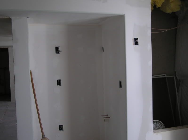

Here's a picture of the wetbar framing with the fridge and convection/micro sitting there in their boxes (sink on top). These two made a great tool holding surface for months. I ran 4" PVC pipe as a cable run through the ceiling over the wetbar, then 90* left over the door into the furnace room. I'm glad I left a few ropes in ther to assist in future cable changes. Note that the PVC in this picture is the drain from the kitchen sink upstairs. I don't have the cable run in yet.
I used both clear and white caulk on the stubs as a budget isolation method. The clear was a little softer, and went on white, dried clear. The white went on...white, but was much easier to see after it dried. I used at least a case or two. Directly on the studs below the Celotex, then all over the Celotex sound board under the drywall. I didn't use isolation brackets so I was liberal with the caulk. This was a first pass. I realized the straight run down the middle got in the way of the drywall screws and got pulled away from the stud in a clump. So I went with a wavey pattern and a whole lot more than this:
My Dad and I started putting up drywall on the ceiling without this jack. Foolish. The jack was rented from Home Depot and was worth the money since I could work on the it by myself when Dad wasn't available.
This is the screen wall. To the right is where the built in book/media shelf/cabinets will be built under the soffit. If you look closely you can see the floating walls that my area requires to allow the floor to rise without knocking the house off the foundation. You can also see the caulking on the studs. Since this is a basement, 2 1/2 walls are below ground with a thick layer of diaper insulation applied by the builder. So the wall studs are at least 3-4" away from the cement. Then I added more insulation inbetween the wall studs for at least 6-7" of insulation. One upper half of the screen wall, there is more two layers of the R-13 JM and I can add more from the crawl space area if needed. This design also gives me easy access to the back of the wall to build recesses for speakers, or boxes around in-wall speakers if I go that route (haven't decided yet).
There is 2" inches of continuous gap under the hanging walls which will make future cable running an option. Our lovely contractors did a horrible job on the framing. I had to take down and move a couple walls. Plus, they started pulling out of the joists and sagging. So I had to jack them back up and add more screws and nail strips to keep them together. The studs just starting pulling away. Also, the studs were rarely on center so I had to custom cut EVERY piece of drywall!!!
Below you see a piece of soundboard leaning up against the stud. Cheap and effective.

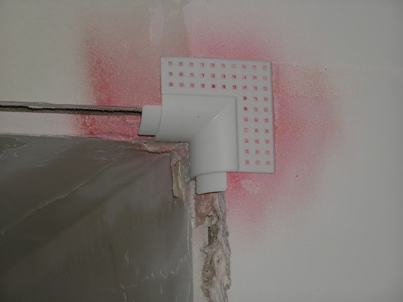

Bullnose corners - attached with mud - not nails/screws to more support behind, and eliminate hollow spaces
Knockdown texturing - done by a contractor.
Again, because there was nothing close to a 90* angle, I had to measure and custom cut EVERY piece of drywall. The studs were not perpendicular to the floor, the walls were at an angle (as much as 2" over 8-9 feet).
Close up of a bullnose corner:

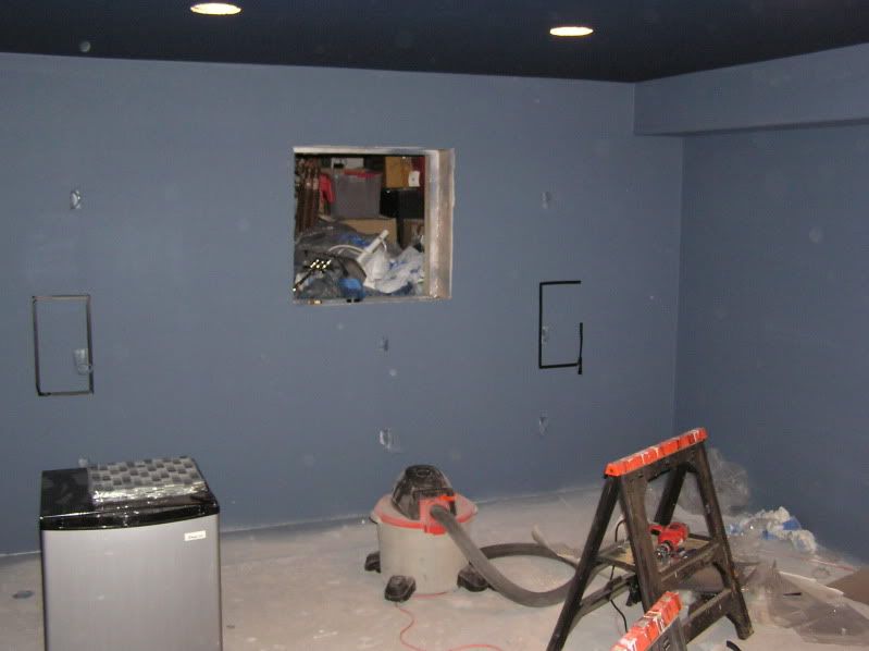

Here's the wetbar area. The counter top will have the black/grayish blue/white glass tile on it to give a mono-chromatic look, which will also tip a hat to the Route 66/Drive-in theater/car theme. I won't go overboard with theme though. I don't want the glaring 50's diner look. Under the counter will be a refridgerator on the left, and a cherry-finish cabinet on the right. Above the counter will be a hanging cabinet on the right for glasses, etc., and a shelf for a convection over/microwave on the left. I've got an outlet in the corner to supply under-cabinet lighting. Both appliances are stainless steel.
The underlayment for the tile:
In this more recent pic you can see some of the outlets, and dimmers

Here is the place I will put a door to the back of the media shelf for easy access to the wiring. You can also see the cabling hanging from the run that goes to the projector mounting area in the HT room ceiling. The blue ropes are to facilitate future cable runs.
mizedog is offline

I went to Home Depot and asked if they'd take the fireplace back after it sat in the box three years. They said yes, if they still carried that model. Unfortunately, I don't think they do. The receipt I showed them is so faded that it's tough to see the sku number. I'll have to disassemble it, repack it, try to get it back, then they can pass down a judgement. My Dad was over to help with routing the craftroom countertop and agreed that the fireplace is too high. We'll see.
I unpacked the fridge and pushed it under the wetbar. Hearing that little hum as it started up kind of gave a little life to the room. Cold drink anyone?
Have you noticed rough spots or holes in the drywall at the base of the walls (like in the wetbar nook)? They were originally intended to be cut out for the floating wall. One note about Colorado. Due to the high cray content of the soil, basement wall must be floating. This means they are suspended from the joists with slip joints at the bottom to allow the floor to rise and fall as the clay absorbs moisture. So, there's about 2" of space at the bottom of walls. The drywall is "supposed" to be cut out and the space hidden by higher baseboards. I found out after installing the drywall that cutting out this waste is actually an option and now have decided not to cut out the space. I'd rather keep the load bearing advantages and risk later drywall cracking. I had to do major rework of the framing after the contractors left because the walls started pulling apart and sagging. I'm just concerned that without gypsum from floor to ceiling, the wall will pull down again. Here's a pic of the space:
