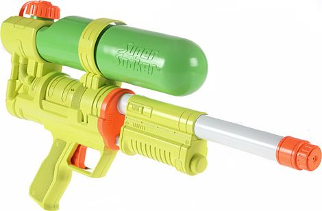

Unfortunately I'm finding this thread AFTER purchasing a 5 gallon bucket of Green Glue and no applicator. There were MANY sites that said I could trowel this on (1/8" v trowel), but only now I'm I finding evidence to the contrary. $55 is a lot of money for an applicator (especially after spending $215 on the glue itself). Anybody had any luck with troweling or using a different (less expensive) applicator?
I'm wondering if I could use a water canon like the Stream Machine or Max Liquidator (each around $15) instead.
digabyte is offline

Sorry but I think you should shell out the additional $40 to get the correct applicator; it's the correct tool for the job. Drywalling is already enough of a PITA without having to worry about a dodgy GG applicator...
