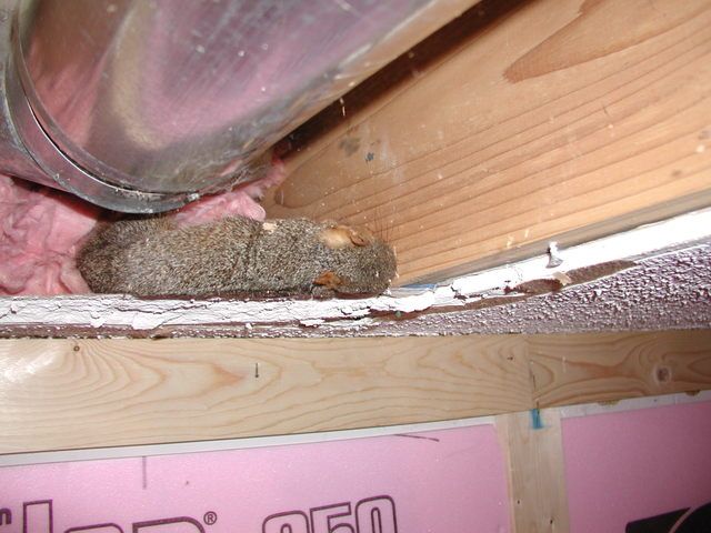

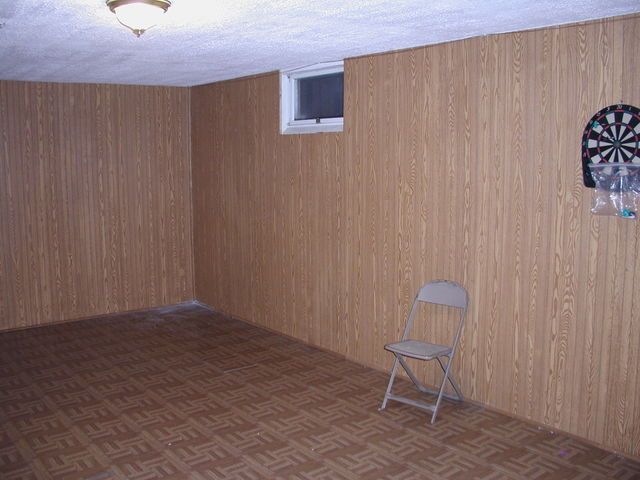

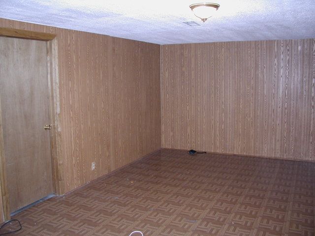

Ok RTROSE....if it's demo you want, it's demo you'll get!! Like I said before, I wanted to start with a blank canvas, nothing in my way if you know what I mean. I'm glad the demo decision was made. There was bad wiring in the ceiling and we also found a little surprise! Needless to say demo was a good call!

I just got an idea for a new "show me" thread"
"Show me your dead animals in walls"
Good Grief.

Liked: 82
Nice surprise, Bullwinkle! I hope you didn't tell your wife about that find - if she's anything like my wife she would then be convinced that she is hearing more << insert type of rodent here >> scampering around behind the new walls.
Keep 'er going!

Yeah, what hanesian said. I'm surprised you didn't smell him first. I think you have a perfect space to work with. I like the shape of the room and the large door openings.

LOL! It had been dead for so long it didn't even weigh nothing! Scared the crap out of me when I was yankin down the ceiling! Did tell the wife though....it helped justify the demo

YIKES! Petrified squirrel! That alone did justify the demo for sure. Glad to see you want a blank slate, it really is the best way to do things. I would be in the camp of not telling the wife/SO. Just too much for the imagination to run wild with.
I'm with Big, new sticky show-me thread for dead critters found during your build.

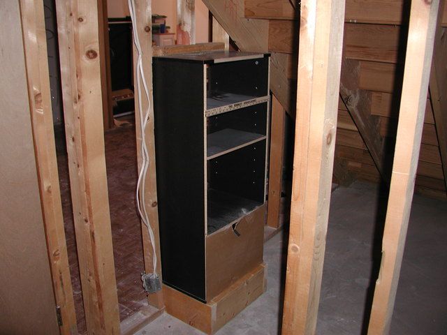

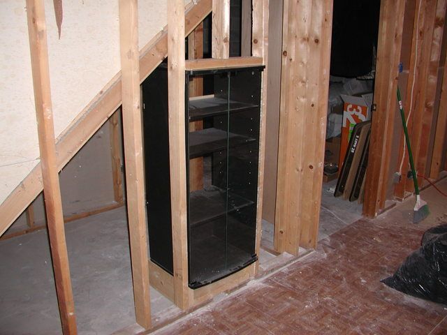

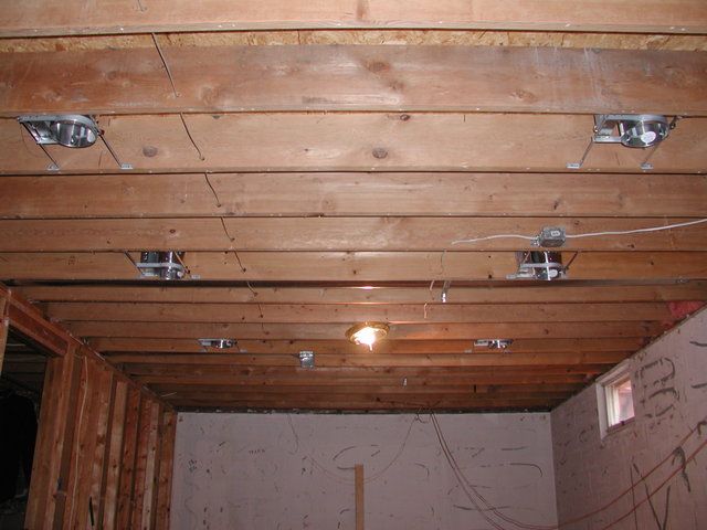

Well, now that demo is complete, it's time to start resurrecting this room. I purchased an eight-pack of 6" can lights at my local Menards and put up 6 of them. Fairly simple and cheap project. Future lighting will include 3 halogen lights in front to show off my 120" Elite screen and sconces on the side walls. I'm also considering using my existing audio rack and building it into the wall under the stairs. I will have access to it from the 5th bedroom. Ive always like the ease of access to my components idea so, I think I'm gonna run with this one. I know it's not framed properly, I'm just trying to get an idea of what it will look like........I think I like it!
"Nick, what did your dad get done in the movie room tonight?" "Nothin', he just went down there and stared again".

The rack looks really good SQUIRREL!!!!! there. I think you just found a new home for the rack. Oh and your right it isn't framed properly!
While you still have access to your can lights go ahead and secure the arms so they don't rattle. Some of us have siliconed the arms others (like me) have used zip ties. I just would not use duct tape as it would tend to creep after time. Maybe overkill but my can lights don't rattle!

What are your goals for keeping the sound contained in the theater? If it is important to you now is the time to develop a game plan and we can help you spend your money.
For starters those can lights should get backer boxes.

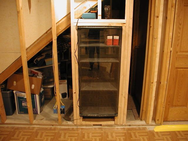

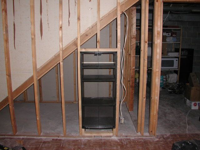

You guys are killing me with this whole squirrel thing! LOL! Got the rack framed in properly. I think your right RTROSE, the rack has a new home! As far as the can lights making noise... I crimped the tracks down. No rattles here! As far as sound proofing the room, I'm just keeping it simple. The walls and ceiling will be filled with fiberglass battings to help reduce any noise reflection inside the walls and ceiling. The interior walls will be treated with linacoustic and fabric. We're pretty simple folks and don't do alot of entertaining so, I'm not concerned about the sound throughout the house. When we watch movies we're usually all together

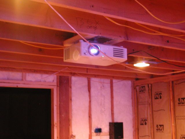

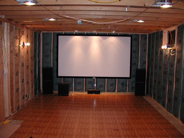

Ok guys, the audio rack is framed in properly. The walls are framed and insulated. Lights are all in and all circuits are live! Hung the screen and projo to get myself motivated. Man! I can't wait until this is done! This is way to cool! I've been wanting to do this for years. Now, it's finally happening!
And he lived happily ever after watching movies in his HT which was "almost completed" when he died of old age.

Great space, nice build and congrats on finishing so fast You know that since the projector is hung, the screen is up, speakers in place and Nemo on the screen that this build is officially COMPLETE!!! Ohh it was a great run but yet another one down

Oh no! You put up the SQUIRREL!!!!!..... PJ. It's all over now! Just stick the popcorn machine in the corner and call it good
Sorry, I didn't really have anything to offer, but I had to jump on the squirrel band wagon too.

Holy Cow!!! Have you not learned anything........Have we not taught you anything?????????? You went and put up the projector. HT CARDINAL SIN NUMERO UNO!!!!!!!!!!!!!!!!!!!!!!!!!
Well this "build" thread is officially done!

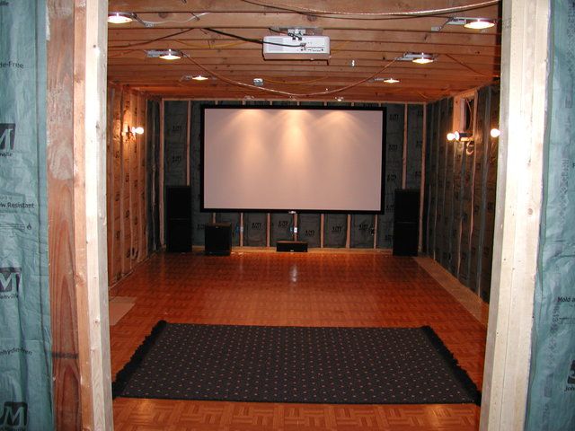

Relax guys! This is not the fastest HT build on the planet. I've been at this off and on for a year now. I already have drywall up. I'm playing picture catch-up. You guys were so right, once that PJ went up the build stalled for a good 3 months. I would go downstairs to work and would always end up in a folding chair watching a movie! No worries though.....the PJ and screen are down and I'm back in the saddle! I'll have more pics up soon.

Whew! That was a close one! I almost had to use my super powers on you to get that PJ down!
