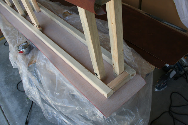

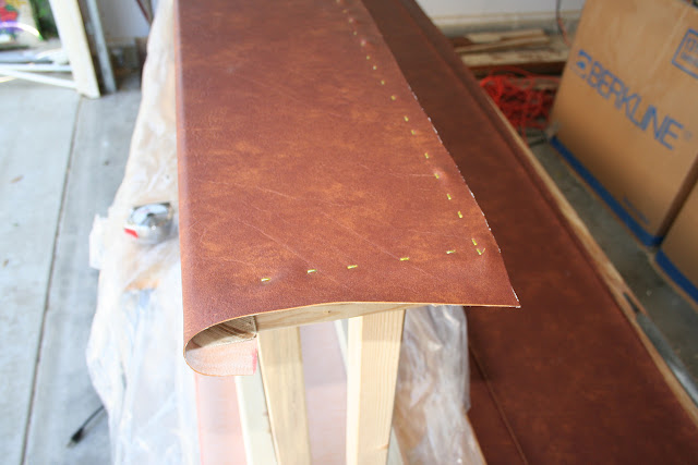

Last night I had precut some of the vinyl I'm putting on the column sides, and couldn't wait to try it out - so I had at it on my lunch break, managed to get the sides of two of the columns done - the stapling for these sure goes quicker than the soffit, much easier to handle:
I stapled on the first side before I started taking any pics of the process:
From the start - cut a panel a bit oversize to allow for wrapping/stapling:
stapled the inside edge:
flipped it over and started pulling the material tight and stapling:
done stapling all around:
trimmed off excess, and used xacto knife to cut holes where the mounting screws on the sides go:

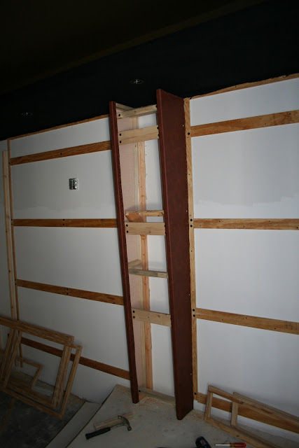

right side column done and test fitted:
left side column done and test fitted:
Not screwed down yet, because (a) they will need to be out of the way when the carpet is installed, and (b) I need to cut an inch or so off the bottoms to clear the carpet / pad. Shouldn't be too bad, add a piece of bracing a little higher, cut away the vinyl with xacto knife, and then saw off the bottom. Trim will be covering top and bottom.
Will also need to sand the face panels some, as I didn't leave quite enough clearance for the vinyl and speaker fabric in the nooks.

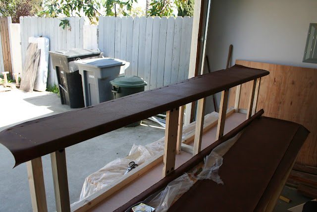

Finished up the rest of the column sides on Saturday - here are the front and side columns, with the face frames in place (spent a couple hours today belt sanding the edges to make them fit after the vinyl was added):
rear corner columns:
all of the right side columns:

Not a ton of progress this weekend. Saturday was mostly yardwork - weeds had gotten out of control. Sunday was rainy and windy, so didn't want to spend all day outside - but did get a few things done:
- added fabric (Commando cloth) over the insulation above the area behind the screen.
- added trim fabric to the edges of the bulkhead where I screwed up and ran short on fabric on the big piece - actually looks pretty good, relieved - the fabric sucks up light so effectively that you can't see it at all from the ground, even with lights on.
- cut out for a couple access panels in the soffit (access to junction box where soffit lights are wired; access to outlet where rope light is plugged in), and made the access panels, covered them, and put them in place (just friction fit now, will add some velcro).
- trimmed off excess fabric on the inside of the soffit, so now I get a nice clean edge on the rope light effect
Brad Horstkotte is offline
