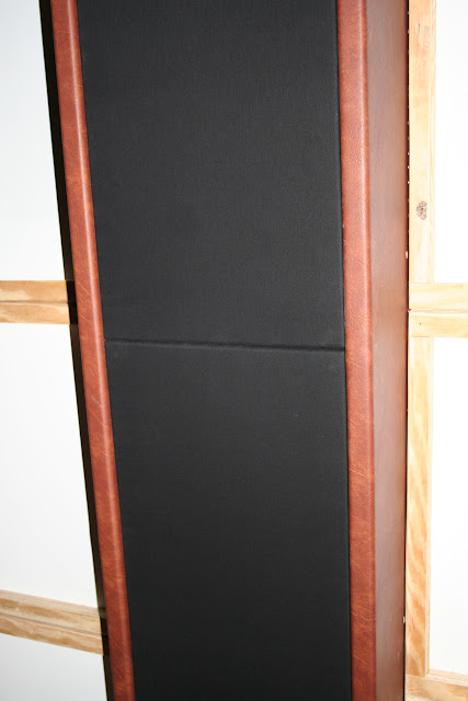

When you get the fabric, place some tape on one end of the tube. make sure that side is up, then make sure every panel you make you make sure i is up, and the same face showing out. Otherwise you could get a slight variation in the shade of the color if you are upside down, or 90 degrees turned, or the other side showing out. I made this mistake with the speaker cloth, but it is hidden behind the screen, so I made sure it was not an issue with the GOM by using this tape trick. Also, every peice I cot off, I added some tape to oriend it in case I needed to come back and use a small scrap for something.

Thanks Michael, I hadn't considered that, will keep an eye out for any variations in the fabric when I get it (looks like next Monday, boo - oh well, I'll have plenty to do this weekend anyway, after carpet is installed this Friday). I didn't have any problems with the speaker cloth, but maybe I was just lucky.

A couple things to keep in mind with the Commando Cloth (the heavy variety that I sent): its not acoustically transparent (try blowing through it); because it has a "nap" (fuzzy surface somewhat like velvet), you kind of have to brush the nap all one direction to get a uniform appearance; because it has a very tight weave, its harder to fire a brad nail through it and have it "disappear", like you can with a more open weave like GoM 701 (or speaker cloth). It does seem to soak up light well though.
For my screen wall, I think I'm going to use Dazian Celtic cloth - got a sample of it last week, its nice, and not too expensive. I may set a record for most different kinds of fabric, lol.
As stated above ^^ Thanks as well for the samples Brad it is much appreciated. It too made getting the mail fun. I have to say the speaker cloth is NOT what I pictured it. I assumed it would be similar to what is used to cover speaker grills?! I think the extra cost for the GOM is worth it here. The commando if I have a use for it (maybe screen wall?)is a nice heavy cloth with almost no light transmission. Again thanks and I will let you know when I am ready to place my order.......
Yes, its used for making speaker grills. I know it looks super sheer, I was concerned when I got it too, but pull it tight over a piece of wood, you might be surprised how well it hides what's behind. Its used here (the wood underneath was painted black just in case), looks pretty different than when you just look at the fabric alone up close with light behind:
I used it over OC 703 too, and none of the yellow shows through.
