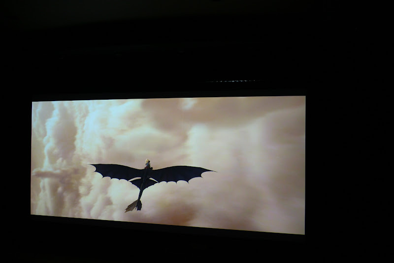

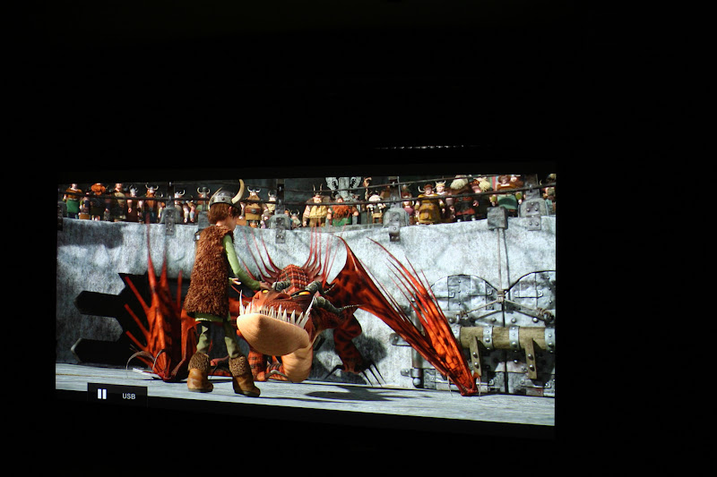

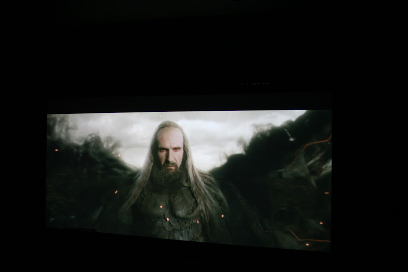

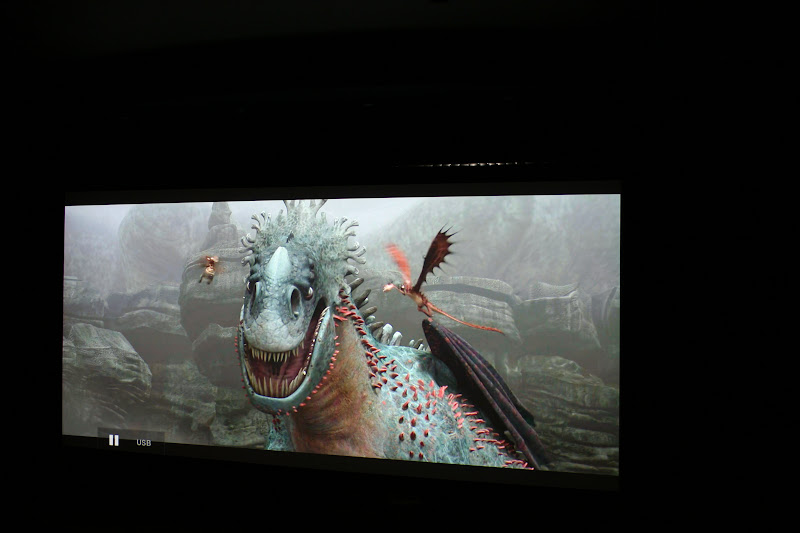

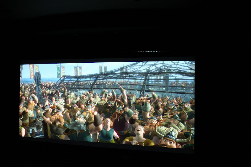

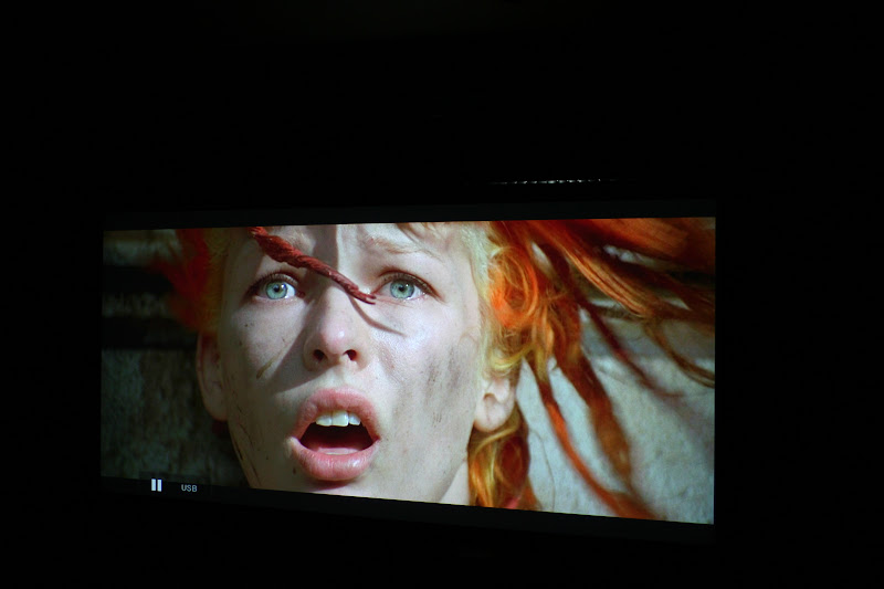

Yesterday I finally got around to hanging the screen. I used a pair of 4' long piano hinges from Home Depot. Because the square metal tubing that stretches the fabric sits proud of the wood frame by 3/4", I first added 1 1/2" x 3/4" poplar under where the hinges go. The poplar strips connect to the poplar frame with 1.25" gold screws; the hinge is connected to the poplar strip with the dinky 1/2" long screws that came with the hinges; the other side of the hinge is connected with 1.25" gold screws to 2x3 cross bracing I added to the false wall. Those 1/2" screws seem a little iffy - but there are going into hardwood, and there are a LOT of them (about every 2 inches along the hinges), so hopefully it will be OK, as the screen isn't all that heavy.
I still haven't painted the vertical braces, you can see the reflection from the flash. I'll need to take one of them out, paint it, wait for it to dry, put it back, and then repeat for the second one - so the screen stays stretched. Or maybe I could make a temporary wood brace to keep it tensioned and work on both braces at once.
The faint circle on the left of the first pic is from the camera, not the screen material - tiny raindrop landed on the mirror when I was changing lenses during a holiday trip, and I haven't gotten around to cleaning it.
Here's the screen, under full light:
under low / screen wash light:
hinge detail:
reference screen shots:
more screen shots - 2.35:1:
16:9
stretched 16:9 (zoom to widen, throw away some content on top and bottom) - I accidentally watched some 16:9 this way because the velvet frame eats light so effectively that I didn't notice I was overshooting quite a bit. Not bad depending on the content.

Wow Brad! Stunning! Hey, my screen is on a french cleat, but the thing is so big that I have nowhere to put it when its off! I think your hinges look great, and I'm going to amend mine to be that way. Having it pinned to the ceiling when up is about the most convenient solution.
Screenshots look great too. You're going to be having some fun!

Brad for me to form an opinion I am going to need MORE screen shots........LOL
Looks awesome. The piano hinge idea is perfect and the 1/2" screws will be plenty since there is a few dozen of them. Looks great but the new screen shows me why your MW2 skills are lacking a bit

Screen shots look really good Brad. I had to go back and threadsearch to remember your choice of the ever-popular screen size ratio you went with (what was it, 2.125?). Has getting it set up made you reconsider (even a little?) your current plan for no masking?

Thanks Tony! Yeah that was my concern too - it's not that heavy, so taking it down wouldn't be too bad - but where to put it?? Still need to make some things to prop it open when I open the hood.
Actually since I sold my projector we only have 1 tv available down there to play on. I am actually sitting down here watching my son play MW2 as I search AVS looking for answers to my column building issues. Where are you on that front???
I've seen many DE builds with hardwood columns - maybe it's not really big deal (as long as they don't land in first reflection points?). As far as surround height - can you set them up temporarily at the proposed height and test some surround material? Ear is the best judge.
Correct on the aspect - no concerns yet with masking need. Only ones where it's really noticeable to me is on low bitrate rips, where the overall black level is elevated.
