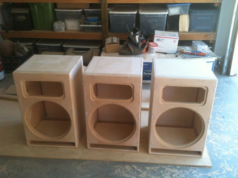

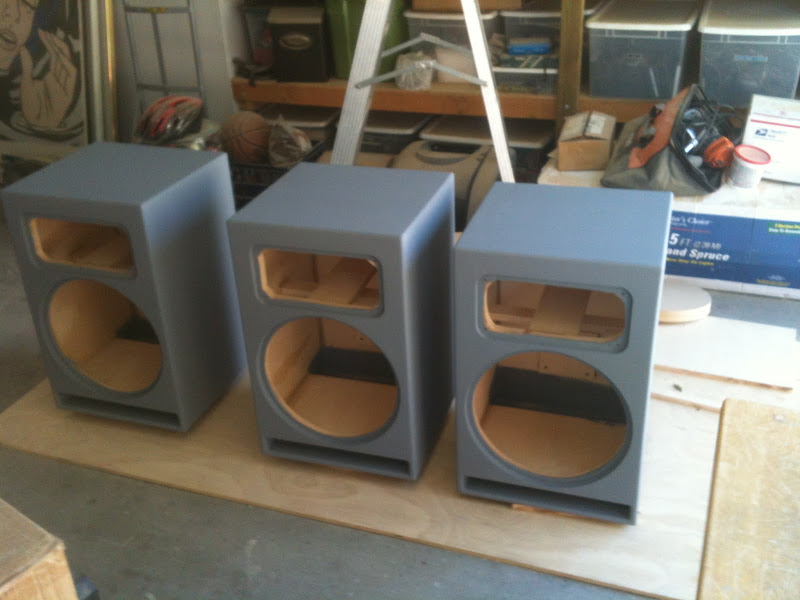

I guess I never posted a picture of my completed DIY LCRs - here they are - not in place behind the screen yet, but well, here they are anyway:

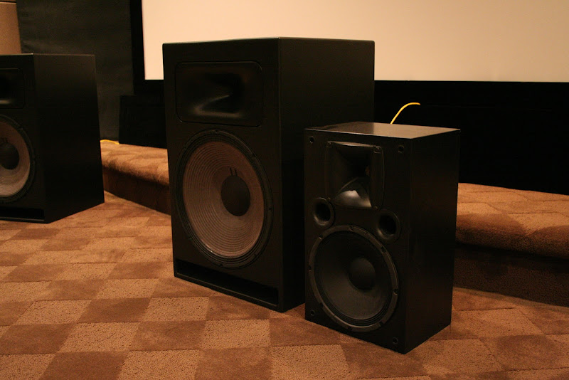

The PRO-10/SHO-10/PRO-10 LCR has been working great, but I've gotten a little hooked on speaker building DIY, its fun - and upgraditis, just wanted to see what I could get by investing in higher end components for the LCR.
