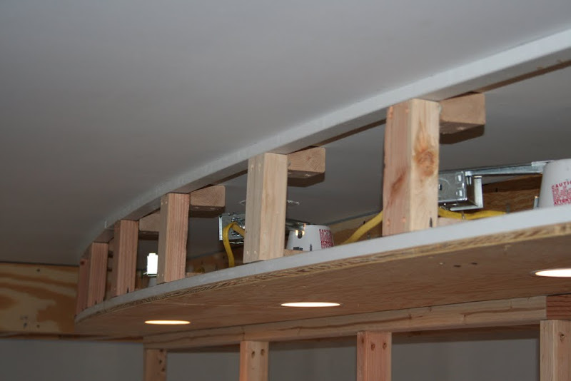

I got the soffit mostly framed in over the weekend - still need to add a curved section at the front, and relocate the screen lights down into it (wasn't originally planning a soffit); as well as add the rope light tray and fixtures.
Rear - the wiring here was originally for the smoke alarm, I'm going to relocate the smoke alarm and use this box for recessed lights in the soffit.
Left - junction box is where the rope lighting will be wired to.

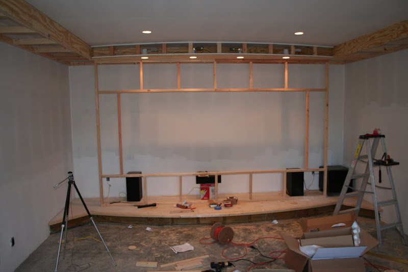

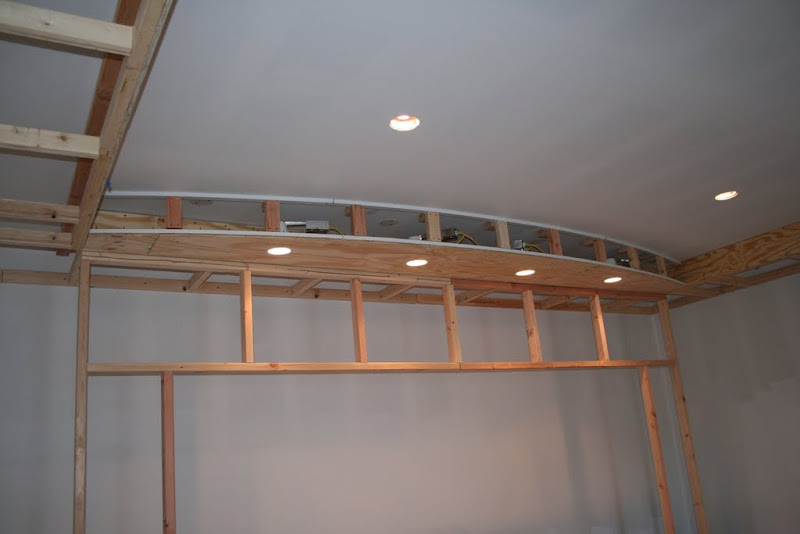

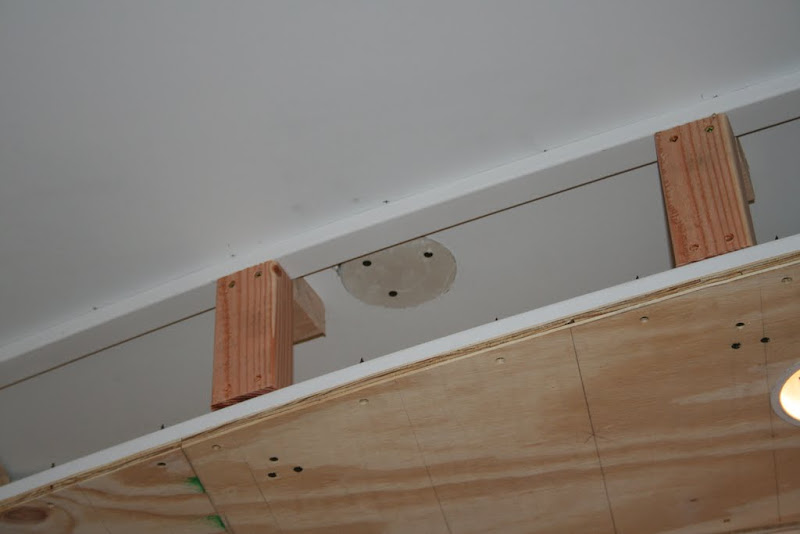

A bit of progress the last couple weeks, not as much as I would have liked to have accomplished, but still progress.
Framed screen wall. No screen yet. The opening is the approximate size of the planned screen, but may have to mount it a little higher than that, in order to keep the PJ ceiling mount from hanging down too low, since I want to due the poor man's CIH, which means the lens can be no lower than the top of the screen. Current eye height is at 1/3 of screen height, so moving it up would be a bit of a compromise, grumble.
Added the curved front of the soffit to match the curve of the stage. The whole soffit was a bit of an afterthought, so I had to relocate the screen lights down into the soffit. Getting that thing up onto the ceiling was a bear with no help, but I managed to figure out a way to do it.
Close up of one of the "old" screen light holes that I plugged.
View of the bracing I created to support the front edge of the soffit.
Added two layers of 1x2s for stage lip, will route a curve on the top edge.

Mentioned: 267 Post(s)

The stage was built by my contractors. I specified the dimensions and curve. They drew the curve out using string + pencil arc technique, on a scrap sheet of OSB, used that as a template to draw the outline on the concrete slab and built over that.
I built the soffit. I wanted the curve to match the curve on the stage, here was my approach:
- I first built out the soffit as a rectangle, extending 24" from the front wall (the depth of the front of where my false screen wall would be).
- marked 24" from the front wall onto the top of the stage with a chalk line.
- I then measured to see how deep 4' wide pieces of 1/2" plywood would need to be to extend from that 24" line to the front of the stage (no lip added at this point, the top was flush with the face).
- I cut those plywood sheets, laid them on the floor upside down, and then screwed 2x3's to the back edge.
- I then flipped the whole thing over, put it on the stage with the back edge lined up on the chalk line, screwed it down temporarily to the stage, and rough cut the front edge with a jigsaw.
- ran a flush router bit to even up the front edge with the stage.
- unscrewed it, flipped it over, then bent and screwed 1x2 MDF strips to the curved edge (MDF because its more flexible, less likely to crack when bent).
- marked the depth front to back every 6 inches across it, and then marked those distances on the ceiling with a pencil
- screwed 1/2" MDF strips following that curve, to the studs in the ceiling.
- added small 2x3 blocking on the ceiling at stud locations just behind the MDF edge, and on the plywood just behind the MDF edge.
- added temporary bracing across the corners and the edge against the screen wall to support it while I installed it; (hard part) hoisted up one end on the temp corner bracing on one side, while I got up on a ladder with the other end, and put it up on the other corner bracing.
- screwed a temporary 1x2 support between the center blocking pieces, to hold up the front edge while I connected the rest of it.
- screwed the 2x3 strip on the plywood to the front of the rectangular soffit.
- cut (9 I think) 6" pieces of 2x3, and screwed them to the top and bottom blocking, to support the front edge.
- then installed the light fixtures, and ran the wiring.
That's where I am now - still need to add a 1/4" plywood face, and then drywall over that, mud and tape. Then onto the tray all around, have the rope light waiting to go up already. Moggie's is far nicer, but this should look OK too hopefully once I have it all together.
It will be fine.

Brad- thanks for the details! So from your soffit pictures, the white "arches" are 1x2 MDF. Did you custom order these? I was looking at HD, and the thickest they have 3/4" sheets, which I guess could be ripped. But nothing larger.
I think I will be doing something similar.

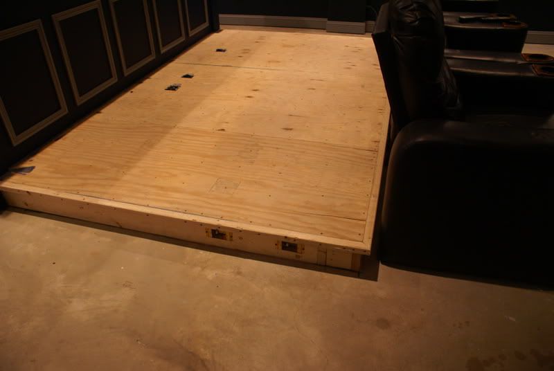

Also, did the contractors build your stage on top of a sheet of plywood? It looks like plywood, 2x6, then plywood top (I'm trying to see how it came out to be 8"). Is riser 2x12?
WannaTheater is offline

Like Chia mentioned, they are pre-primed MDF 1x2s, and I found them at HD in the trim section.
Post #12 has pictures of the riser and stage as they were being constructed:
http://www.avsforum.com/avs-vb/showt...9#post18678279
The riser has a 12" finish height, it has pressure treated 2x4s running crosswise and also cut to follow the curve of the face, then 2x10s ripped down a little, then 2x 3/4" plywood on top.
The stage is similar, but 2x6s framing it inside, filled with plastic sheet / sand, and topped with a single layer of 3/4" plywood. (1 1/2" + 5 1/2" + 3/4" = 7 3/4" - maybe they were 2x8s ripped down to 5 3/4"?)
