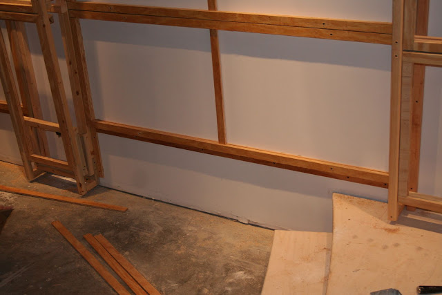

Took the last couple days off work to get in some real work, HT work that is. I finished building the column face panels for all six columns:
Picture of the grill guides that attach the column face panels:
and almost finished adding furring strips to all the walls:
Here's one of the concealed outlets that I need to redo the mud rings on, to get the flush with the wall:
I'll be building 1" deep wall panels, sitting on top of 1/2" furring strips - loosely based on the GPowers plan, but wide panels (26" high, ~66" wide - although the width varies slightly due to column placement), built from two layers of 1/2" plywood (vs. 1/2" plywood + 1/2" MDF), and probably rounded off edges, vs. angled. Here's a couple in place, no routered edges yet and not mounted yet:
The 3 big panels on each wall section will be removable; the top and bottom pieces will be permanently attached, so I can add baseboard and crown if I decide to.
Tentatively planning on using ball/socket speaker grill guides to attach them, but maybe velcro. Have used the ball/sockets on my column faces, with no problems, but these panels are much larger, so will have to test it out on a panel or two.
Panels will house 1" OC 703 1/2" off the wall - or maybe 1.5" OC 703. But I'll defer adding the insulation until after I have carpet and furniture in, all the panels built, and have done measurements to see how much absorption I need.

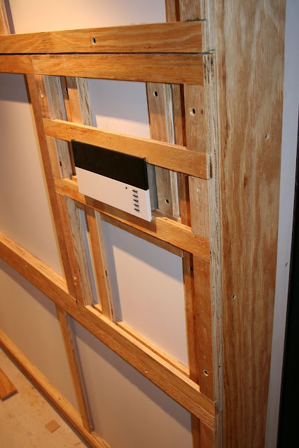

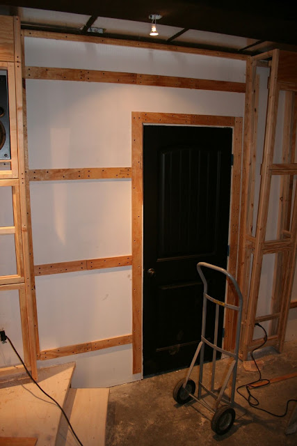

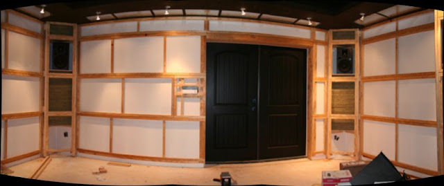

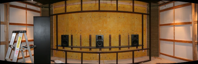

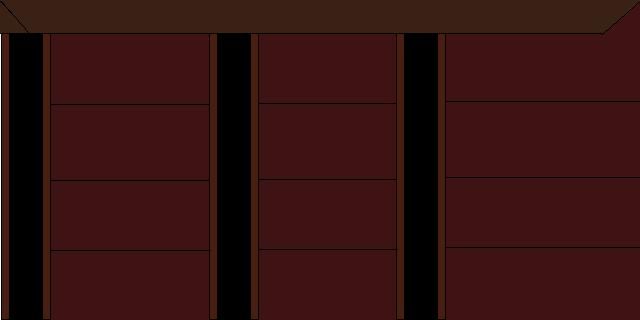

Here are some pictures of the fabric frames as they stand (test fitted, but still need fine tuning on size, routing, and sanding). Note that the panels generally run the full width between columns, but the center braces make them look like smaller panels.
back:
front:
left:
right:
The panel for the Grafik Eye was a little tricky:
Wasn't sure what to do with the entry door frame - decided to mount a sheet (will be covered with black fabric) within the door frame, and flush mount the panels against the edge. If it turns out OK, I'll skip adding trim.
The closet door frame had to be handled a bit differently - I ran the furring (and will run the panels) up to the door frame, and will add an MDF strip to extend the door frame up to the panels.
not done with bottom panels (will add after carpet goes in, so I get the height right - or I guess I can do sooner, and leave it high, since I will need to add baseboard anyway):
A couple color schemes I'm considering - tan scheme, which is my front runner:
rust/red color scheme, which I also like - but I've seen so many red theaters, I think I'd prefer to have something different:

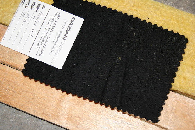

Testing to see if flash shows OC 703 / wood through fabric (Duvetyn) - doesn't appear to:
some GoM samples I'm considering (all are lighter than reality due to flash):
I would love to find a FR fabric GoM alternative in a similar color, but having a hard time coming up with on. Just really not looking forward to shelling out $1000 on fabric.

Thanks Jeff! I sure am looking forward to the post sawdust and drywall dust everywhere stage - the HT and garage are a complete mess. When I took down the columns and wall panels to get them ready for fabric, I really started to run out of room to operate. The room looked naked without the columns up, I had really gotten used to them.

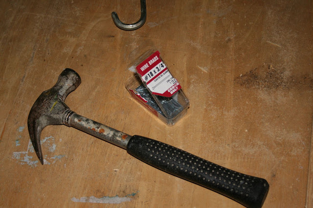

So I guess that box of 5000 staples I bought isn't going to last very long eh... Did you have any issues with plywood splitting when stapled into? I guess I'll find out soon.
I got my panels all routed and sanded, and I hung all but the back wall back up, using speaker grill ball and socket connectors (six per panel for the wide panels) - seem to hold OK, but I'll probably need to add a bit of Velcro too - but the grill guides should keep the panels lined up properly. Need to buy a few more packs though, almost out of them.

5000 staples probably won't getter done you shold have no issues with the ply blowin out. Also you may want to lay out a sheet of ply and wrap with plastic as a work surface when you are wrapping your frames. This allows for a slippery surface to spin the frames around when stapling and easy to keep clean.
Good luck!
Edit- Oh yea one more tip, get yourself some of those sticky 3M lint rollers. These work great to clean up the frame prior to hanging.
